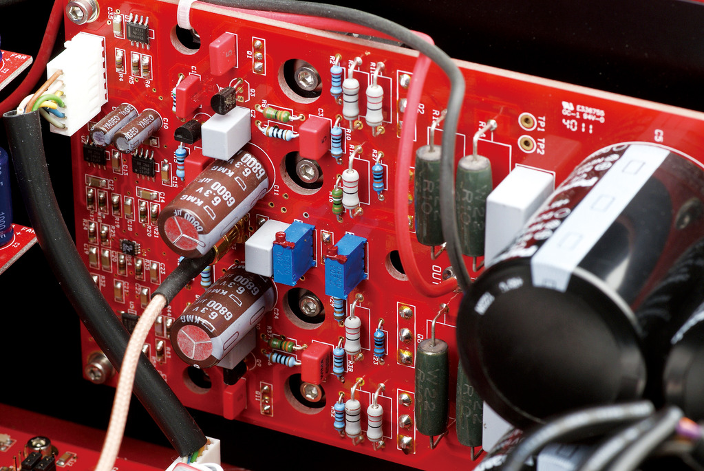

After the ancient NHB-108 model one, the newer LHC-108 and CTH-8550 amps contain the 458's circuit with 2 pair of MJL1302A/MJL3281A. To suppose the NHB-108 model two includes a similar one is logical but there is no exact information...
You may think the key of darTZeel magic is the schematic and the spectrum of THD.
The real magic is the synergy between the circuit and the "sound" of certain parts which are used by dartzeel.
If you change a resistor from Dale RN55 to Beyschlag MBB/SMA0207, you cannot measure any difference concerning THD, etc. But you can hear difference and you may step into the real dartzeel sound's direction...

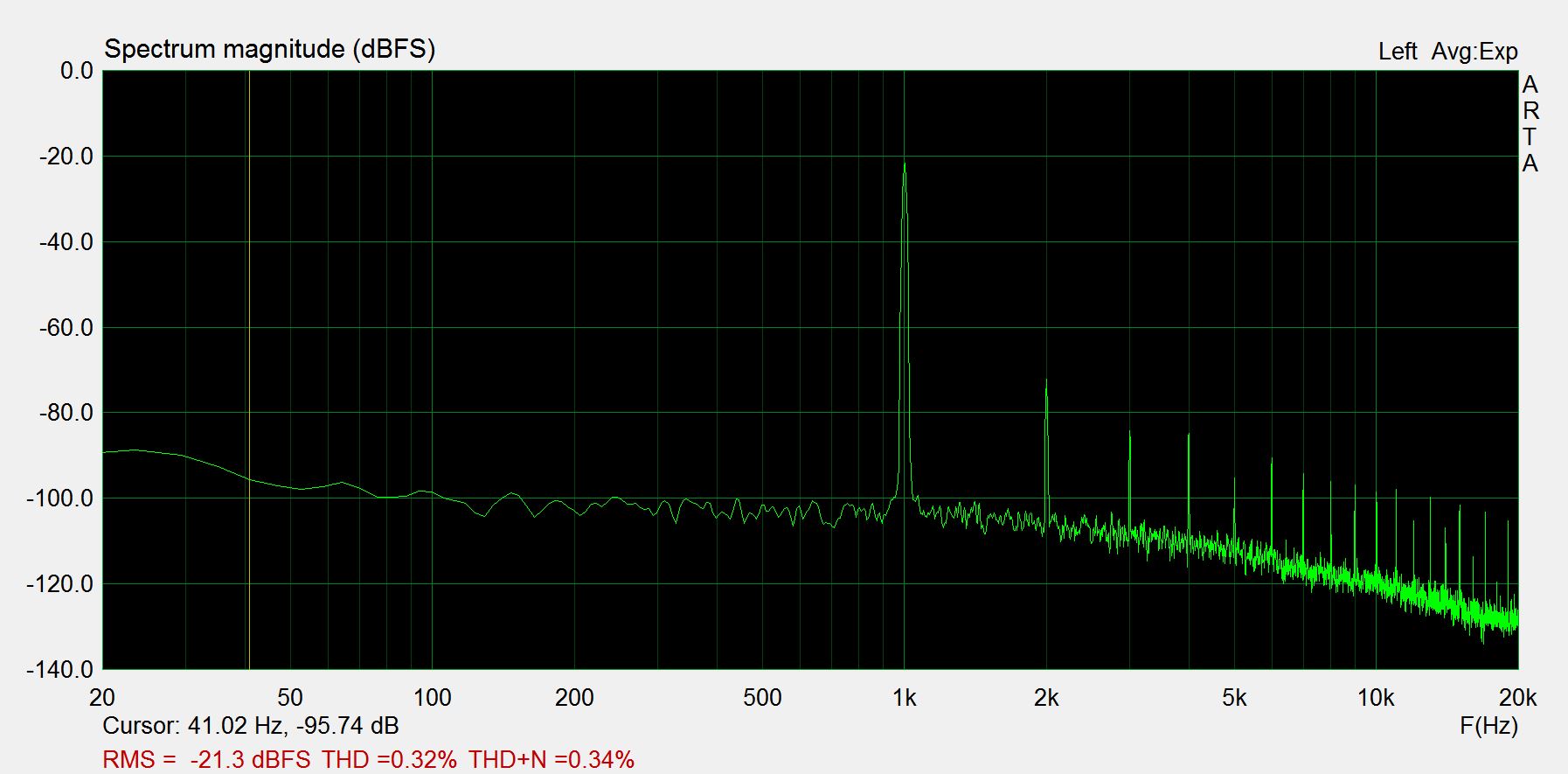

My 458 circuit's THD:
39,3Veff / 8,2Ohm ( 188W ) / 1kHz - THD=0,085%
38,8Veff / 4Ohm ( 376W ) / 1kHz - THD=0,11%
and I use this amp with a speaker which has 2.5Ohms impedance minimum.

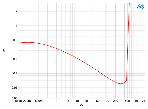

Which seems in line with the published measurements for the 458. Have you measured the distortion spectrum at some more usable power range? Perhaps 5 - 50W?
Come to think of it i have mostly heard the original 458 at extreme power levels, where its distortion is minimal.

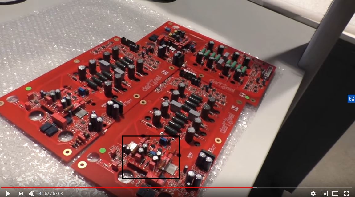

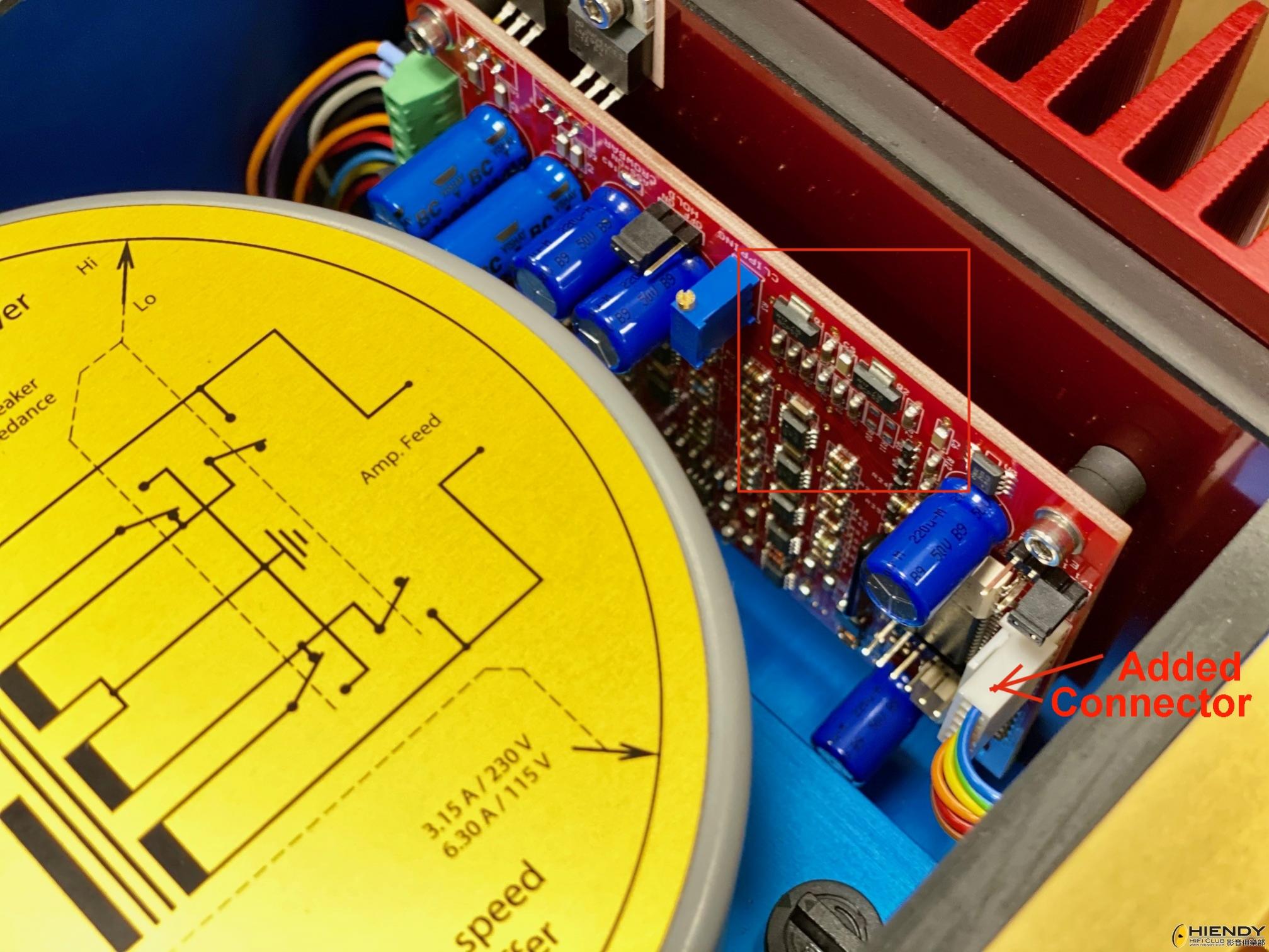

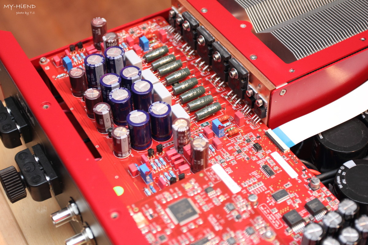

Part of the explaination for Ver2 result may be that some part of the amp schematic is located on the protection PCB, in fact extending the already amp small foot print. That may be the way they were able to squeeze to 458 circuit into the 108 frame. Looking at the ver2 protection PCB we can see it is using smd part, but more important look at the left section where a new connector is added. We can see BCP52, BCP53 smd transistors, and added parts. Maybe there is a first gain stage on this section than it goes to the final output pcb... Just a tought...

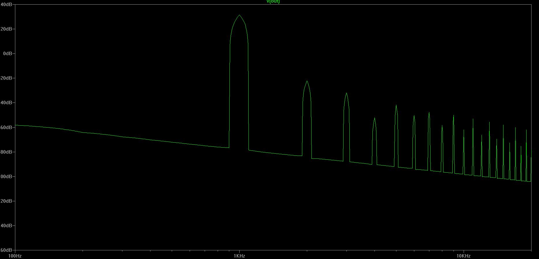

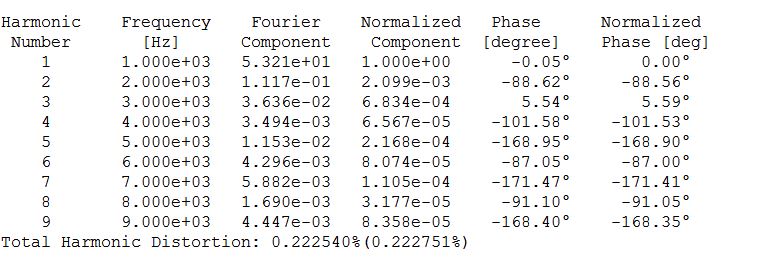

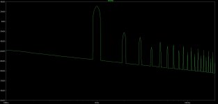

180W/8ohms/1kHz.
The simulation is close to what i measured. Not very pretty.
The Stereophile measurement with the gradually decreasing with output power distortion is impossible to replicate.
I get you idea: the amp ugly distortion is compensated by mellow sounding passive parts. Not sure i can swallow it.

..." Looking at the ver2 protection PCB we can see it is using smd part, but more important look at the left section where a new connector is added. We can see BCP52, BCP53 smd transistors, and added parts. Maybe there is a first gain stage on this section than it goes to the final output pcb... Just a tought...
AND does this not look like a multilayer pcb?? Even more difficult to descipher :(

Maybe just 2mm thickness, like the amp pcb... But indeed impossible to figure the actual circuit with just a few pictures...
I don’t think there is some magic circuit for the amp on this board because I read somewhere you could upgrade from model one to two without the new protection board if your model one was of later date with SNCP ad on.
Also the new update is using the new solid core silver wire from the input to amp board and on the pictures from the new protection board I can’t see this wire.
There were more steps, price’s for the upgrade.
