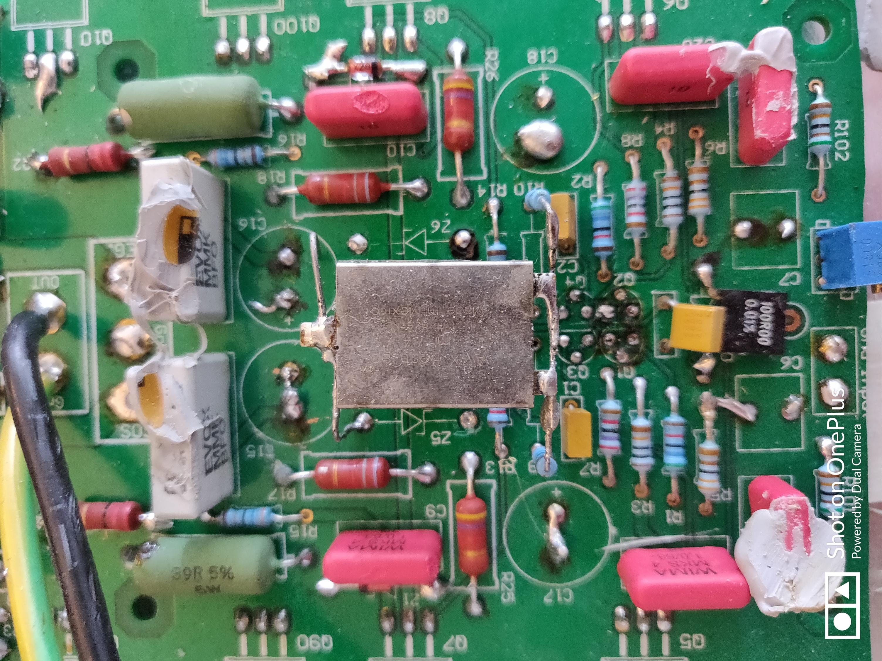

It is the B version of the 108, where one side of the 360R resistors are lifted and grounded through a supercap for AC thus reducing the DC gain. Much to my surprise the supercap's esr had gone up through the roof by a hundred ohms or so. They appear well sealed but contantly elevated temperature apparently dries them out. There is no lifetime data in their specs anyway.

Sorry just difficult to read. Avx Best Cap 4 v
My Clone was "dancing" +/-200 mv. With Supercap
Weird. The correct way to deal with this is to adjust the offset with the cap shorted out and then remove the short. DC gain without the cap is about 20 and with the cap drops to 2. The input offset appears at the output reduced by a factor of 10 and of course there is some non-input related offset that cannot be reduced but is not significant.
So, before delegating blame to the cap you should examine the situation without a cap. If the inclusion of the cap does not improve it dramatically that means the cap itself is leaky. If the pot appears too jumpy when setting the offset it may be a good idea to use a much lower value like 10-20k.
Not trying to jump to conclusions but this particular board appears to have spent time at Chernobyl during the core meltdown :)
My low voltage clone has never had any offset issues at +/-36v. The high voltage one (+/-56v) starts up cold with 140-160mV which settles down to 40-50mV twenty minutes later. The input transistors are in thermal contact with each other and reasonably well matched which helps a little bit. Never felt any need for either a servo or a cap and once every few months check the offset. No Chinese parts anywhere.

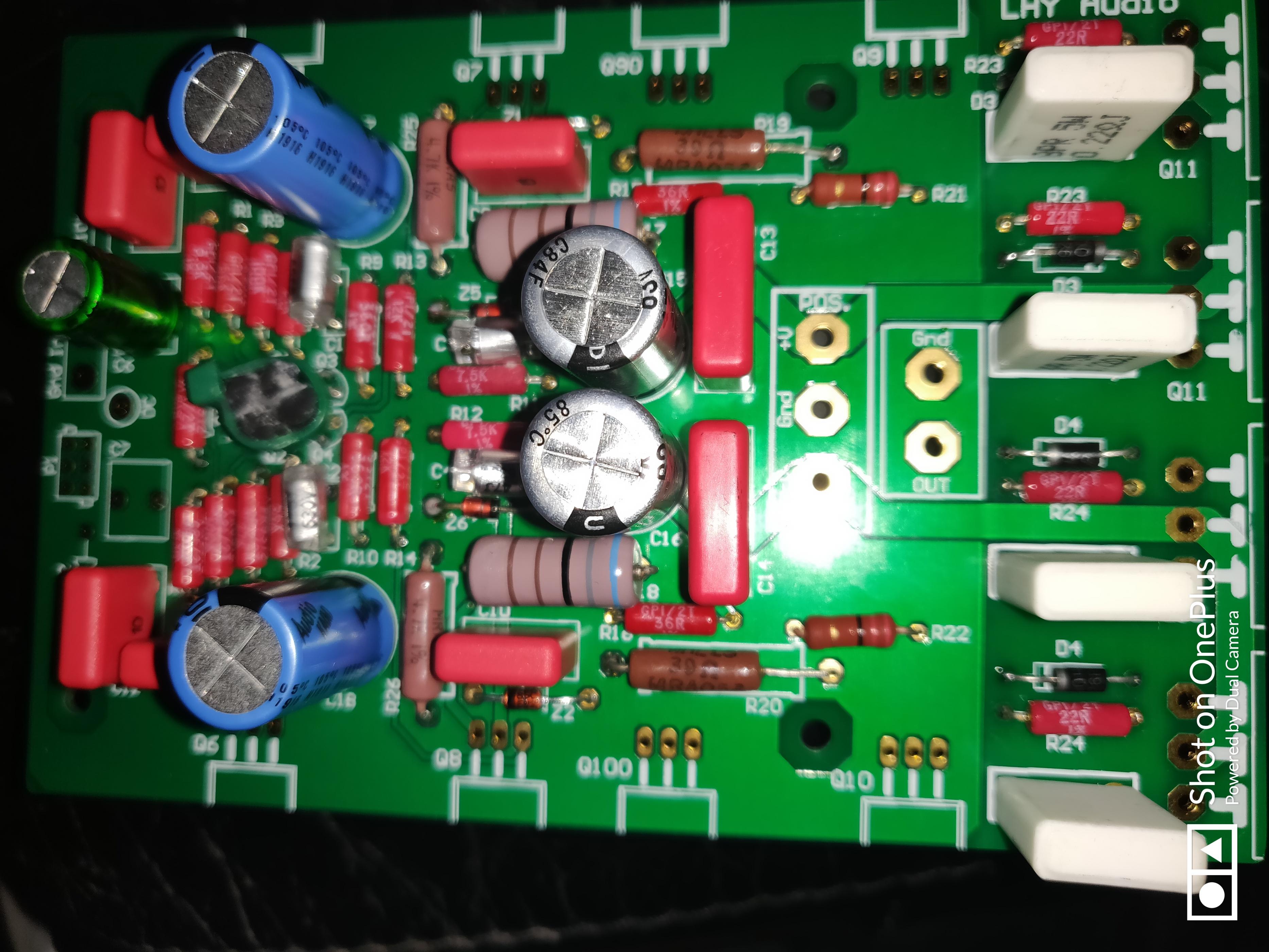

How is the build of your new card/design, Version 2, going?
I have tried to find how you (and Algar_emi) found/came up with the schematic for the new card with two pairs of output transistors, but cannot find it.
Besides the physical placement of one the pairs of output transistors, what is the (schematic) difference between your new card and the chinese (original circuit but two pairs of output transistors?) card used by E Saeterdal?
