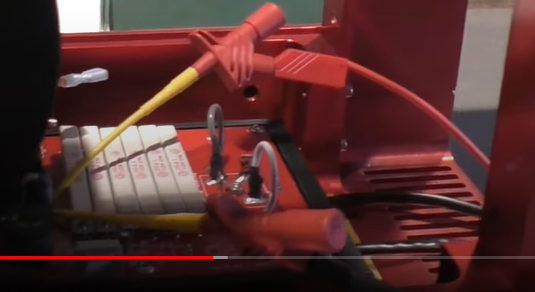

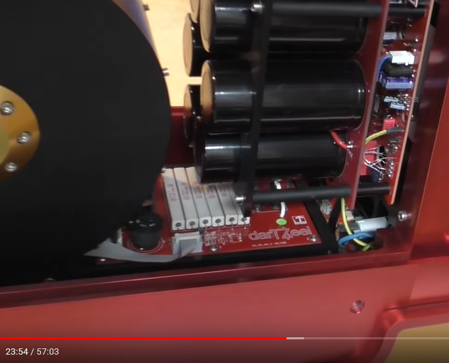

Finally looked at the Dartzeel factory tour. One screen capture shows an amp partial schematic, seems to me that this thread NHB-458 schematic was quite correct"
Those pictures are from the (short) Matej Isak factory tour
Did you see Analog Planet/Michael Fremmers Dartzeel Factory tour, as well?
It is much more extensive:
YouTube
I am sure You will pick up even more interesting info from that tour.
E g the rectifier/soft start resistors used in the 468 (if that is of any interest to NBH 108 Ver 2?)

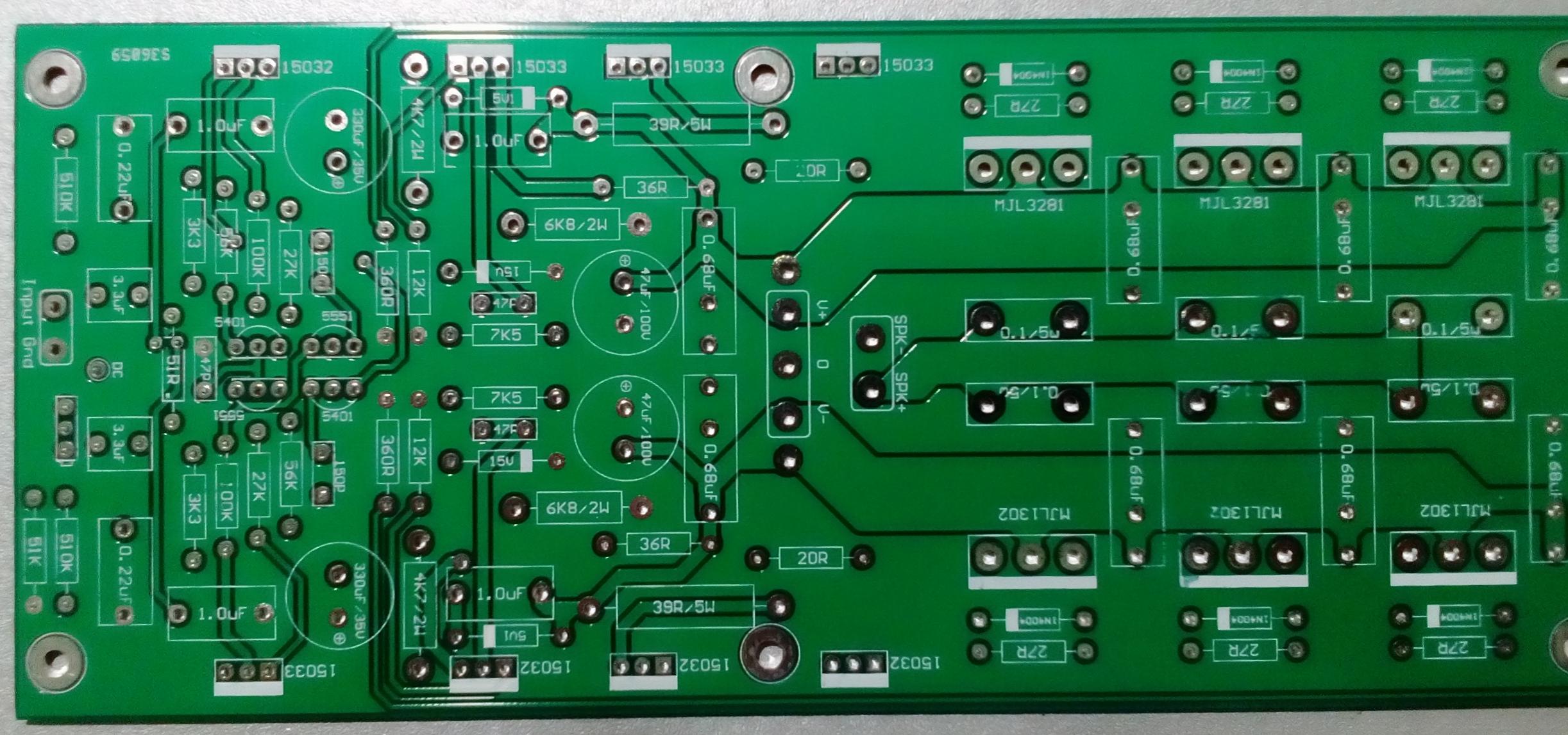

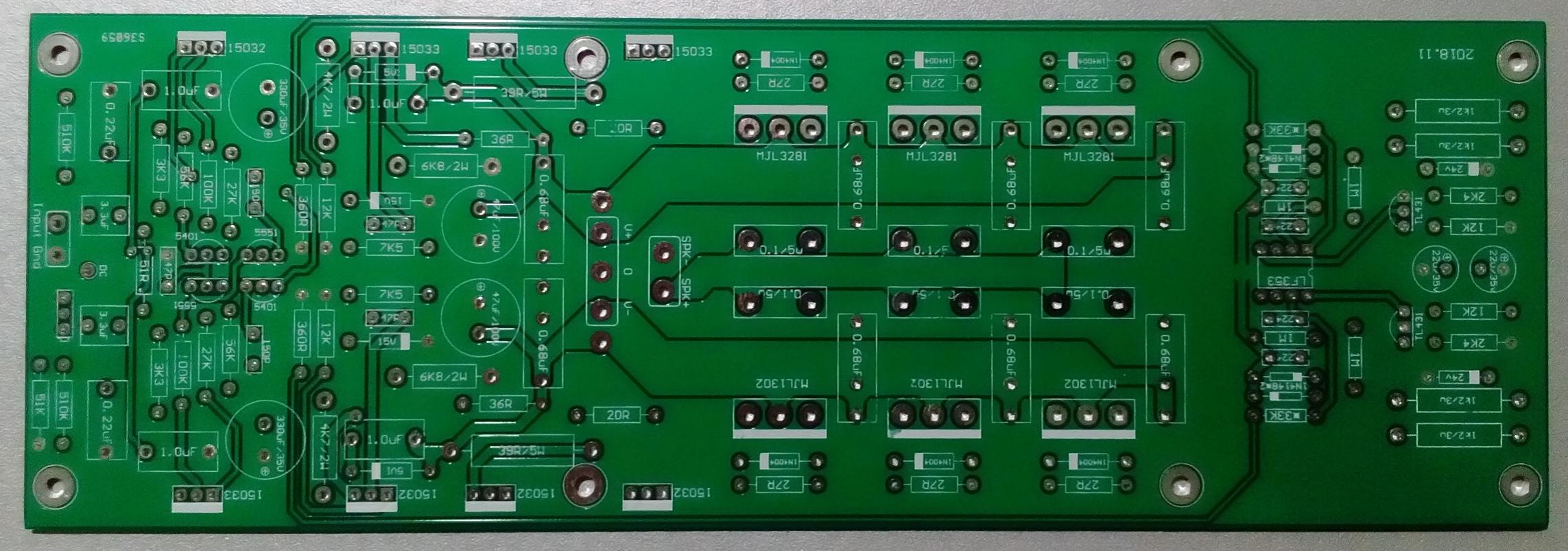

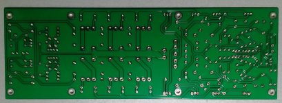

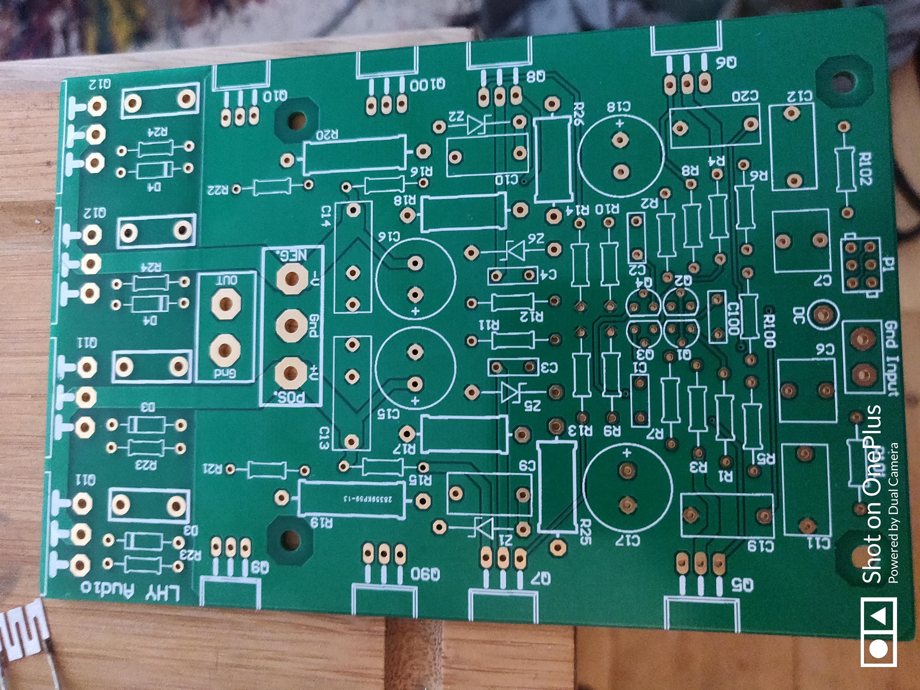

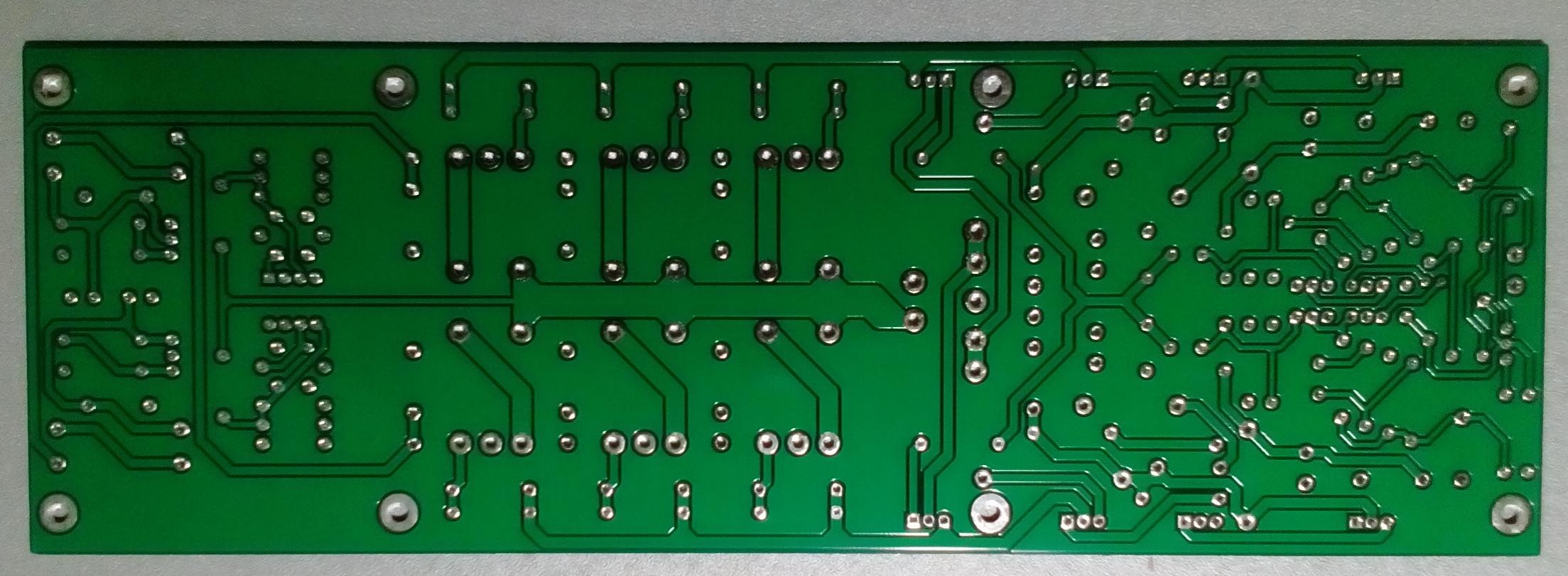

Their ad has a parts list and a PCB part layout, why don’t you ask them to send it to you? I also bought my PCBs from them, but the parts labels are printed on my boards.
2PCS Swiss NHB 108 Post Power Amplifier Copy One Without Negative Feedback Amplifier Circuit 2 Tubes Parallel (without SCNP)|Amplifier| - AliExpress
Have the parts list from the Dartzeel Manual.. Downloaded it. Tomorrow I will finish the PCB. I will get the missing components. Think I will knock of the ceramic from output resistors. Place a silvermica in between two 0.22 resistors and parralel them so it is 0.11 ohm
