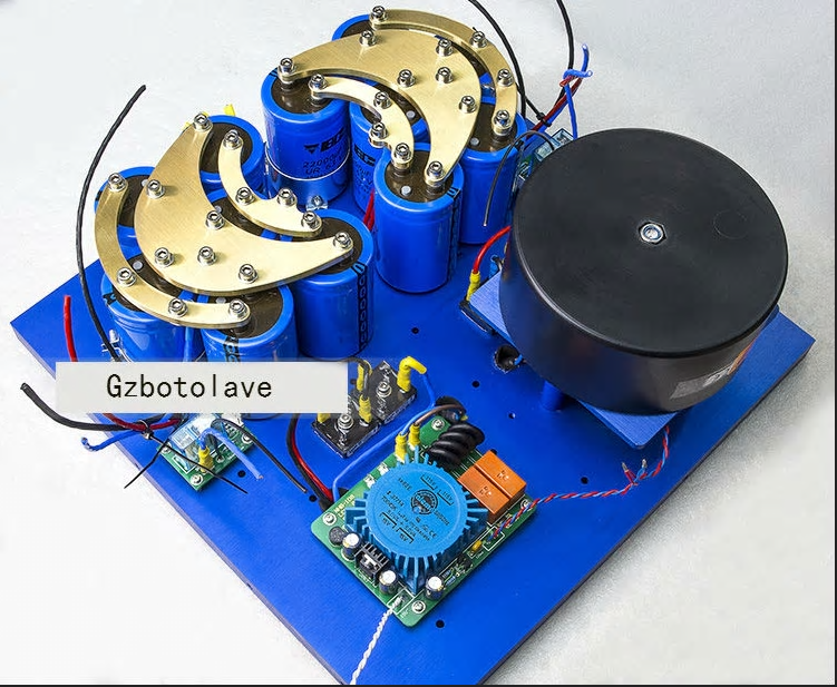

Would something like work?:
"220V Class A Amplifier Power Delay Soft Start Temperature Protection Board"
220V Class A Amplifier Power Delay Soft Start Temperature Protection Board | eBay
It has a 220 to 12V transformer, NTC resistors to dampen start current, 5 second delay of two 30A relays, 75 centigrade sensors.
Yes, that cover the Power-On, Softstart and over temp protection. Exacty what I was planning to use, but with solid-state relay instead of actual relay (smaller) and also the Solid State relays are zero-crossing (switch on at the 0Vac point of the ac waveform.
Just need to add the protection pcb with current sensing and crowbar and you have a complete DartZeel 😉

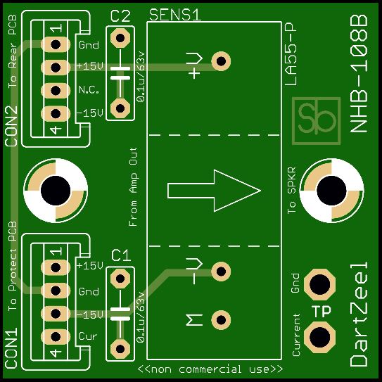

Here again an othe Goldmund protection schematic. A lot of op-amp, comparators, but from count, the DartZeel has about 20 op-amp on it...
Naturally there are some differences, the Goldmund has the Left and Right channels monitored on the same schematic, the Goldmund current sensors are on the power supply output, so are measuring DC current, the DartZeel is measuring DC+AC, so probably need some form of active op-amp rectifier, but it gives us an idea...

From what i gather, it is SB's intention to emulate the original as closely as possible and to this end he is trying to achieve the same with the protection circuit too.

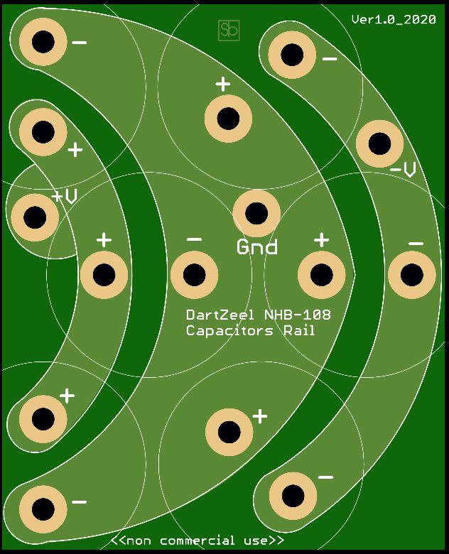

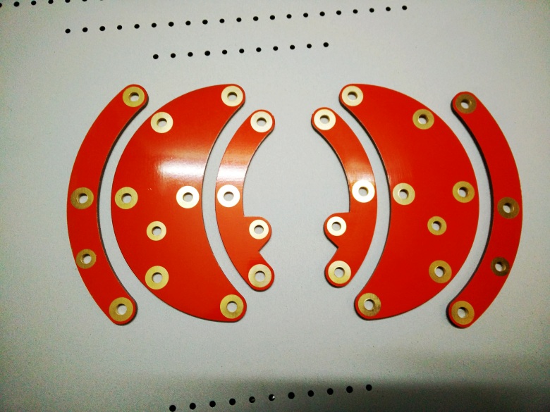

Did a capacitor bracket pcb, with 1oz copper top/bottom = 2oz, for test purpose and prototype quick assembly. I'll use two pcb per cap banks, that will equal to 4oz copper. I won't try a 250Amp crowbar on it, but it will make the assembly of the prototype much easier and faster...
The final pcb will be with a Yellow silkscreen.

So how do your two boards differ, analog_sa and Algar_emi? They look rather similar, but I notice Analog has One larger capacitor C100 while Algar has two MKP10, eg. But I guess the function will be the same, or..?
Will you make more boards after your first batches have arrived? (I would also like to build one of them)

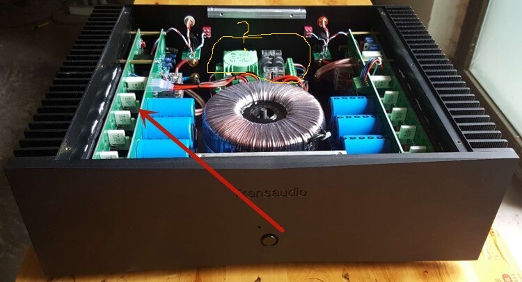

Is this clone true to the original when it comes to placement of protection circuits and other components underneath the main transformers? Are there really 2x2 diode bridges on the original?
But should not the big electrolytic capacitors be closer to the mainboard/output transistors? Is this really an optimal placement (on the original)?

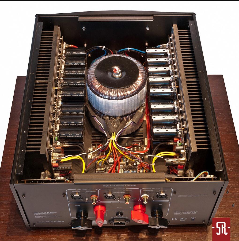

Better design?
Is not this a better design/placement of electrolytic capacitors? (close to the output transitors) (Hegel)
..or another chinese clone amplifier.
And what is better? A few huge ones or many, smaller?

No idea really, but I suspect a very simple bridge per transfo. The capacitor banks are so big, and also the presence of the Crowbar protection suggest a big, tough rectifier bridge. I like the big Vishay 35MB100A, with 35A, 1KV specs. And Pass use it a lot in some of his supplies. Pass like slow recitifier like this one.
Yes I know of the brackets on Tabeo, but only Chinese can buy from this site...
And yes analog_sa I also believe that a lot of little details of the original, like these copper cap bracket may explain the difference in sound from a clone and the original.
Mostly in the libraries used, SB's are much prettier. I saw no point in having two crappy Wimas in parallel as used in the original and made space for the single caps i am likely to use. Not nearly enough space for anything really nice but sufficient at least for Auricaps with the option for BG-N i currently use.
Anyway, unimportant, as the boards i ordered are just for testing. No one really knows if this amp will be worth keeping, it's an experiment. Until an owner has taken and published pics of the real thing we can only speculate what exactly goes inside.
