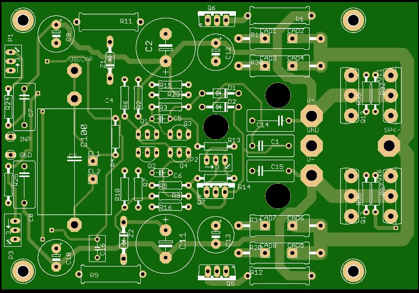

The board on the recent post (#1020) was labeled:
darTZel NHB-108 Model 2, Ver 1.
Will that board eventually be available for group purchase? In that case I will be the 1st in the queue. I would like very much to have an amplifier based on board developed here.

I want the boards also
Maybe better to wait and see (hear ;) ) if this ver2 prototype is working and deliver good result. Don't forget we don't know the ver2 actual circuit, we just assumed and guess...
Guessing analog_sa will be the first to try it. I'll sell the few extra I'll get so some others can try it, but no warranty it will work ok, and sound good. It may be too soon for a GB, don't want to send to a lot of buyer a defective pcb...
With that in mind, if you still want to try it, send me a private email. BTW the pcb will be the usual 1oz copper, 1.6mm thickness to start. If the pcb deliver and i start a GB, then we can order 2oz copper.
BTW my board already have double top/bottom output traces that equal to 2oz... So proceed with caution when you'll test it...
Let me know and keep in mind it is a prototype...
SB

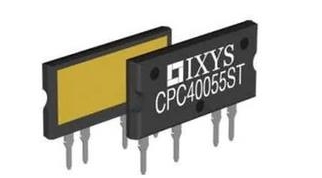

Found very nice solid-state relay from IXYS, pcb mount, small as a rectifier. If bolted to the bottom frame can pass 20A. So the Power-on and softstart relay can be on small pcb right under the pcb...

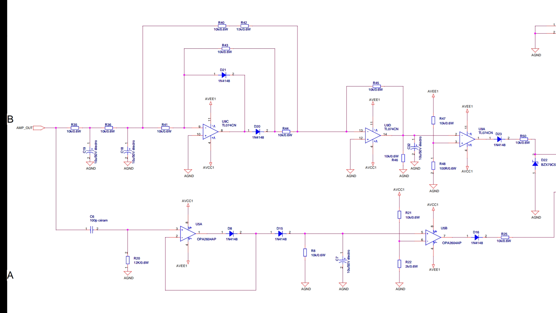

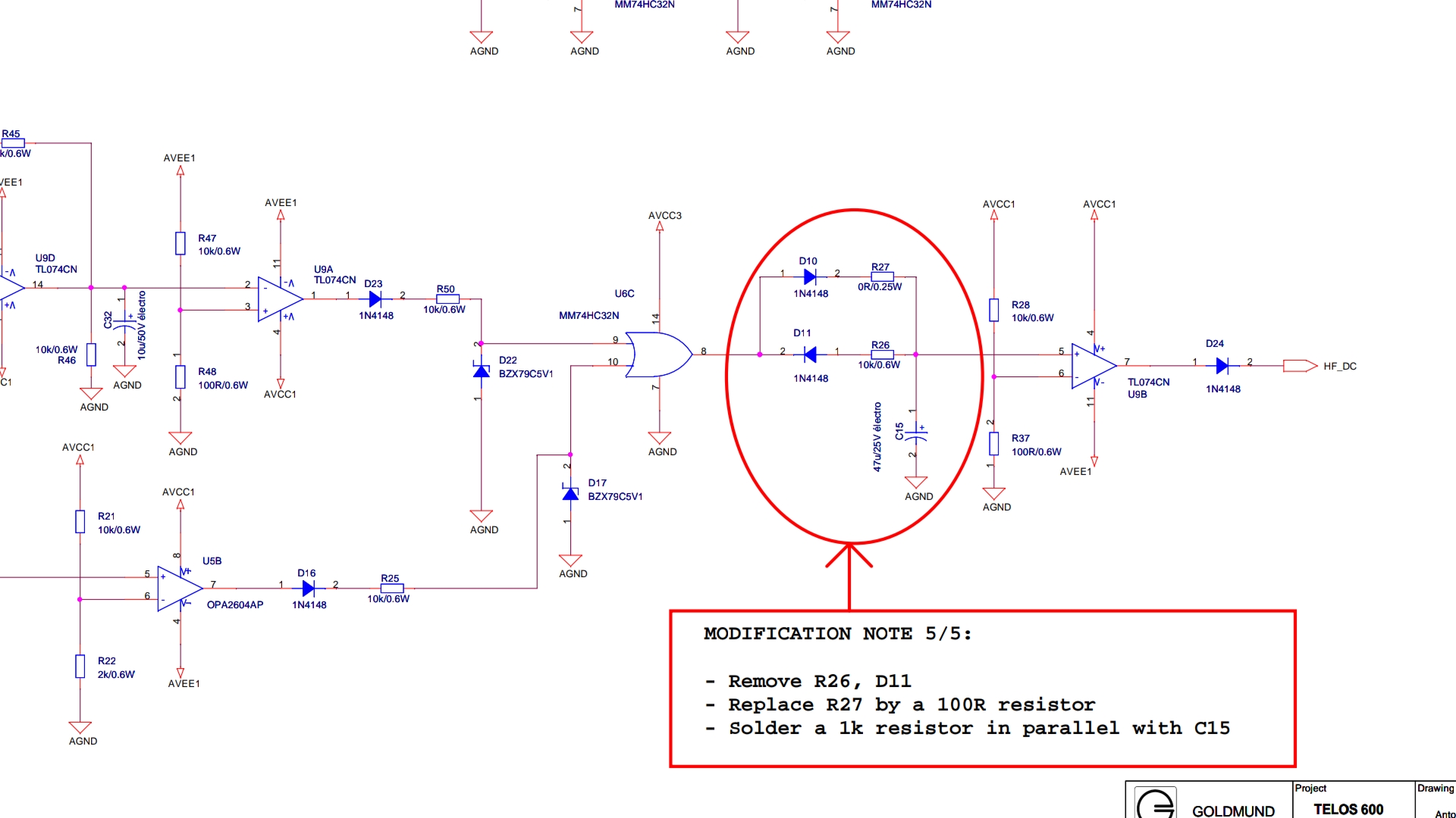

On the protection Card, maybe the protection is similar to the Goldmund amp that have a lot of TL07CN Comparators IC.
-This protection usually includes a DC detection + HF oscillation detection (for oscillation), combined with a OR gate = one shutdown fault --> Crowbar
-Simple op-amp conditioning for the current sensor (like Goldmund again), overcurrent being a fail condition as well...
-Then three level comparators for Led:
>>If no input signal (<10mW into 8ohms at output), for 45sec, then turn ON led, LOW intensity
>>Signal presence (>10mW into 8ohms at output), then turn ON led, MEDIUM intensity
>>Amp reach its maximum power (near clipping). Flash led for 1sec at HIGH intensity, then get back to MEDIUM, wait at least 1 sec before flashing again if power still reach maximum
and Clipping protection, so goes too high (clipping) shutdown the amp (Crowbar)
The protection PCB has three trimmers, and three test points VA-I, VA-V and GND, I is probably Current crowbar trigger point, same for V that is probably clipping crowbar...
-From pictures small TO92 transistors seems to be the same as used on the amp, 2N5401 and 2N5551 (makes sense, they probably have tons of them...)
Here the Goldmund Current sensor conditionning and Fault, and the DC Voltage and HF oscillation, also an other fault... OR Gate on these schematics can be done using simple diode 'OR'...

Not at all, sorry if I implied that. I found this great SS relay from IXYS 849-CPC1918J, 13A, at Mouser but there is also a 20A version, but sadly not in stock. At 14$CAN it is not that expensive, fit the small pcb under the transfo, and can be mounted on the metal plate under the transfo for heat dissipation. Can be control directly by a dc voltage.

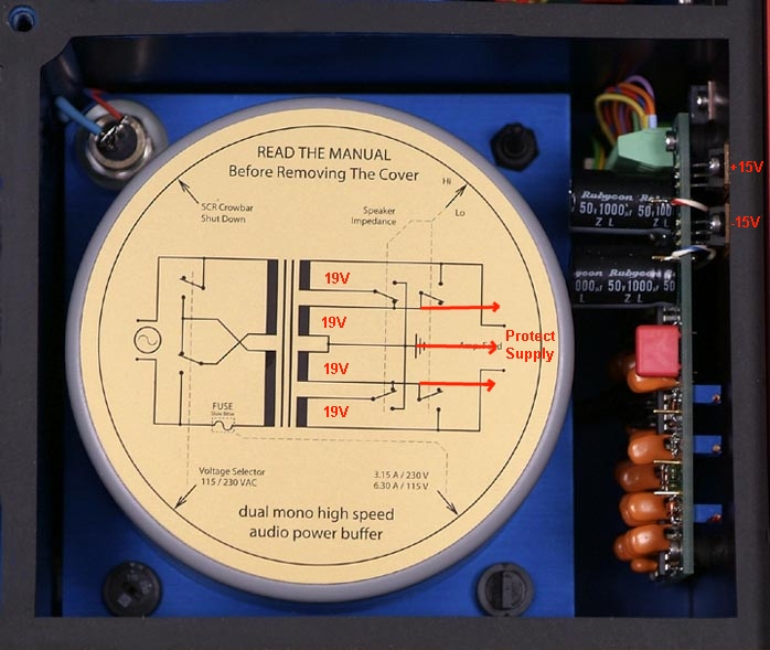

Latest findings, the monitoring PCB raw supply before the +15 regs is around 20Vdc (19Vac x 1.4142)-1.4V rectifier drops = 25Vdc, not bad as input for the 7815 series regs. Maybe there are some dropout resistors to reduce the voltage to 20Vdc... So there is a storng possibility it is derived directly from the inner seocndaries of the amp main transformer. Since these secondaries always remains at the same voltage whatever is the transfo is switch from 8ohms or 4ohms mode, it make sense to supply from the fix section of the transfo...
Somewhere I read version 2 (or possibly a later model) has a small, separate transformer for the standby power, according to a manual (or maybe in a comment by Mr Deletraz in Stereophile)
Surely it is not desirable to take the standby power from the main transformer.
The protection pcb only is powered by the main transfo, not the standby section. And this section indeed is powered by a separate small transformer that includes two static relays, on for Power-On, the other for Softstart. The temperature sensor on the heatsink is directly inline with the Power-On, stop the amp in case of overheat and resume operation when cold down occurs...
The protection PCB is not powered when the amp is off, only the standby section remained, so it doesn't appear that the protection pcb is involved with the power-on and/or the softstart section...
