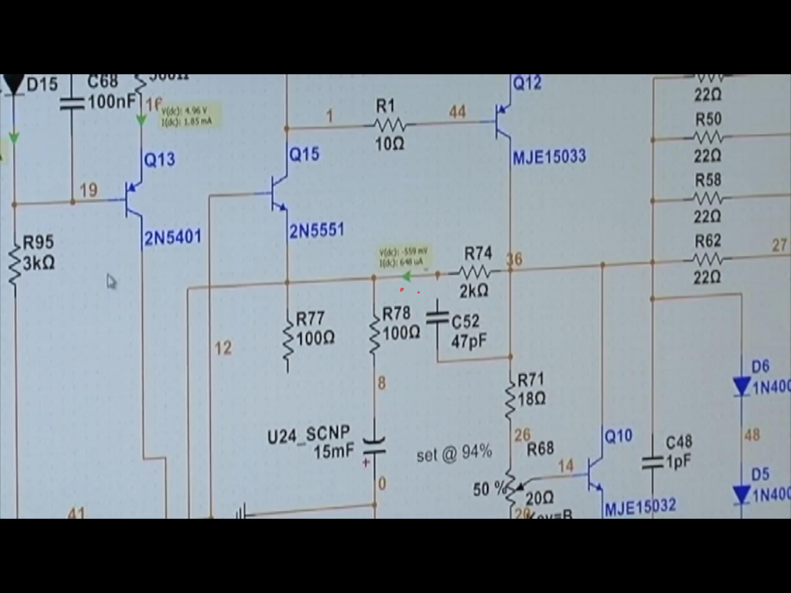

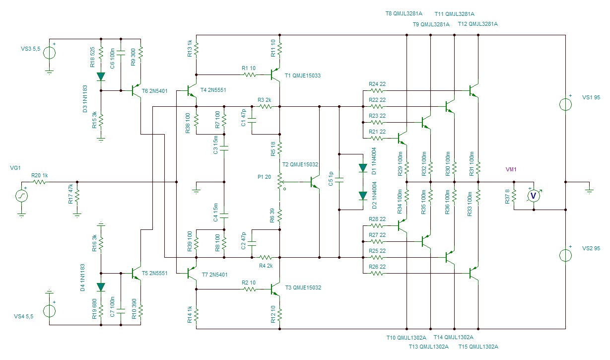

Finally looked at the Dartzeel factory tour. One screen capture shows an amp partial schematic, seems to me that this thread NHB-458 schematic was quite correct. If the NHB-108 is a scaled down version of the 458, with two pairs of output, it shouldn’t be too difficult to make a test pub for it... Compare both pictures

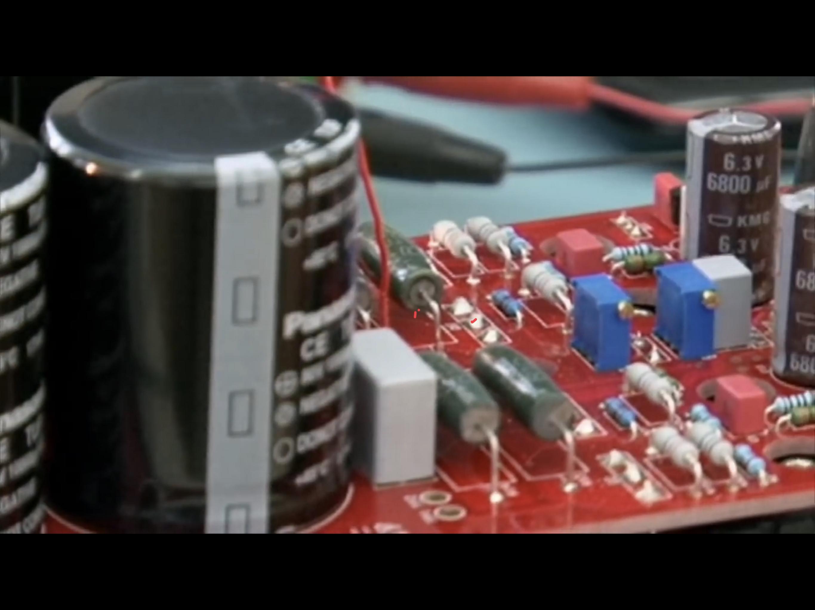

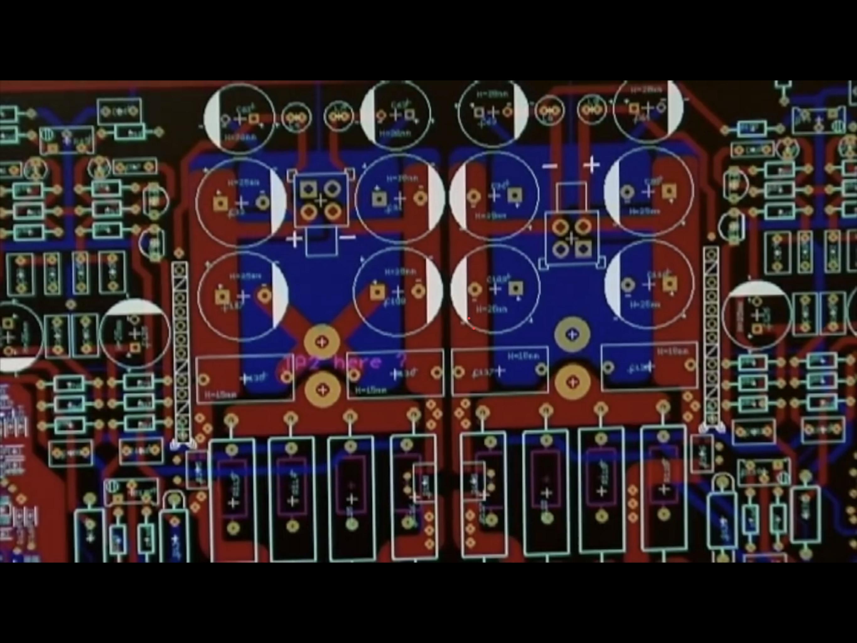

And these pcb images give us so idea of the pcb layout, and parts choice...
The pcb on the left is from another amp altogether, perhaps from a LHC208 and the photo on the right is from a CTH8550
The Hungarian circuit is of course inspired from the video, but we cannot say much more about its credibility.

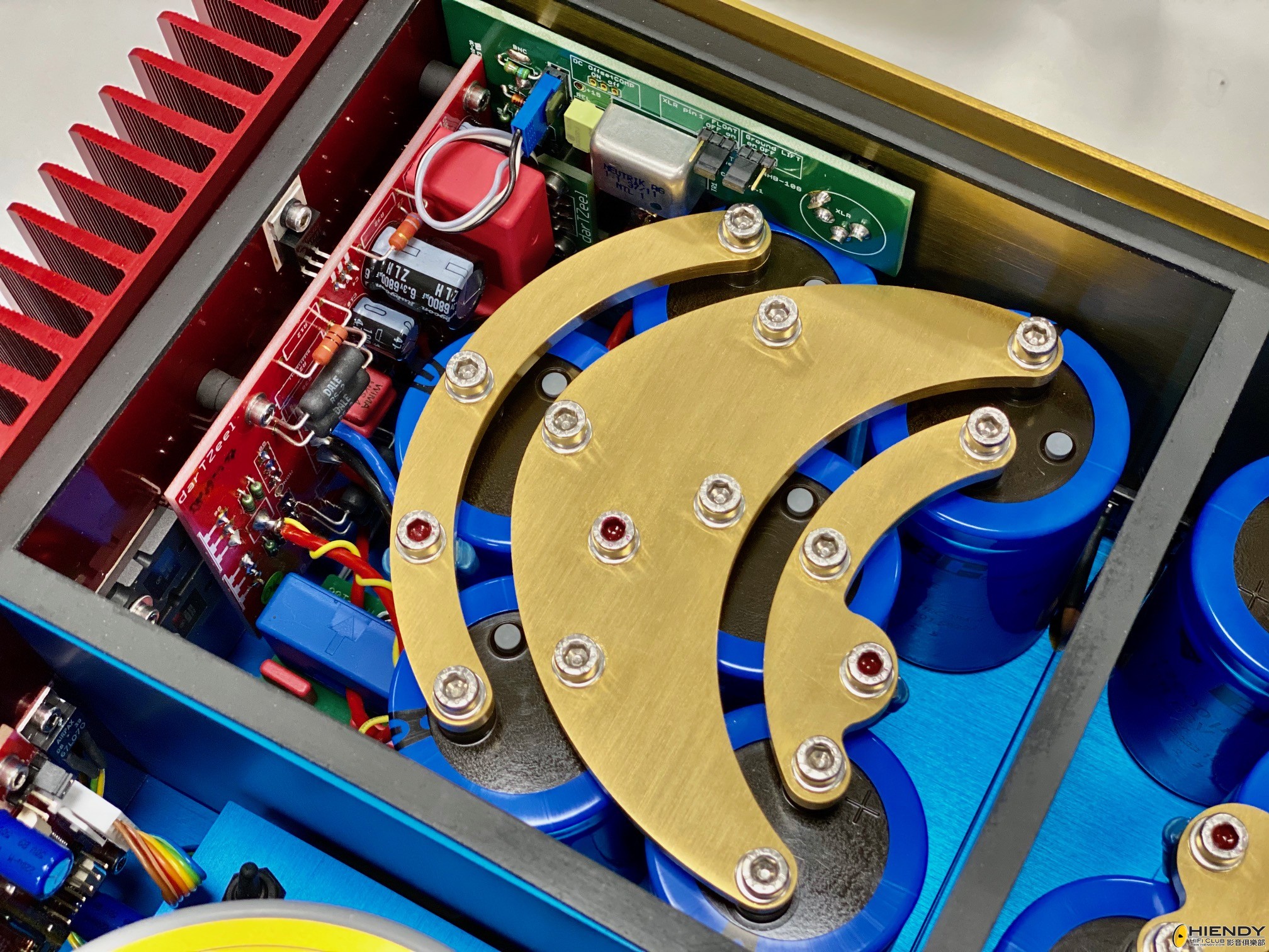

purchased the clone and powered by a 300 VA transformer and 2 BC of 22,000 micro per channel, I was unable to distinguish it from the original, and with the original I mean the final from € 38,000

the clone, as I say, I consider it little distinguishable if not indistinguishable from the original despite having, the clone, a smaller power than the original.
I repeat, I am sure that the 108 scheme, as I know it, has no need for 132,000 micro and 1,000 VA per channel as power supply, at least from my tests and even just looking at the scheme, but I say it with utmost respect for the work of others of course

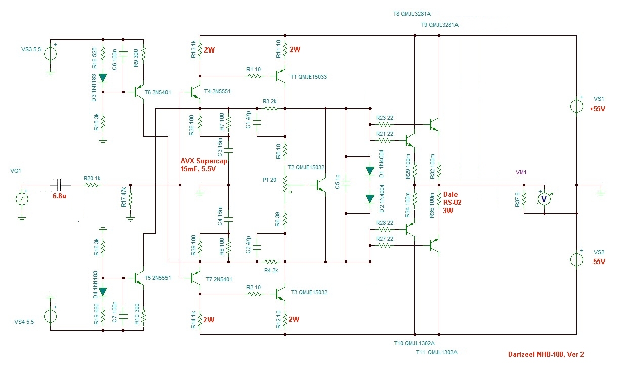

Possible Ver2? Still missing a few caps, like the 6800uF/6.3V (possibly for the CCS 5.5V supply (simple Resistor+zener?), and the smaller 100uF (possibly bypass of the Supercap, as shown on the NF-458 schematic), but matched more or less the pcb image. Also input cap (large red wima possibly 10uF, like the NF-458 again...

Funny enough, that's what i am doing atm too.
No idea where that 5.5v came from into Shany's circuit. If you want isolation from the CCS side, the logical way is to use a better CCS, not frivolous voltage regulation. The 6800 is very likely bypassing the zener.
I am nearly resolved to using a depletion mosfet for the CCS. It sounds better in my system but it may be because the 5W 39R wire resistor is missing.
