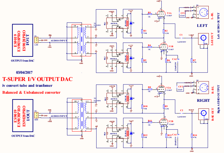

The bottom one is 'current mode'. Instead of a 10K resistor, the coil is connected directly to the ground instead. Each coil (of the LL1684) has a resistance of 41 ohm. Thus the output of the DAC will force current through the coil to the ground. Thus the coil is also acting like a resistor and performs an I-V.
No. The resistance is immaterial for the I/V as it is a DC parameter.
The only consequence of the low resistance value is that the dc level at the dac output is now close to zero volts. There is no i/v conversion as the secondary of the transformer is unloaded.
So, what kind of load does the dac see at audio frequencies then? Not sure about this particular transformer but i have measured a similar Lundahl and the inductance of each primary was around 40-50H. Something like 500k @2kHz?
Again, nothing wrong with the circuit, just don't kid yourself it is somehow resembling current mode as it is not.

Ok, now. New IV
I have tried to test a lot of IV for ES9038.
And finally I'm very happy with this design, that's my choice,
Combination LL1684 and electronic lights.
You please take a look at it and test!
thanks
quanghao

Hello friends!
I know you are anxious!
We are taking the time to test the iv for 9038pro, we work very hard 12 hours a day.
So I did not go online. Looking forward to sympathy for me.
I have tested 10 different designs, however, we find the design below suitable and have the best sound.
It has a balanced output - directly from LL1684, but the amplifier is small, about once.
The output is not needed by using a large amplifier tube ~ about 3 VRMS
Please wait and pay for the DAC kit, and have fun waiting for the best results, please see the circuit diagram. The circuit diagram has a few points I did not publish.
thanks a lot!

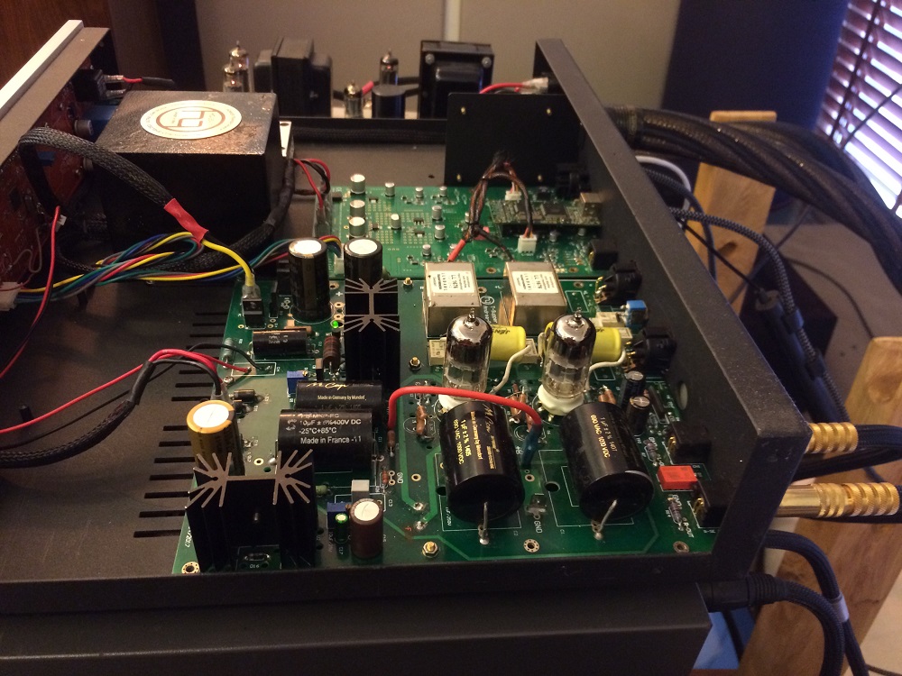

Some pictures: DAC ES9038PRO with T-IV, listen on other sound system, invite you to watch.
