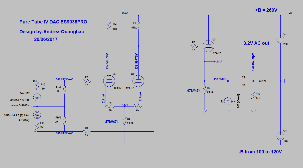

ye, now i design PCB, when all finis , i will say all friend!..

Because, Andrea and I are measuring re-testing all iv designs for ES9038pro.

Andrea and I are working together on design and measurement of IV designs.
We work hard and work hard. We will have the earliest information on test measurements, designs, circuit diagrams, and specific values.

The transformer for IV i think later when i finis test all tube IV
