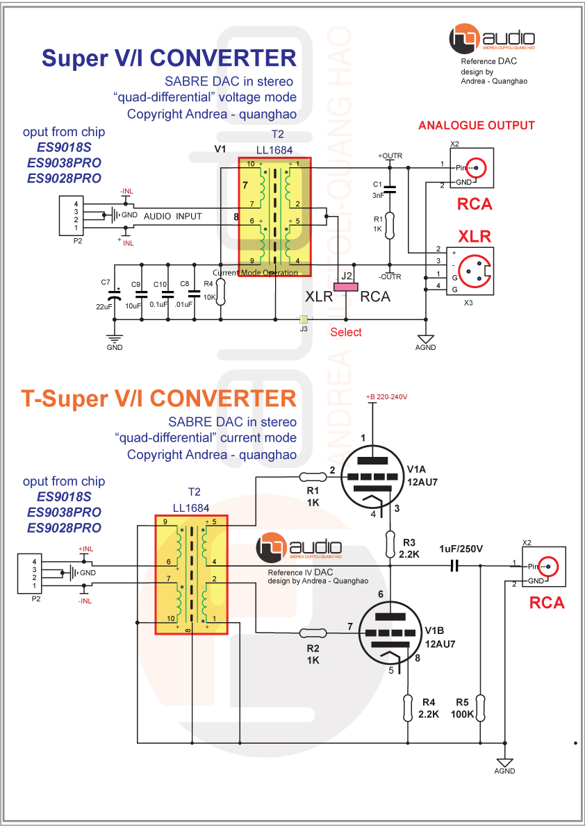

I think the I to V was done by the primary coil of the LL1684.
This does not make any sense.
All the circuits in this thread seem to employ the voltage mode. Nothing wrong with this of course, only that it is nonsense to put labels as I/V or V/I when all they do is V/V.
Quanghao proposes two output configuration.
The top one is 'Voltage' mode with only the LL1684 as a passive output device. The '+' and '-' output from the DAC is connected to the '+' and '-' of the primary of the output transformer. The mid point of this connection is connected to the ground by a 10K resistor. There is no way 'current' to run to the ground due to this resistor. Thus a voltage mode.
The bottom one is 'current mode'. Instead of a 10K resistor, the coil is connected directly to the ground instead. Each coil (of the LL1684) has a resistance of 41 ohm. Thus the output of the DAC will force current through the coil to the ground. Thus the coil is also acting like a resistor and performs an I-V.
