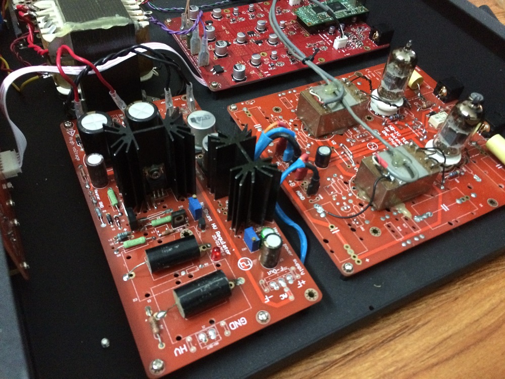

I have tried a lot of output for DAC 9018 - ES9038PR- ES9028PRO, and the version below has won! LL1684 and 12Au7.
You should try . thank you

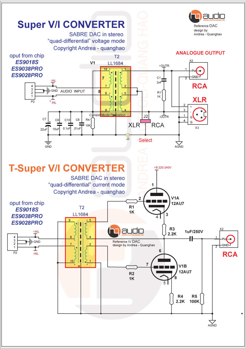

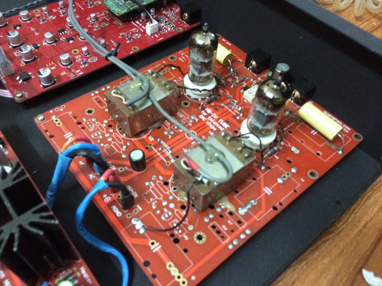

IV for ES9038PRO
Ok, now. New IV
I have tried to test a lot of IV for ES9038.
And finally I'm very happy with this design, that's my choice,
Combination LL1684 and electronic lights.
You please take a look at it and test!
thanks
quanghao
Ok, now. New IV
thanks
quanghao

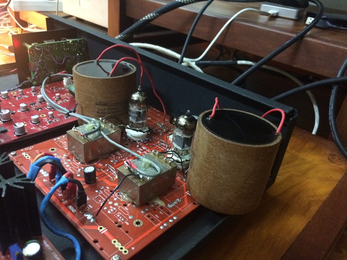

Yes, I specifically use Duelund output capacitors!
OHA ! Yes ! And great sound effects!
Thank you Mr. Duelund!

Balanced output
Hello Quanghao, how would the schematic look like for balanced output? Thank you!

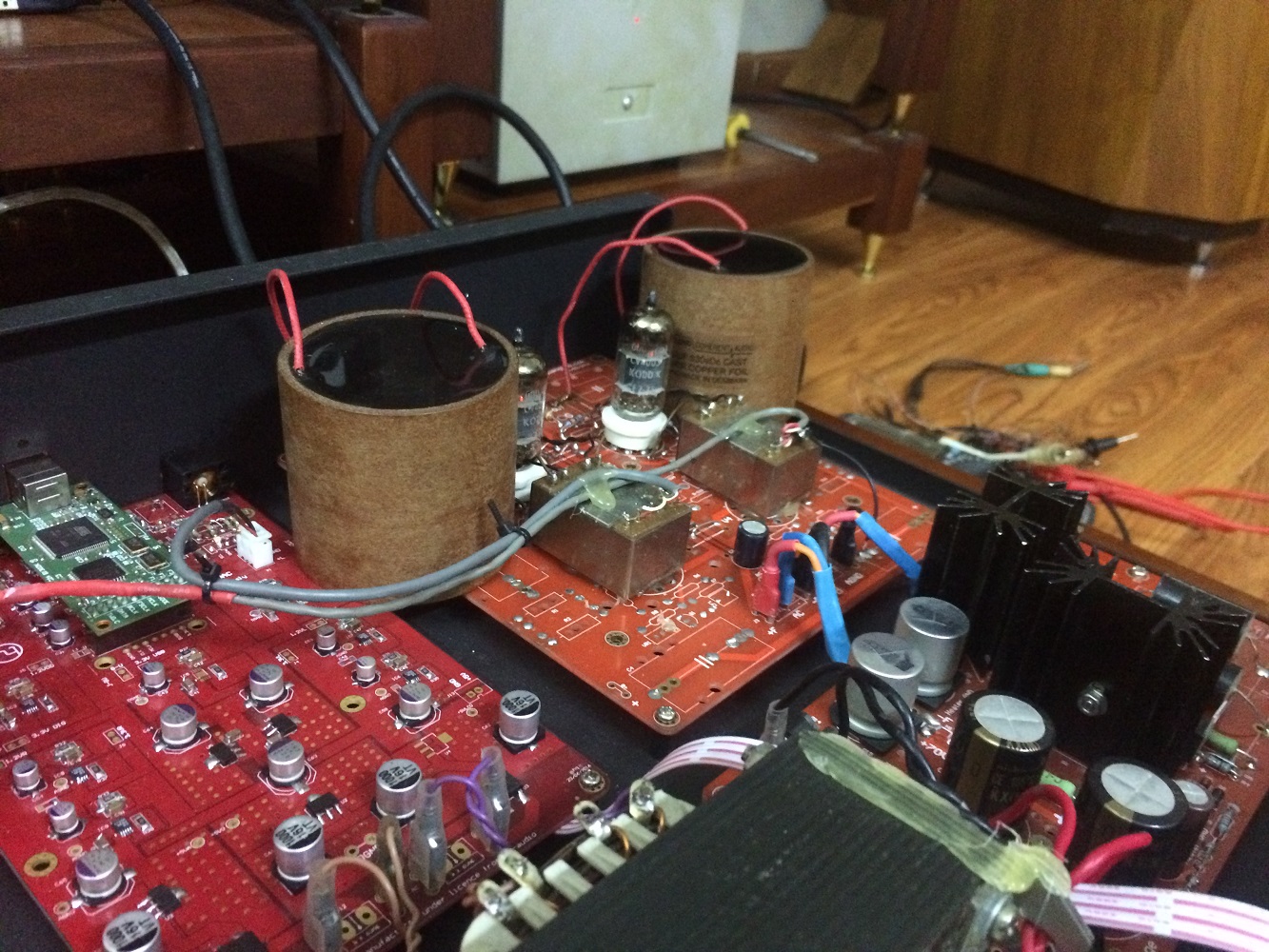

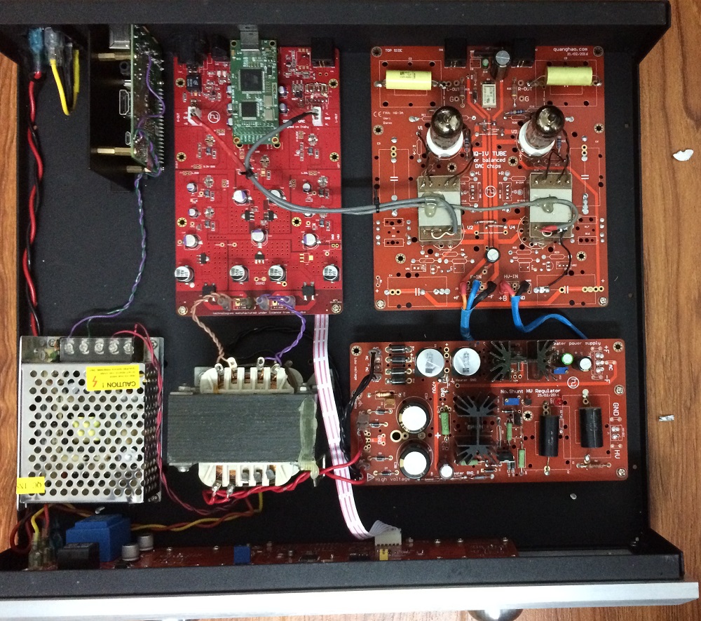

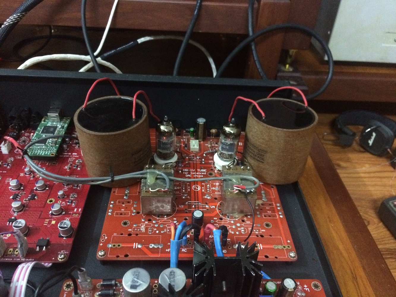

Hi Quanghao,
Is the 12AU7 of the right channel and the left channel sharing the same B+ power ? I would suggest you at least give each channel a separate RC power supply.
Separate Choke power supply with separate power transformer will be even better. But it seems that there is not enough space in the chassis.
Hi Quanghao,
i like use one +B.
you can use your like! and can use 6DJ8 or 12Au7 curent 3-5mA
thanks
