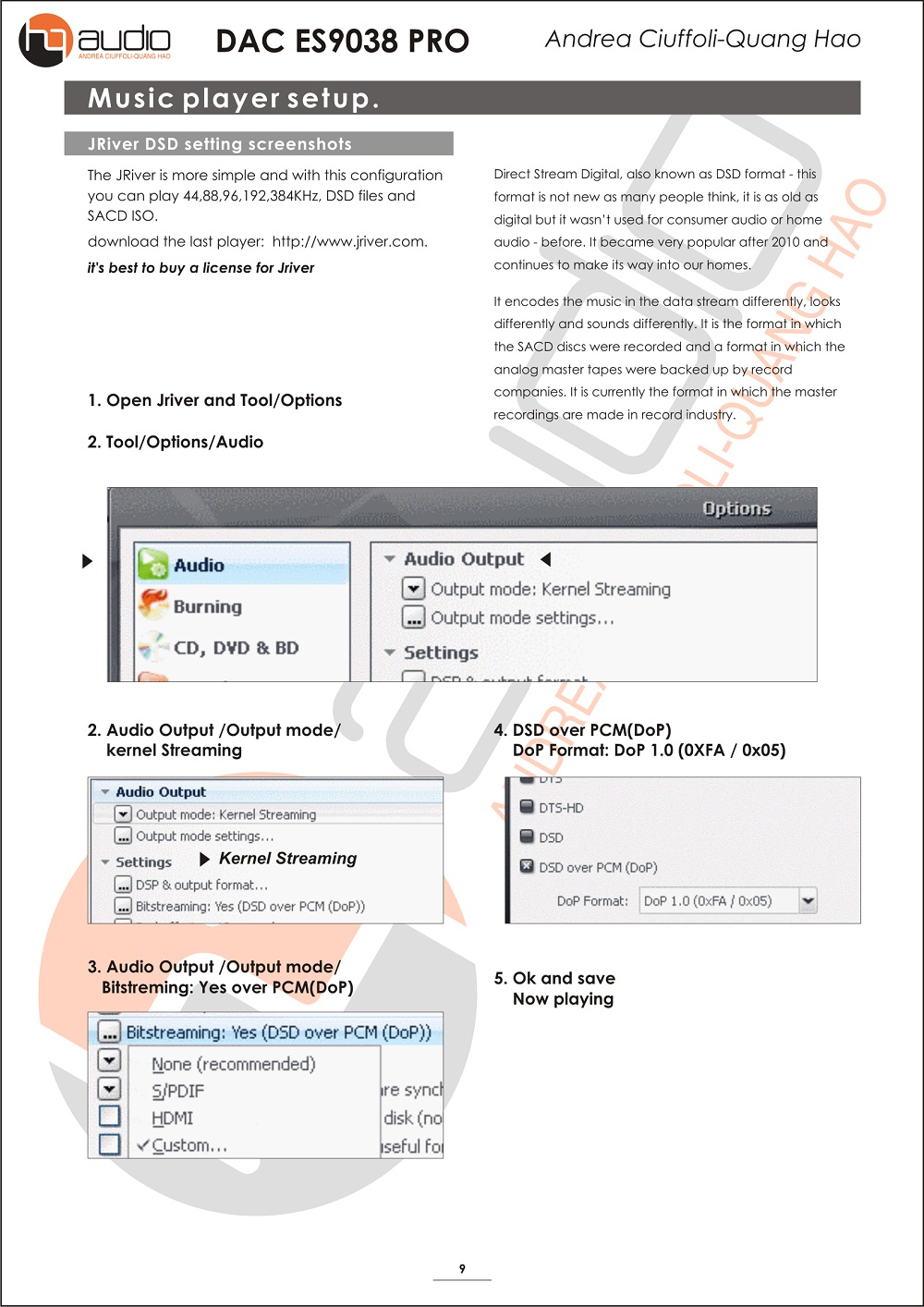

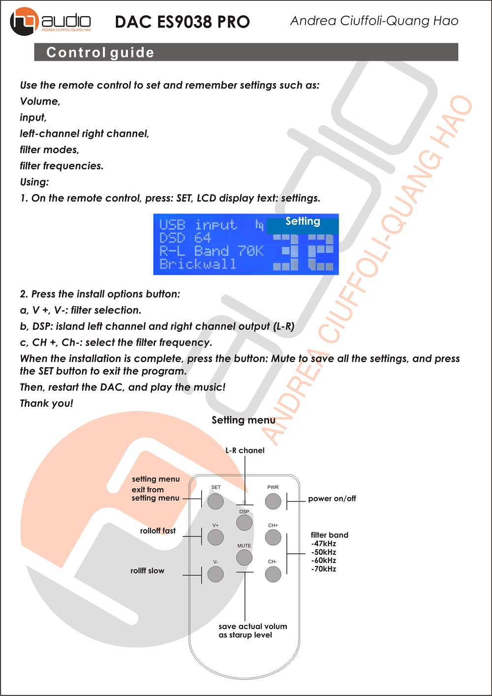

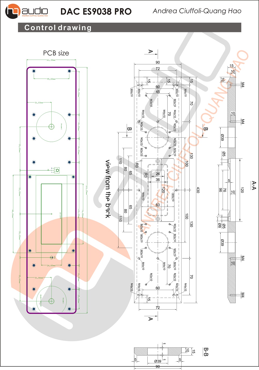

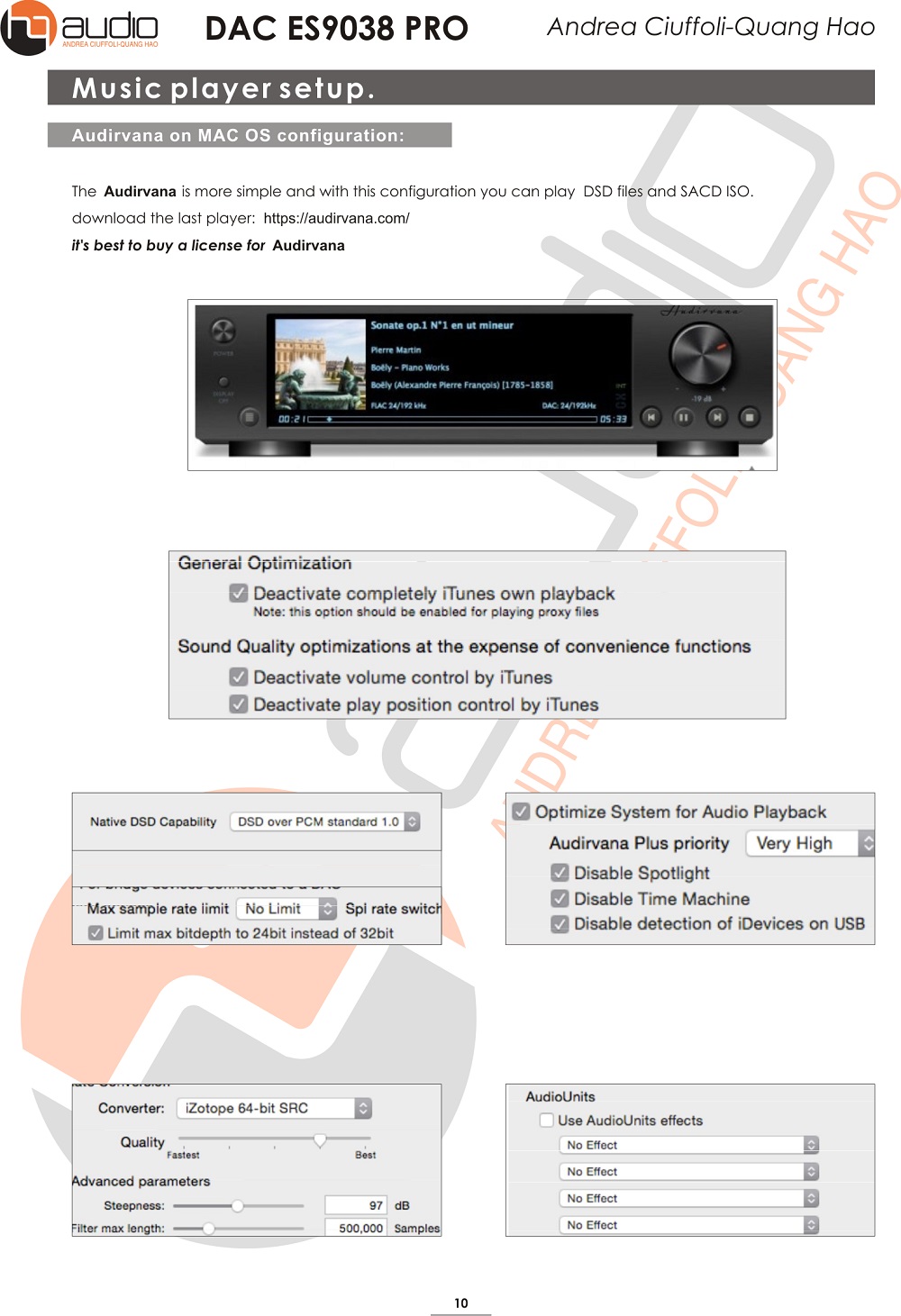

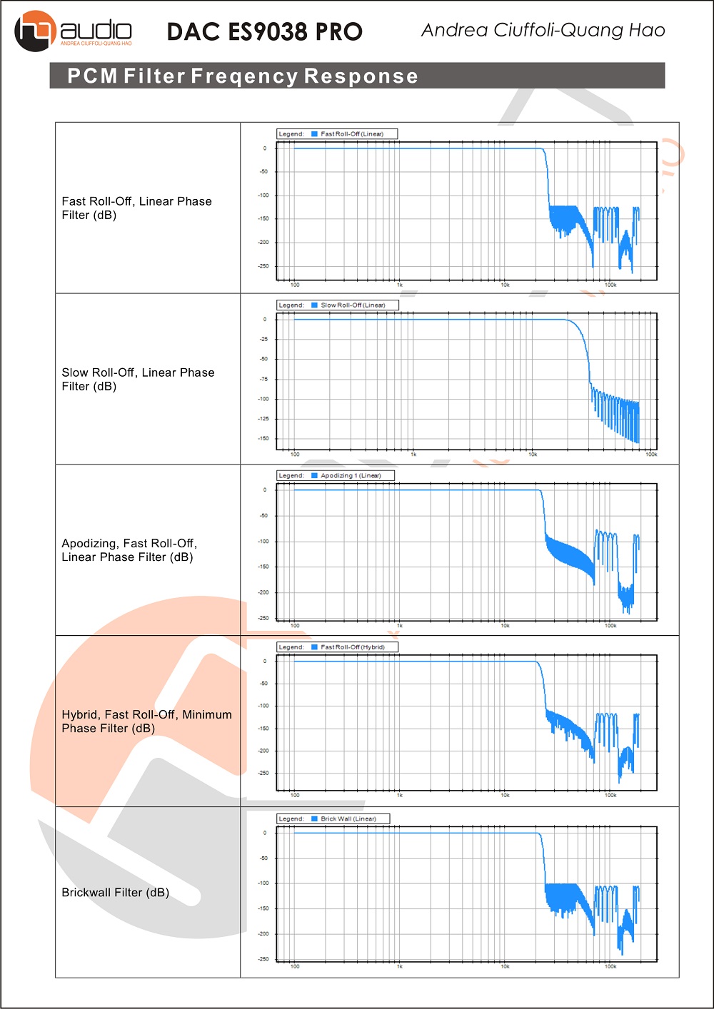

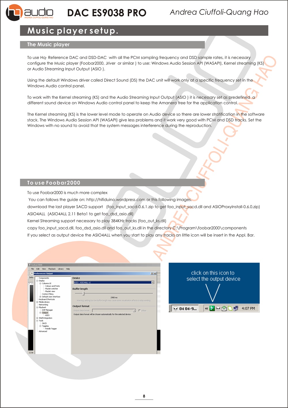

All information for Control DAC 9038PRO + setup USB
Hi all!
This all information for Control ES9038PRO DAC + setup USB Amanero
thank you very much!
quanghao
Hi all!
quanghao
Hi all!
quanghao
Thanks quanghao ,
U miss rear panel drawing
Thanks quanghao ,
yes, in the DAC guide,
thanks

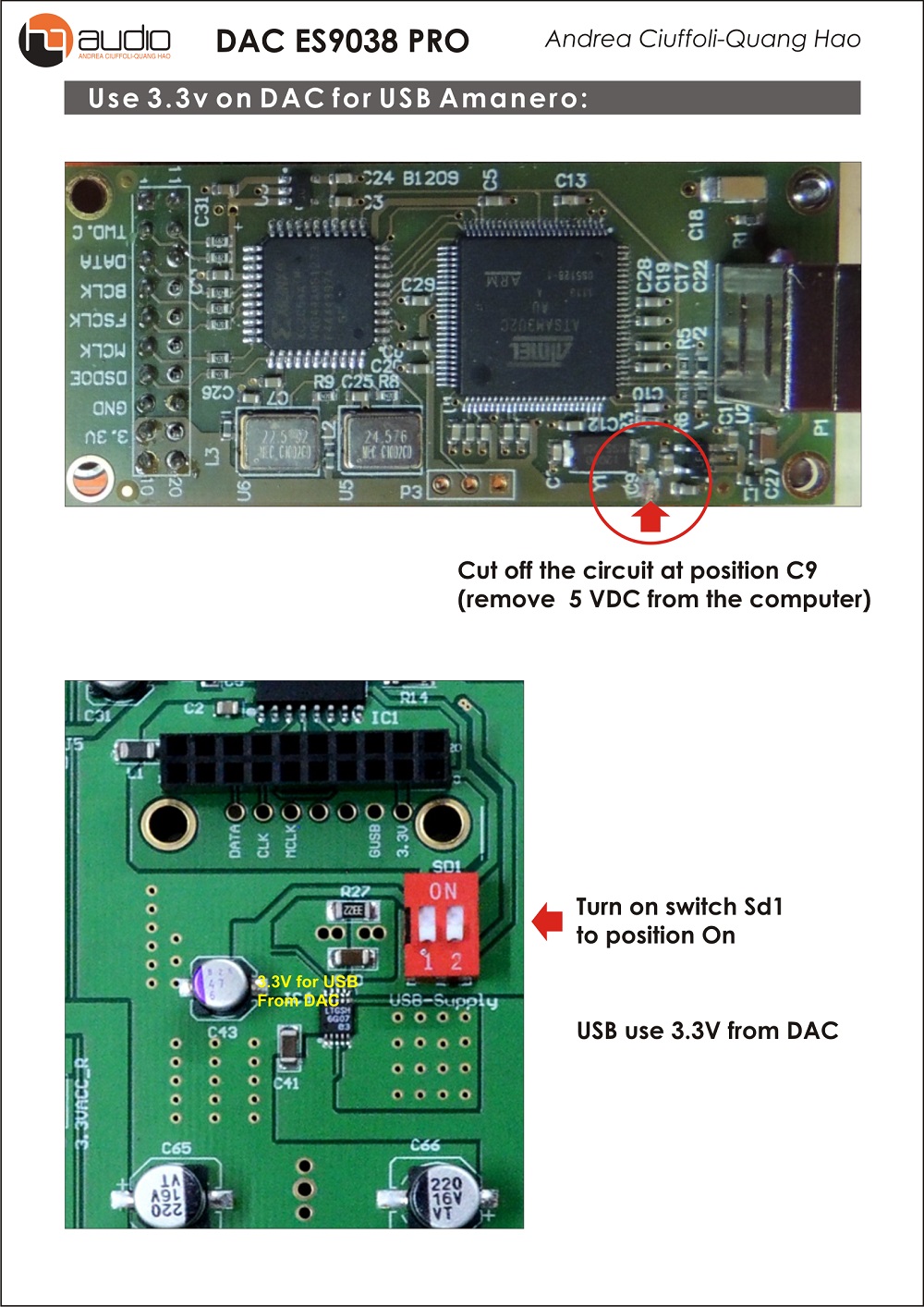

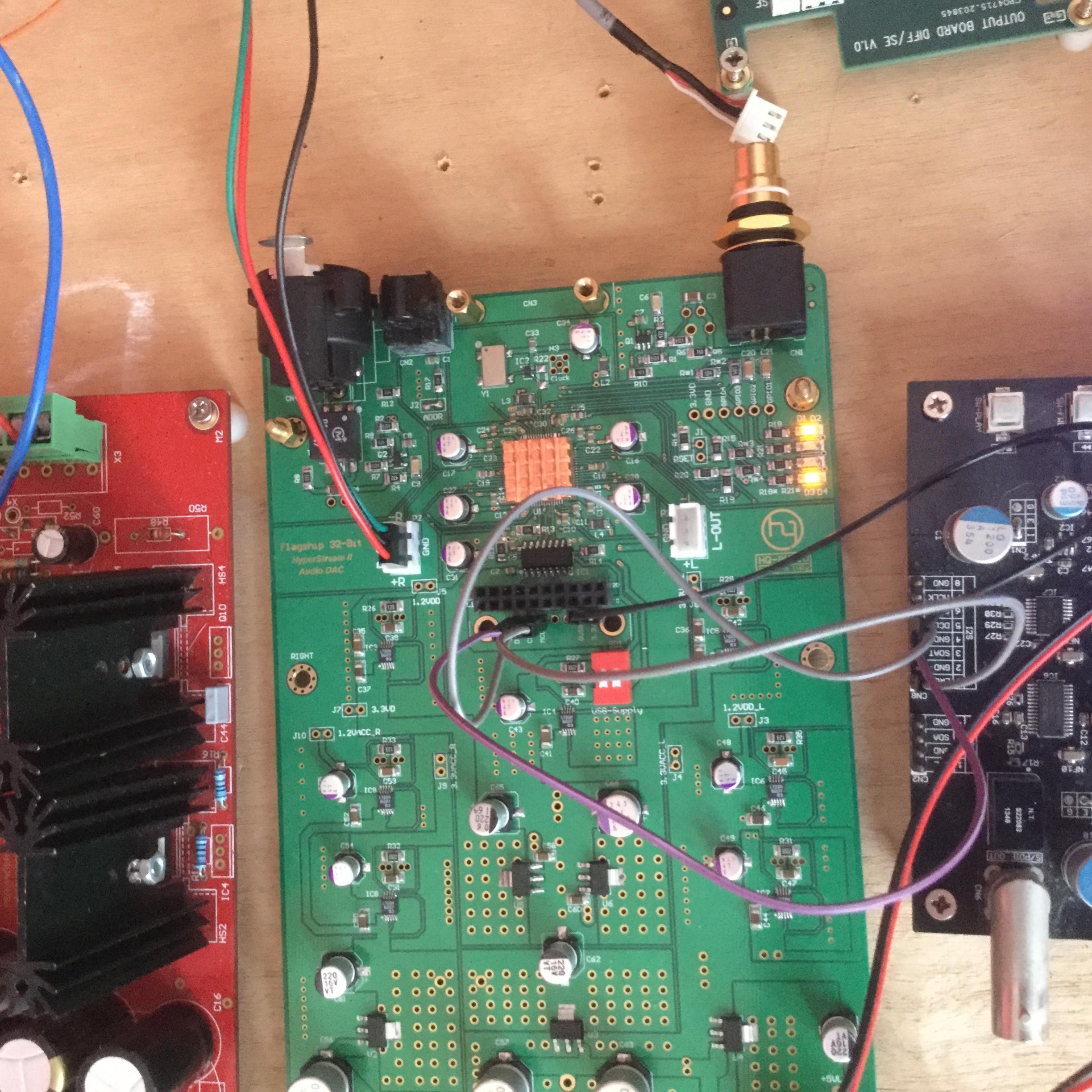

Question about using ES9038 USB Power to power Amanero
Hi Quanghao,
I want to use the LT3042 on the ES9038 board to power the Amanero card.
Do we need to un-solder anything on the Amanero card in order to use the USB bus power from the ES9038 board ?
Thanks.
Hi Quanghao,
Thanks.
Hi Quanghao,
Thanks.
Hi akltam and all!
this for use 3.3v from DAC with LT3042
thank
Hi akltam and all!
thank
Hi Quanghao and All,
I just used the USB power with LT3042 from the ES9038 board to power the Amanero card by cutting off the 3.3V regulated supply.
Before that I use the AQVOX USB power to power the Amanero card.
I can tell you that the LT3042 from the ES9038 board is a step up compare to before where I have an external power supply to the Amanero card.
Highly recommended to use the USB power from the ES9038 board.
(for your information, I also have an Intona USB isolator between the computer and the Amanero card).
[QUOTE=akltam!
If you use 3.3v form DAC.
so you can not have isolator Amanero with computer!
thanks
thanks
thanks
I am using it right now and no problem. And the LT3042 is powering the Amanero.
what sound ?
it is better ?
thanks
what sound ?
it is better ?
thanks
Yes, it is better. It sound more musical and sound more 3D.

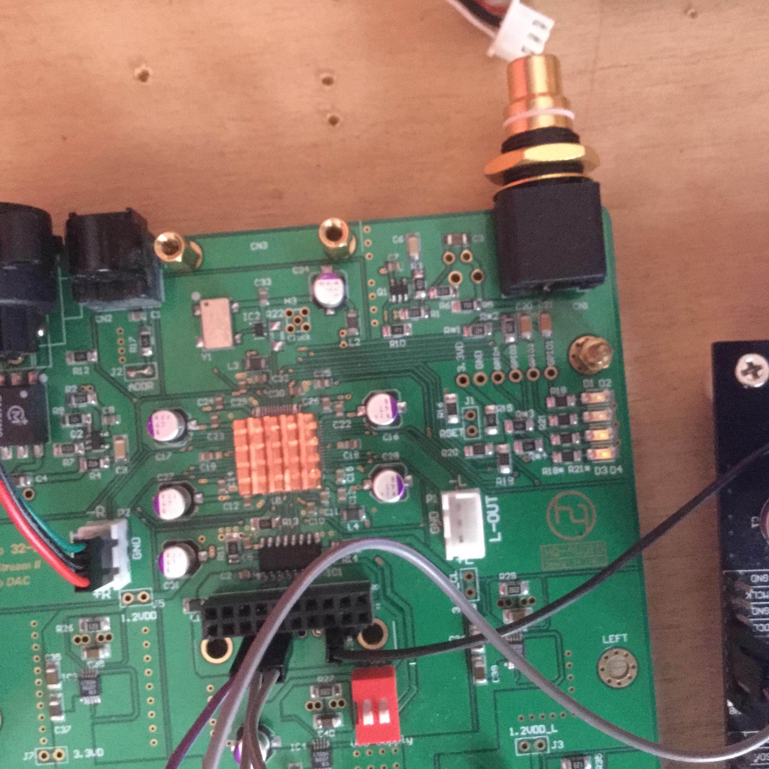

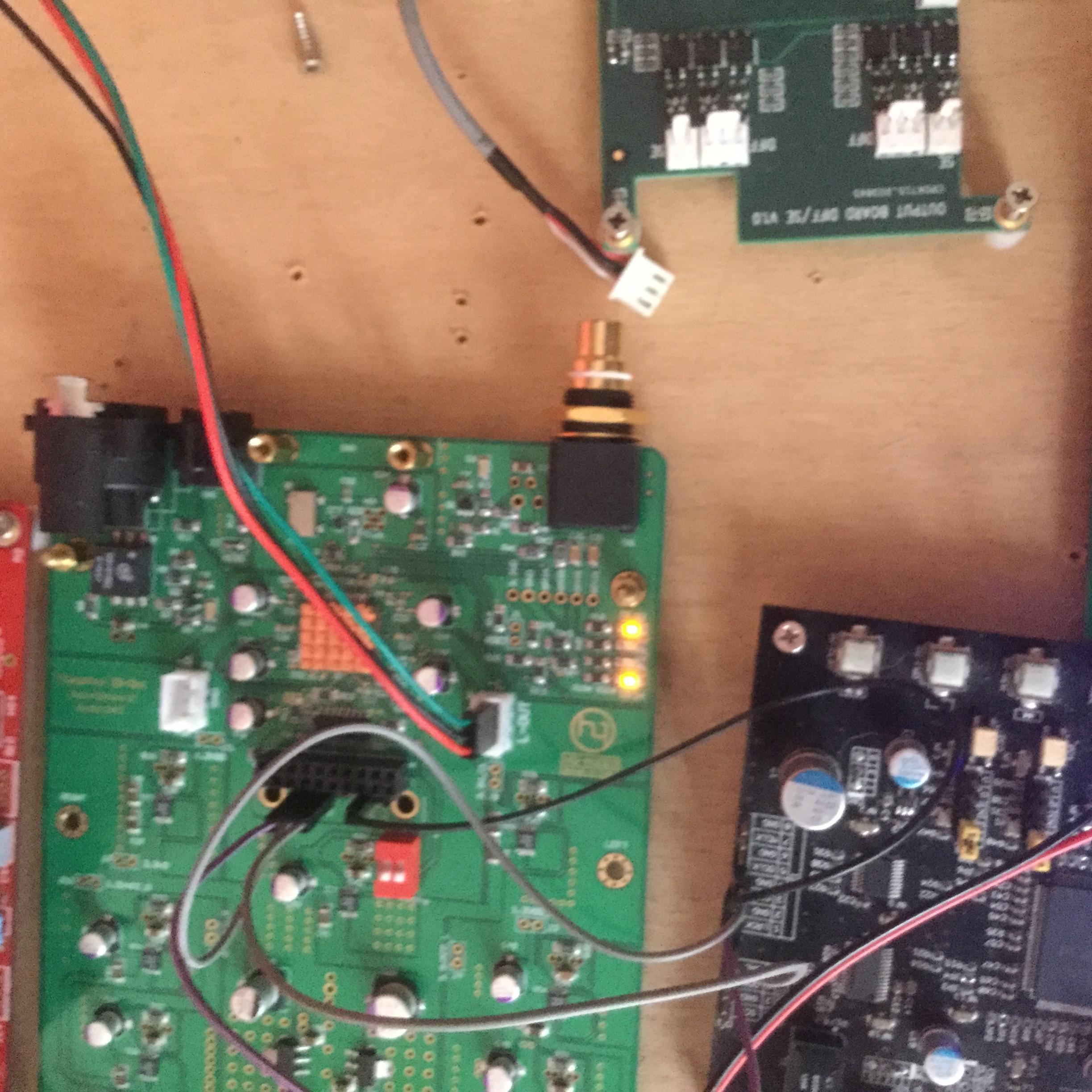

Right Chanel
Hi Myint67,
Have you tried the Coaxial input ? Is the unstable problem only happening to the USB input ?
Right Chanel
Now you need to reset the chip.
1. turn on DAC then connect J1,
2. Turn off the DAC, remove J1. And turn on the DAC source again.
thanks
Hi Myint67,
Hi quanghao
USB input
