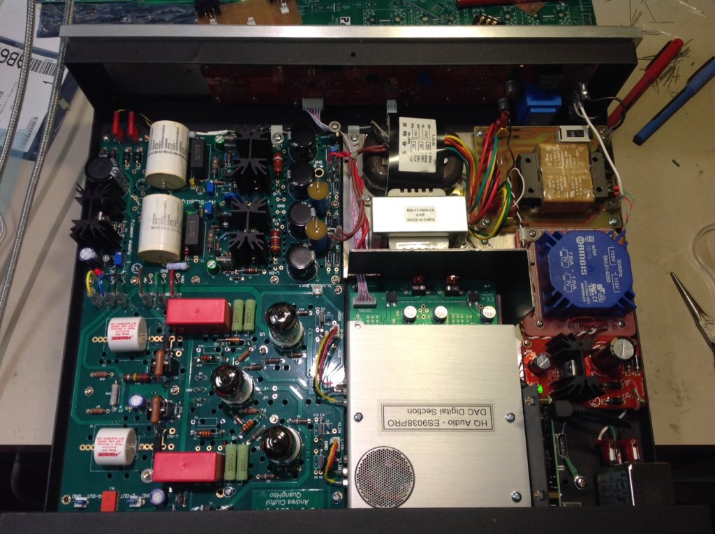

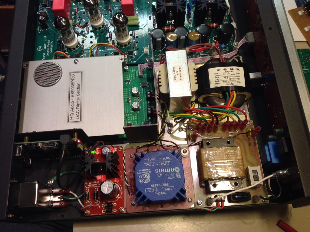

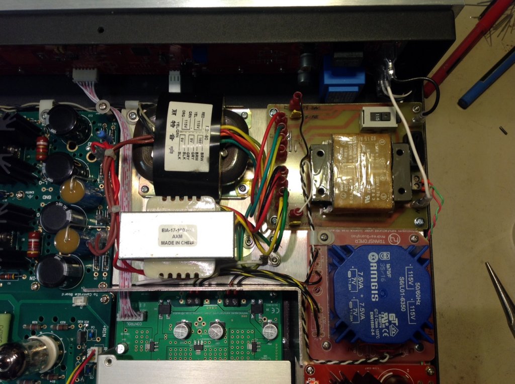

""" Finally the DAC is signing Here the pictures. I had to make a lot of mods on the inside to install the needed power transformers 115/230V compatible, and have provision for this primary voltage selection. I had one transformer for B+/FIL (T1), one for B- (T2), one for the DAC (T3) and finally one for the High current discrete 5V supply for the Raspberry Pi3 (T4). The Raspberry trasnfo PCB has the necessary AC primary voltage distribution and 115/230V selection switch for T1 & T2. I used a nice pcb from HQ Audio for the Rasberry 5V regulator. It uses the LT3042 High current low noise smd IC, with an D45H11 current booster. Worked like a charm
I had also to replace the front controller 230V transformer by an other one with 115/230V primary. Simple junction points allow voltage selection for this one.
I installed a shield over the DAC PCB, and the I/V current outputs go through feedthrough. An extra shield separates the DAC from the AC transformers. Don't know if it was necessary but it was easier to plan them right from the start, then to add them later. I also installed an AC Inlet module with EMI filter/switch and built-in fuse to replace the standard inlet.
The DAC is completely silent, except for a small hiss at max volume, typical tube thermal hiss probably. But it is very low and not in the way of the music.
Listening to it using the Amanero USB interface (modified to use the DAC digital supply, not the USB +5V) and JRiver. Sound is incredible with DSD output, and very nice choice of digital filter by the way, still haven't had the time to compare all of them.
Pure I/V PCB has MK132 27R current conversion resistor, Kiwame cathode resistors, Active CCS option on the output tube cathode, large MKP Wima local B+/B- filter caps (an addition I did) and Mundorf MCap EVO output coupling caps. Also the output section is already modified to accept an optional balanced output, using Lundhall Transformers.
Next thing I may try are active CCS on the tube anode, to replace the passive 33K resistors. But so far it is a great DAC
And naturally I still have to configure/try the built-in Moode Raspberry music server..."""

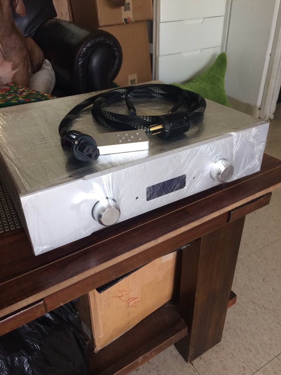

Happy New Year DIYers!
Just received my DAC!!!
It's build like a tank and weight a tone!
Unfortunate I can't test it - my Synergy are still in a processes.
Two things; quanghao you have to pay attention - you forgot to place apartment number on shipment. And second - you have to send the buyer a trucking number as soon as you make a shipment.
Thank you quanghao!

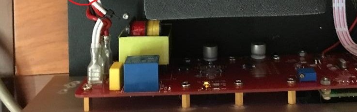

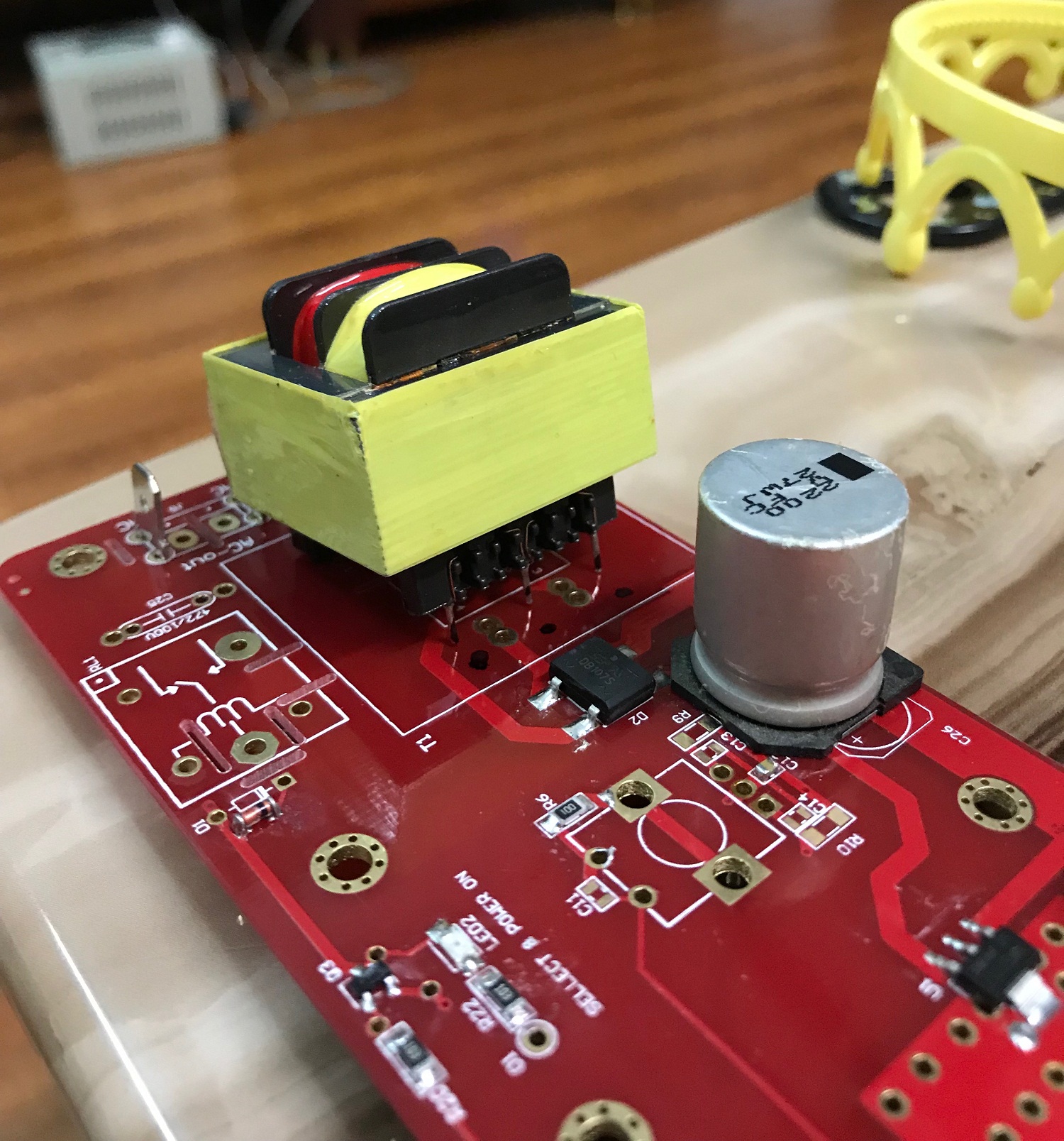

Today I started reading all the post about this Dac again and notice this statement from Algar_Finis, ooh man this is unbelievable for this kind of money paid for this dac, we in USA have to modifies this board, definitely this group buy was not meant for USA and then notice too that the boards does not fit properly on the chassis , waoo this is unbelievable, right now trying to maintain mine composure , very disappointing.

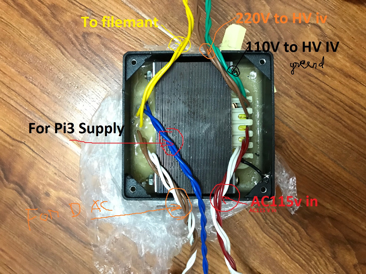

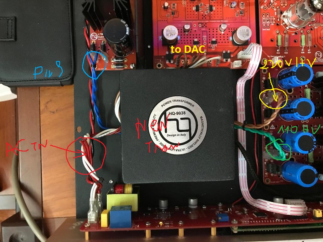

Same problem.
I have to replace that 220V trans too!
Paid additional $100 to quanghao and still waiting for new trans.
Just received my 115v trans. Very heavy and solid.
try see it for change
Same problem.
Hold on!! you bought the DAC already finish and then you have to pay for another transformer😕
Why he did not tell you or change the transformer before shipping?
Really don't understand.
I have a new 110 VAC transformer for a few weeks. I did not have them before!

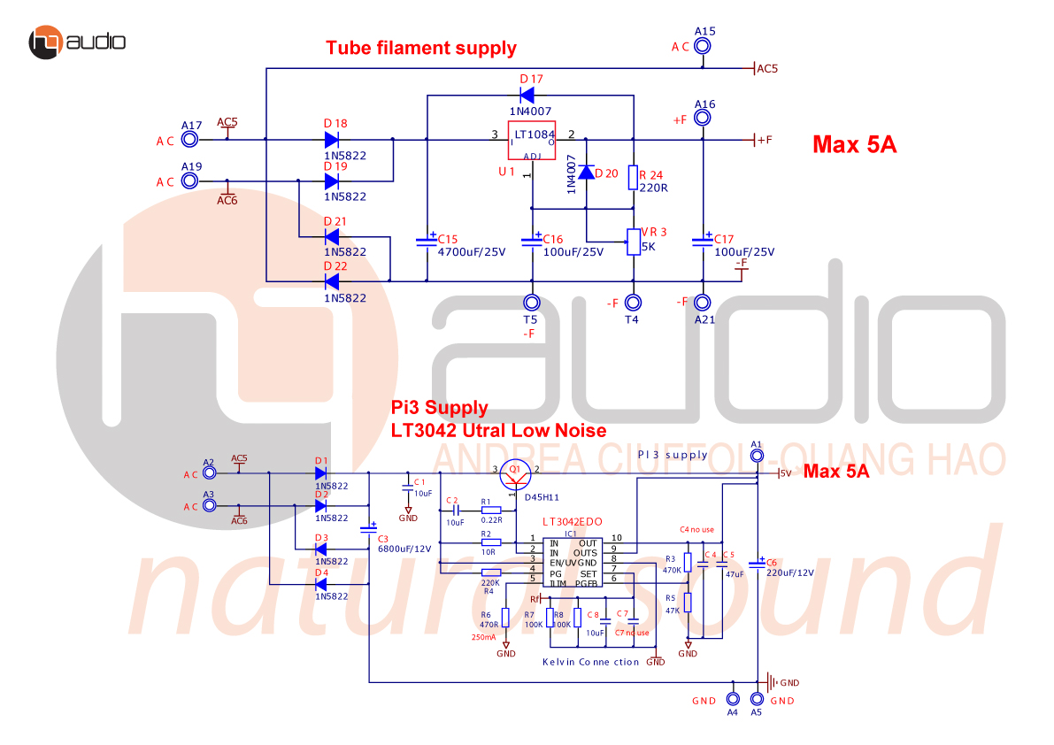

Hello QH, can this one work for the PI3 power supply, I did order LT3045 instead of LT3042.
LT3045EDD#PBF Linear Technology/Analog Devices | Integrated Circuits (ICs) | DigiKey
Thanks.
Thanks.

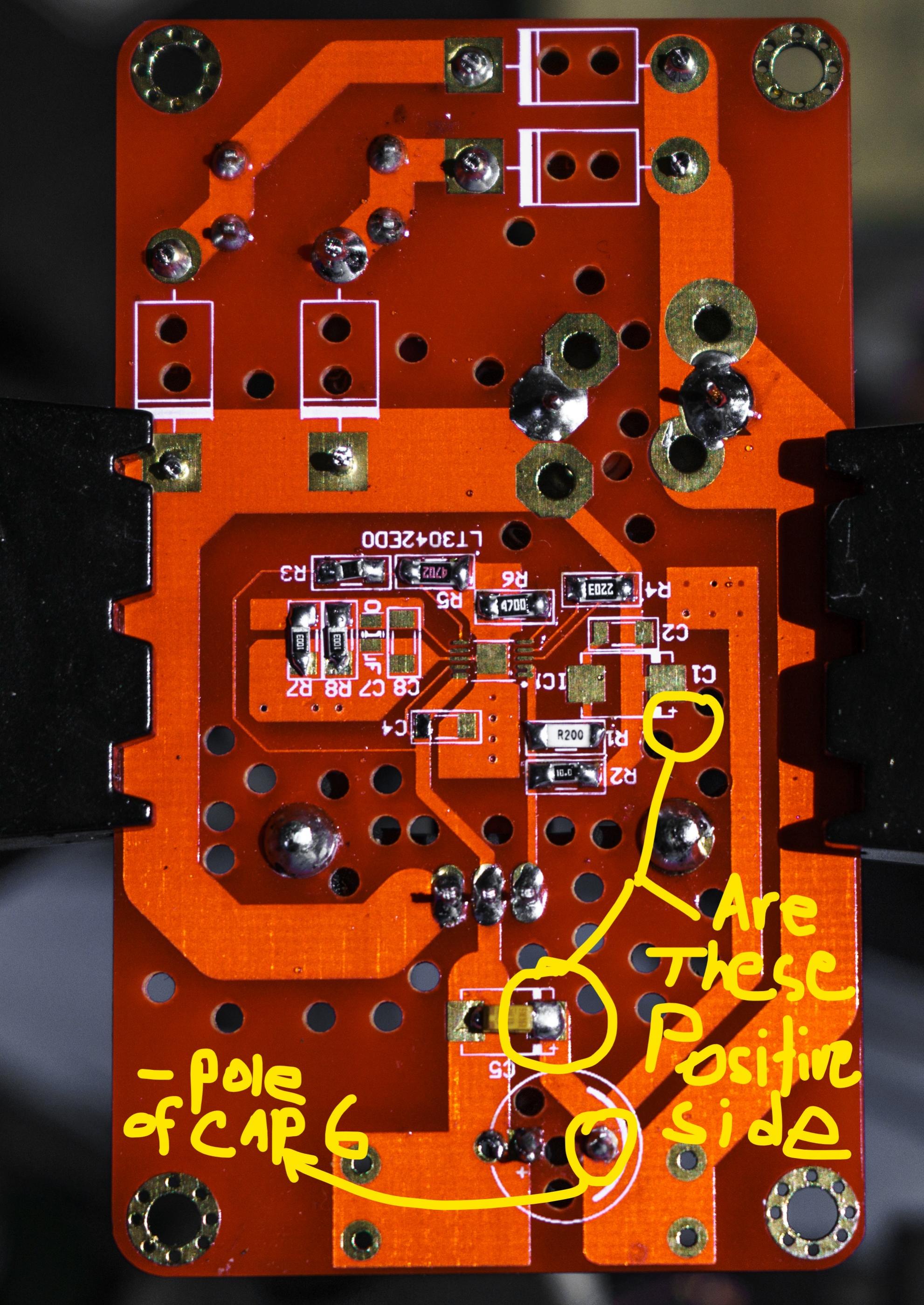

I started soldering caps on the PI3 power supply pcb then I saw two caps have a line on top meaning they are bipolar.
Then I checked on C5 spot of PI3 power supply it is marked with a line on the + side and this side is in line with the negative side or ground of C6 but if you look at the schematic + side of C6 and C5 is in line with pin #2 od D45H11, C4 and pin #10 of LT3042.
In the picture I marked you can see that C1 and C5 have a line and + , is this a mistake and they are really the negative side of those capacitors.
Thanks in advance.
Thanks in advance.

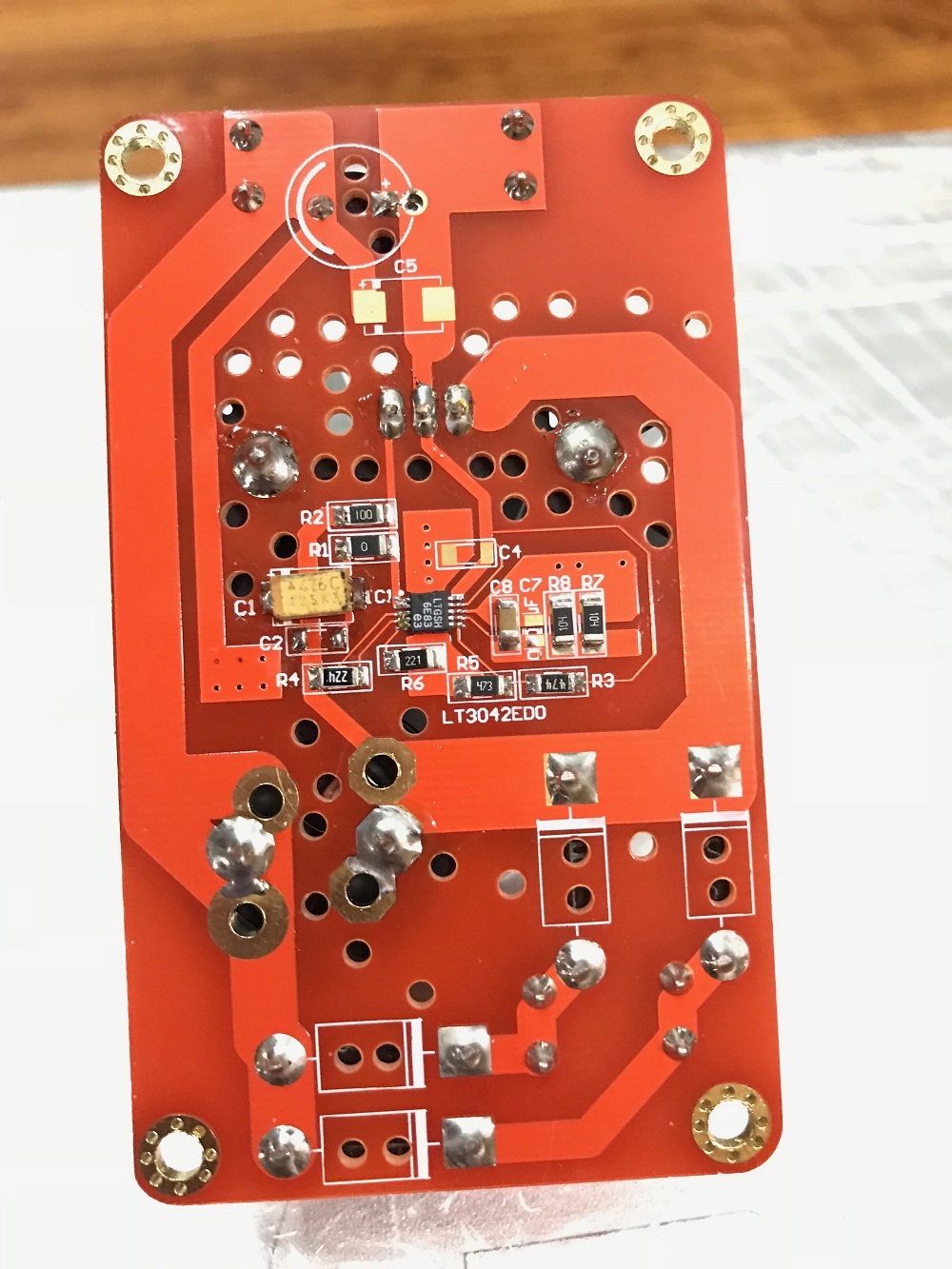

see it for best Advice!
C2 and C1 use one cap: from 10uF to 100uf /12 v min ( you can use your cap you have)
