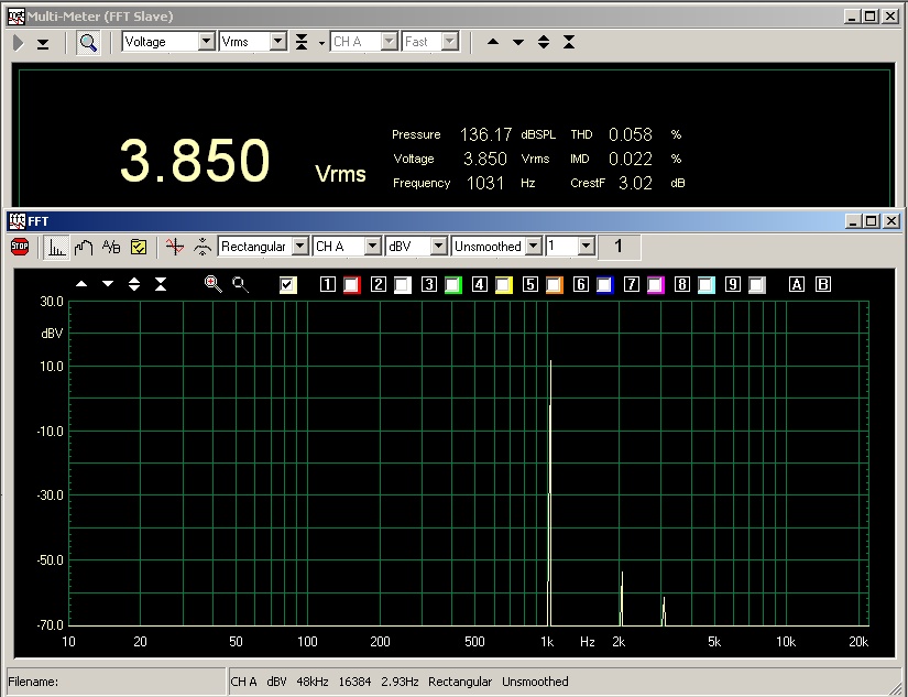

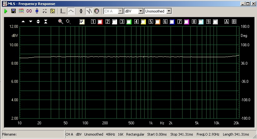

Hi All friends!
I have some new pictures of the DAC ES9038PRO
Please click on this image
Looks good! Waiting for my order.

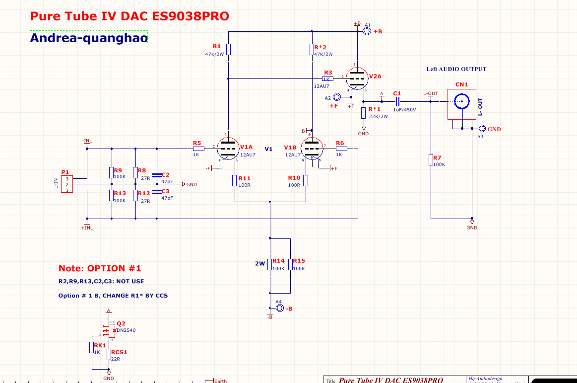

OUTPUT STAGE
For this new DAC has been develop a new pure vacuum tube output stage, this is a very simple differential stage but optimized to obtain the lowest distortion and better sound.
On this folllowing schematic many values has been changed in the final release.

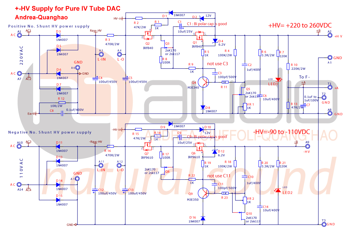

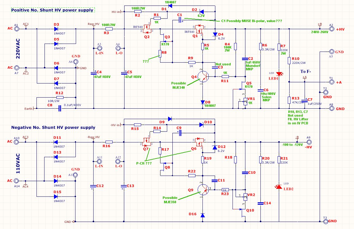

Hi. I bought the DAC with IV Tube output, and there are still some values that I don't know for the HV supply pcb from posted schematics. Check my schematic, can some one tell me what are the value for R8, Q4, C1 on the +B side and R17, C9, Q6, Q7 & Q9 on the B- side?
I assumed that the others missing part values on the B- side were the same as the B+ side.
It seems I can't get these values from Quanghao at the moment.
Also can you confirmed my findings, parts values in Green on the schematic
Any help appreciated. Thanks
