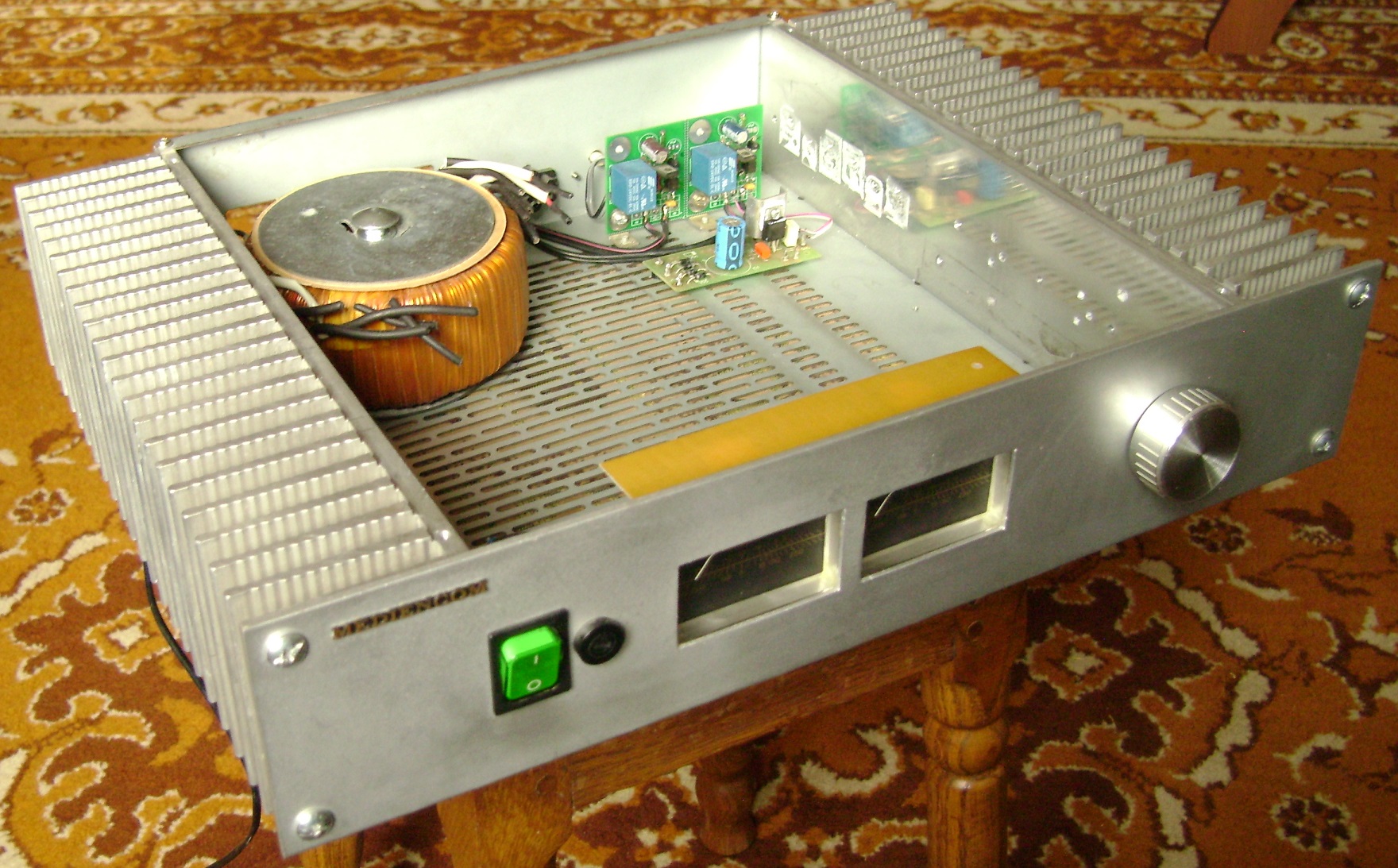

Prepared housing for the amplifier-circlotron.
Massive radiators, this is good. And already installed protection for two amplifiers.

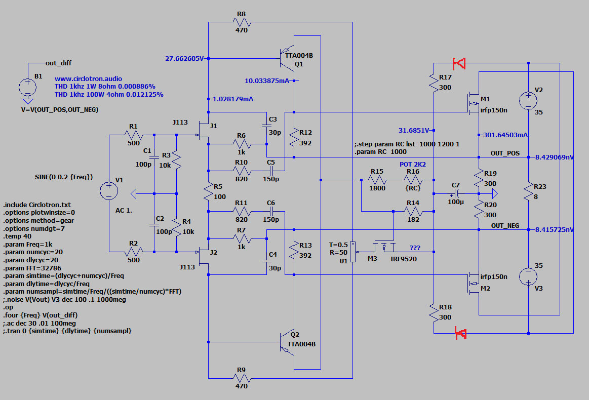

Do you think it is possible to divide + 35 V(V2, V3) into Schottky diodes?
I tried simulation a long time ago and it significantly increased the distortion
Maybe we should try in real
but you're right we should improve the preamp supply
With my circlotron amplifiers I found that adding snubbers to the main floating power supplies reduced RF noise on the supply a lot, and this made a big improvement in sound quality. I would start there. I would not add diodes as shown above, as this reduces the signal-canceling effect of summing the two supplies.

An interesting solution. I have not seen this before, and therefore I liked this circuit.With my circlotron amplifiers I found that adding snubbers to the main floating power supplies reduced RF noise on the supply a lot, and this made a big improvement in sound quality.
Thx Joe, i will try snubber

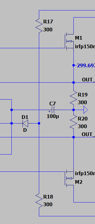

Maybe we could use one diode after summing
I've not tried it but it may help. If you try it, please let us know your results.

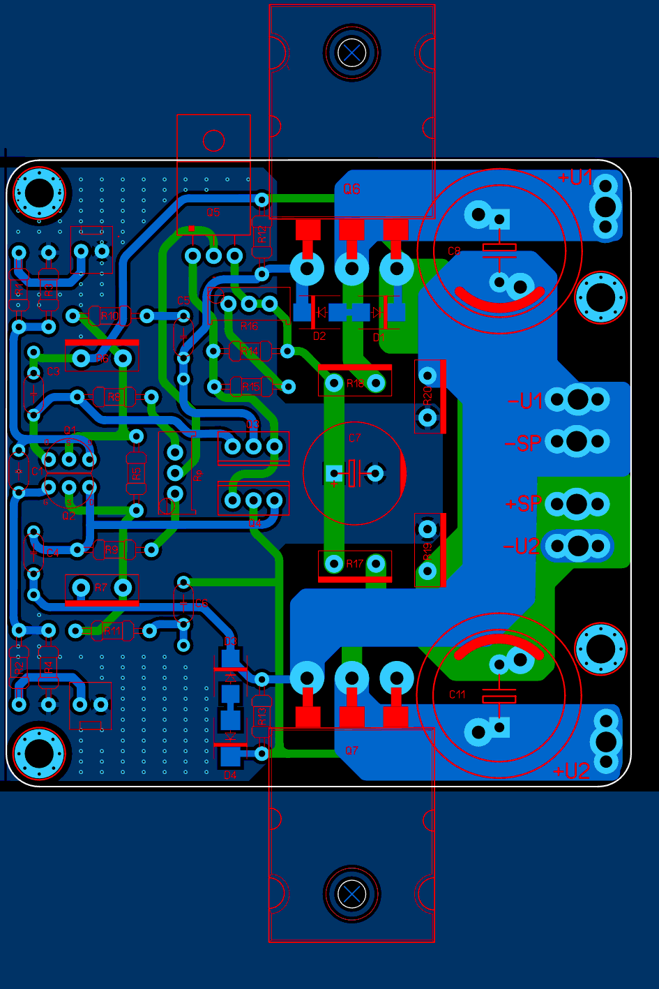

jpatay in my opinion the two input point are too far apart and you shouldn't use two ground point
Could you try to integrate the diode? with maybe a strap for shunt
I will use one ground point.
Do you want me to turn on the breadboard with the diode, as in the circuit?
https://www.diyaudio.com/forums/att...-current-feedback-mosfet-circlotron-diode-png
OK.Tomorrow I will try with one diode.
since you are doing a new pcb and you wanted to try, this is the opportunity. with a strap in parallel with the diode to remove it
