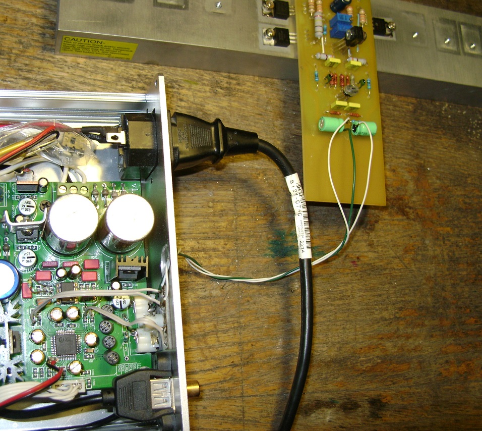

I installed BD140 temporarily. Later I will make a replacement for 2SA1538.
with the error on the PCB, my amp had no compensation and was NOT unstable 🙂 (59° phase margin without cap c3 c4)

I connected the differential output from the AK4399. (Chinese solid-state player DV-10).
Now I listen to music without a transformer.

I immediately put 33 pF. Stable current and deviation at the output of the amplifier + - 20 mV.

C5, C6 - I temporarily set 100 pF.
even with 100p the stability remains good
if there is no problem in measure, stay like this
OK.

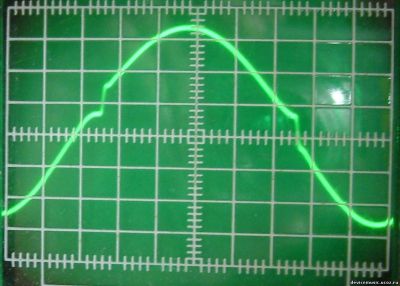

At a frequency of 50 kHz, I removed the “step” and the current turned out to be equal to 100 mA.

Sorry don't understand "removed the “step” "
but this chosen according to our heatsink
Here is such a "step".
i think in a circlotron topology, that step must not be present.
my two cents is that derive from a not ideal match between the two mosfets.
increasing current i think you can fix that. but best do a close match on the device first...
On other circuits Circlotrons assembled on bipolar transistors, the same thing happened.
The circotron is very fond of current.
Try to reduce the current and you will have the same.
