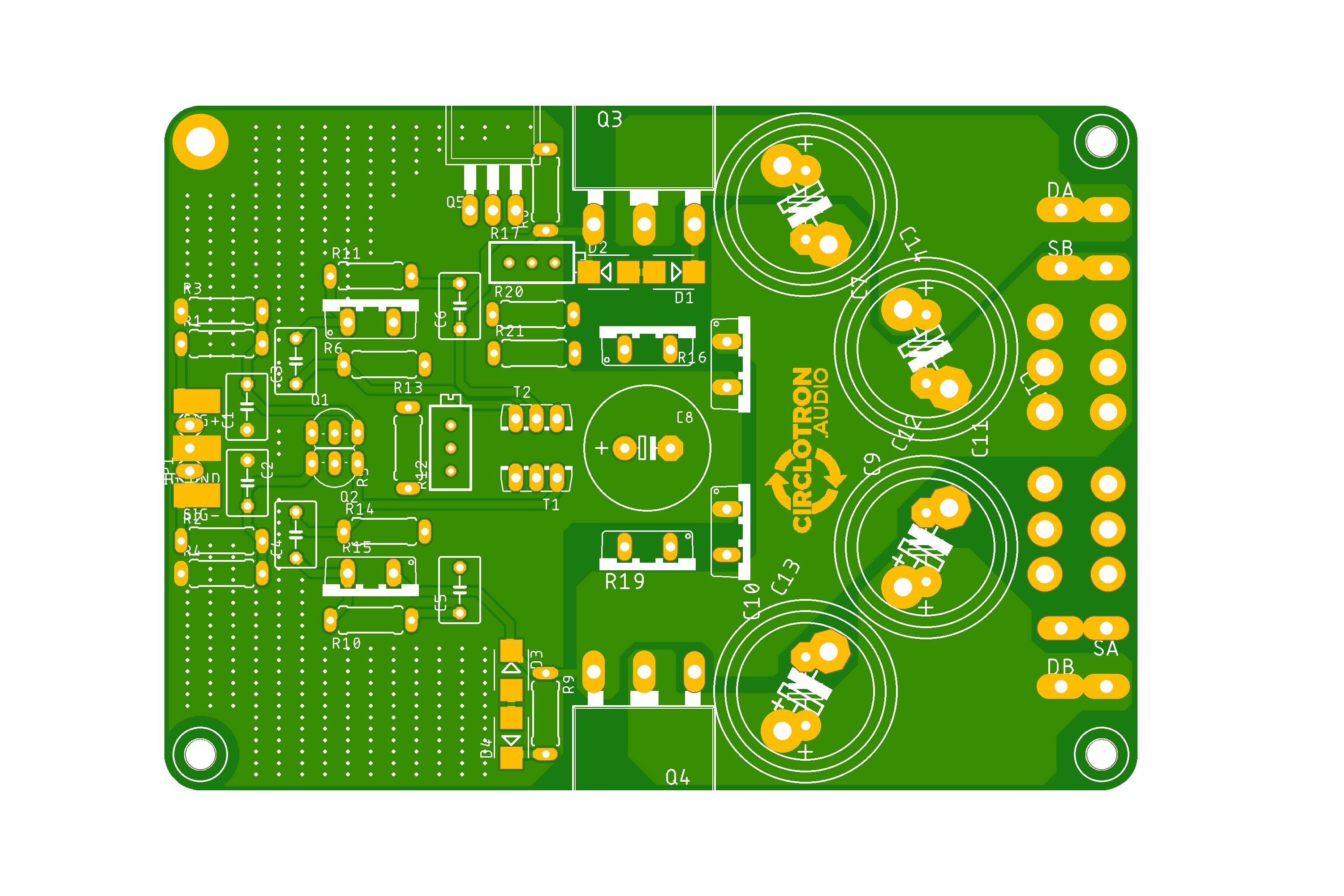

10X fqp3n30 have lower input capacitance than only one IRFP150N but better transconductance, so the result is not the same.
simulation shows in the performance of the amp, lower distortion, lower current on driver at high frequency
Yes, I've measured a few samples, actual values in this thread. Matching is pretty good out of the tube also.

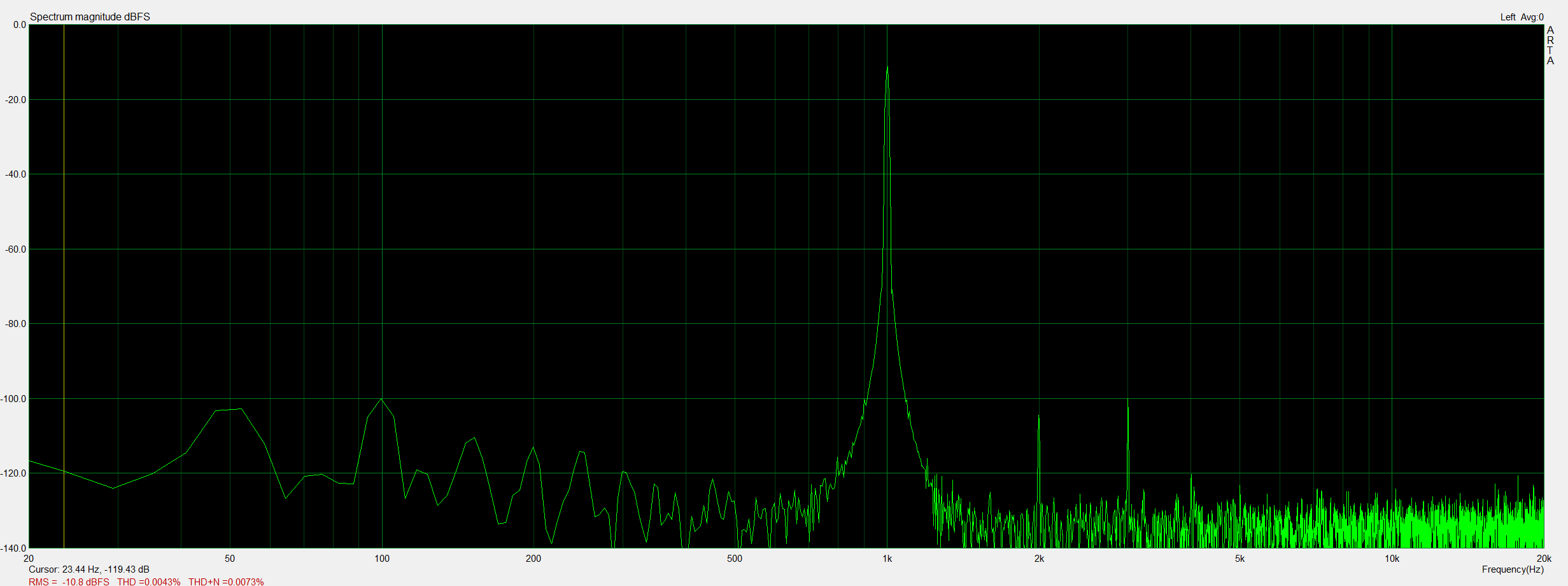

Amplifier spectra with unbalanced input connection.

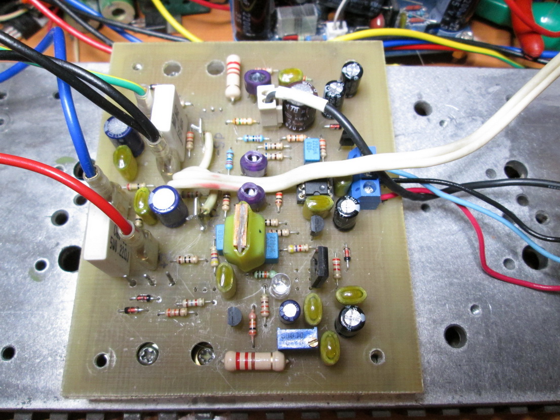

I was busy with one, and another class D.
However circumstances did now allow me to go on, but Now I can go further, things
are fine now.
The classic rover P6 did need so much attentions, but it is almost done.
This is also a circlotron without feedback, a little different.
and one with feedback, who is very low hd.
