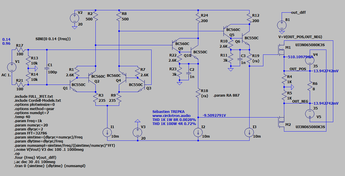

HI jpatay,
This is the amp so I spoke to you in December, but I just invert the schematic and put the Power Jfet that you proposed on your thread
with the difficulty of finding input jfets, I thought why not bipolar, so I tried to simulate this one
HI jpatay,
Yes, I remember our conversation. Good job!!!
In the circuit model, filtering each supply rail individually as shown in the attached diagram works well as an alternative to using C7 for reduced front end supply noise.
With this method, noise currents return directly to the supplies without crossing signal ground. Front end supply voltage is reduced slightly (3V in this example), but apparently not enough to affect performance.

I see a different result in my model, but we may be measuring differently. In my case I add two in-phase sine voltage sources, one in series with each supply voltage source. My assumption is that the noise of greatest concern is mostly the same on each supply. For this type of noise, higher C values give lower noise across the output.
Just a simulation test but good performance without global feedback

I would like to try with a pair of IXXN110N65C4H1 IGBTs. Spice models are available from IXYS. The IGBT have much lower input capacitance than an equivalent full mosfet.
If it's possible at reasonable cost of power dispersion due to high Vge, I would like to research on a class B current dumping circlotron. Class B circlotron stage would not need temperature tracking

10X fqp3n30 have lower input capacitance than only one IRFP150N but better transconductance, so the result is not the same.
simulation shows in the performance of the amp, lower distortion, lower current on driver at high frequency
