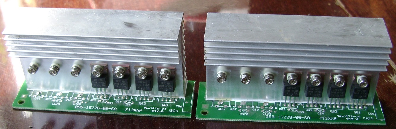

I found 8 pieces of IRF740. I put 4 + 4 at the output and measure Rout.

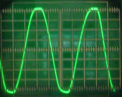

I switched the circuit to an unbalanced input. It's okay. The amplifier output has symmetrical clipping.
Later Yura will measure the harmonic spectrum, and I will listen to how the amplifier sounds after changing the circuit.

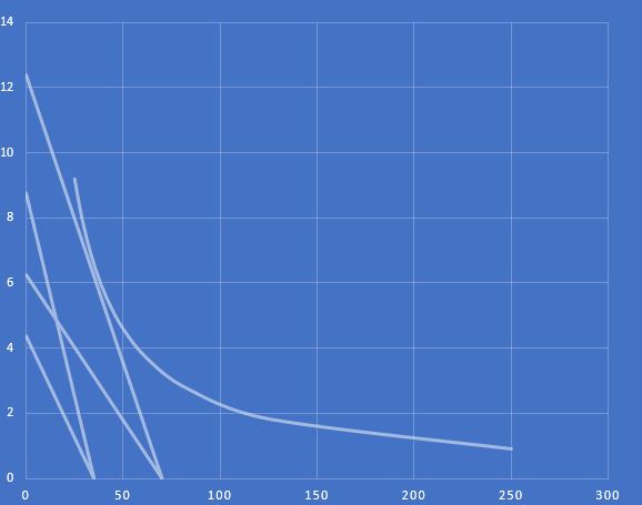

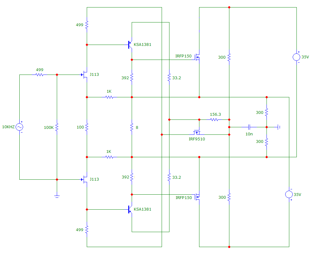

I checked the SOA of the IRFP150 in this Circlotron and it's just set to a safe limit. In the picture from the left to the right line: 8Ohms DC load, 4Ohms DC load, 8Ohms inductive load (reactance 5.6Ohms), 4Ohms inductive load (reactance 2.83Ohms). The curve is the DC SOA limit of the IRFP150 which does not intersect any load line. Cool
B+ 35V and device Max Power dissipation 230W. VDS max 100V just ok, higher would be safer.

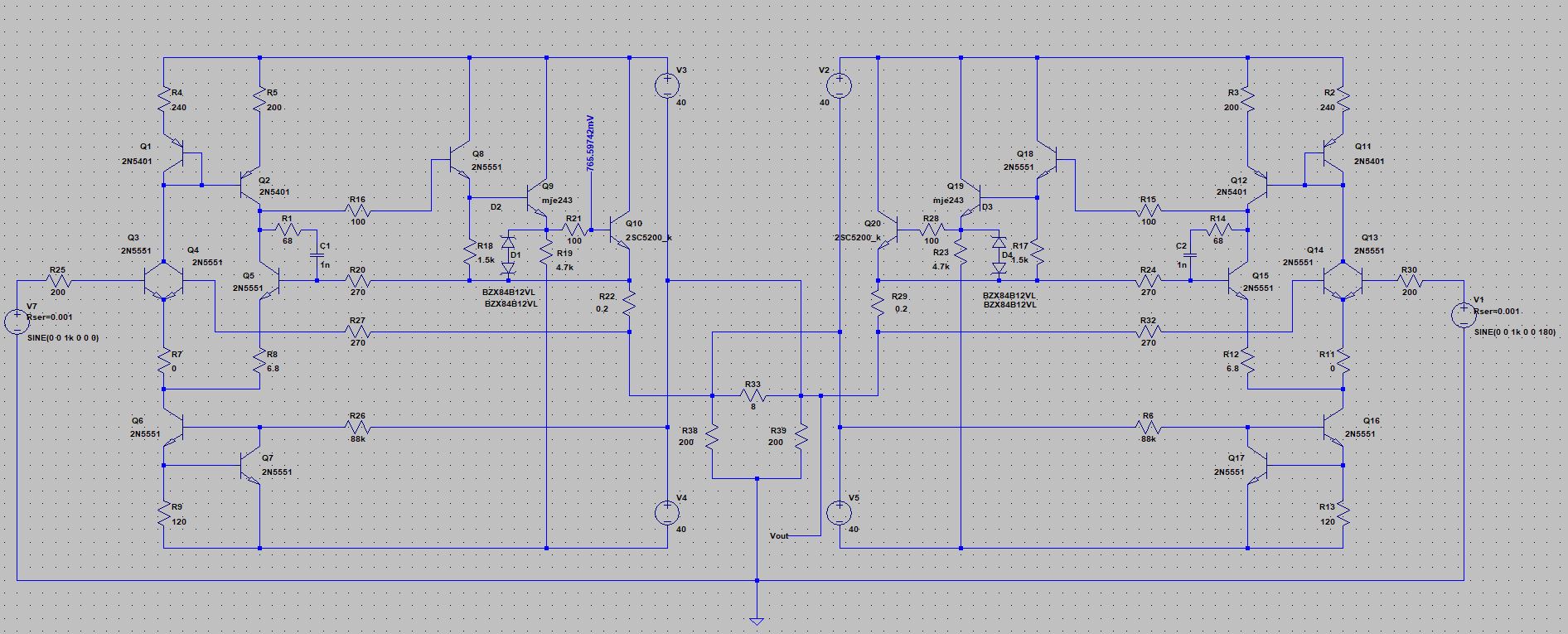

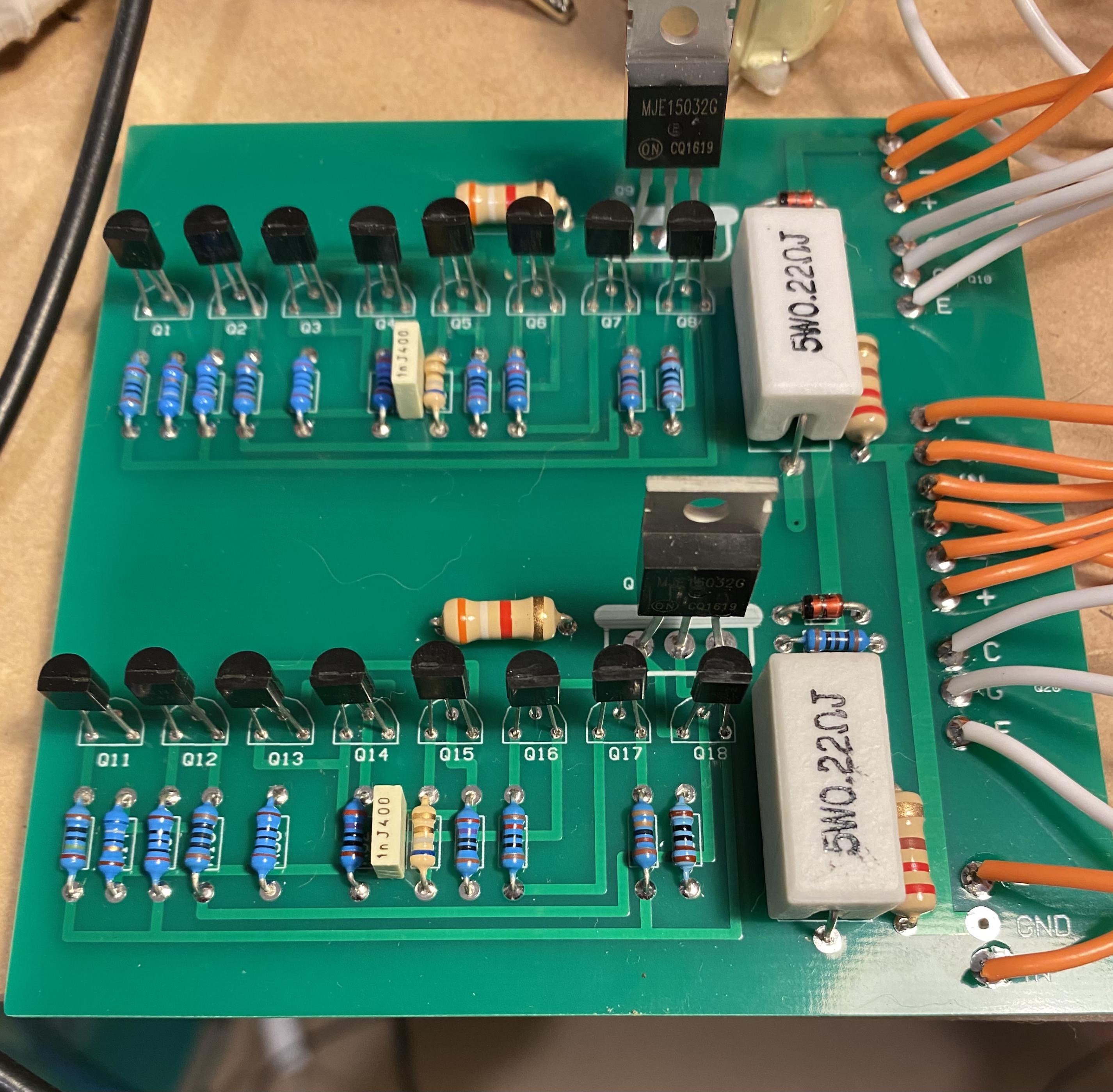

Class i Circlotron
Hello,
I attached the picture of the Class i circlotron power stage which I am willing to develop. My target is a 200W Circlotron.
Some good points:
It features auto bias where the output devices never switch off (Thorens TEM 3200) and lands to around 269ma according to the sensor resistor value of 0.2ohms. This avoid switching crossover distortion.
It does not double GM as in heavily biased power stages.
You can swap the output devices Q10 and Q20 with mosfet (enhanced) npn BJT or IGBT without changing values in the circuit.
It doesn't need thermal tracking of the output devices.
It requires low impedance drive.
I currently got it working in my lab but I need to develop it with a voltage stage.

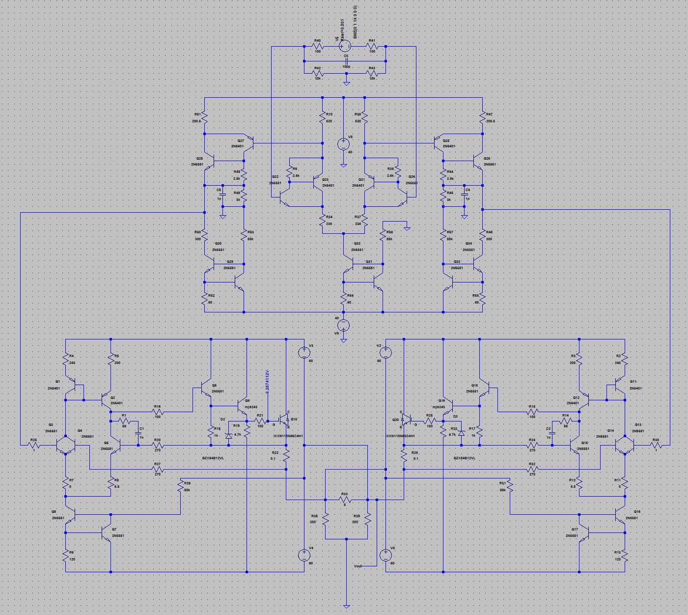

I am simulating it with your voltage stage (second picture) as an idea.
If you like the idea we could open a new thread "Class i Circlotron" but it's not necessary.

Hi apelizzo,Hello,
Some good points:
It does not double GM as in heavily biased power stages ....

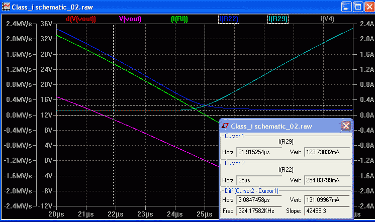

It does work well in the simulation that you posted. Thanks.
The plateau current is 124mA and the idle is 240mA. That setting pretty much eliminates the crossover distortion. Even at 20kHz (see below).
The circuit is effectively a follower. The distortion seems low enough for it to be used as a no-global-feedback amp.
The driving gain stage appears to drive into 400k ohms (50uA peak) unless I have miscalculated.
The output stage swing was clipping at 32 volts for 40V main supply so I reduced base stopper R21,R28 from 100 ohms to 10 ohms giving 36V swing which will help a bit.
At 100kHz full swing the idle current increases to 1A as cross-conduction, so an input filter on the VAS stage is needed with roll-off -3dB from about 80kHz.
The need for two floating power rails is not a major issue. The negative 40V bias supplies can be relatively easily derived from the main supplies AC.
BTW I've added missing models for my PC and modified the run commands with Freq as a parameter. Also does AC plot.
It looks a pretty good idea to me. Well done.

Hello Ian,
Thanks for testing the circuit. I am glad that it looks promising and thanks for posting the updated circuit.
Do you think I should create a new thread? I don't really want to change topic in this thread.
I just started experimenting the follower power stage on a test board and I'm trying to come up with a voltage stage without global feedback. Local feedback is ok.

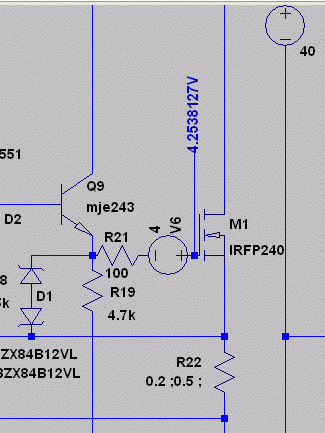

BTW MOSFET output version is attached with same idle currents. Amazing
With an IRFP240 the output swing is lower by about 3V. One idea is to add 3V-4V to the gate as shown. Maybe 2 LED's in series for 3.5V with a 100nF shunt cap and 100uA pull-down resistor to -40V (470k?).
With an IRFP240 the gate stopper is increased to 100 ohms (needed for stability when recovering from clipping).
That's a great idea as I was keen to use IGBT. The one I am trying now is the IGW30N60T just as an experiment. What I like about IGBT is their high S but probably not in our range. That's why I need to test them.
