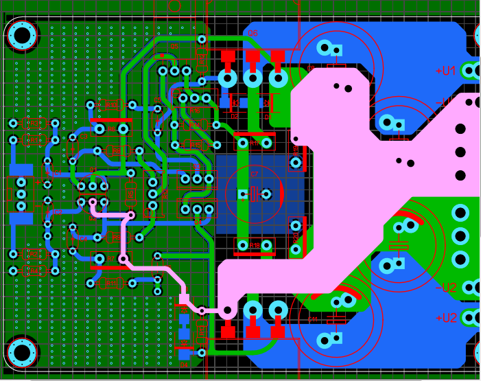

btw i just bodged the fix on the pcb... nothing major 😀
keep in mind that thoose pcb are never meant to reach the "public" in the form you are seeing now...
so can be mismatch in naming and not "optimized" stuff.
OK thanks.

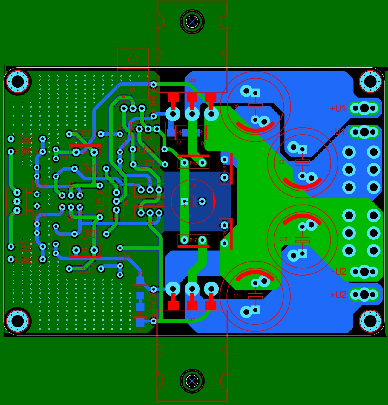

There's a esch several inconsistencies between the circuit and the PCB.
I just check and the only error is the compensation cap in wrong place, sorry
actually the names of the components are not the same between simulation and eagle
I have no experience at KadSoft Eagle, I use the simpler SprintLayout program. Translated your circuit board into this program. The numbering on the diagram corresponds to the printed circuit board.
Eagle isn't made by CadSoft anymore, was acquired by AutoDesk.
Anyway... not sure why you felt the need to redo the whole pcb... but i guess is a good thing.
on the simulation i have 30p, but it was a test, i think you should use 39p for start and lowering after
i have 47p in real and it is too high
