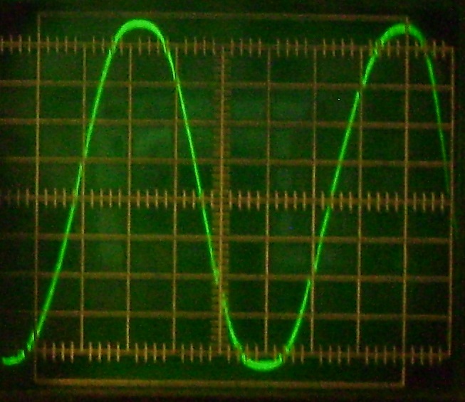

Hi Sébastien,
Changing the values of R8,R9 is a convenient way to adjust the open-loop gain of the amplifier for stability with different gain devices. I assume jpatay reduced R8,R9 for stable operation with the IRF1010E output devices.
The circuit I originally proposed here set R8,R9 = 499 ohms, but this was for a PMOS Vas. Your PNP Vas has more gain, so it may be a good idea to recheck for stability (e.g. using a 10 kHz square wave driving a 1 uF load) and adjust R8,R9 if needed.
Sébastien,
The translator translated it incorrectly, I did not understand everything.
I wrote earlier: R17, R18, R19, R20 - 270 Ohm. R8, R9 - 470 Ohm.
V2, V3 - 28.5 V. On the capacitor C7 - +26.7 V. On the emitter Q3 - 23.5 V. On the B Q3 - 22.9 V.
Today I replaced the BD140 with a BC557B (hFE - 250) and installed a small heatsink on them.Excitation at the output of the amplifier disappeared. I turned off the Zobel filter. Square impulses have not changed. Clipping symmetrical.
I will probably stop at this stage.
