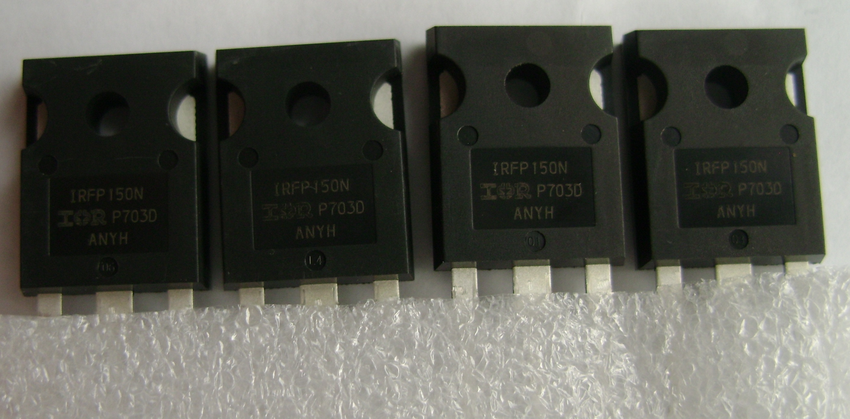

So you Found irf150n.
Yes, I found, only such IRFP150N:
if needed i have to spare.
both IR and vishays
Do you meas them ?
No, there is not much choice, only 4 pieces.
I bought the cheapest transistors.

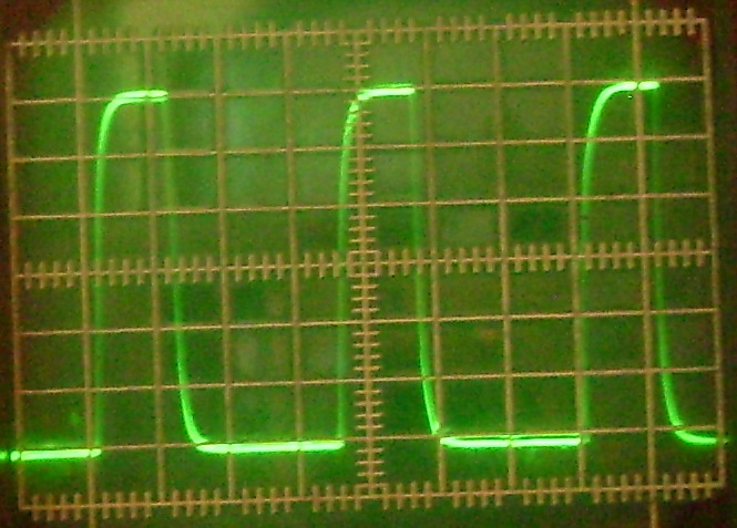

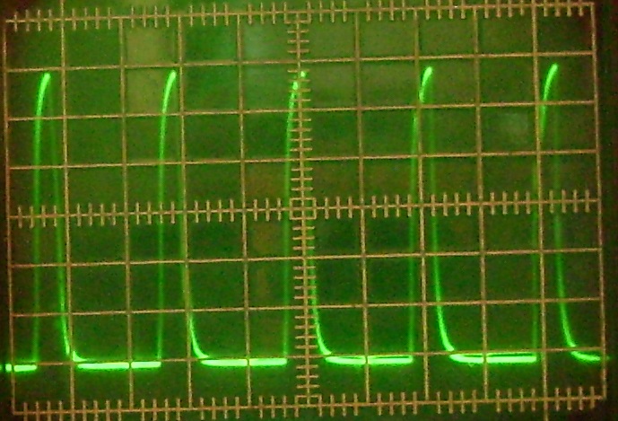

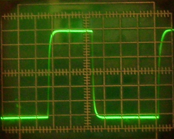

Two channels are already running on the (2SA1360) IRFP150N. C7 - 1 uF MKP Wima. 😉
1) 32 kHz; 2) 60 kHz; 3) 100 kHz.
Congratulationst, glad you like it 🙂
Seb, at a current of 120 mA, excellent sound is obtained. The radiators are cold.😉

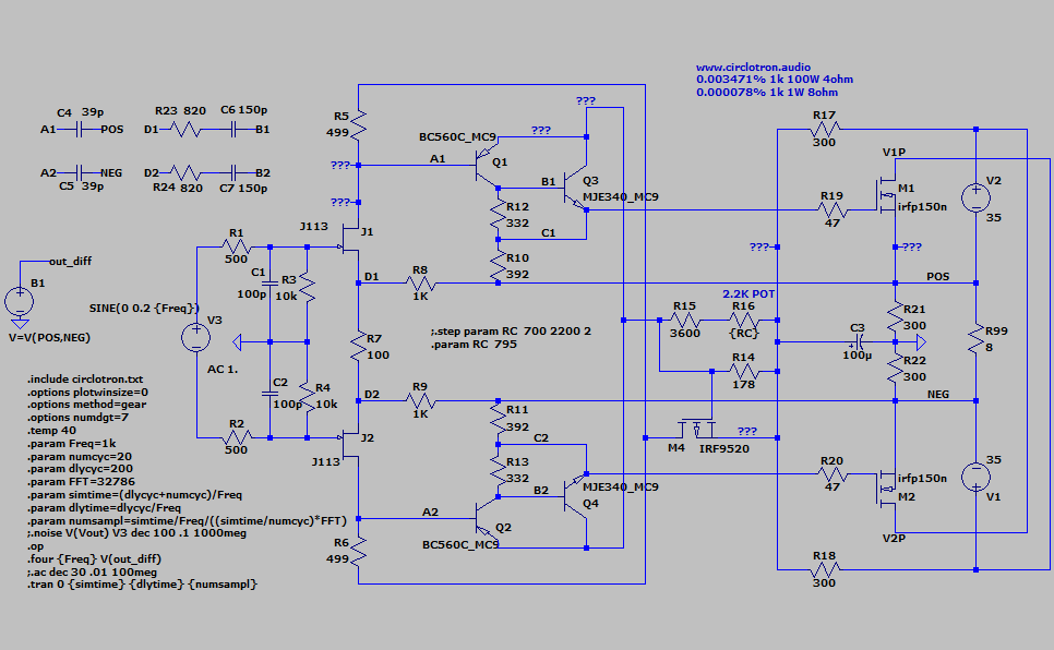

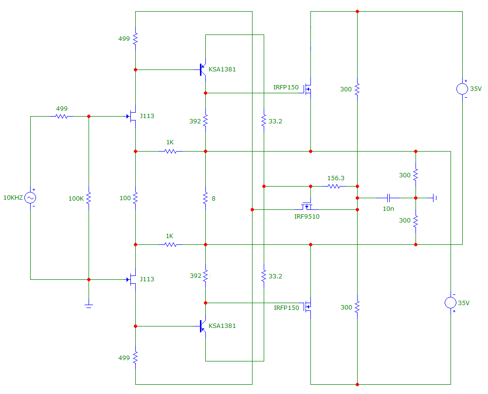

Micro-Cap 12 Sims

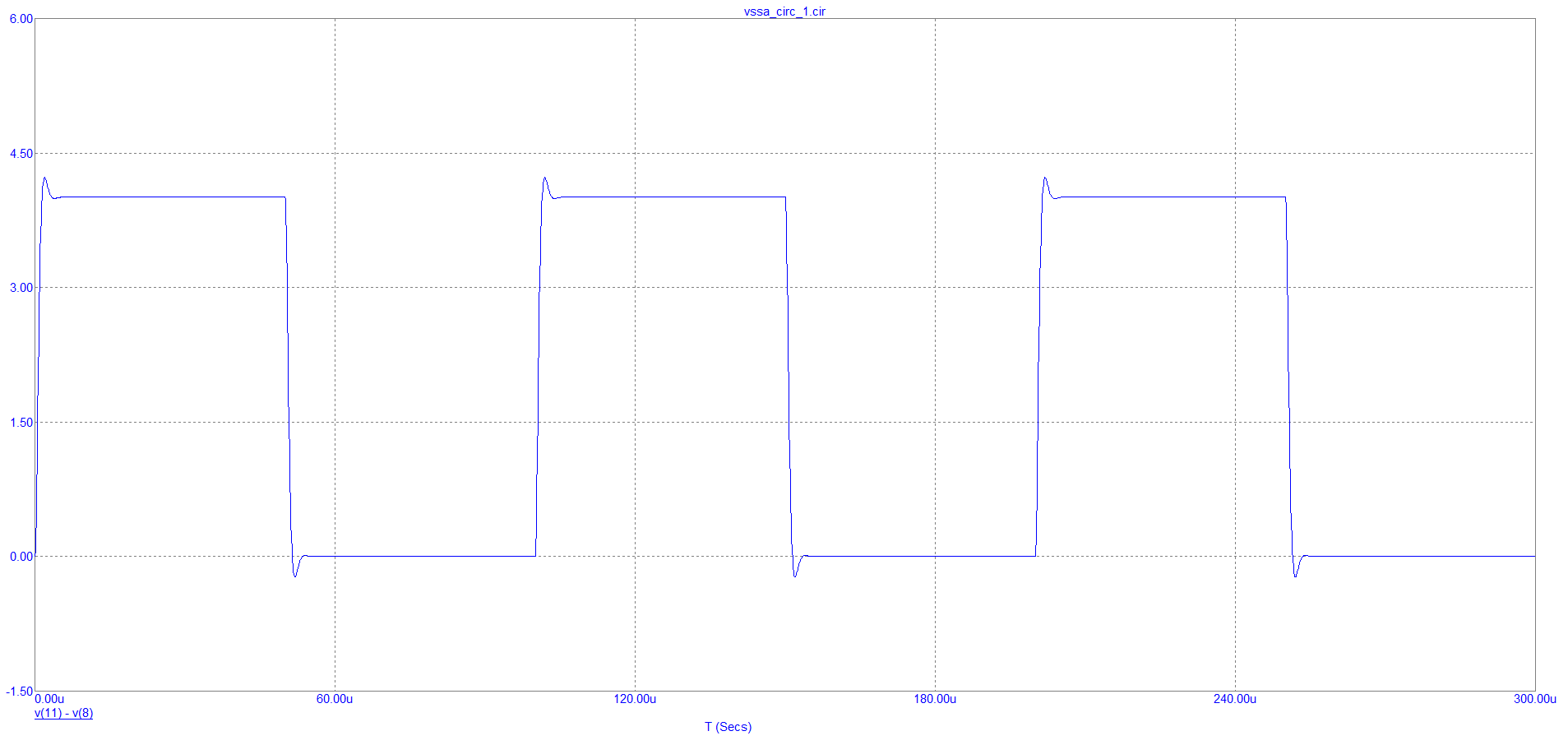

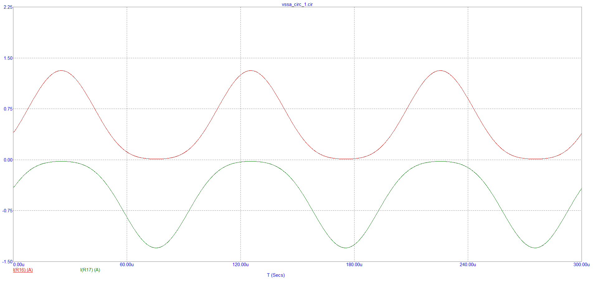

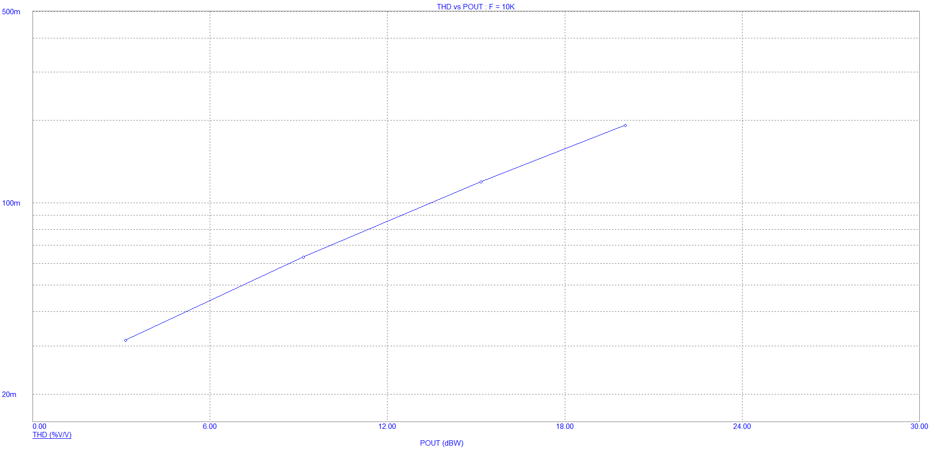

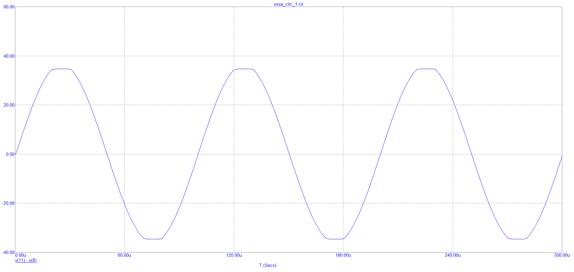

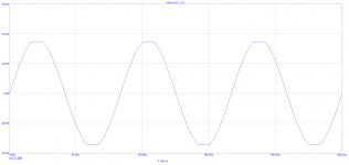

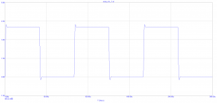

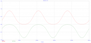

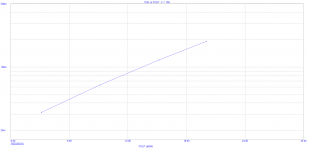

FYI, some new simulation results using Micro-Cap 12 (free download here). All results are with input stage driven unbalanced.
1. Test circuit using only Vas emitter resistors as compensation
2. 10 kHz square wave response with 1 uF in parallel with 8 ohms
3. 10 kHz clipping waveform with 1.8 V peak unbalanced input
4. Class A currents with output stage devices biased @ 400 mA
5. 10 kHz THD vs. output power (in peak dBW; 20 dBW = 50 W RMS)
In simulation, the only real difference I see when driving the input unbalanced is the presence of even harmonics (mostly H2) in the output distortion spectrum, which may or may not be audible.
I'm still new to Micro-Cap but it appears to be an excellent simulator with really good component libraries, including vacuum tubes. Interested to see how these results compare with the real circuit...

HI,
hello, thank you Joe it is true that it could be interesting to do without capacitive compensation.
i don't have too much time right now, but was planning to add an emitter follower for an update or upgrade
RAY_evolution.png is the most efficient, but the most difficult to tame, the 2nd is just a simulation that I tried thinking of a lunch break, there is no optimization
what do you think?
what do you think?

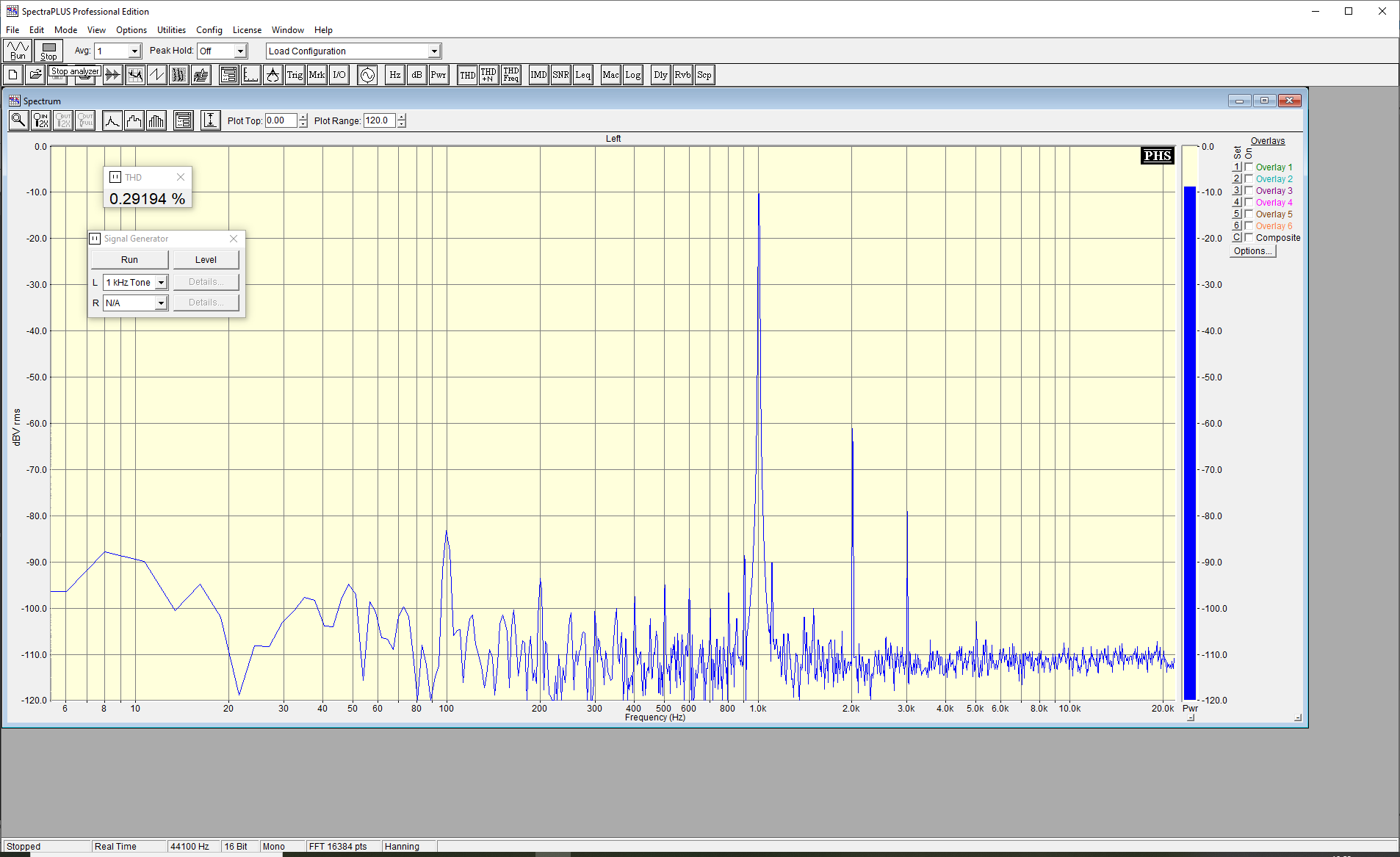

Tastes are different for everyone. Someone likes the monitor sound, and someone like a warm tube. A low distortion amplifier does not always sound better.
In the attachment, the spectrum of the amplifier is without feedback. Yes, this amplifier has increased output impedance. But if we make amplifiers on our own, why can't we make an acoustic system for our amplifier? 😉
