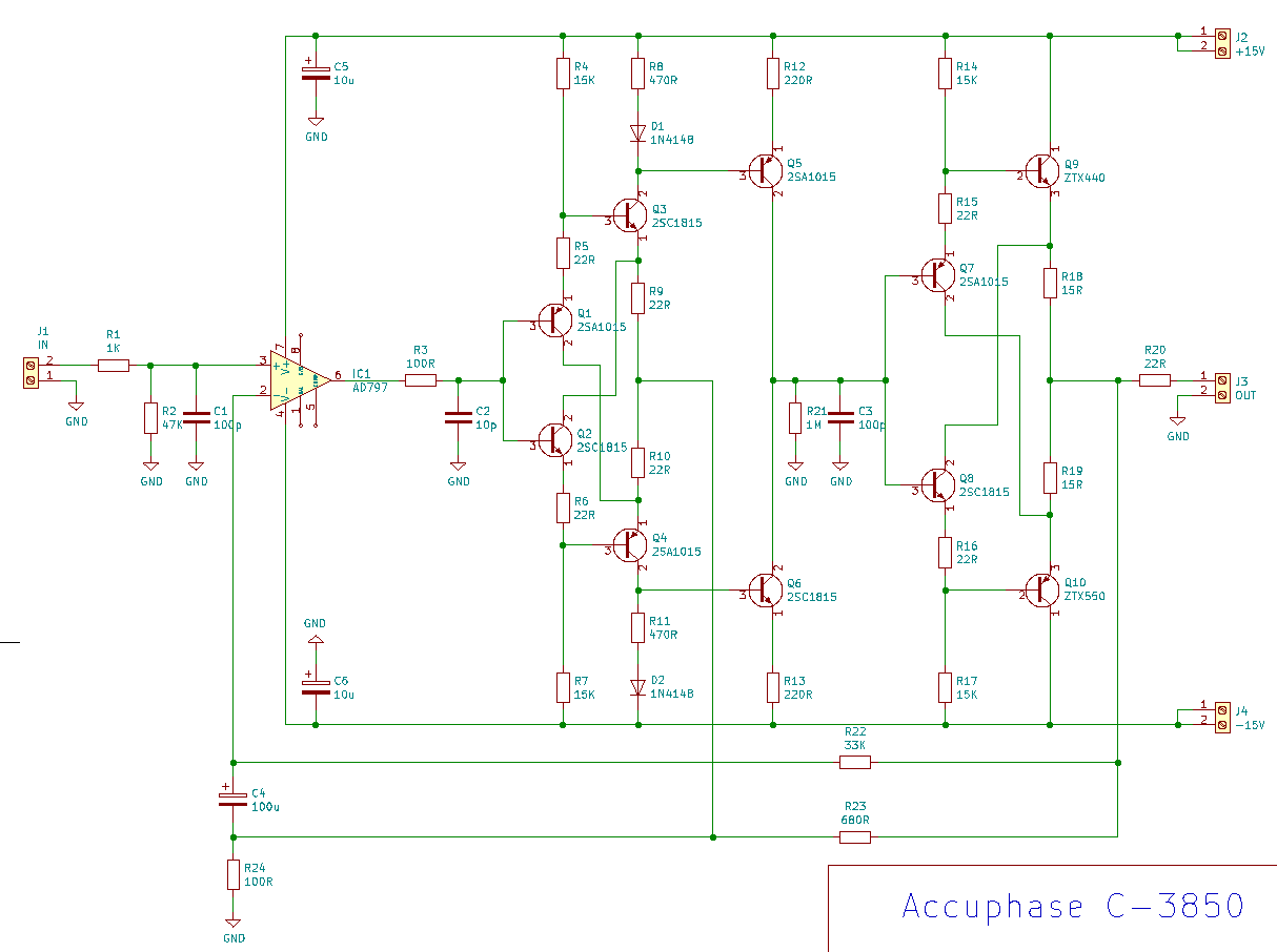

In your schematic, you changed R3 and R6 to 560R. The change should be to the feedback resistors R29, R46 instead. 560R and 22uF works out to 12.9 Hz.
You can use an online RC high pass filter calculator .

Ok....if i use a calculator i would choose 470 Ohm and 22 uf (15,39 Hz). I think i have done wrong and changed the wrong 100 ohm resistors.
Peter
Peter
I have changed the 100 Ohm to original at the opamp. Also i have changed the feedback resistors on their right place, the value of 560 Ohm remains. 😉
Now i think everything is right...long way because a wrong idea..🙂

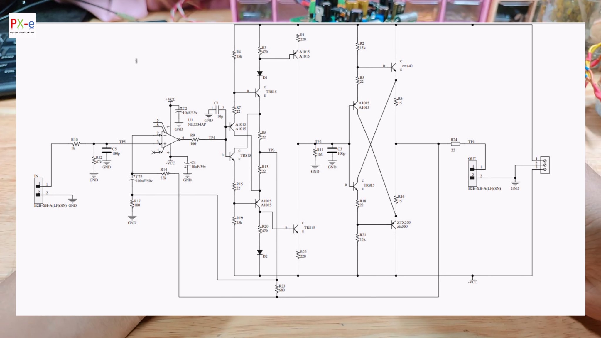

I am wondering if it is the original C-3850 schematic or another clone? Maybe @m0rten knows. I have not been able to find a detailed enough pic of the actual PCB. This is the identical circuit layout as ours, with a different op amp (AD797 an "ultralow distortion, ultralow noise op amp" $22.75 USD each, in stock at digikey, lower noise and higher slew rate than a 5532; even lower noise than a 4562) and different transistors. Also, less global feedback with 680R instead of 470R.

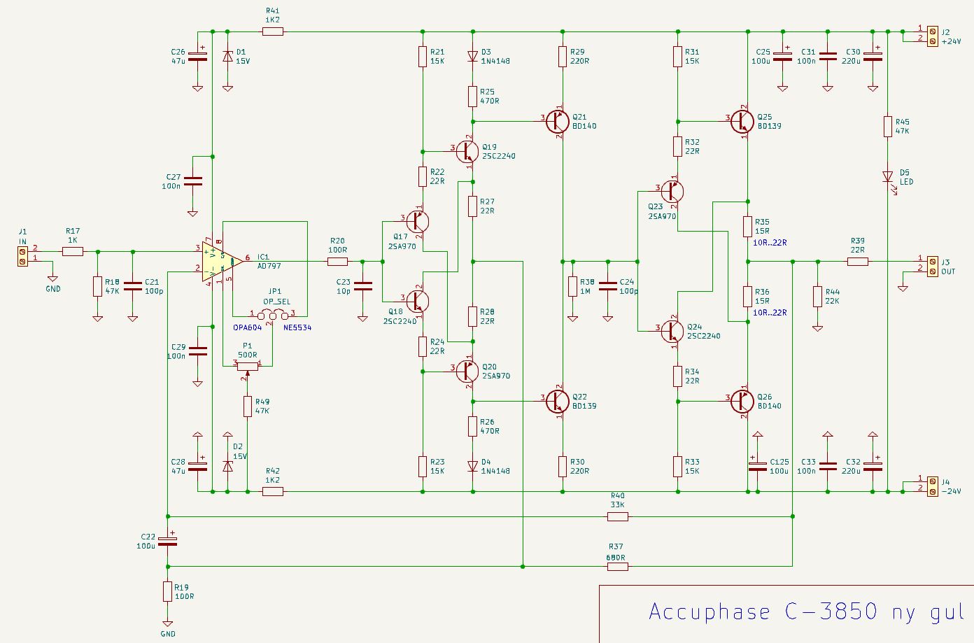

The ny gul schematic has a mistake. C22 listed as 10pF. R19 and R37 are reversed.
Looking at the other Ali C-3850 board with the 5534, it is "using low noise small power transistors 2SA733/2SC945, The output tube uses the original UK tube ZTX450 ZTX550." Maybe the @m0rten schematics are older clone boards?
First, my apologies for errors in the schematics. Most of them are made for my own pleasure to have a more readable (for me) schematic of PCBs I have bought or that I fancy buying. These schematics may be less scrutinized by me for errors, because I already have BOM and PCB.I am wondering if it is the original C-3850 schematic or another clone? Maybe @m0rten knows. I have not been able to find a detailed enough pic of the actual PCB. This is the identical circuit layout as ours, with a different op amp (AD797 an "ultralow distortion, ultralow noise op amp" $22.75 USD each, in stock at digikey, lower noise and higher slew rate than a 5532; even lower noise than a 4562) and different transistors. Also, less global feedback with 680R instead of 470R.
Some schematics are reverse engineered from PCBs without schematic. I does not enjoy doing that! In these cases chanses are greater for errors, There are not many of these, though, and mostly Xovers, I think.
Lastly, there are the schematics drawn for PCB production. Still not guaranteed 100%, but at least these are more thoroughly checked.
Now, for the C-3850. I do have some boards for this amp, so the schematics are just for my own pleasure. The "ny-gul" (=new-yellow) schematic has indeed errors in it. I did not realize before you guys pointed it out. Thank you! The "green" is a correct version. I hvae now corrected the "ny-gul".

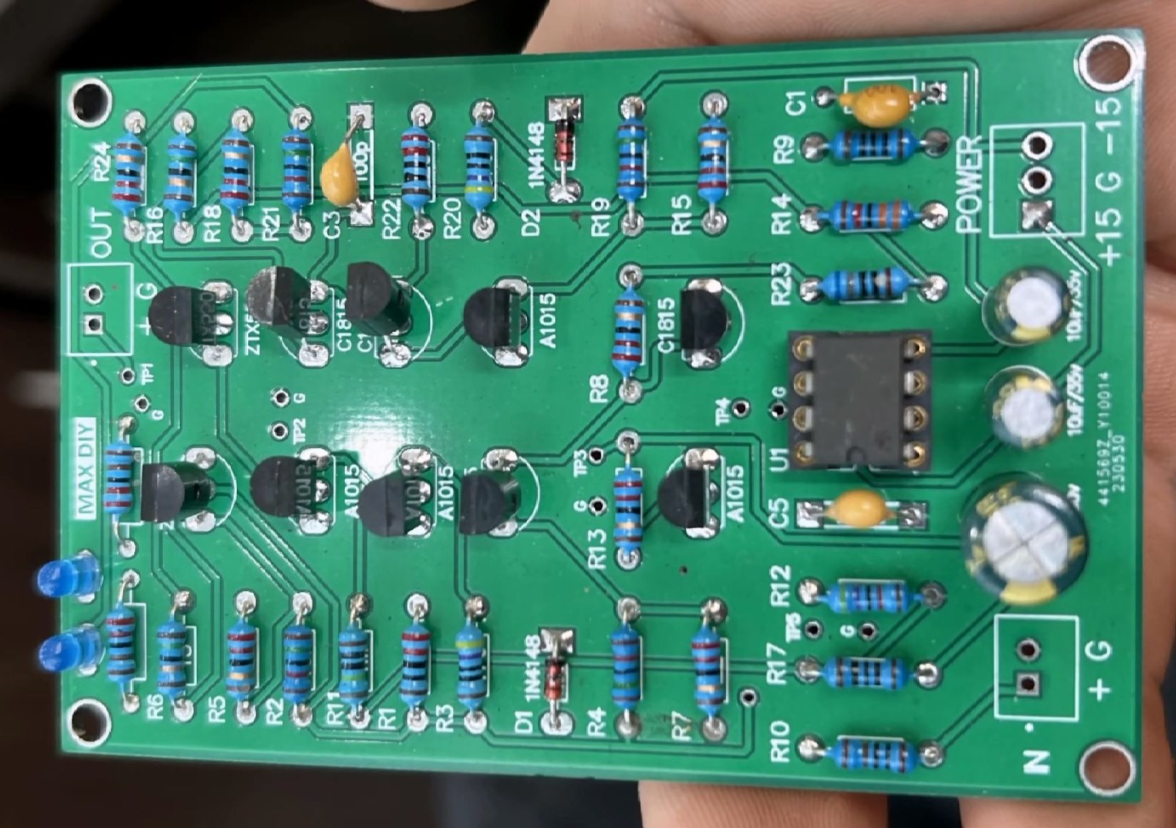

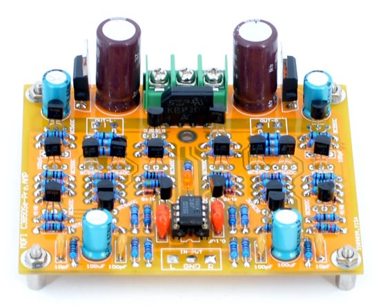

To make this more concrete, here are the 3 PCBs that I have:
Green:
Gul-ny:
Is there an "old yellow"? Yes. No schematic, as it looks like a version of the "green" without input relays:
