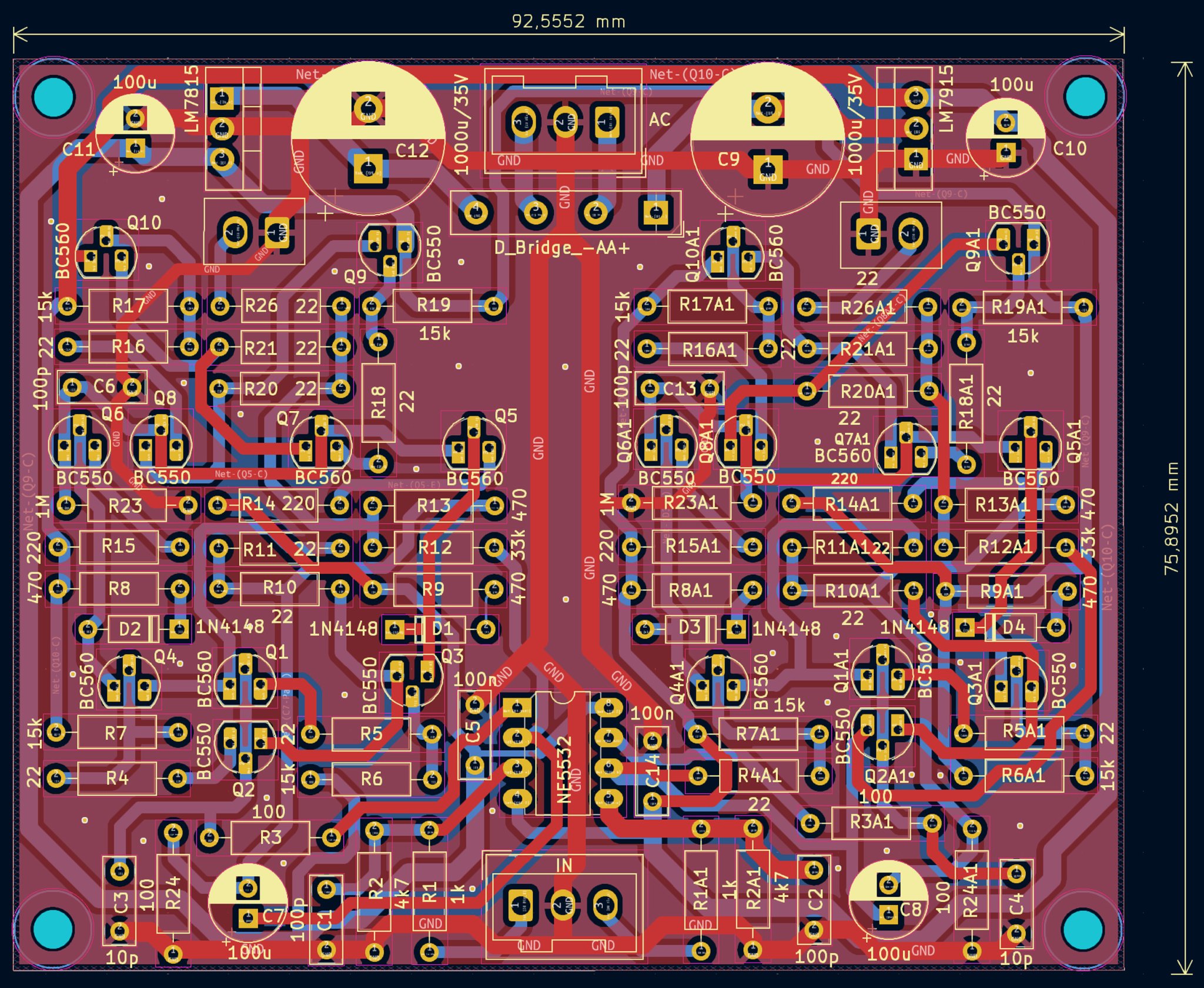

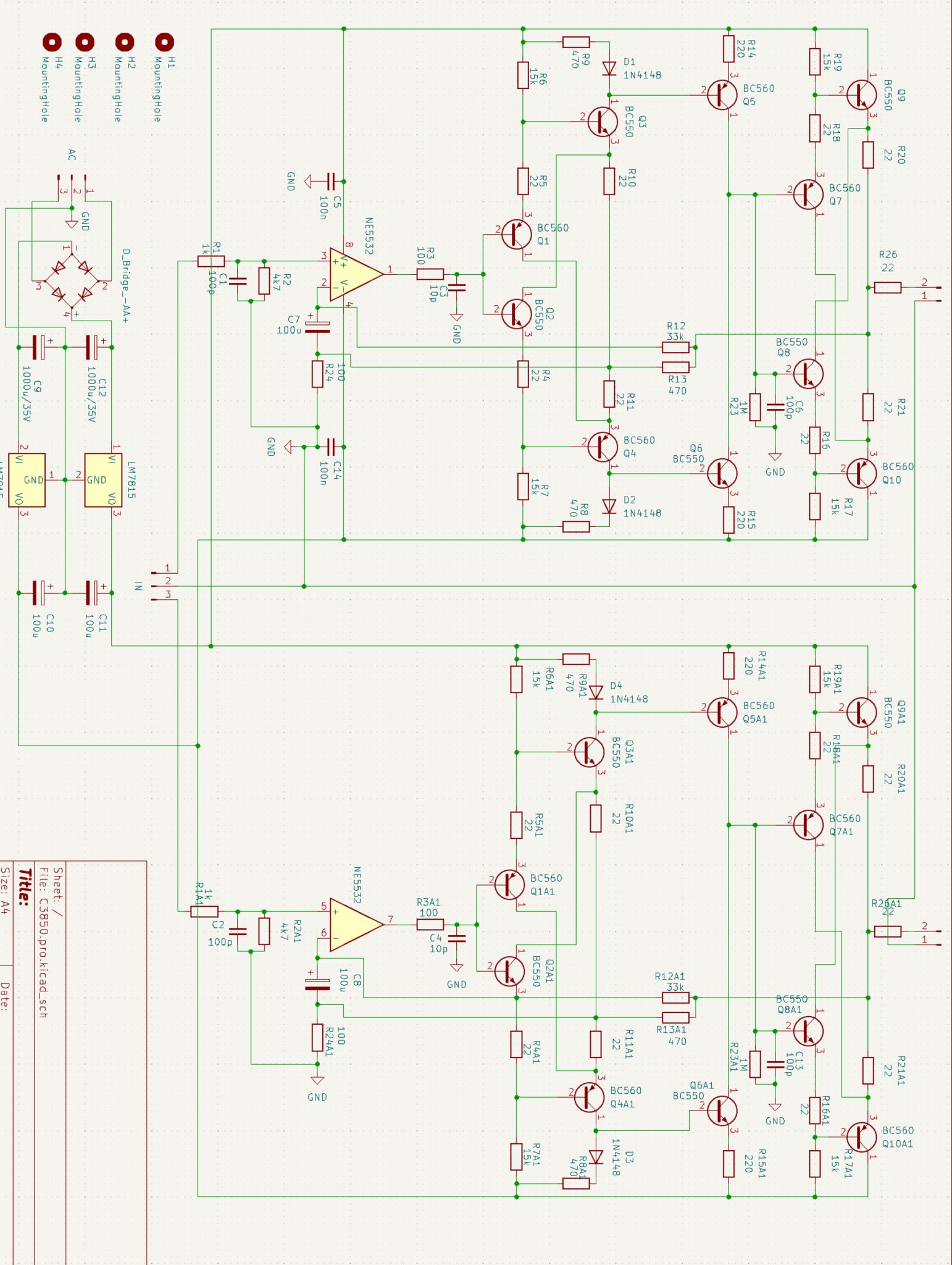

I made a PCB, you can have a first look. Perhaps some components have to move, i will see. I updated the schematic with other values.
R1/R1A1, Q1/Q1A1 and so on. Capacitors and diodes have the old values. NE5532 is rotated !!!
The groundtracks are no more necessary, only for my use in the moment. The pcb has a groundplane.
If someone has an idea to make someting better please tell me...
Greets
Peter
Greets
Peter

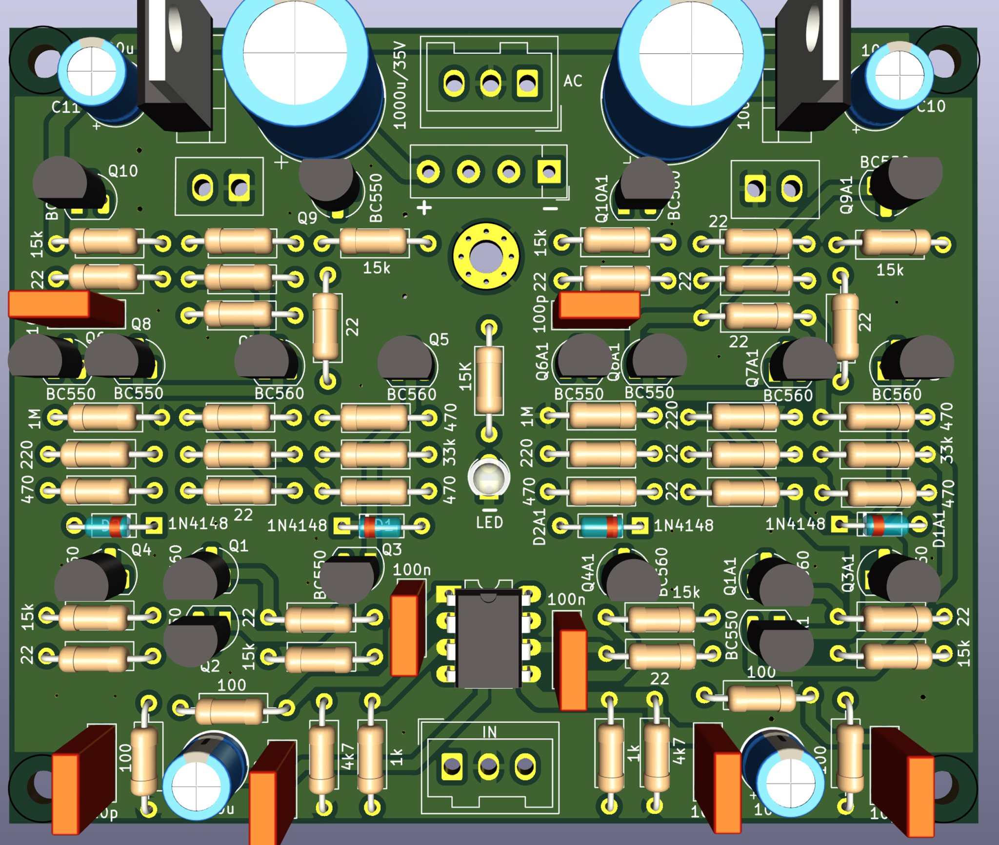

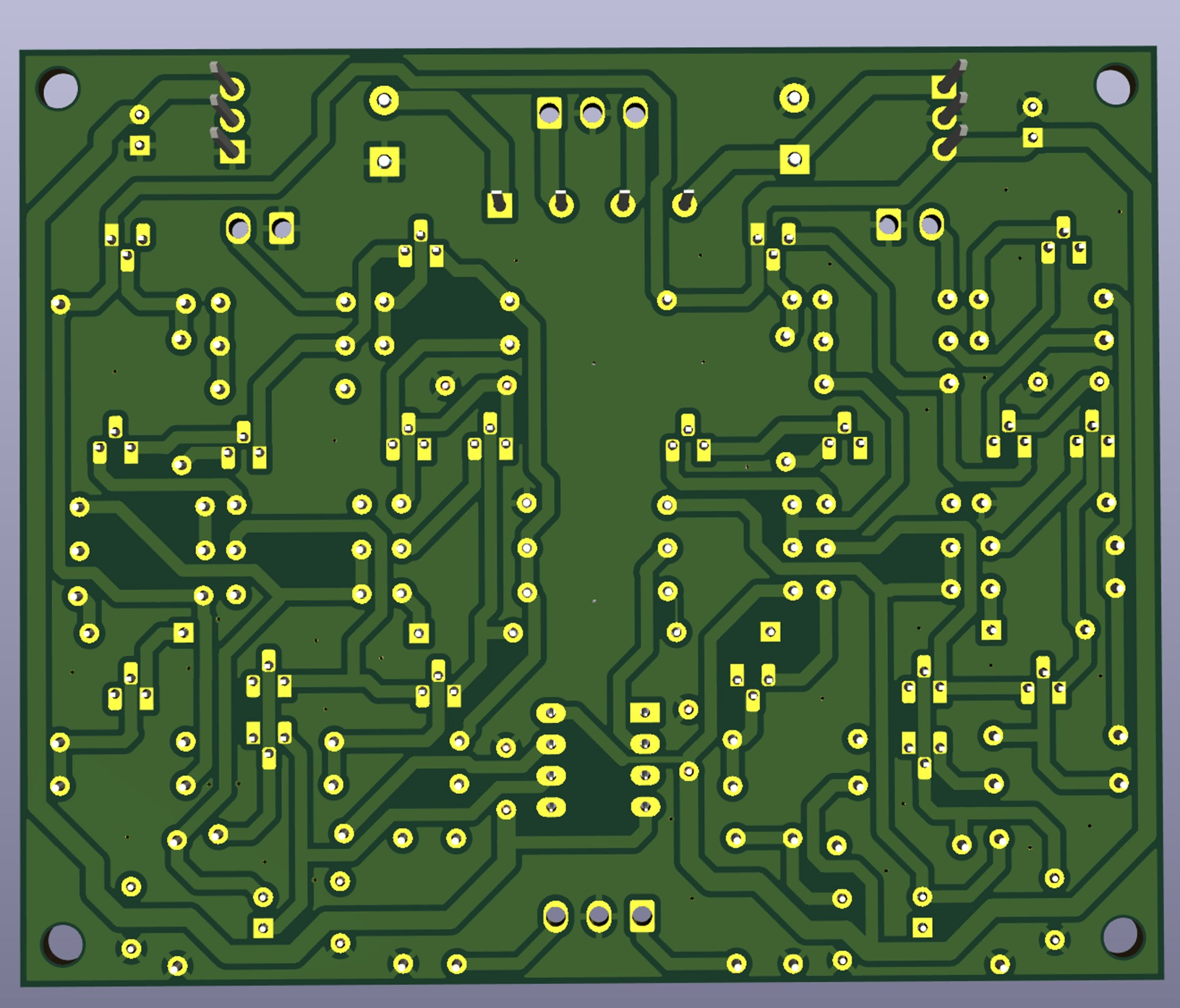

Hello,
i have controlled the pcb and found one too small track...thats all.... corrected. DRC with two mistakes, because i changed the output connectors (i know, i have done 🙂 ).
One ground via, 15 K resistor and one led are new on the pcb. Diode bridge i changed to a smaller one. The feedback tracks now in 1,5 mm.
I can give no guarantee, but i think the pcb with its components will work. The pcb size is similar to the pcb from "Mofi".
The Metz Connect AKL connectors 3,5 mm will fit too https://www.reichelt.de/wannensteck...-p36644.html?&nbc=1&trstct=lsbght_sldr::36629
Greets
Peter
Greets
Peter

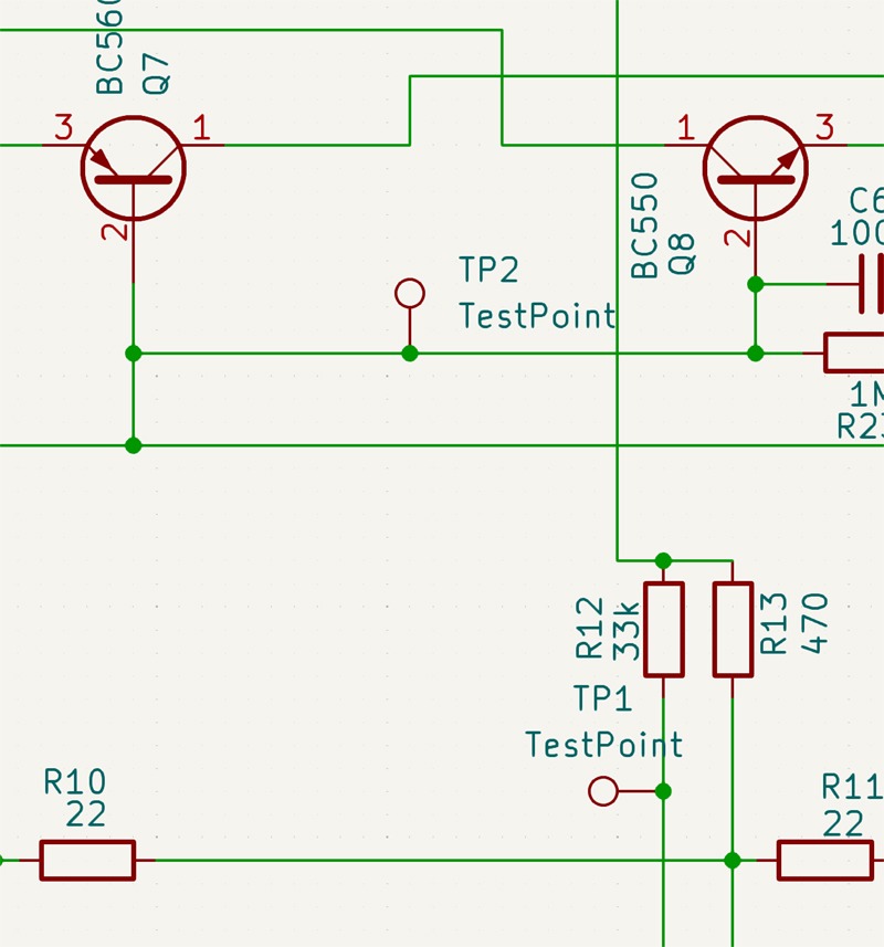

very nice pcb. Do you think you can do some TP-Test points?
e.g.
after output opamp, after the R12(33k) to check DC there.
Base of BJT Q7/Q8
chris
e.g.
Base of BJT Q7/Q8
chris
perfect...like this...yes...

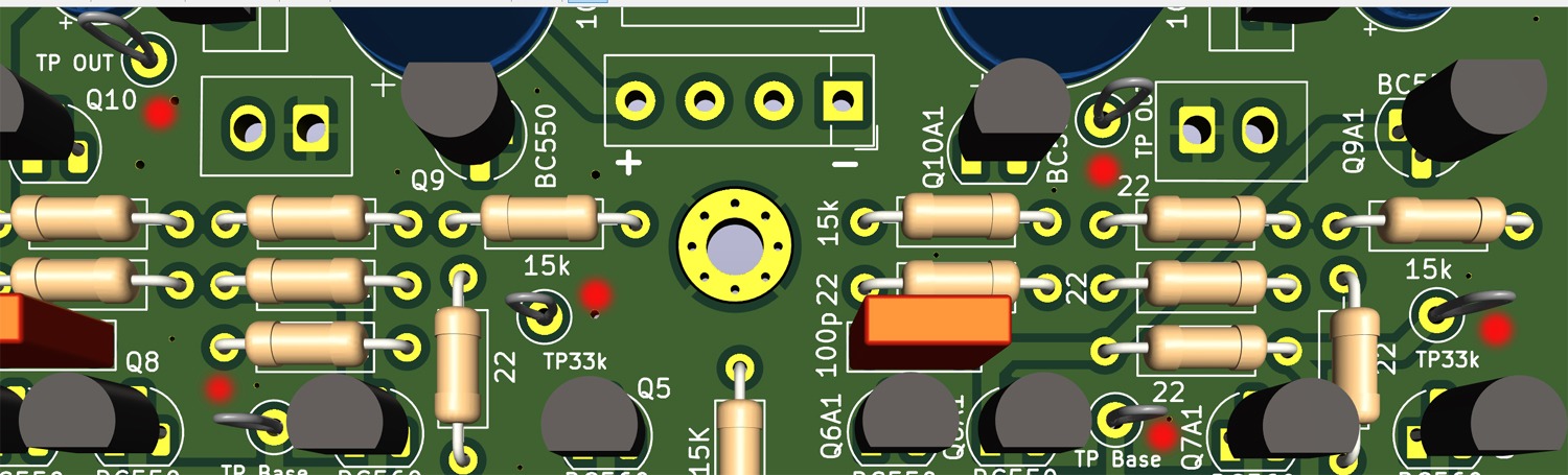

In this way ? Q7/Q8 base (are together), 33k to the output R21/R22/R26...or after R26 ? You can have a testpoint after 33k and to the output after R26
Three testpoints marked
