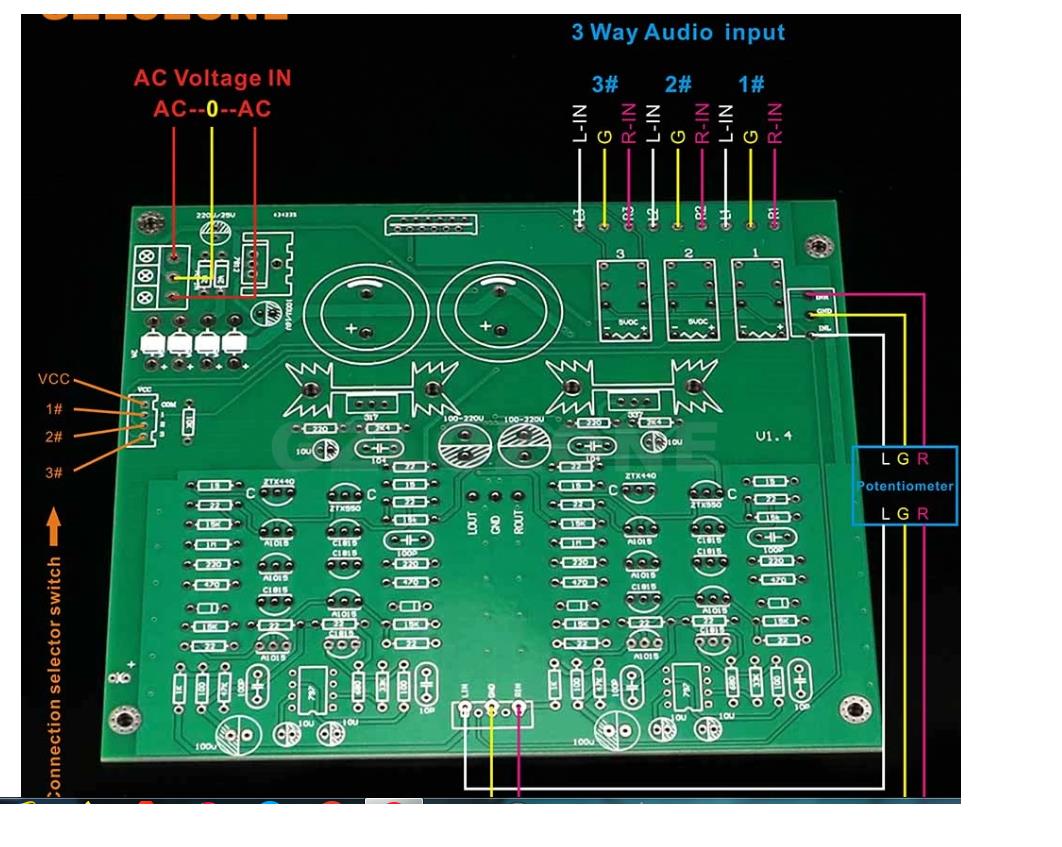

Unfortunately I do not know how to connect the RCA output,🙄🙄😱
It has two place where possible to connect and really confusing me.
I will post pictures later.

I Find a picture on the net.
I don't have this kit, but the output is in red below. The RCA jacks are meant to be chassis mount. In that case, use two shielded wires to connect the pads to the RCA jacks. LOUT connects to the center (signal) wire and GND connects to the shield of the wire. Connect the signal wire to the center contact of the RCA jack. I hope this is what you are asking.

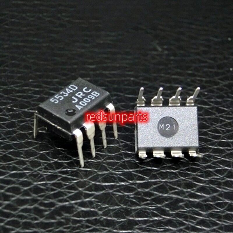

Beeny did a review of this board, and said the 5534 are fake. This was 3 years ago. Not sure if this is still the case. In the video, Beeny has a PCB mount RCA jack installed on the board for testing.

Sorry I was not clear.
The two set of marks for the potentiometer confusing me.
L G R and again L G R all printed on the PCB IN.
If the chip fake I will buy (order from a big company).
I watched one of his video and there he said the chips are OK. His friend also built this kit.

The LGR at the top near the relays connect to the pot at the end terminals. The middle terminal or wiper connect to the input L and R at the bottom in the picture. The G for the input and relay pads should connect to the same terminals on the pot.
When the pot is positioned to the extreme counterclockwise position, the resistance from the wiper to the ground terminal should be zero. When the pot is positioned in the extreme clockwise position, the resistance from the wiper to the ground terminal should be the value of the pot. This insures that volume increases with clockwise turning of the pot.
Important. When soldering to the pot terminals, be sure the pot is turned full clockwise or full counterclockwise.
The only way to know if the parts are genuine is that they will meet specs, especially slew rate. Testing with square waves and oscilloscope is the only way to know for certain. If your kit is 3 years old, it might still be supplied with the fake 5534. These days, the genuine parts are so cheap, it doesn't make sense to substitute fakes. Digikey only has marketplace suppliers for the through hole 5534. Digikey only stocks surface mount 5534.

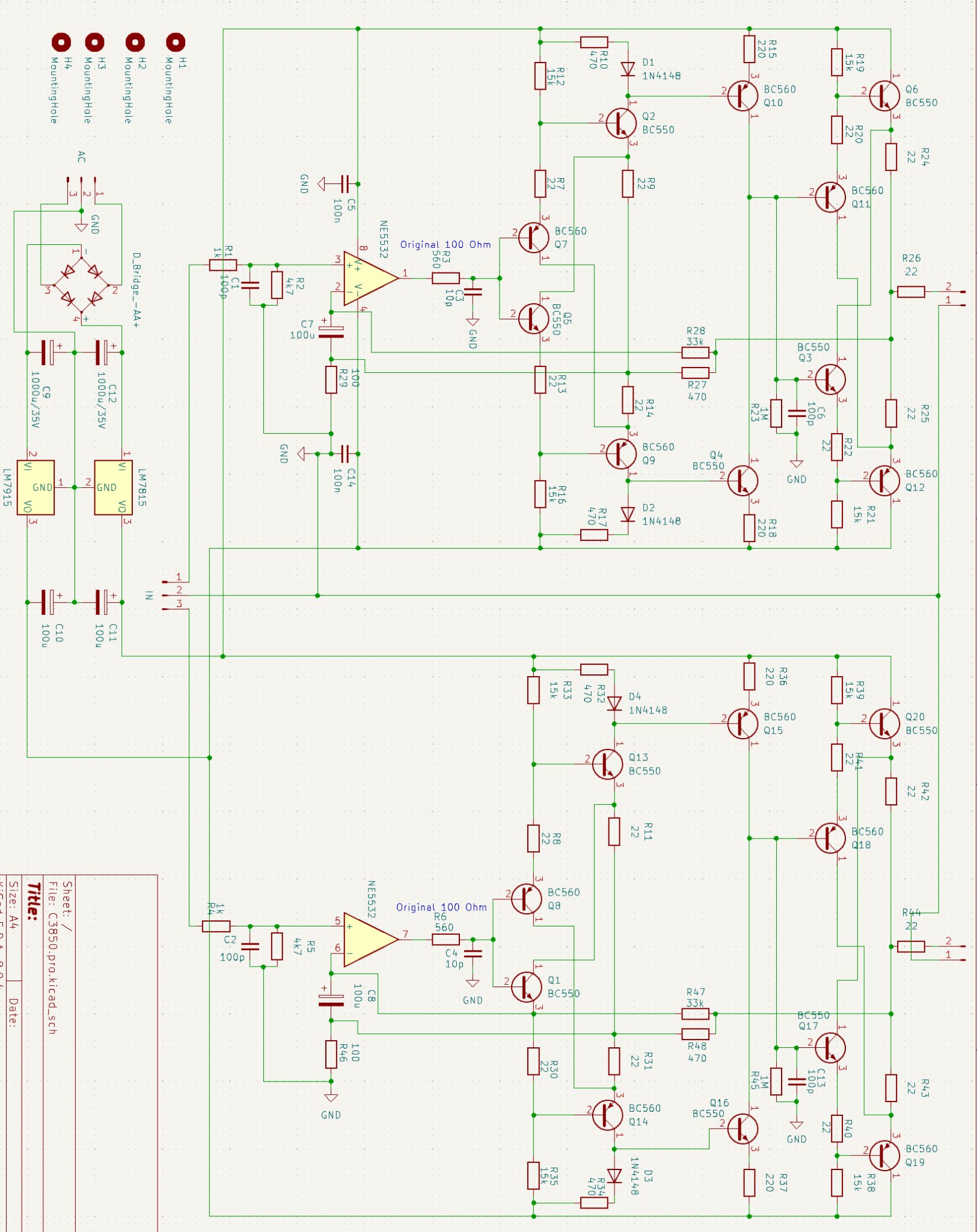

Hi ...
i have corrected the schematic and hope everything is fine now.
I try to design a pcb, but i it will take a lot of time. Cant say how long it will take....
I think it is easyer to buy a new PCB at Ali... 🙂
Chris, do you know where to buy other transistors ? I have taken a look to ZTX types, hard to find to. Other ideas ?
For the first i will change the input ic and let the BC550/560 in there.

I have tried the proposed alternatives. Increasing 10p and 100p capacitors reduces bandwidth, as expected, but that doesn't affect behaviour of the circuitry in the audible region. That change could be useful if you anticipate RF interferrences. However, short and adequate cables may prevent that and you still can retain advantages of better frequency response.
I have decided to make just two changes: R1=330 ohm and C8=27pf. Both changes were suggested by Michael Beeny and Ron Schauer in their youtube videos.
Hi Gabor,Unfortunately I do not know how to connect the RCA output
Thats simple. First note that there are three relays for input selection. You may activate individual inputs via relays by shorting VCC with 1#, 2# or 3# inputs. You can do that with multi-position switch.
You right about the RCA connections those are easy. I made a mistake when I asked for help.
It is not the RCA the problem, the potentiometer
It has two places marked bot as IN L G R and again L G R IN.
It should be one L IN and one R IN and one R Out also one L Out.
I will figure it out when it comes to set it up.
Hopefully a signal wrong connection does not damage the pre-amp.

Referring to @Kleinhorn schematic, with the standard feedback resistors R29, R46 of 100R, the low frequency cutoff frequency (-3dB) set by the 100uF C7, C8 caps is 15.915 Hz. The purpose of these caps is to rolloff gain to unity at DC. If R29, R46 are increased to 1000R, then the cutoff frequency becomes 1.59 Hz. So if the feedback is increased by increasing R29, R46, the value of C7, C8 could be correspondingly decreased to maintain the original 15.915 Hz. With 560R feedback resistors, the caps could be 20uF and get a cutoff of 14.21 Hz.
