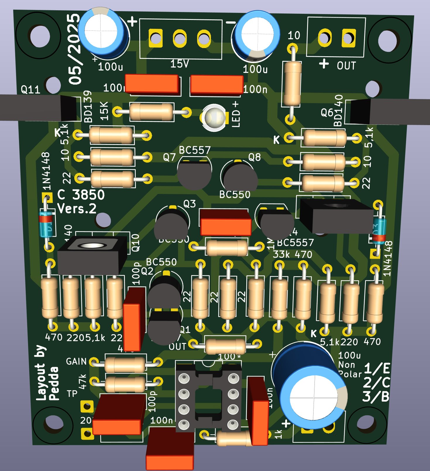

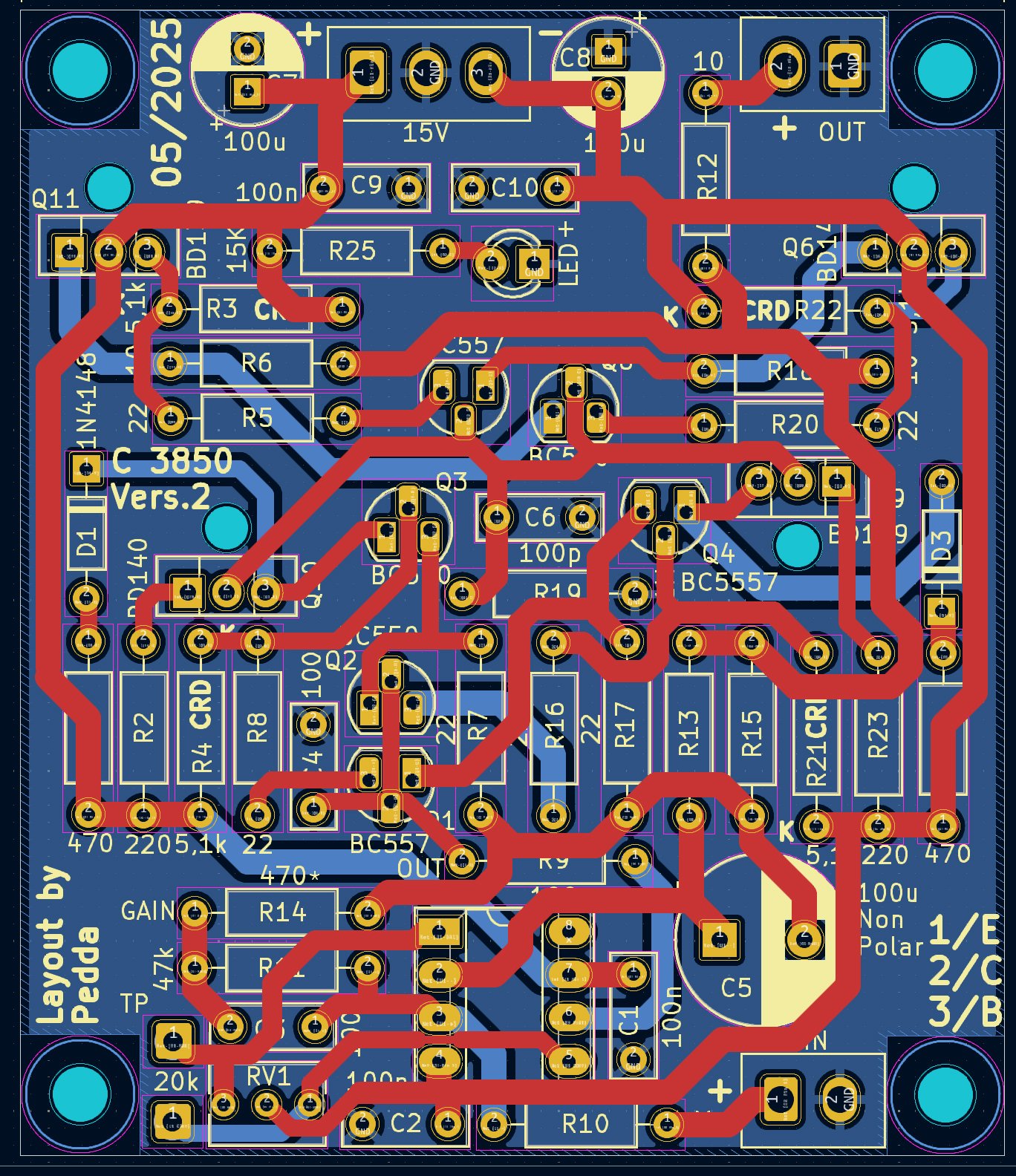

i made another layout for the Mono Clone with BD Transistors. The schematic is the same based on Chalky's simu.
The S8050/8550 transistors are small and need cooling with a heatsink, as i wrote.
Now i have changed to BD139/140 on the pcb. They will need heatsinks too, therefore i set 2,5 mm holes.
I will use heatsinks from Fischer 10022747 SK 95 25 TO220. I think this heatsinks will be big enough to cool down the transistors.
Because there are tracks under the heatsinks, it is useful to put a cardboard disc or a plastic disc betwenn pcb and heatsink for safety.
The heatsinks from fischer have 5mm thicknes after the transistors. Other heatsinks will fit too, but you must use one.
The rest is the same as before...

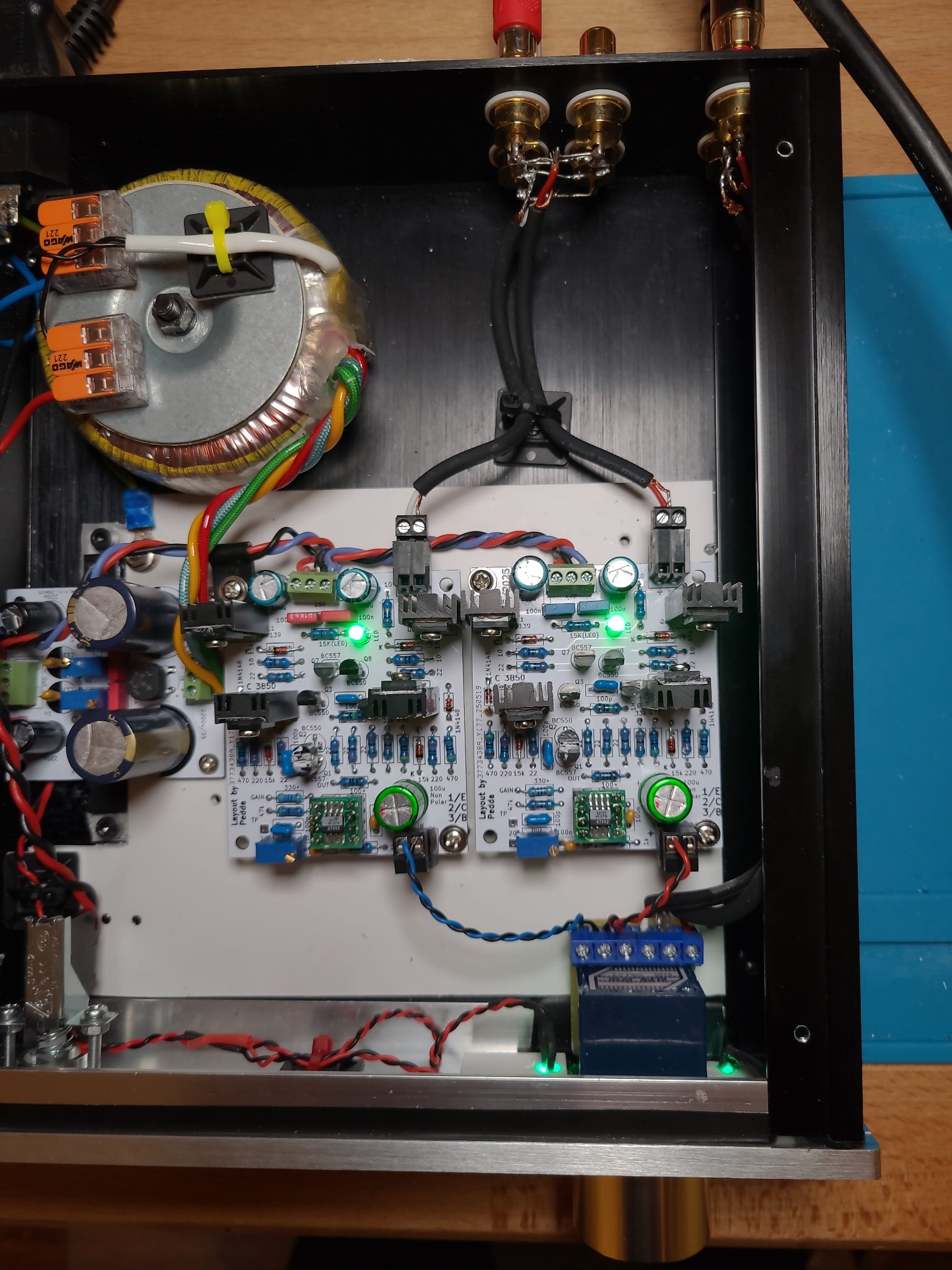

Hi...
It took a little time. I went to holiday and the pcb's have seen half of the world, thanks to dhl....
Yesterday i found the time to solder out the components and solder in on the new pcb's. Why ? The preamp was working with the components and I used matched transistors, wanted to use the matched crd's and so on.
I needed about 3 hours and the boards were finished.
The C3850 Clone is working fine now. The sound is not different using BD139/BD140 instead of S8050/8550. The heatsinks get warm, not hot, you can easily touch.
The first test was with 250 Ohm headphones, Beyerdynamic DT990. As all seems to be ok, i connected my FH9 XRK Mod amp.
No hiss no hum as before, the sound is great....
Now...one bad news...i had to find out, that there is a little space problem with the transsistor Q3 and the heatsink of one BD140, Q10 . I have marked on the first picture. My solution was to take a file and work on the heatsink to give a little space to the one solder pad of Q3.
I have made a correction on the pcb and will upload new gerbers. Not a big promblem, but annoys me.
I will not order new pcb's, because with my little change, taking a file, all is fine.
I have to mention that the fischer heatsinks will need 2,5 mm srews to fasten. Under the the heatsinks i used little nylon spacers.
My new pcb will have grounded mounting holes. I moved some components a little bit and some tracks.
I am glad to hved finished this project now...
