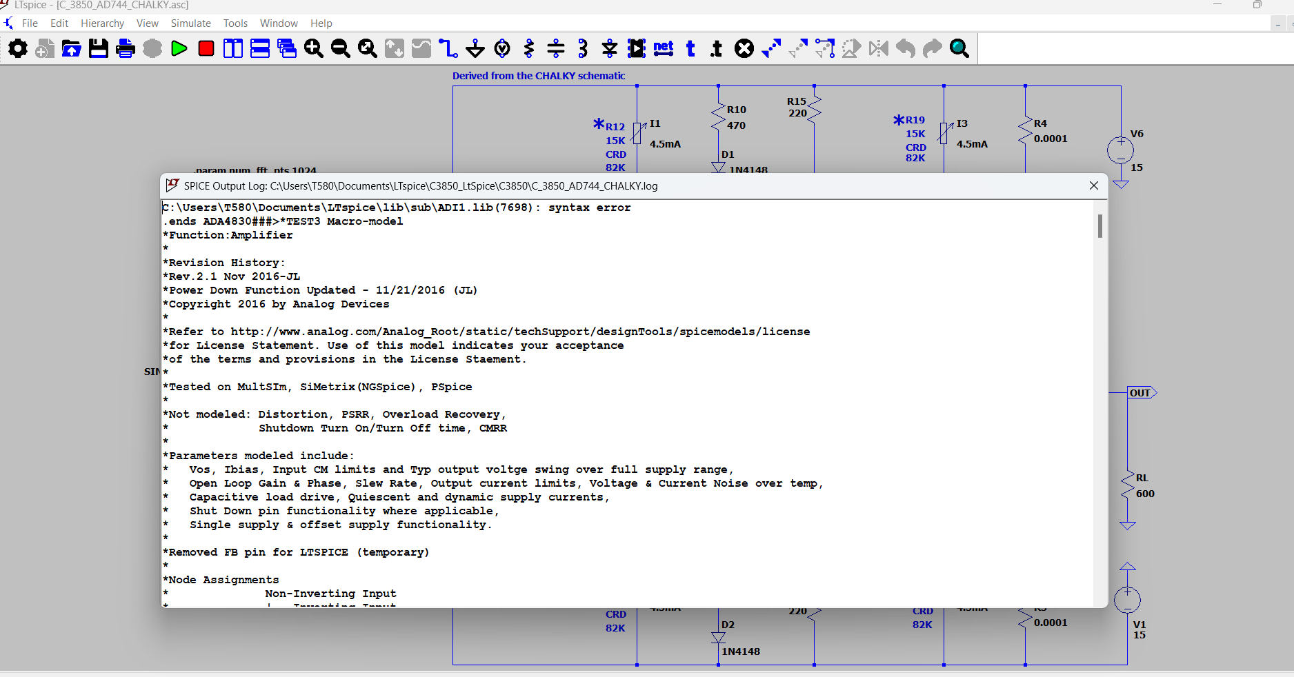

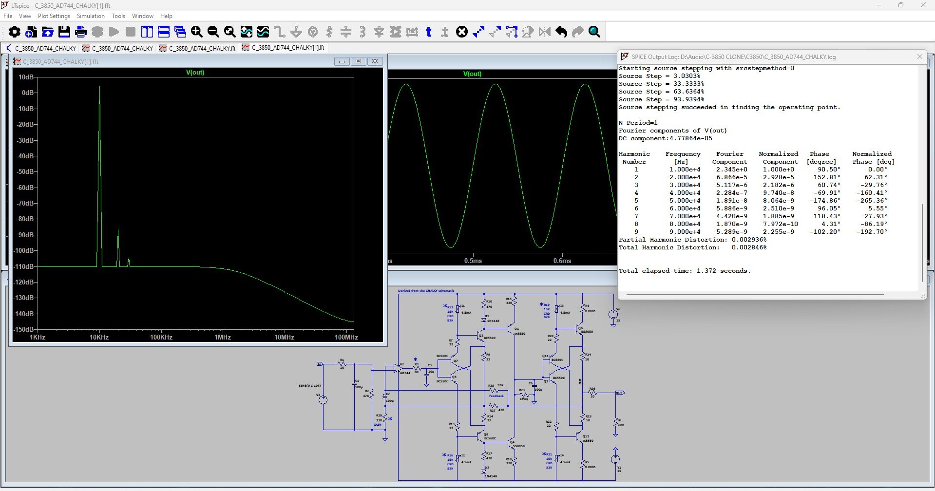

Hi again
i want to restat this project and wnat to simulate with LT spice. i do not change anything but i have got the strange error.
Error:
Expected device instantiation or directive here.
.set prb=0
Help please

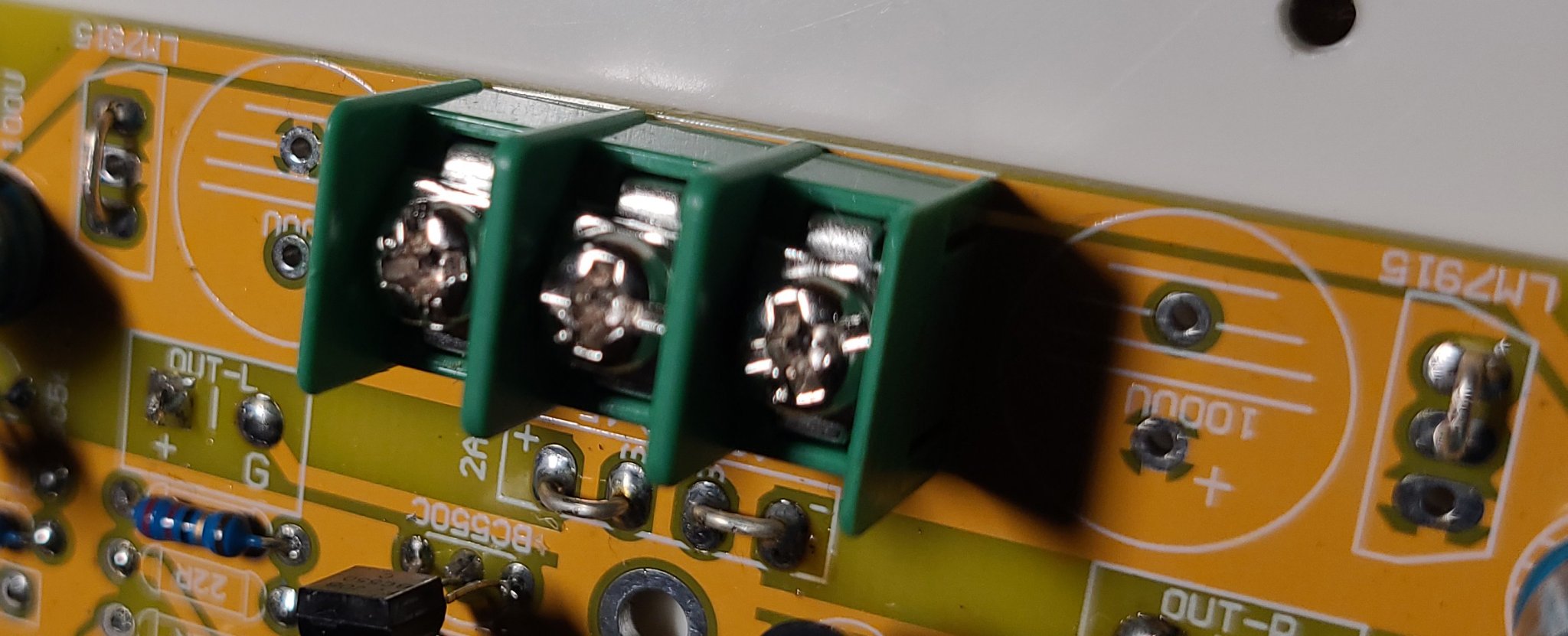

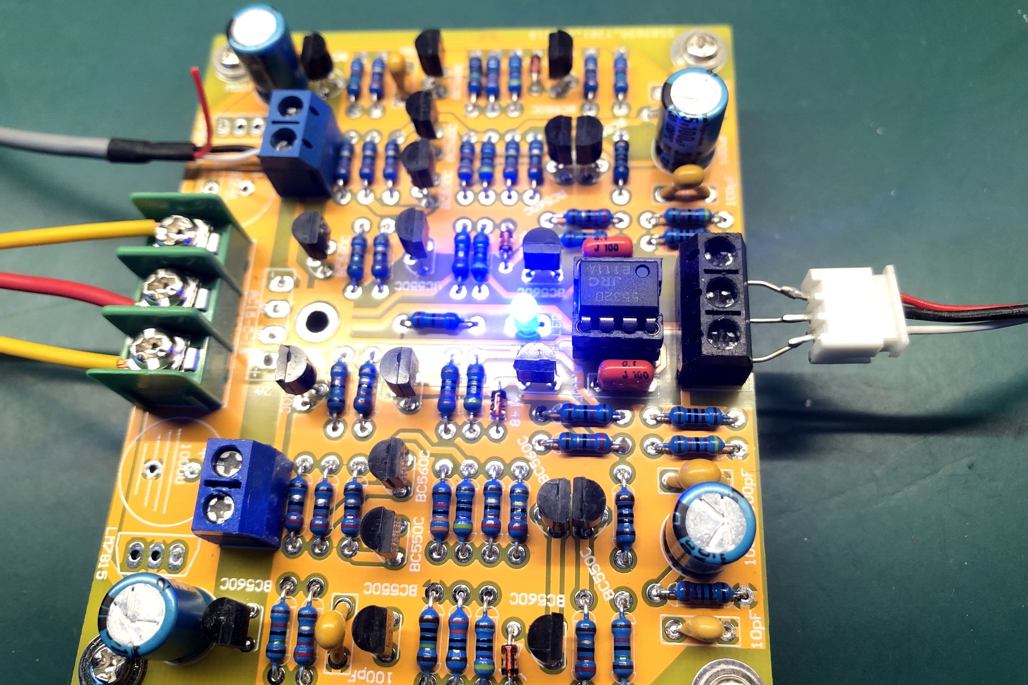

My very little voltage regulater board had arrived a few days ago from China. The voltage regulators are not isolated to the heatsink and there is no thermal paste. Done two changes, isolated and used a bit thermal paste for better cooling.
Took out the LM7815/7615, big capacitors and the rectifier and made little new connections on the mofi board.
I bulit a mistake in by soldering the new connections. Ground and - were shorted...stupid..searched for half an hour to find this connection. 🙄
I am using a OPA1612 now (like it very much). I had to solder on a small pcb adapter.
With the OPA 1612 i get a wonderful (heavy, dark) bass, better than every Opa i used before. I like the OPA1612 more than LM49720/LM462.
The best news is..the white noise, i had before on my speakers, is gone now. Deadly silence.😀
Perhaps one of the original voltage regulators was a bit faulty. I got different rail voltages, not much, 14,97 volts to 15,02 volts. That could not be the reason.
No matter now it sounds very good. The C3850 can easyliy drive a headphone, like my DT990, with 250 Ohms.
Happy now with this little preamp...🙂

I am very interested in how you did this conversion to use external regulation.
I've enlarged your picture to an impossibly large size to try and see your links on the pcb where the 7815 and 7915 were.
I mean the pieces of wire / bridge links soldered in place where the regulators once were.
If you can explain it I'll try it straight away - the LM317 must be be quieter than 78xx - a great idea, bravo.
Any other wire links to consider as well ?

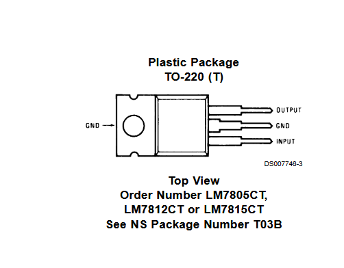

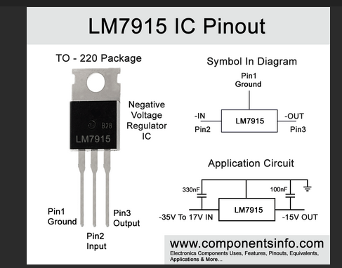

Hi Andrew
7815 make a connection (bridge) of both outer pins (IN / out)
7915 made the connection/bride between the middle pin and the "right" pin
kr
chris
kr
chris
Hi Andrew,
you have to make 4 connections. Two at the regulators. You will see the thicker lines if you have soldered out. As Chris wrote, input and output is bridged at the regulators. The next two connections you have to make at the rectifier.The two holes left and right must be shortet. I used little silver wire, 0,8 mm.
Be sure that the wire bridges are a little bit higher over the PCB. If not you can shorten something...

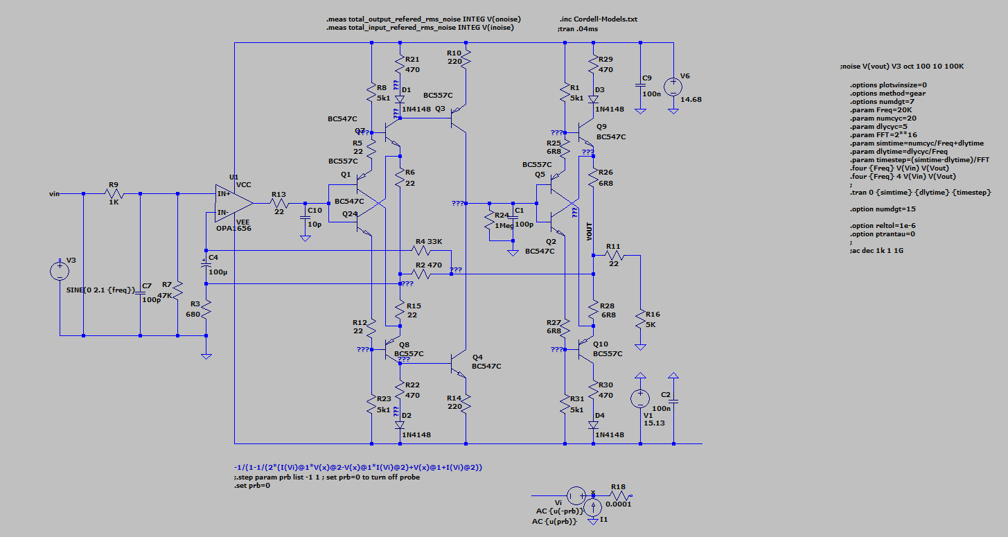

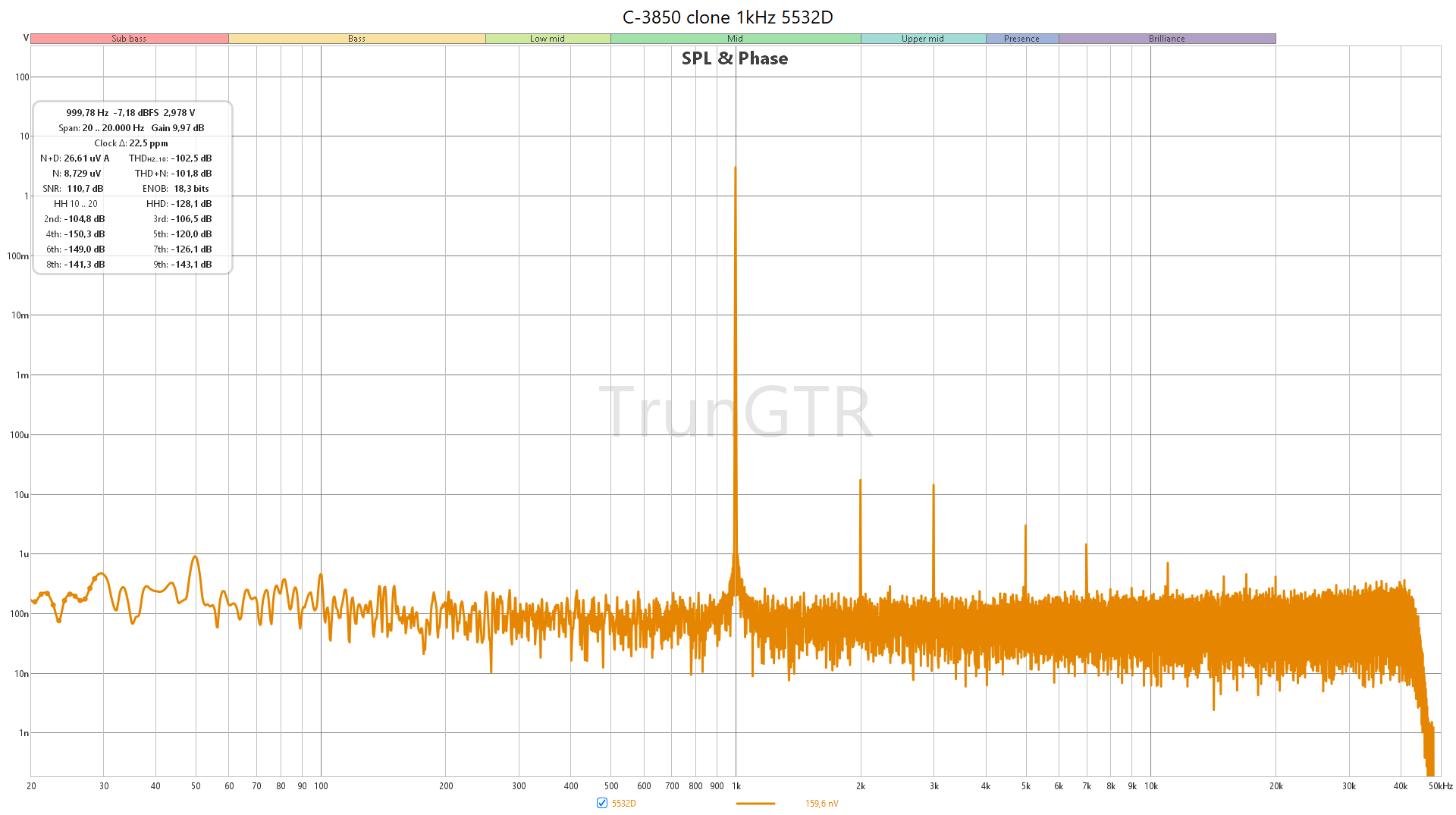

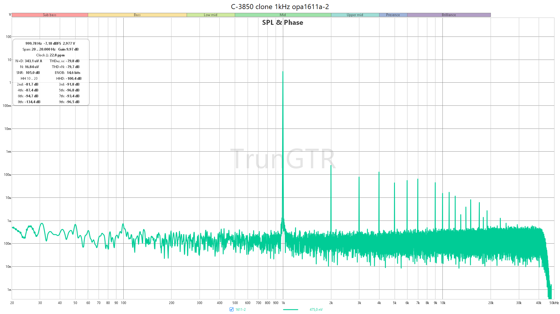

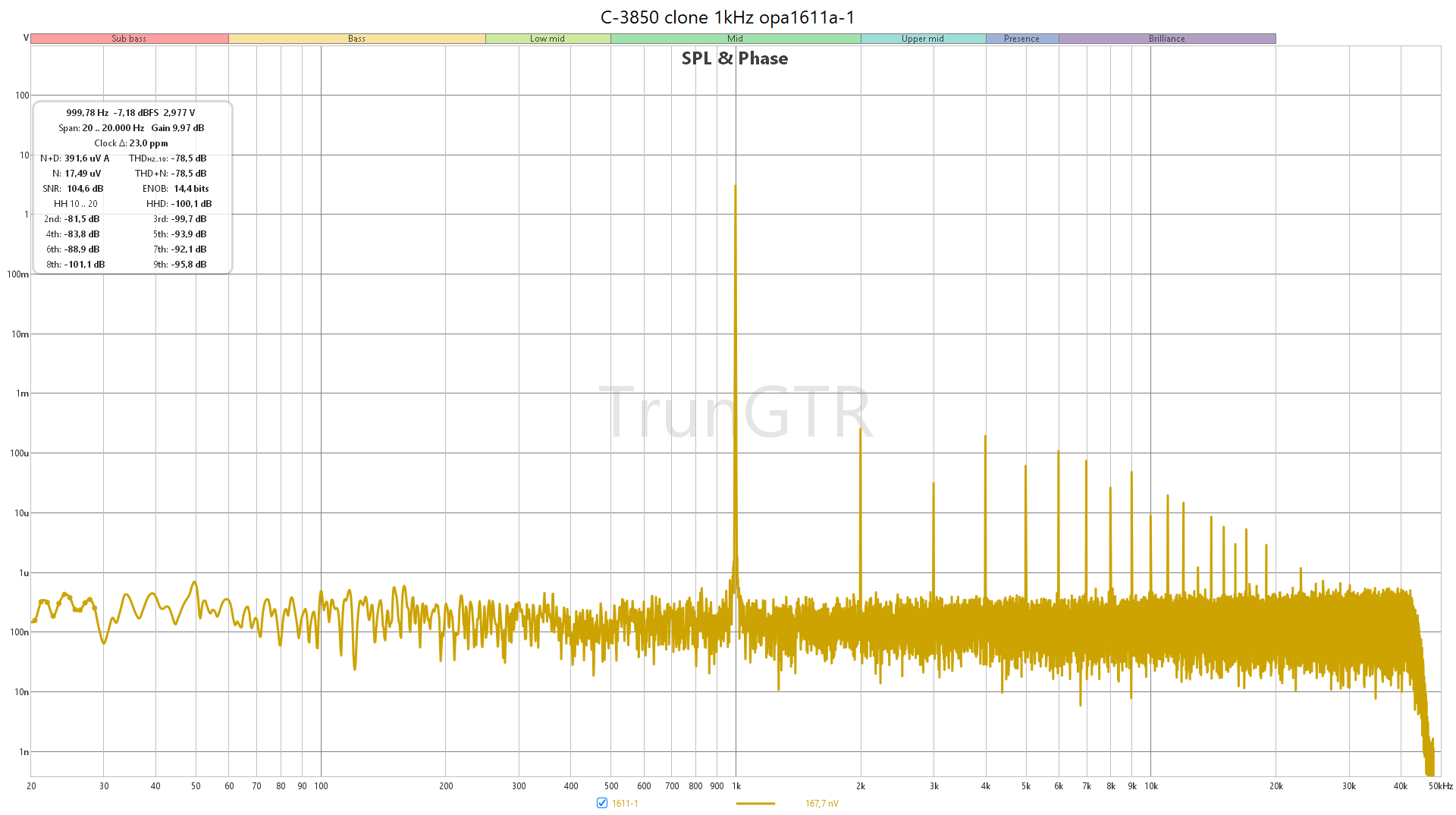

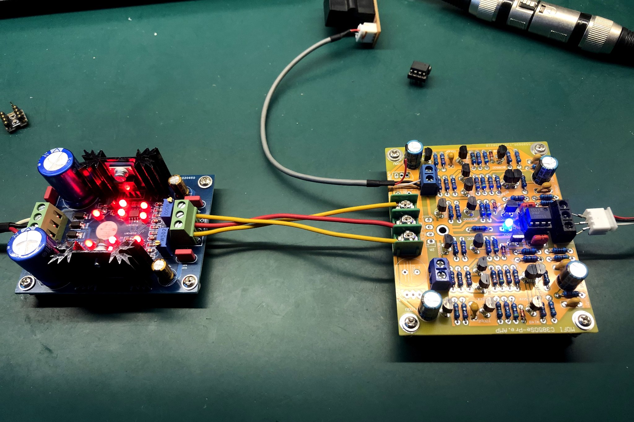

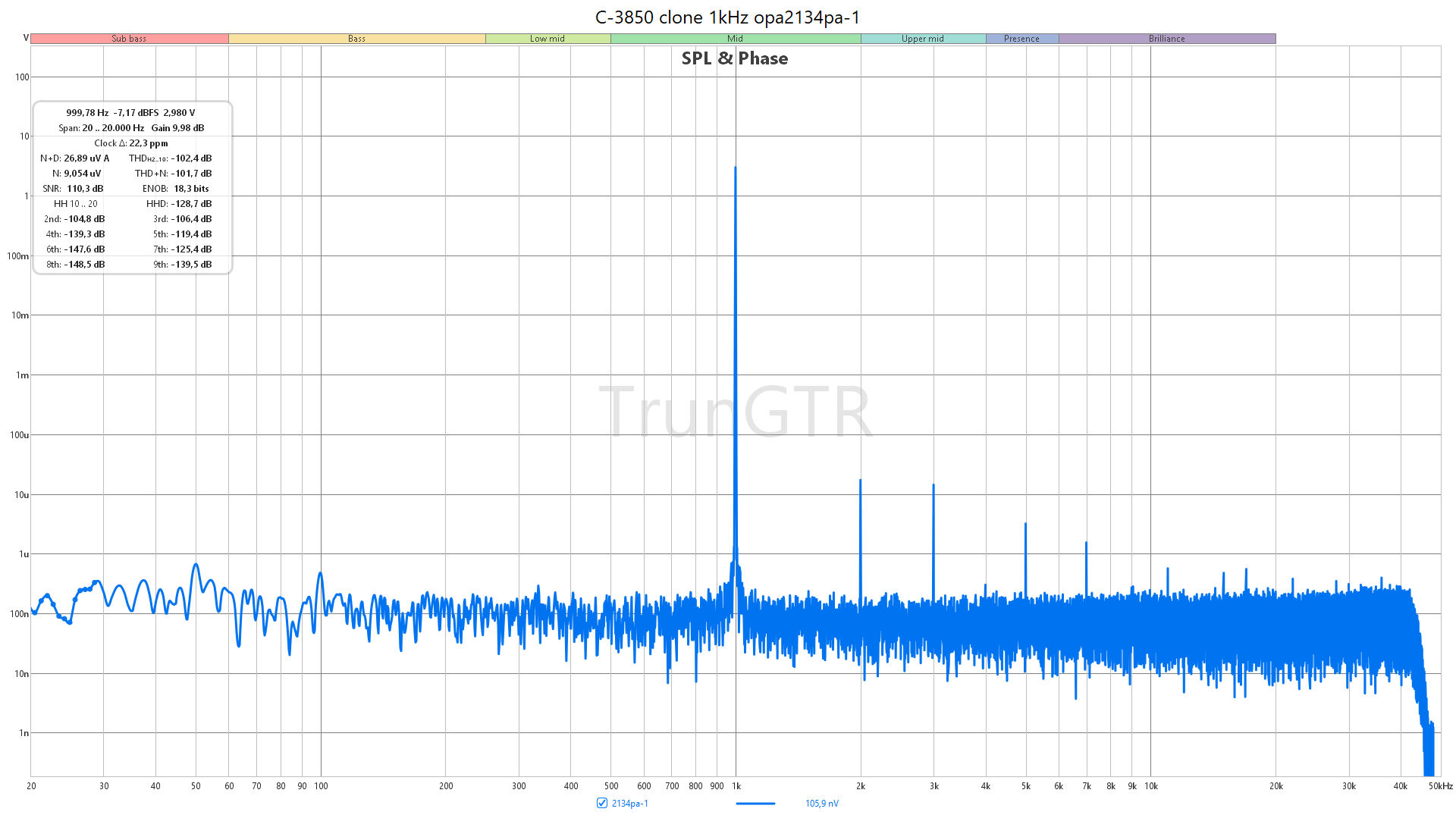

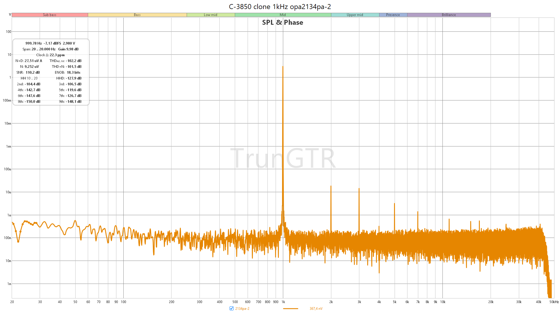

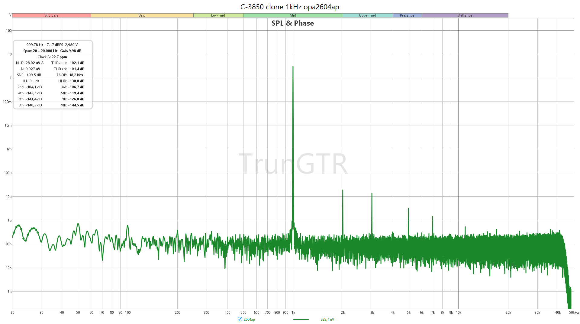

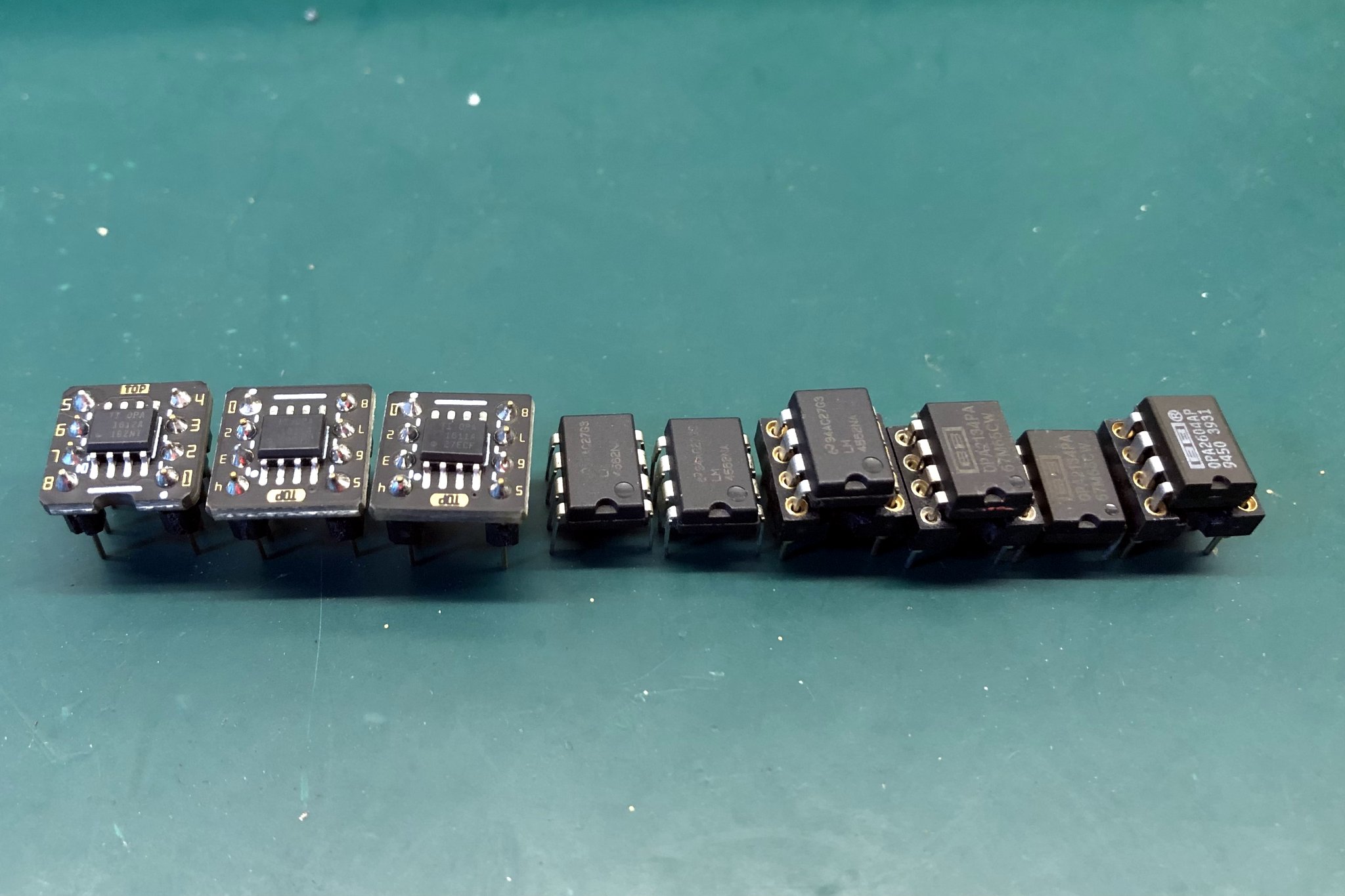

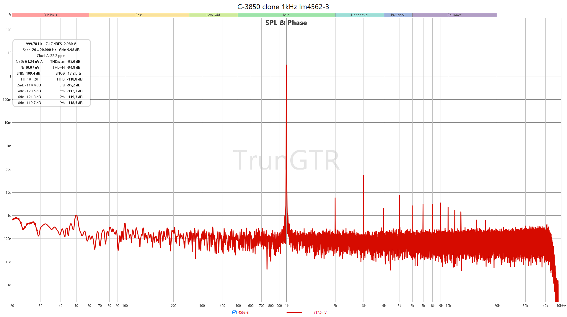

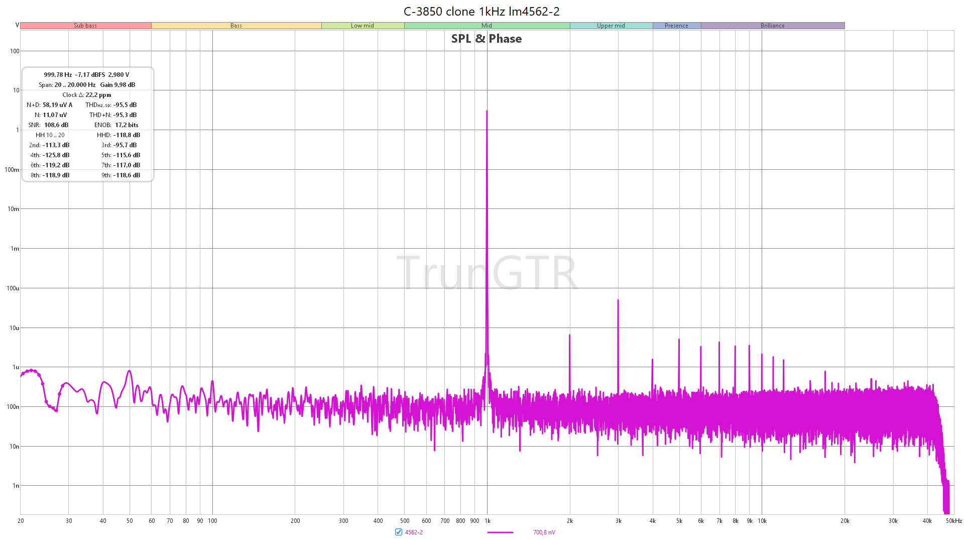

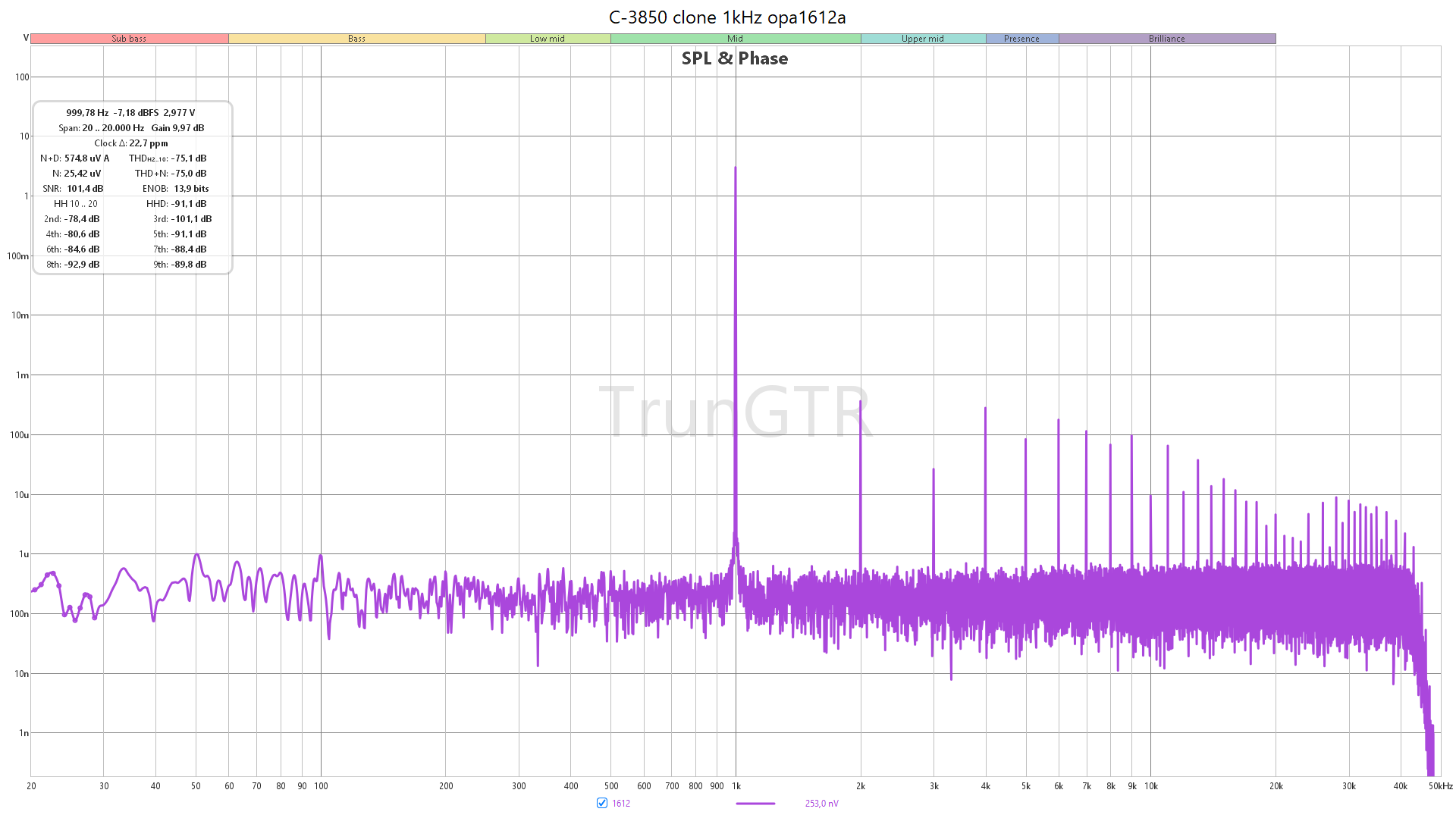

Hello, i ordered a kit and tried it out to see how people were interested.
First, i didn't use the LM78/79xx LDO ICs and powered it from the Jung Superpower circuit. I also reduced its gain by 10dB by changing the feedback resistor to 220R.
On my desk there were some opamps so i changed and measured. the results are in the pictures below
i didn't pay attention to the post, i connected it by observation and it works normallyWithout make connection at the 78xxx/79xx like post668? its working?
@trungdtmc do you hear difference between the opams? What is your preference?
I see some good opamp don't prefer so well maybe some compensation is needed for their high operating frequency.

You really need the gain of 10dB?. try to set the gain down and measure again...

Since listening can't be as fast as measuring i can't say much yet, there is just a slight difference when switching between 5532d and 1612a, i have to listen more@trungdtmc do you hear difference between the opams? What is your preference?
@chermann ok, i will try
