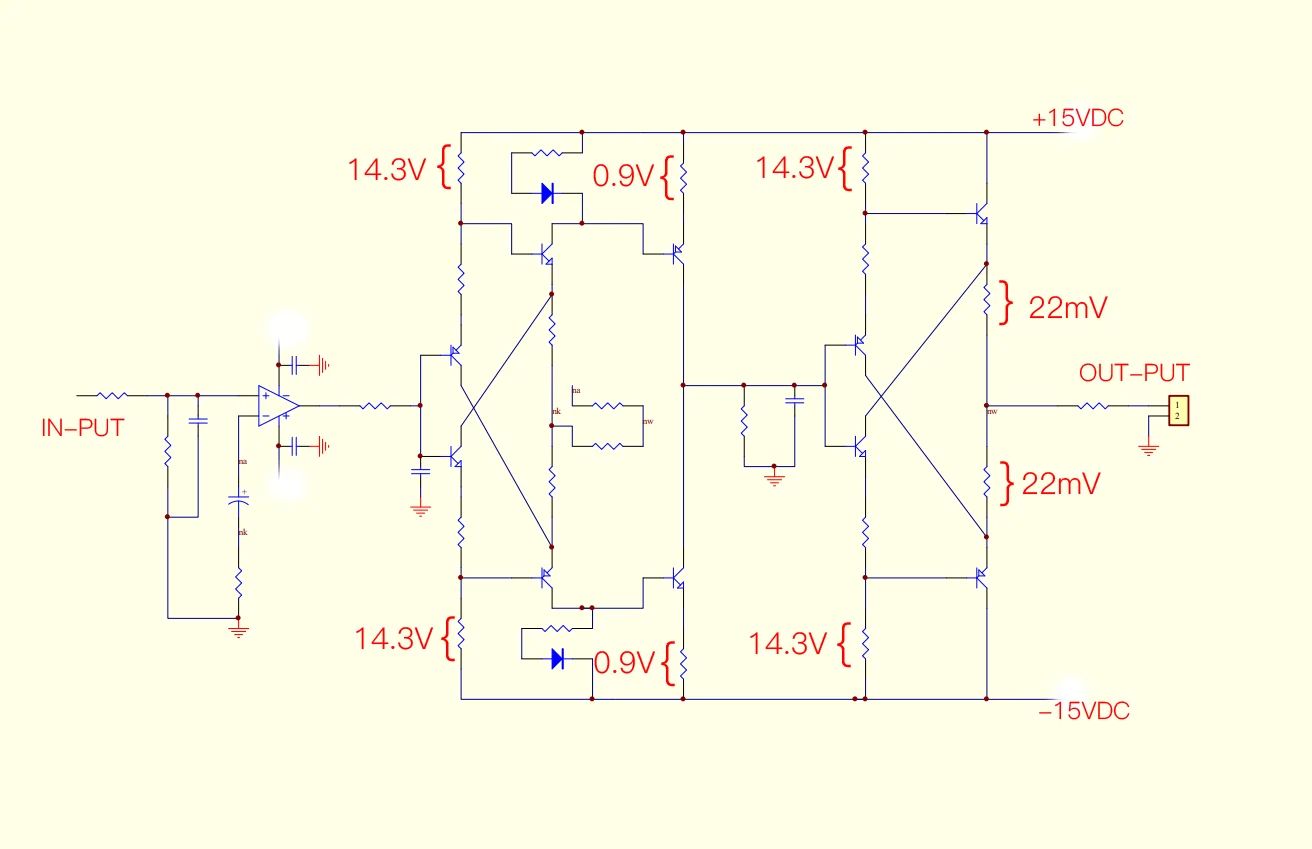

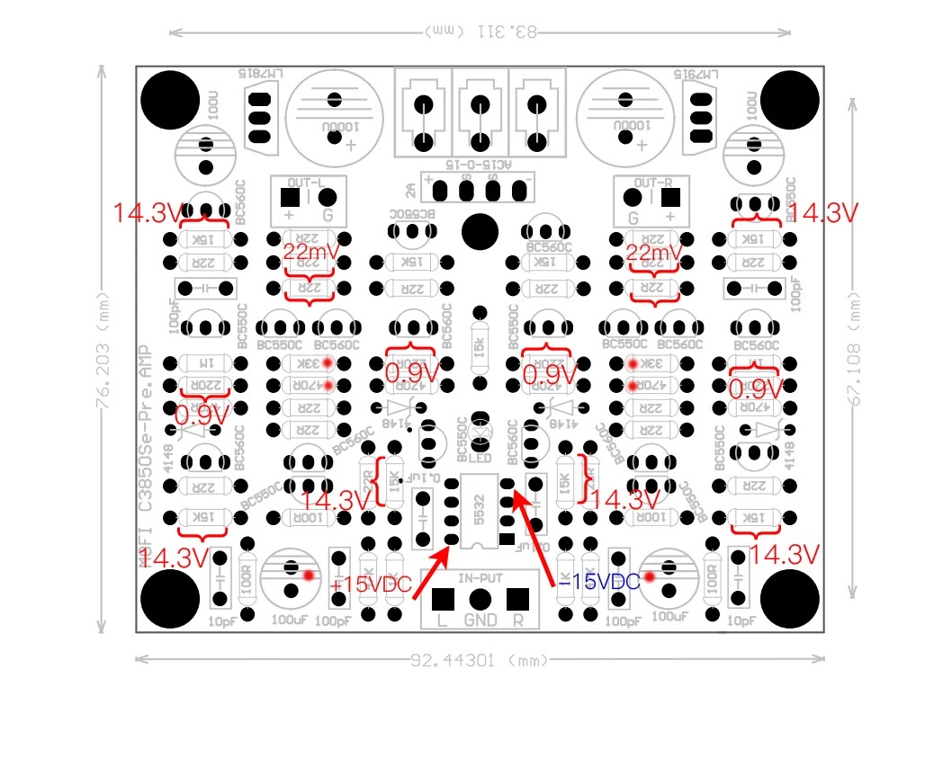

If you look at the voltage diagram at the pcb layout and on the schematics you will find the red marked values and you also can see the resistors value.
so my guess is that on a 22R resistor should have bee a voltage drop about 22mV--> this is just 1mA at the output stage of this pre amp this is nonsense.

@chermann I measured the voltages at the test points on a factory assembled board, and all the voltages are correct. 22mV across the indicated 22R resistors. 1mV DC offset at the outputs.
PCB test points.
Schematic supplied with kit/assembled board.

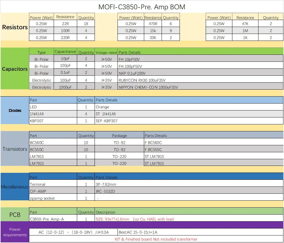

BOM supplied with kit.
Schematic by Michael Beeny.
PCB test points.
It's said to be Class A, but the output transistor seems to be biased too low with only 1mA current. Any fix? Anyone understand how this circuit works? Using the 5532 alone will probably be much better as a line preamp, with much lower distortion.

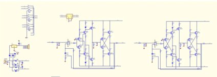

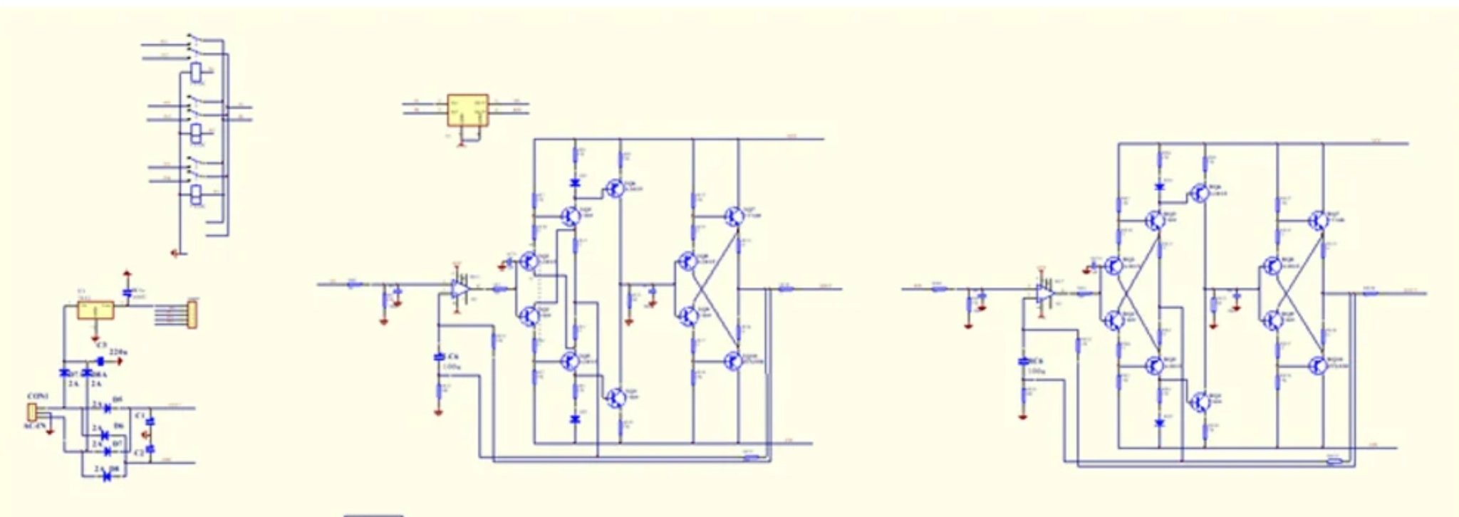

new video by Michael Beeny is available. it is about a similar amp with 4 x NE5534 and balanced board or complete amplifier (housing and transformer...etc..)
new kit :new kit 4xNe5534
complete pre amp: complete amp with balanced in/out

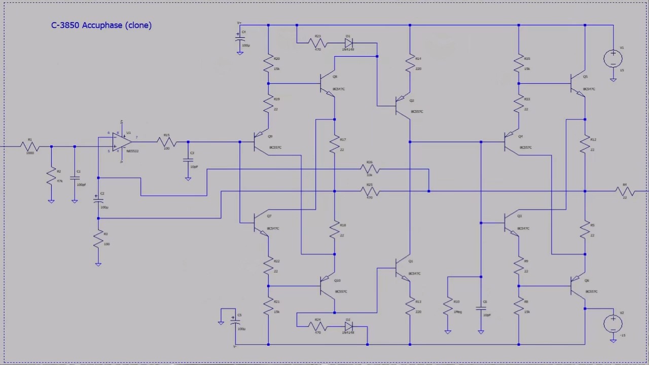

I think you are correct. This circuit has a distortion generating gain stage (in Class A) outside the feedback loop. It appears to be intentionally done to get a particular sound. Increasing feedback won't get rid of the distortion. Maybe take the output directly from the feedback, and eliminate the gain stage entirely. The Beeny schematic shows feedback coming from the output, but the schematic from the Ali website shows feedback coming before the Class A stage (I think). That would also explain why distortion only improved slightly by increasing feedback, in your measurements. Taking the output from that point would make the preamp inverting, but distortion should decrease considerably. An inverting preamp is not a problem for me (since my source is only digital, which can be easily digitally inverted), but it might be for others.You're quite right: increased level of harmonic distortion doesn't authomatically indicate bad sound. This preamp has excellent frequency response and bandwidth. Also, note that it has low distortion at low output level and in normal condition of home listening it must sound good but as soon it crosses 0.35 VRMS, distortion increases signifficantly.

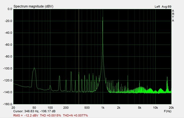

----- IMPORTANT UPDATE ------
My recent measurements indicate that this preamp has indeed low distortion and it indeed achieves HiFi performance.
My previously published measurements in post #26 are wrong: batteries of my sinewave generator run out and it generated distortion, not the preamp.
Now, with fresh bateries I have measured indeed great results. For example, a snapshot below corresponds to 3.500 mV rms at output. At lower output voltages it performs even much better.
This small and cheap preamp really ROCKS!
Measured THD value at 3.500 mVRMS is 0.0026% and THD+N is 0.015%
Once again, I sincerely appologize for causing discomfort by publishing erroneous data.
I hope you can forgive me for causing this inconvenience. 😱

I can say michael bleeny's schematik is correct with two feedback resistors.
I have marked with a red point on the board picture. 33k/470 Ohm went together to the output track, on the other side of the tracks to the 100 uf capacitor in parallel mode.
Michael has the LM4562/LME49720 as its favorit ic. I have in stock. Whats obout the OPA2134 ? I think there is no reason to put an ic in which got a higher price as the whole board...18 Euros....
I think i make a test with both....
