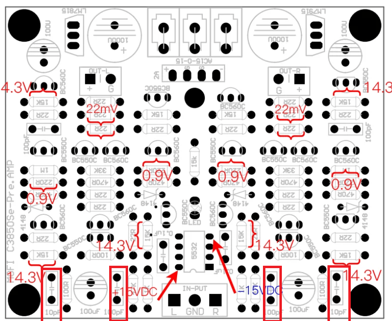

I'm not sure whwat's you have proposed in posts #30 and #31. Could you please draw the proposed changes on the image below.at berlusconi:

Hi

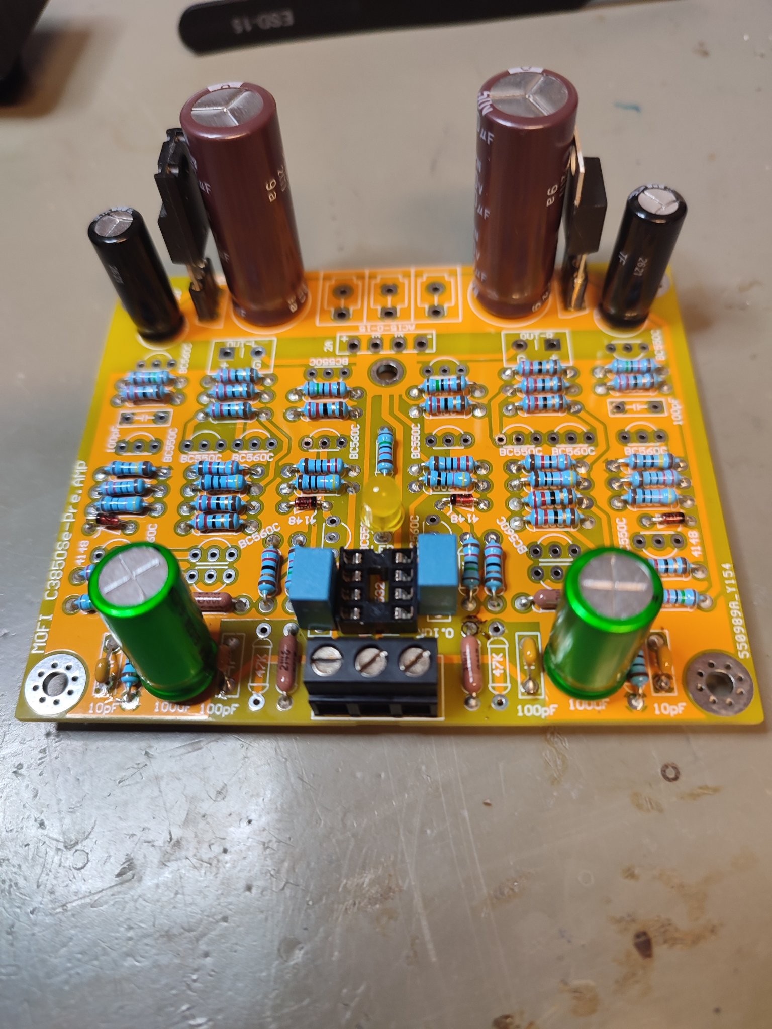

the caps in the red frame should be changed.
1 the frame with 100pF should be change to 220pF these are the input filter - before opamp.
test-measurement
2 the frame at the 10pF should be changed after test 1 with also 220pF - these are the filtering after the opamp.
thx
test-measurement
thx
You could start with changing at one channel and then compare.

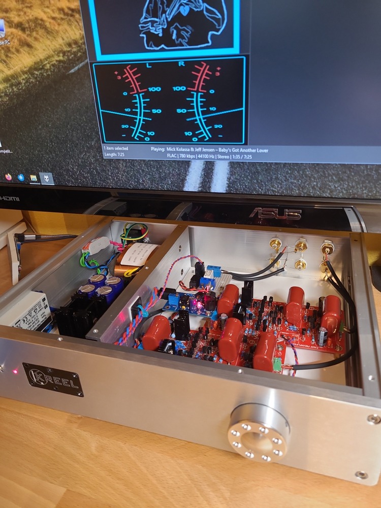

Apart from this from the beginning I have said that it had good measurements, pro above some recognized brands, but I also said that for me, it was too neutral, so I will try to bring it to my taste (when I have time), the other day I tried replacing the ceramic capacitors for other values and copper, and it sounds a little better quite imperceptible, but I notice it, and the best thing is that I did not have to buy the capacitors, I made them, and I will put as and measures.

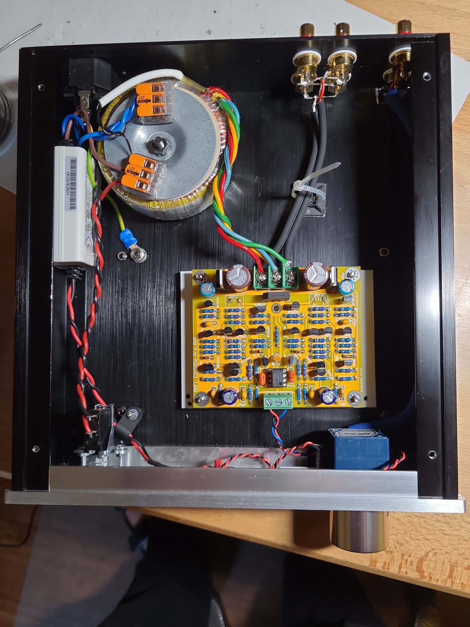

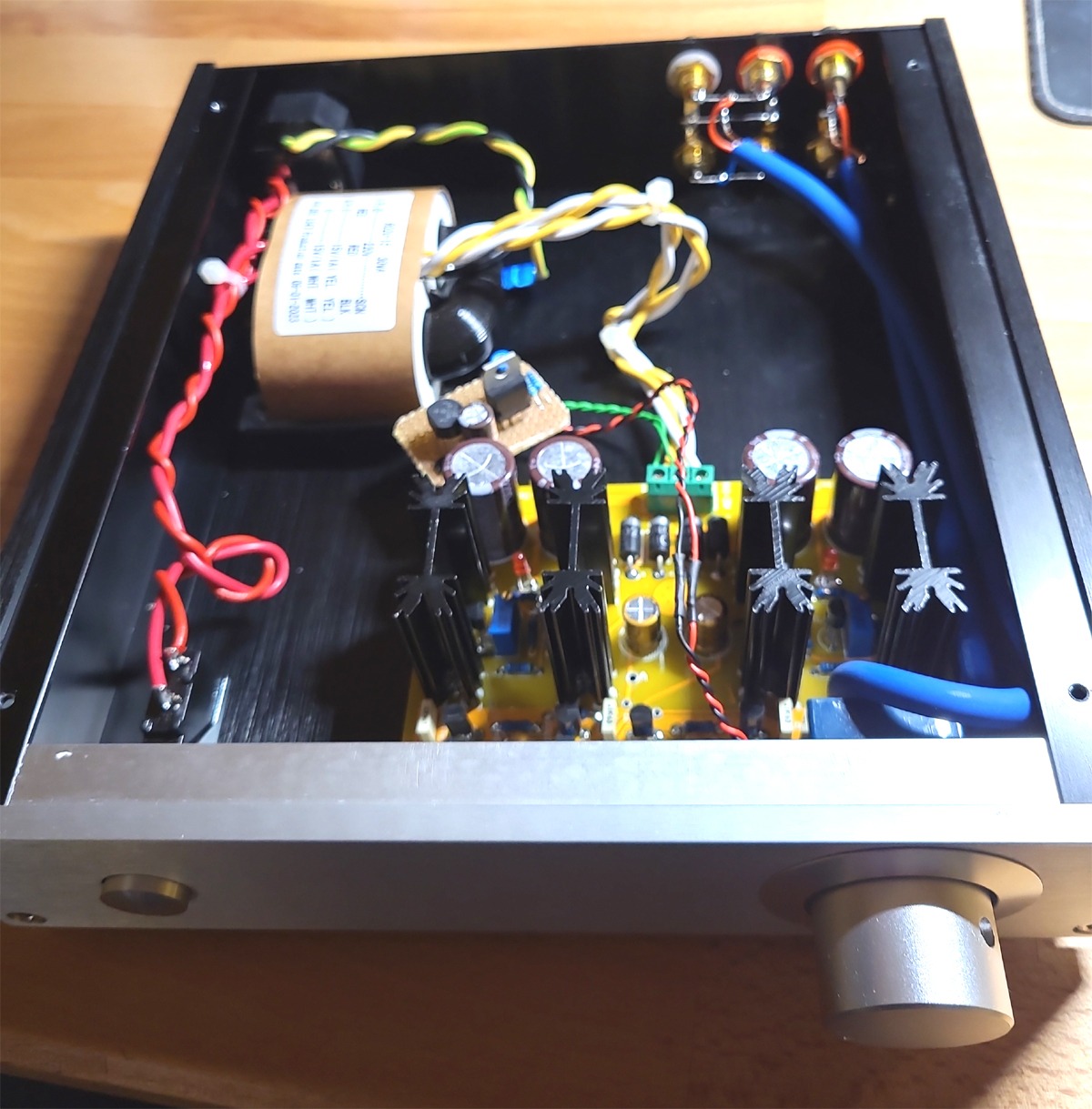

I was a little bit busy too...built in the C3850 in an old housing. Tomorrow i will make the first hearing test. I dont like the ceramic capacitors, will see what is in stock...
My first change was to change the 100 µf capacitors at the ic into 100 µf bipolar. I had in stock 🙂

yes the ceramic caps should be changed in a adequate film cap - its also written in FH9 by XRK.

First hearing session....sounds very good... 🙂 I have tested with my AKG 712. No hiss, no hum, deadly silence if foobar is paused.
I have done 3 changes of components. Feedback capacitor 100 µf is a bipolar type now, the gain is lowerd to ~ 5x with two 560 (556) ohm resistors. The 100pf capacitors parallel to 1M near output are glimmer capacitors.
I have to wait for more components (220 pF and more). I have ordered but it takes time...if i find time tomorrow i change the input ic.

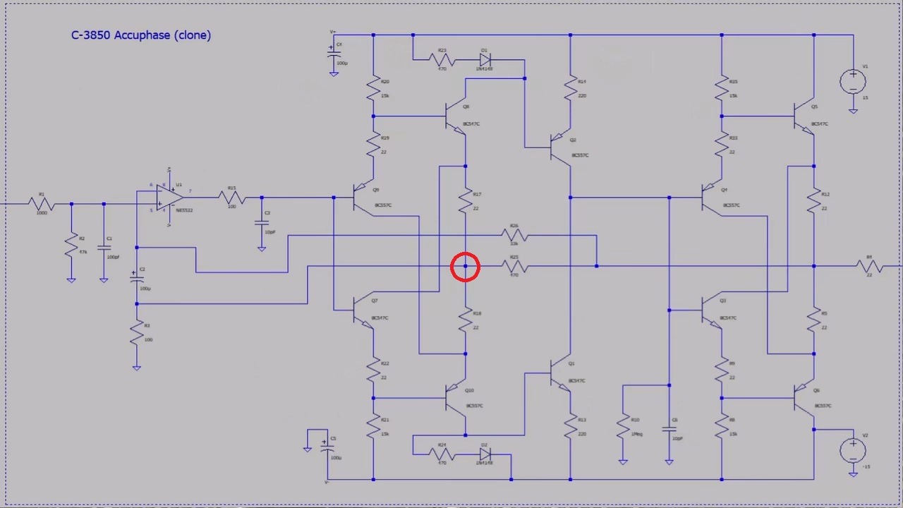

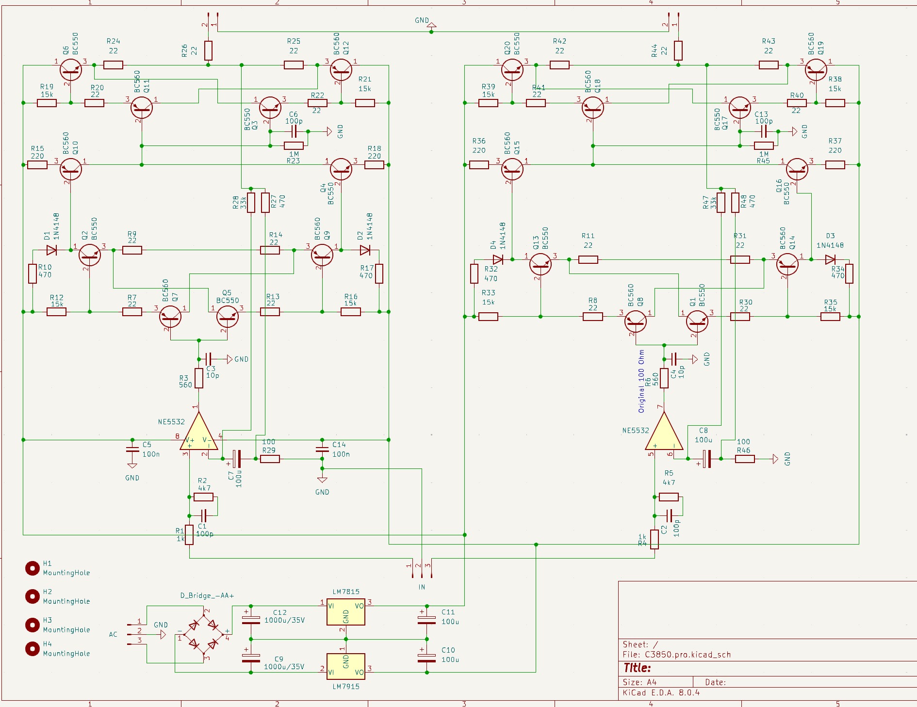

With KiCad I have made a new schematic with values.

wow...thanks Peter for the KICAD schematic!

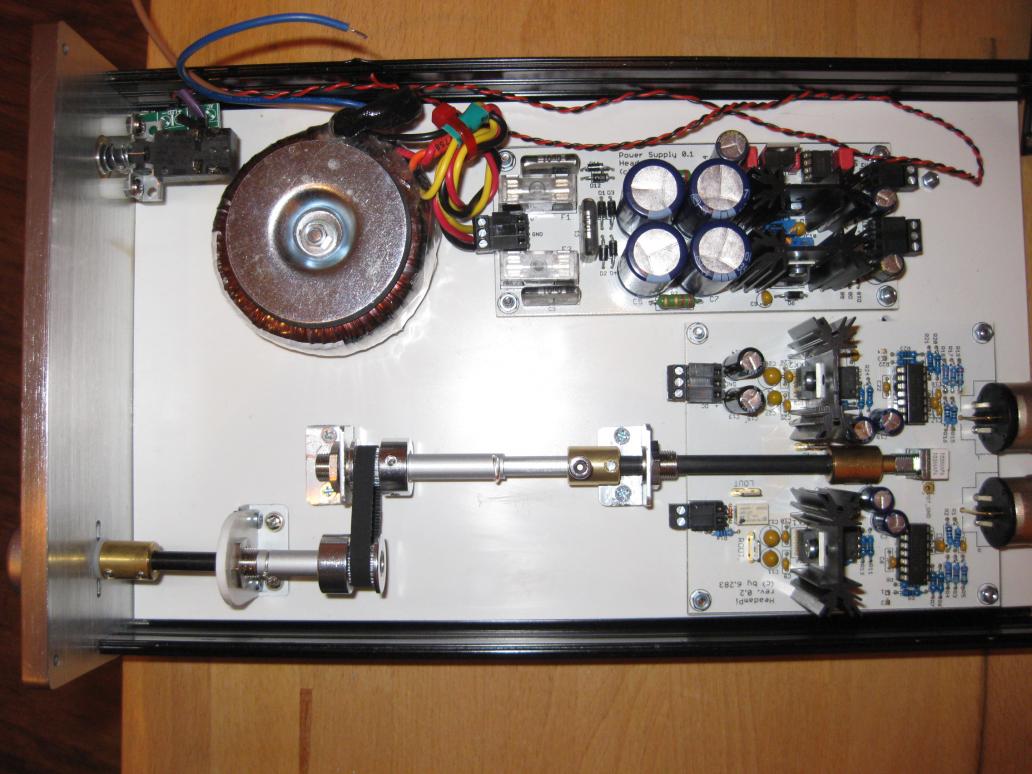

yes, i have 3 preamps more. But in the first time i will use my headphones. Later i will hear with only one amp and change the preamps.

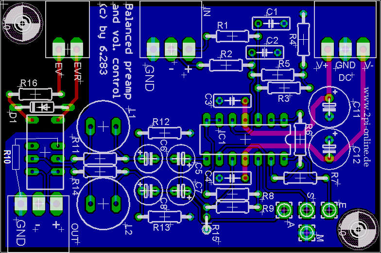

P30ZF, a JC2 Clone and one preamp with LM49740. The last one was designed by a forum user 2pi, oliver, at diy-hifi-forum. I need sometimes because of its balanced outputs.
Thanks to oliver..because i am the only owner of an headphoneamp with timing belt. Photo ? 🙂🙂🙂

@Kleinhorn please check your schematic. Both the website and Beeny schematics show a connection from the 470R in the feedback circuit to the output of the Class A stage between the two 22R emitter resistors, which then continues on to the point between the 100R resistor and 100uF cap. Circled in red in the Beeny schematic below.
I had a misstatement earlier that the schematics from the website and Beeny are different. I think they are the same.
Thank you very much....i overlooked that connection. Tomorrow i will correct that mistake, a little thing. I upload the new schematic then...
Greets
Peter

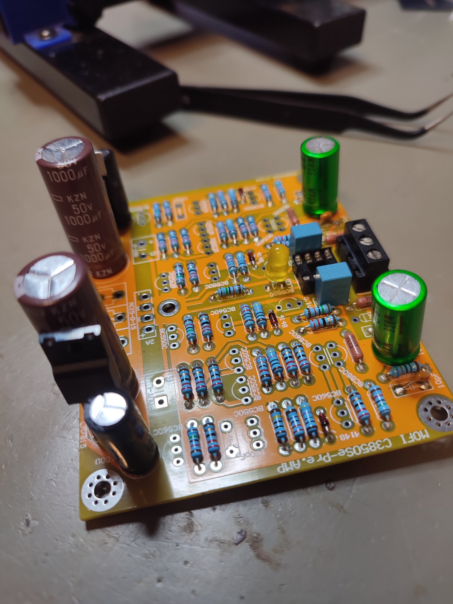

my pcb is partly done...mouser delivered faster.🙂
gain is set with 680R --> 4.61dB

ooops...i see...i was too fast...some resistors are not good soldered...have to check...
