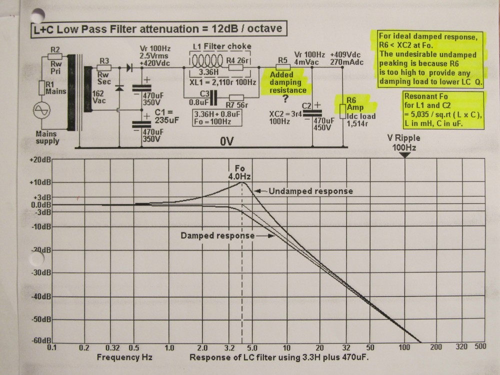

I always defer to Langford Smith's Radio Designers Handbook for the best explanation of how rectifier chokes work and their advantages.
Allen Wright extolled their virtues in his Tube Preamp Cookbook
take choke between 4mH and 10mH, no more than 0R33 of Rdc, toss it in place of R in your CRC

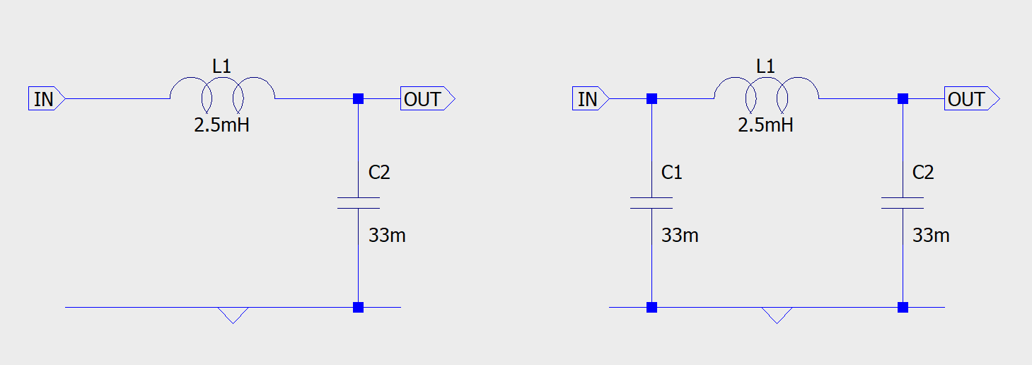

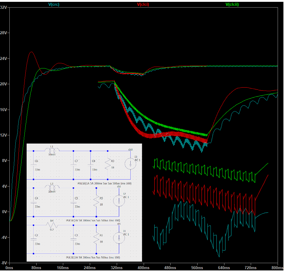

Anyway, before I leave this, I would like to share my findings regarding these chokes.
Extreme_Boky
My response to you was meant to be; perhaps the sim is good enough for this purpose, and that the parasitics will vary a lot according to the layout of the amp.
If we use the calculator provided by tombo56 we get a resonant frequency between 8.76 and 13.85Hz.
If we were to use 1mH choke, we would need 140mF to get 13.45Hz
If we were to use 2.5mH, we would need 66mF to get 12.39Hz.
The L + C2 is the low pass filter where resonat frequency is calculated.
When we add C1 of the same value as C2 it becomes a pi filter. I suspect that this is when the ringing occurs.

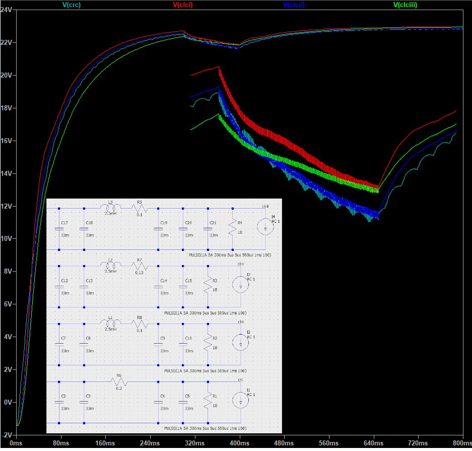

Here is Hammond 159ZL as an example ; 2.5mA 10A DCR=44mΩ
from bottom to top ; cyan red blue green
If we decrease C before L, or increase C after L most of the ringing goes away, more if we increase after C ( 2.5mH needs more C )
The first part of the curve is under startup and the second dip is a stressload of 1-5A for 100ms (0.1 second). Perhaps a bit extreme but needed to expose any ringing under load.
we are talking about; R5 damping resistance.
Here is Hammond 159ZL as an example ; 2.5mA 10A DCR=44mΩ with damping resistor
I like to see the load curve more or less the same as the CRC. Then I think the ringing is to a minimum. The green here is where it is because it sags less due to more C.
The DCR is the chokes resistance at DC. With this choke it would equal a CRC with R=44mΩ at DC.
I have found that a larger inductance with a smaller DCR will ring more than a larger inductance with a larger DCR.
With the damping resistor we can tune the DCR of the choke.
If we sim the choke 2.5mH/44mΩ +R=100mΩ, together with the same choke with changed DCR to 144mΩ, the resulting curves are identical.

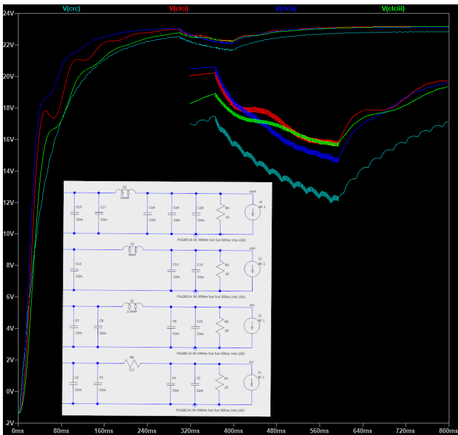

Here is a sim of 159ZJ which seems popular here.
This one looks promising with CLCC.
from bottom to top ; cyan red green
The green one is 33mF + 10mH + 33mF + 33mF.
This is like hiding our best 33mF caps in calm water behind the L, and we can use a more brute of a cap before the L to deal with the hammering ripple from the rectifier.
The square wave you see on the rails is the load square wave.
With music playing we would see the music signal here.
On the green it is smaller due to parallel capacitors; the ESR is halved.
The ESL is also halved. My understanding is that this increases speed of the current through the capacitor.
Music is the current through psu capacitor.

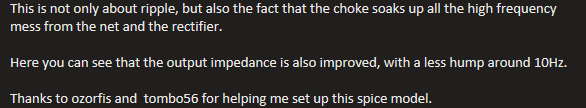

This is not only about ripple, but also the fact that the choke soaks up all the high frequency mess from the net and the rectifier.
Here you can see that the output impedance is also improved, with a less hump around 10Hz.
Thanks to ozorfis and tombo56 for helping me set up this spice model.
Perhaps you should consider a CLCC instead of CLCRC.
With CLCC you would reduce the ringing and lower the resonant frequency and output impedance.
I am not an expert in Ltspice, but I find it a good tool to try out new ideas with.
If any of you have been contemplating learning LT spice, this is a simple circuit for you to get started with.
I see that quite a few of you have implemented damping resistor or/and more C after L, so I'm not claiming to have reinvented anything here, just trying to learn and put it into perspective for myself.
I also hope that this can give some of us less experienced builders some inspiration to make choices and start building.
I am including the Ltspice file for you to play with if you want.

Very comprehensive summary of discussed so far and a very good starting point for everyone that is interested to investigate further. 👍
That is a point I agree with. Good power supply is foundation of a good amplifier. That’s why I opted to use super regulators for my amplifier build. CLC is, probably, the best power supply one can get with simple solutions.
If you read the long but very interesting thread Power Supply Resevoir Size you will find that the music rides on the rails and the music is the current through especially the last psu capacitor modulated by the output transistors / fets. So it it good to have a clean rail voltage.

Re inductors in power supply..... I have mixed feelings.... no doubt the high/mid spectrum is cleaned-up, but the bass region is much more difficult to get right... it requires a full retune of other little spots/things... 🙂
Thanks for sharing your R21_Positive & R21_Negative designs. Very nice of you.
I’ve made my version for high current, up to 10 A, and wide voltage range. It works in my LuDEF.
Hi, a very nice design with impressive mesurements you have here 🙂
PSSR, noise, transient responce and output impedance seem to be in a different league.
A pita with parts shortages.
Did you or anyone else compare this with CLC.
🤔 If time allows, would you mind sharing some more details on you findings regarding this.
Could this be due to the low frequency ringing we get if we are close to a pi filter ?
Could it be due to the peak in output impedance at low frequency ?
Could it be due to current saturation in the choke ?
What I have found so far is that a choke's current rating should be bias current + max expected peak ac current (please correct me if this is wrong)
