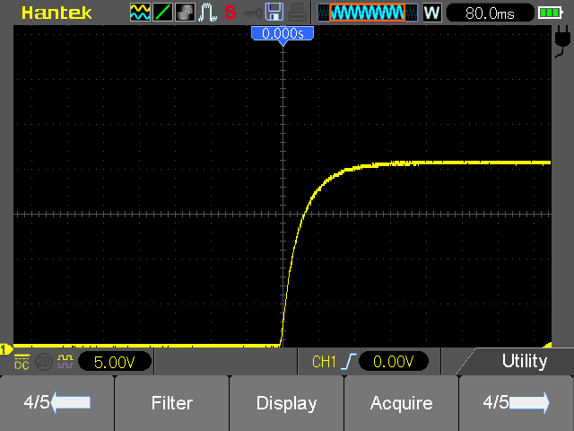

anyway - I can't see any significant ripple under nominal amp Iq, chokes are cold, same as caps ....... same as diode bridges
frankly - didn't waste any time in sims, having enough xperience with CLC filters from before - exactly with chokes pulled from various old equipment ; as long resonant frequency is under audio range , you're probably good

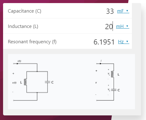

with mine - 4m7H and 33mF, I'm slightly above 10Hz and that's just simple calc - not sims , so without including ESR of caps and Rdc of chokes and also fact that CLC is in question , so Pi filter - not just L filter cell
point being - I'm thinking - when you're close enough, just grab it; math involved is anyway over my head

Moving country resently, I left behind my old large scope, and need a new one.
Preferably a pc scope for space reasons.
May I ask what model you Hantek is?

My scope is Hantek DSO 1062B, literally a very “handy” device.

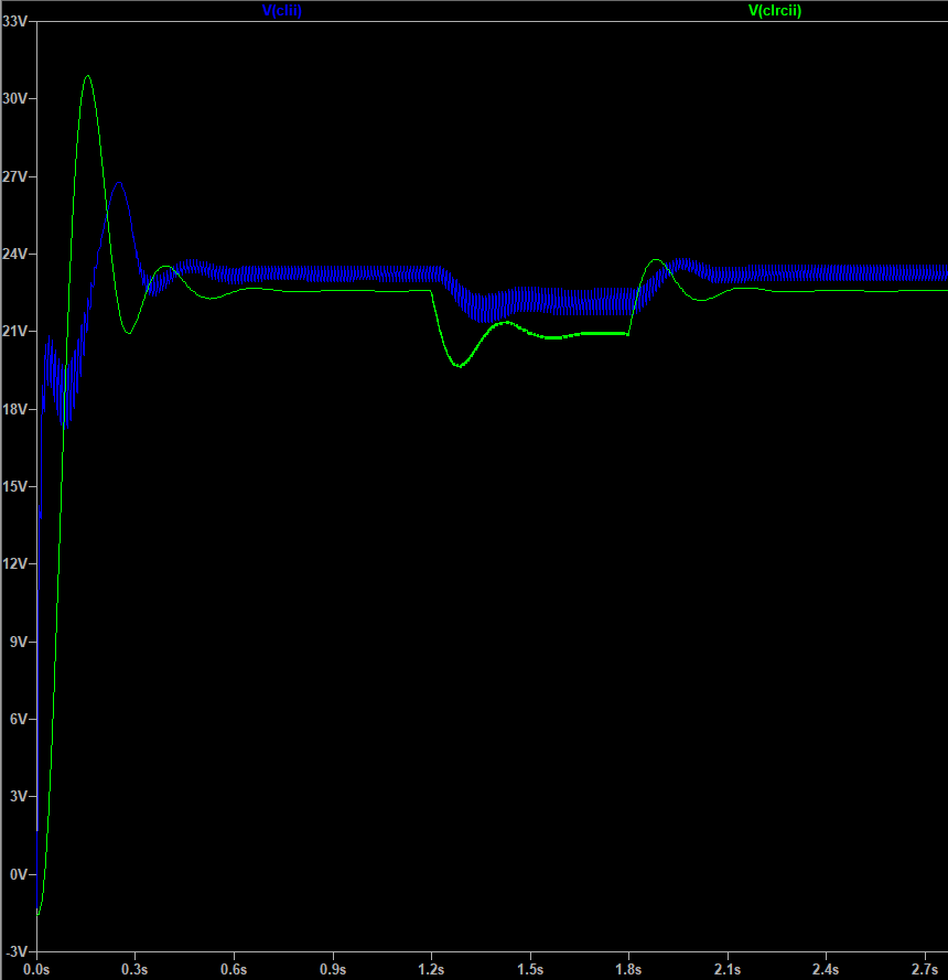

I did a new sim with your 65mH/0.3 with the new trafo impedance.
A bit lower ring on startup, but I still don't like what I see on that rail.
Maybe this is what some people call ringing?

Yes, that would be ringing. I still consider that model is not exact as real circuit, but it is close enough. Think of mΩ and nH that any PCB track or wire in real PS has. Anyway, 65 mH is too much and I would continue with values you intend to use with real PS.
The useable range for inductance in a CLC configuration is probably about 2.5 mH to 10 mH. Larger values will cause issues as we have been seeing here. Whether additional resistance is necessary will depend on the existing DC resistance of the inductor as well as how the amp draws current from the PSU. For example, the M2 has a delayed turn-on due to the capacitance in the opto-isolator bias circuit.
The sim does not take into account all accompanying wiring to and from the CLC bank. Also, the amp PCBs and their traces/components leads' reactances (reactance because in real life you will mostly have AC-like current draws... unless you'll be using the amp to heat up the place) are omitted from the SIM.... Build it, hook up the scope and stress the whole thing a bit. If there's oscillations/ringing, place a resistor to damp/dissipate that ringing...tombo56

Would you mind sharing this formula again
perhaps on a napkin with a picture 😉
after ☕

I actually think that the 65mH/0.3Ω choke was a good example of what can be the issue with CLC and what to look for.
My thinking is that the pulse stess test between 1.2s and 1.8s in this sim could resemble a bass drum attack or other rumbelings into 6Ω, 4Ω or even 3Ω load. If you play a girl on guitar you would probably not see any of this.
I do agree that parasitics reactance ( capacitance and inductance ) between wires & pcb traces + resistance in wire & traces play a big role in this. It would make the spice model quite complicated though.
If you have a good amp layout with short tightly twisted wires from ac in through to speaker out + a pcb with good layout regarding loop areas + good grounding, you would possibly get better results in real life.
But who knows, if an amp looks like a spiders web, could it look worse?
