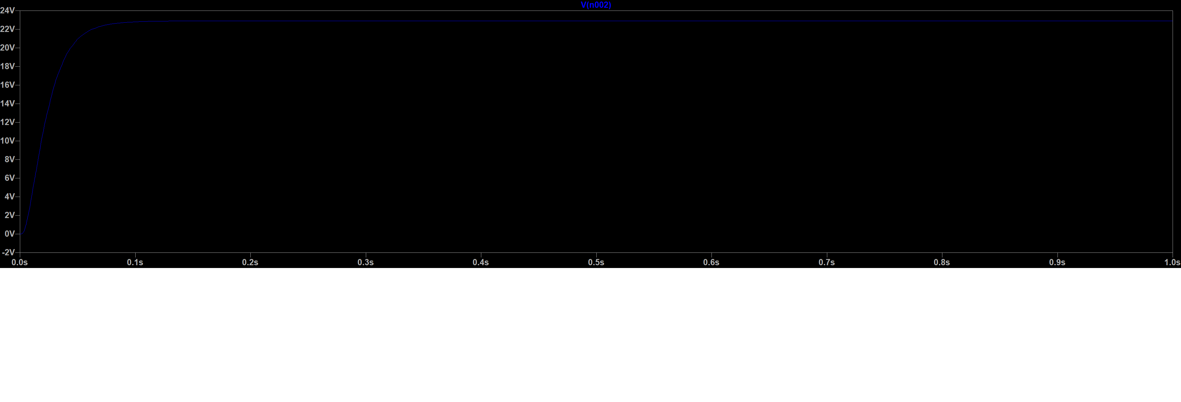

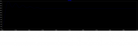

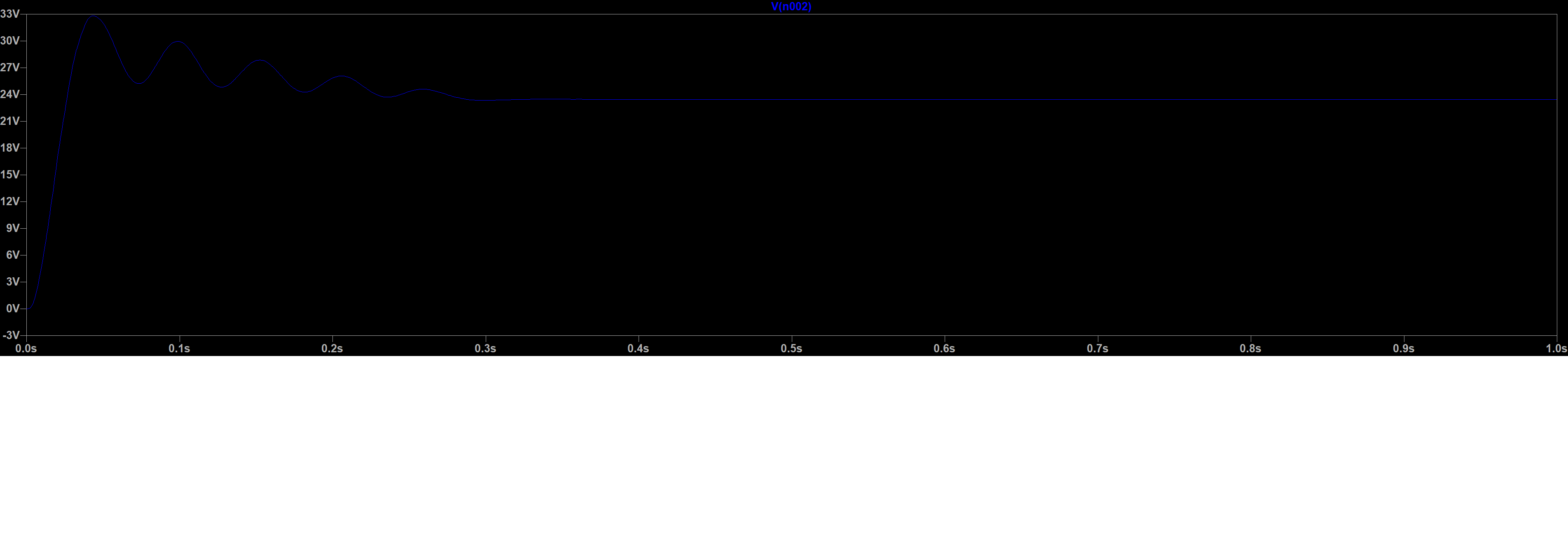

Just in case someone is reading this again - like me. Yes CLC will ring without a little series resistance, which your amplifier might not like. You can easily simulate it in LT-Spice for your specific PSU. For 2.5mH and around 100mF you want around 0.2 Ohms 20+ Watt resistor. The 44 mOhms of a 159ZL is too little in my case. Higher inductance will give you even better ripple but you will also need more resistance and generate lots of heat.

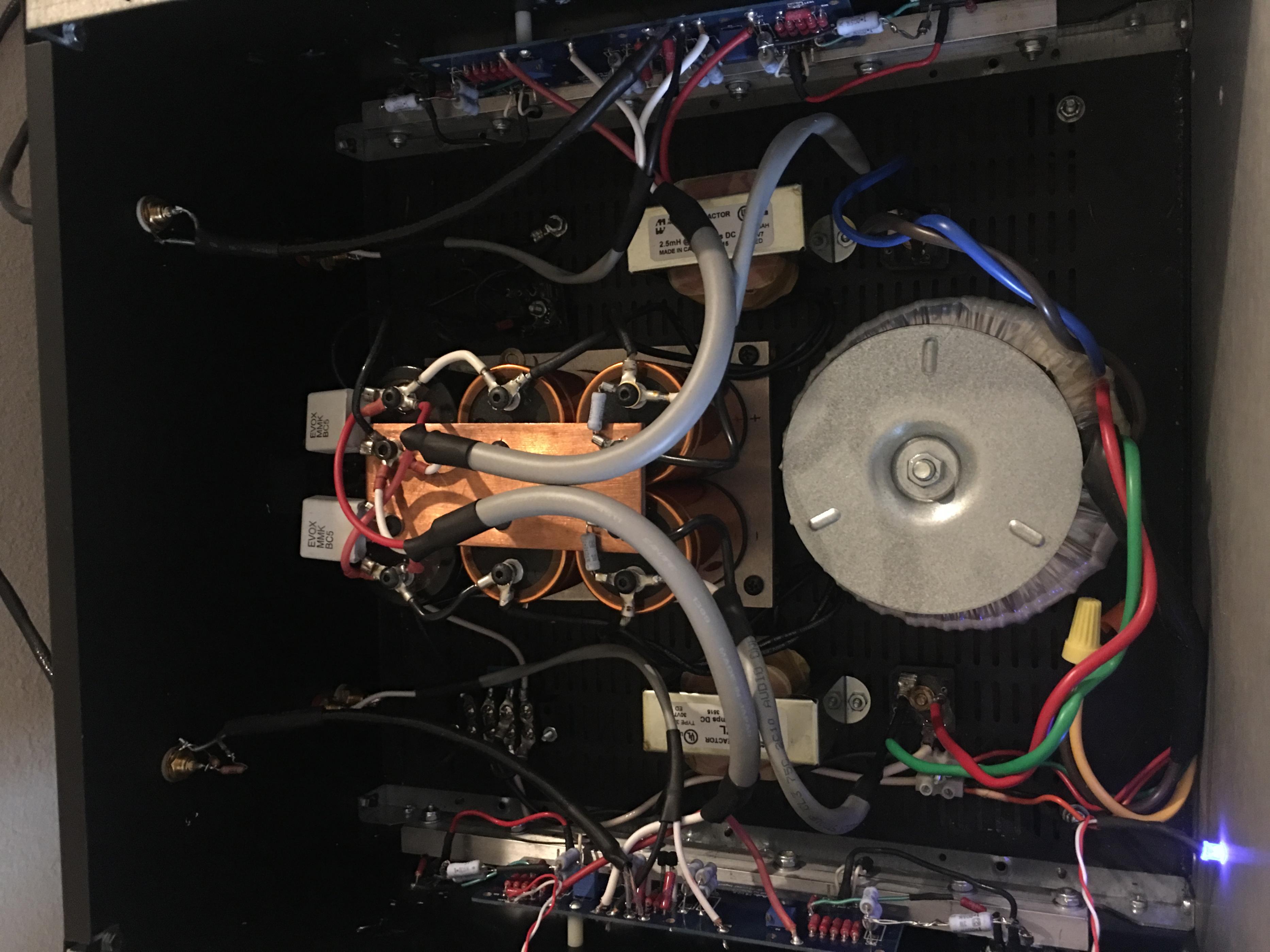

I recently rebuilt the PSU in my M2x. Went from a single shared CRC supply to dual-mono CLC supplies. I used the Hammond 154B chokes (3mH, 1.5A DC) with 2.2 Ohm, 3W resistors in parallel with the chokes. Works brilliantly, completely silent with ear next to my speakers, and sounds fantastic.
All chokes have some DC resistance. It is up to the builder to determine the best means of preventing inductive ringing. Either a small added DC resistance, or a larger parallel resistance can work.
Reactions: 1 users
Just to be clear, by "Went from a single shared CRC supply to dual-mono CLC supplies" do you mean two toroid transformers, each with it's CLC filter feeding a channel?
