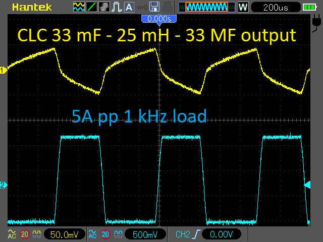

Yes, we are interested if there is any ringing at CLC output on load change, or what transient response looks like. I’ve set up test case with CLC as 33 mF – 25 mH/0.9 Ω – 33 mF. As chokes were used secondaries of two smaller transformers. As load was used current sink governed by signal generator (my standard test equipment for power supplies). Load was 5 A peak to peak at 1 kHz and limited rise time to stay within possible speed of change for the real audio signal.
Test reveals that there is absolutely no ringing and response is clean. Response using 65 mH/0.3 Ω was the same (ripple was cut by half).
Most interesting fact may be that CLC transient response was exactly the same as with CRC consisting of 33 mF – 0.33 Ω – 33 mF.
My conclusion is that with choke we get much lower ripple and less voltage sag at very low frequency load. But, from several hundred Hz and up, performance of PS completely depends on output capacitor and is exactly the same for CRC or CLC.

Just to clarify, I checked as well pure square wave load with 1 us rise time and frequency up to 20 kHz. Response was always clean. At higher frequency, response changed from sawtooth to pure square wave, with smaller peak to peak value. That is expected as output capacitor is able to sustain its voltage for this short period of high load.

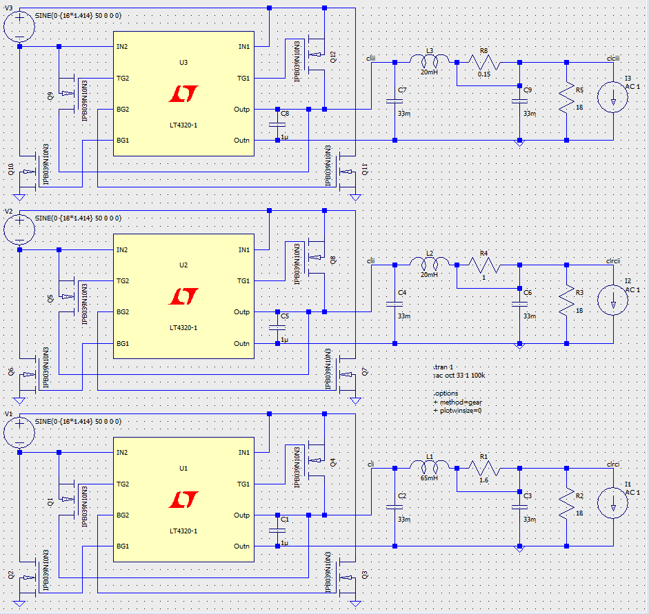

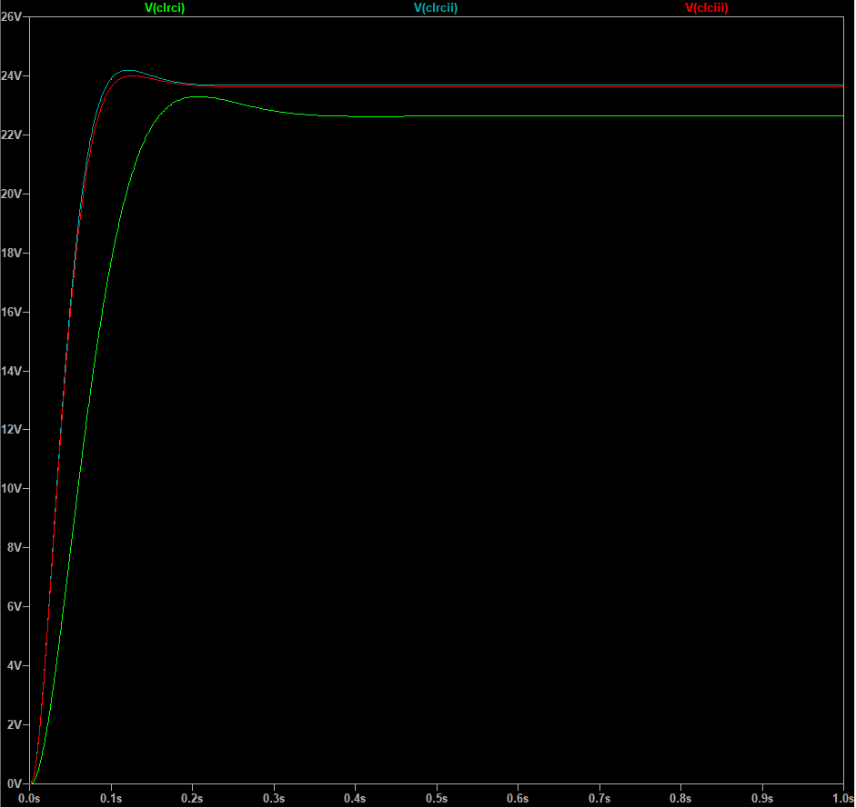

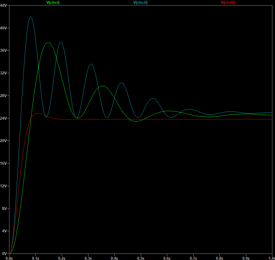

Here is how it sims in LTspice
green= 65mH-0.3Ω
cyan= 20mH-0.013Ω (Hammond 195M10)
red=20mH-0.9Ω
Here is how it sims with additional series resistor
green= 65mH-0.3Ω +1.6Ω
cyan= 20mH-0.013Ω +1Ω (Hammond 195M10)
red= 20mH-0.9Ω +0.15Ω
The red=20mH-0.9Ω seem to correspond to what PRR said here
Try to aim for 20mH-100mH, near 1 Ohm. (Less will ring, more is distressing voltage drop.)

Here is how my sim was set up.
I was using LT4320 as that is what I will use in my new psu.

Nice post! You show very clearly that more inductance leads to more ringing, and that more inductance requires more series resistance to suppress the ringing. I've been modelling in PSUD2 recently, and drawn the same conclusions.
The big question is how much this matters. I wish I knew! I'd guess that varying current draw may provoke some ringing, so it probably isn't just a start-up issue. No? But then the next question is whether that matters - if the amplifier has decent rejection of ripple at 100 or 120 Hz, how well can it reject ringing at around 20 Hz, or at subsonic frequencies?
One thing that seems clear, though, is that additional series resistance in the PSU is undesirable - it will make the rail voltage less 'stiff' with varying current draw. In fact I'm wondering if the best CLC supply is one with just a very small amount of inductance. A mere 1 mH will reduce ripple substantially compared with CRC, but require no more series resistance. Win win?

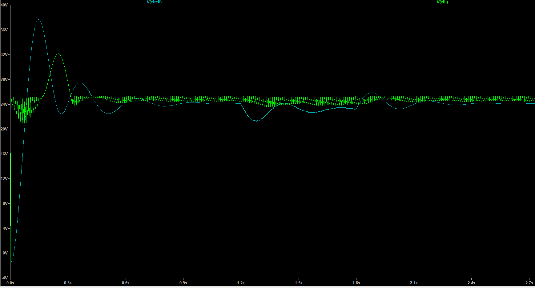

I had inductor max. current to 5A.
I have now changed it to 3A and added 200pF.
It did not make a lot of difference on the startup peak voltage.
I had and have 18mΩ ESR wich is the value of 33mF CDE SLPX and guestimated 20nH.

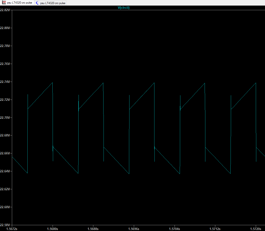

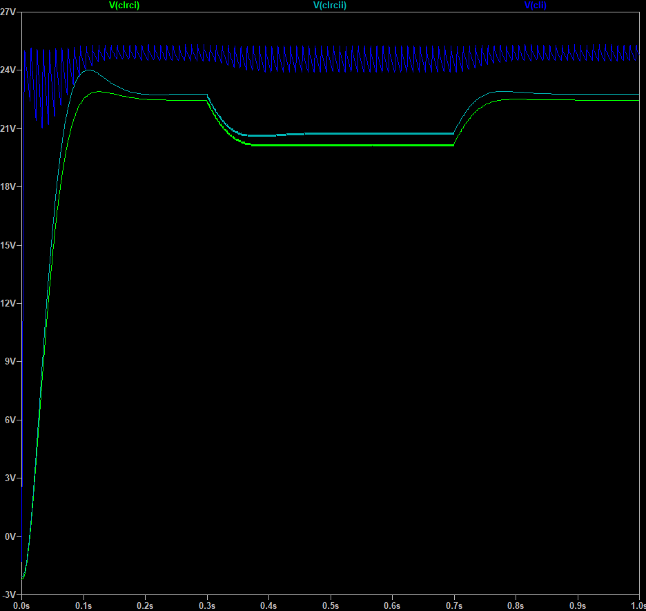

Thanks for the tip on pulse loading, I've set it to PULSE(1A 5A 300ms 5us 5us 500us 1ms 400)
cyan is for your 20mH 0.9Ω
green is for the same, but with 0.15Ω in serie.
blue is the ripple on choke input
It does sag a bit

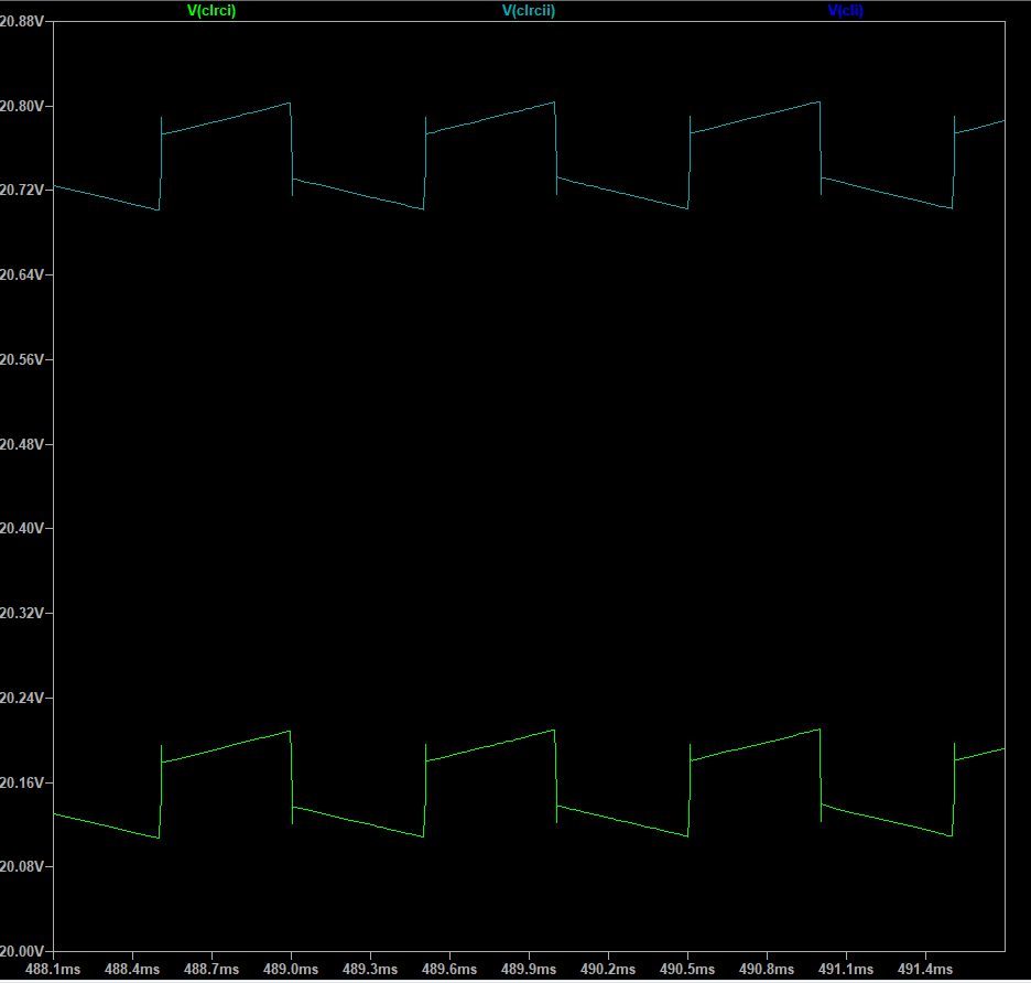

This is a close up of the pulses on the supply line
sims like I need to find a lot more play time :sneaky:
If I find something more of interes I'll post some more

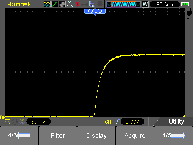

For comparison between sim and real circuit, here is startup voltage waveform of 33 mF – 25 mH/0.9 Ω – 33 mF CLC supplied by 300 VA transformer. It’s evident that there is no voltage overshot. Transformer was directly plugged to mains (no soft start).
Simulation has ideal voltage sources, so it would be better to add supply internal resistance as 0.1 to 0.2 Ω.
