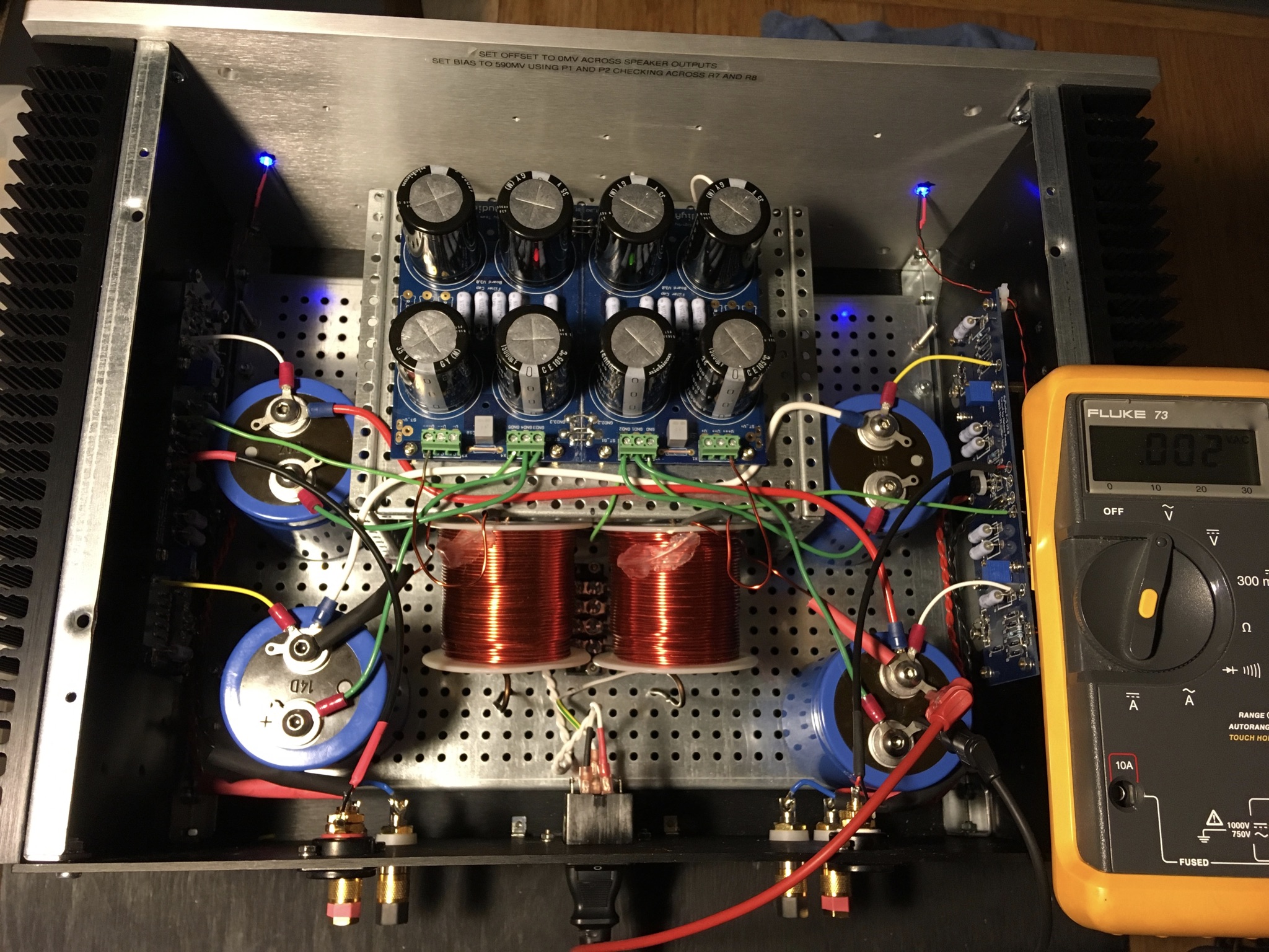

For an C1 Lr R C2 power supply filter , I've shown the transfer function ,
and how to calculate the value of the dampening resistor , in post #134 on page 7 .
Total dampening R = 2 * Zeta * sqrt ( L / C2 )
......................... where Zeta = 0.707 in an ideally dampened system
Also , looking from the supply rail into the amp , the supply rail sees a CCS ( Constant Current Source ) ,
which has a very high impedance . So the Amp itself does not provide any dampening .
and fo = 1 / ( 2 * Pi * sqrt ( L * C2 ))
However , after building this , and conducting listening tests with FAB's USSA 3.2 Amp ,
my advise is to help dampen the system by making C2 very large and leave the dampening resistor out .
Also , if C2 so large , then fo will be subsonic anyway .
To explain FAB's USSA 3 and 3.2 Amps .
FAB has taken the F5 , removed the IRFP240 , and replaced with a MOSFET driving an Exicon Lateral ECW20n20 .
The transconducance of the ECW20n20 is low , hence the need for the driver MOSFET .
Because the ECW20n20 are lateral MOSFET's , the source resistors are 0R01
and are used to be able to measure output bias current .
Same story with the IRFP9240 .
Note how the star ground node is on the power supply board , and that the USSA board has 2 analog ground connections .
One ground for the low current signal transistors 2sk170's and 2sj74's .
The other analog ground for the high current MOSFET's - which are biased at 1.2 Amps .
The transformer I used was 600VA and the supply caps are 22,000uF each .
Not shown in the photo is a Fo Felix DIY EMI filter - which I highly recommend .
... and its one of the best Amps I'be ever heard .

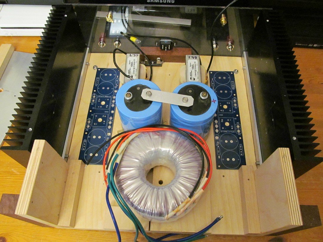

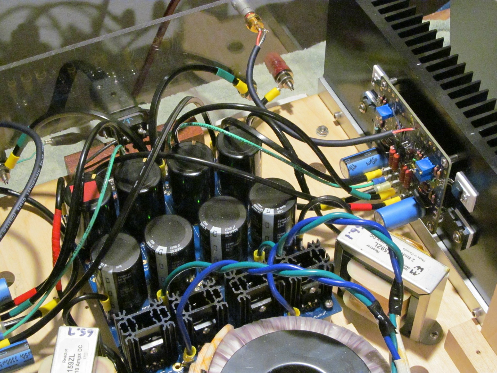

Here is a power supply idea I was thinking of .
  • 600VA AnTek transformer
  • diodes de jour
  • 2 computer grade electrolytic caps take the brunt of the ripple ( the ESR on some of these is in the neighbourhood of 4 mOhms ) .
  • Hammond 159ZL chokes
  • Then the L and R channel get their own bank of power supply caps .
  • Consider using Belden 19364 for the internal hydro wiring because its got a foil shield
Post Covid and central banks printing fiat money , power supply caps have become quite expensive .
But its all about getting current to the load .
From listening , the bigger the power supply , the more the sonics move forward and the sound becomes more natural .
Reactions: andynor

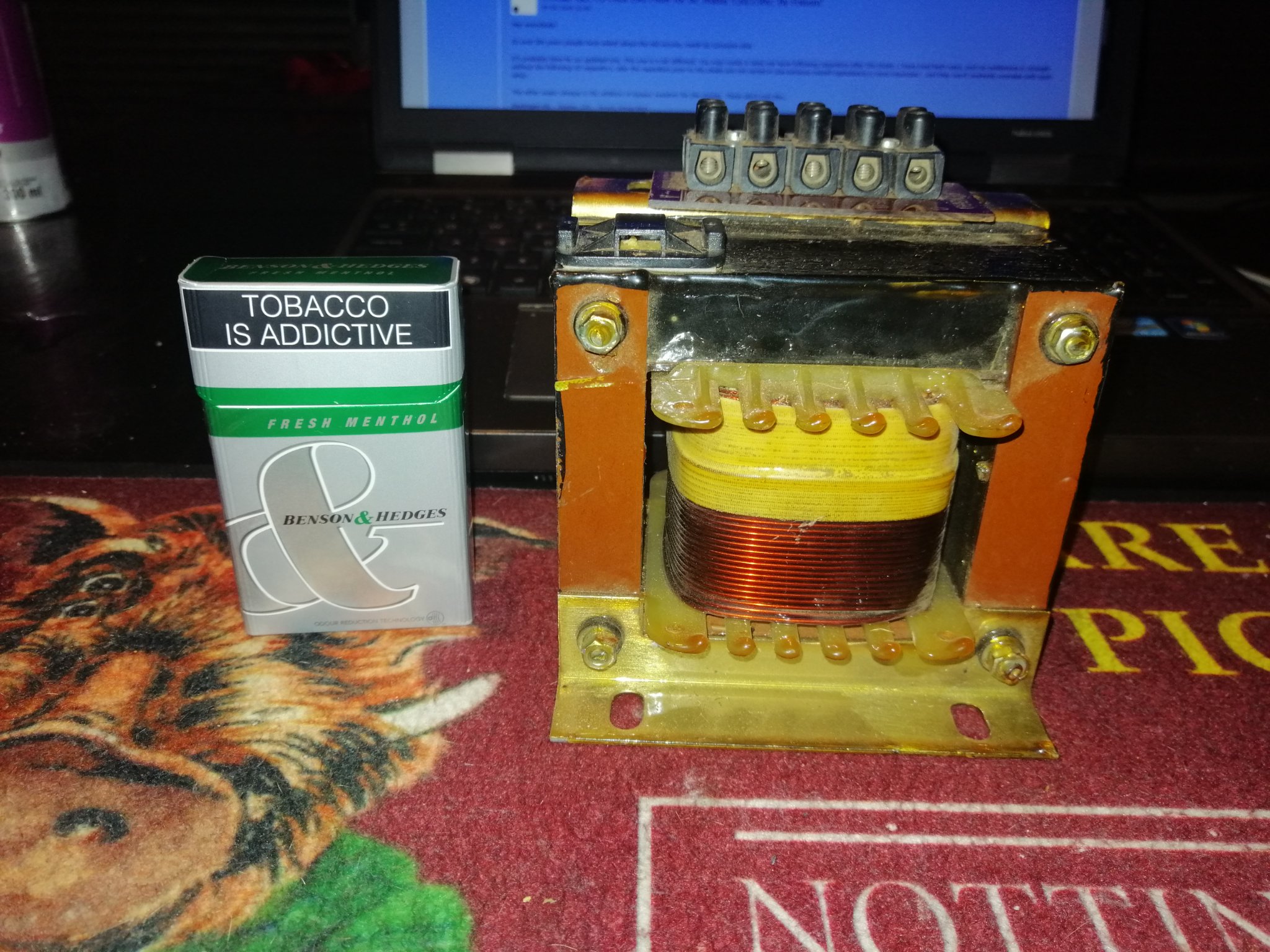

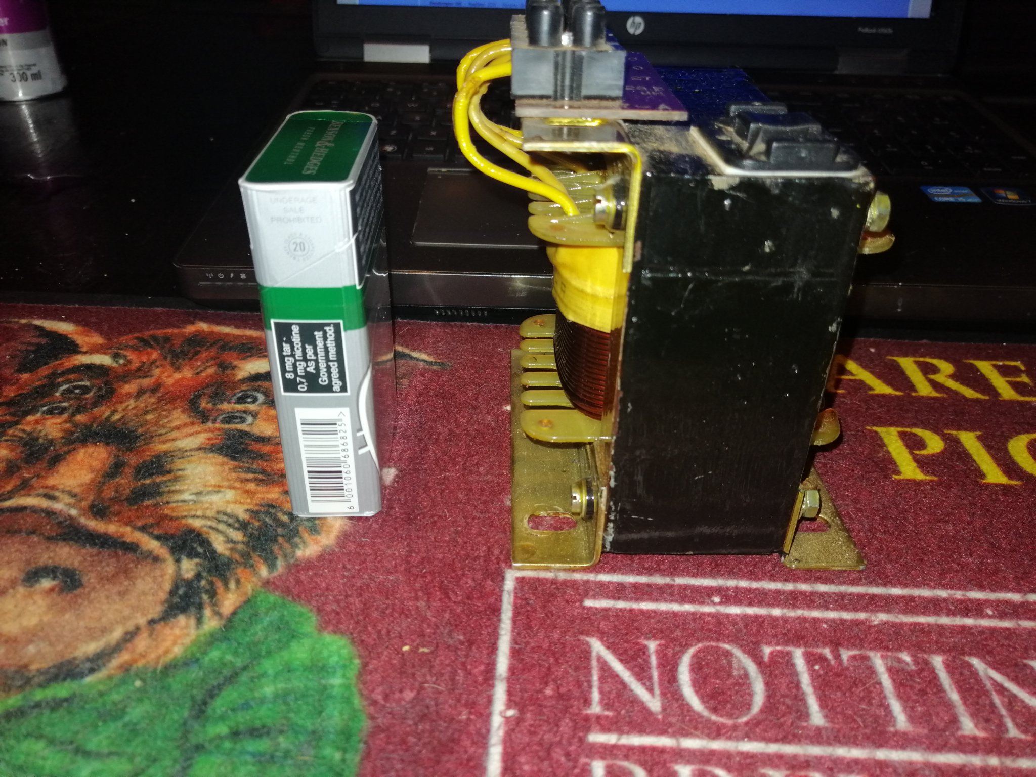

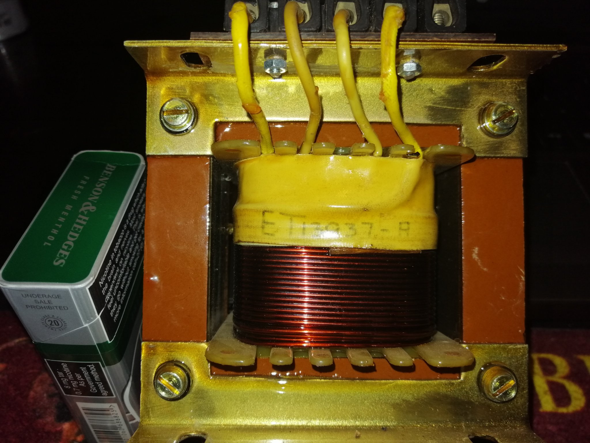

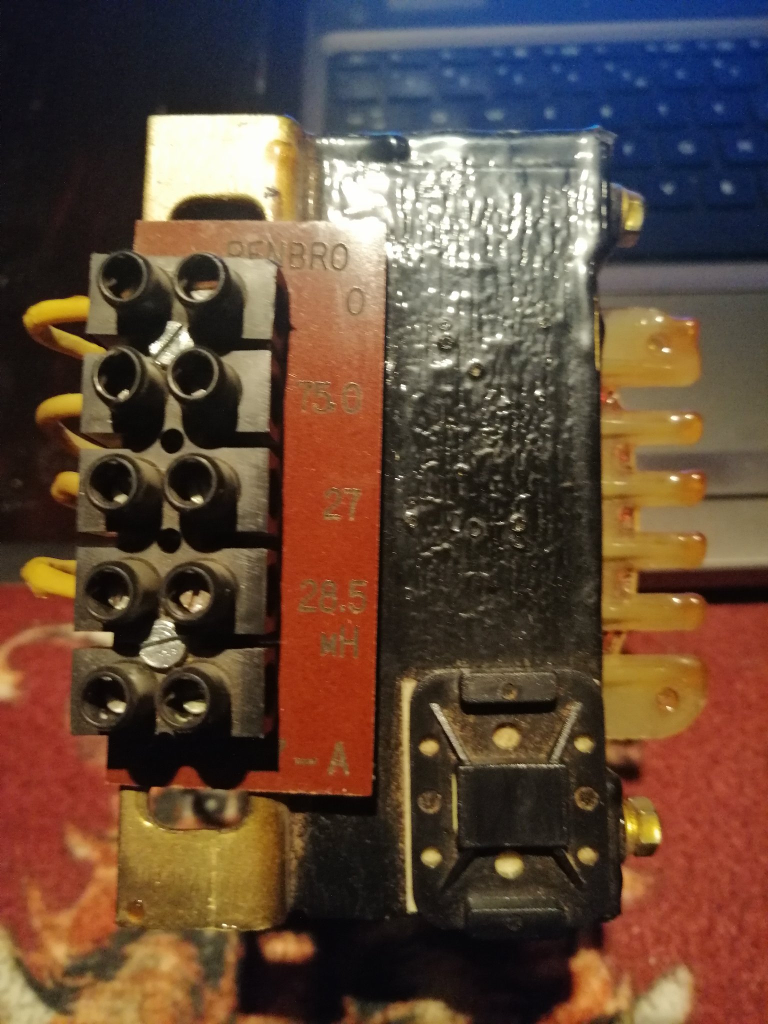

is a 25mH choke overkill?
I'm no expert , but in a power amp supply , I've never seen a value this large .
When current flows through an inductor , a magnetic field is created . That magnetic field then opposes any changes in the current .
So an inductor or choke acts like a current fly wheel .... it tries to maintain a steady current .
If the inductor or choke is too large , when there are sudden current demands , a choke that is too large is going to starve the Amp of current .
Possibly the easiest way to actually test if the 25mH choke is too large is with simulation software .
Set up a C Lr C filter
Introduce a load with a sudden current demand ( step function ) - and watch if the voltage rail sags .
But again , I've never seen a choke this large used a power amp supply .
This is what they look like, not small, looks like 2.5sq windings.
