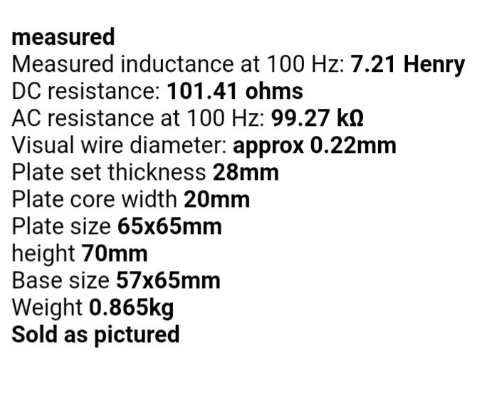

Hello,
I remember there is a formula to calculate the ac resistance of a choke. It will show how much advantage a choke has when being compared to the usual RC network.
I forget the formula and i am outside my country with just a basic smartphone. Because with psud software one should enter dcr of the choke and its inductance is it just this formula that this software uses to produce the graphics.
If you have two chokes with identical current rating. Both 500mH but one two ohm and the other four ohm dcr will the two ohm one work twice as good?
There is energy stored in the choke. I can imagine the lower dcr choke can release that energy quicker and a bigger inductance choke can store more?
I remember some more technical people were surprised i could use so low current rating diodes with my dddac which takes almost ONE A and has some big caps. It shows choke input really reduces the current being drawn to a nice steady line. It also reduces stress in the transformer.
