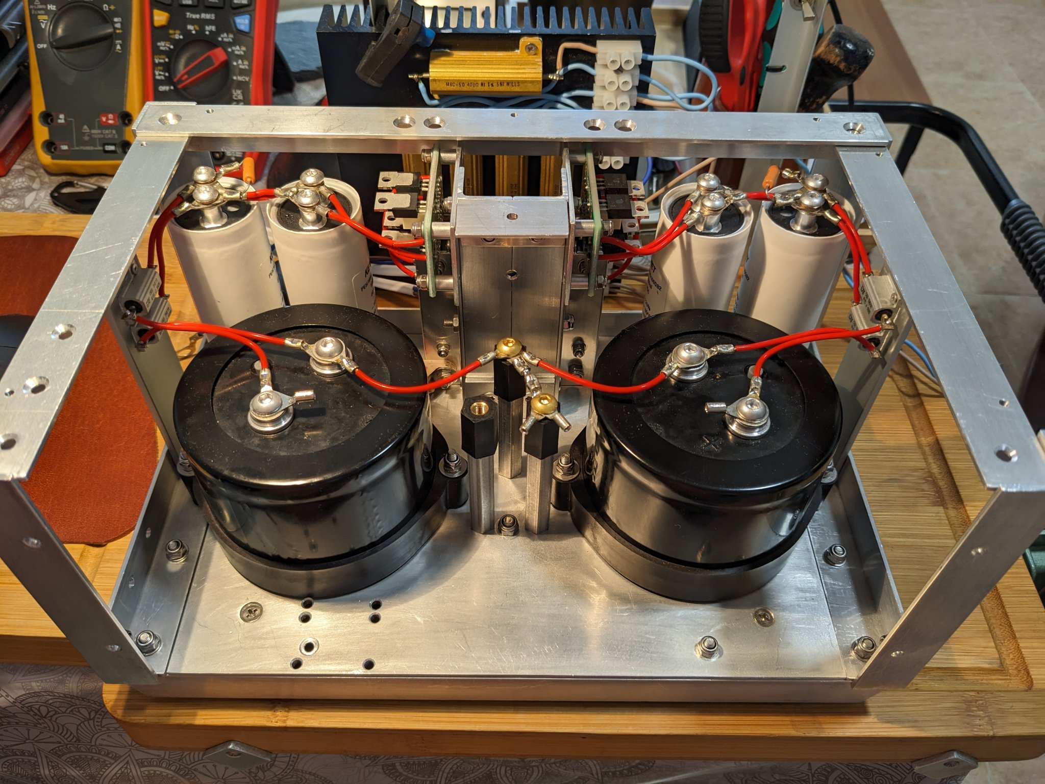

What? Since when is one cap better than several smaller, esp for low ESR...?After this I put one 100mF with low ESR ( FTcap GW ).
In this position I believe it is better to have one big cap rather than several small ones.

I recently bought these caps with 10mm snap in terminals for the DIYAudio Universal power supply board v.3
https://www.cde.com/resources/catalogs/380-382.pdf
380L223M050A052 22,000uF 50Vdc ESR ( 0.023 max - 0.018 min ) 35 mm dia x 50 mm height
But having a look at a PEH169 beast , the ESR is between 4 and 5 mOhms .
https://www.mouser.ca/datasheet/2/447/KEM_A4035_PEH169_85C-3316717.pdf
PEH169KU610VM(1) 100,000uF 40 Vdc
PEH169MV582BQ(1) 82,000uF 63 Vdc

The second capacitor at 100,000µF is separated by resistors on plus and minus pole.
This one is not easily discharged, and will only have gently top-up when needed
Sure you can get low ESR by using several small capacitors, but the wrong kind of wiring or PCB layout can easily increase both the ESR and the dreaded inductance to unwanted values.

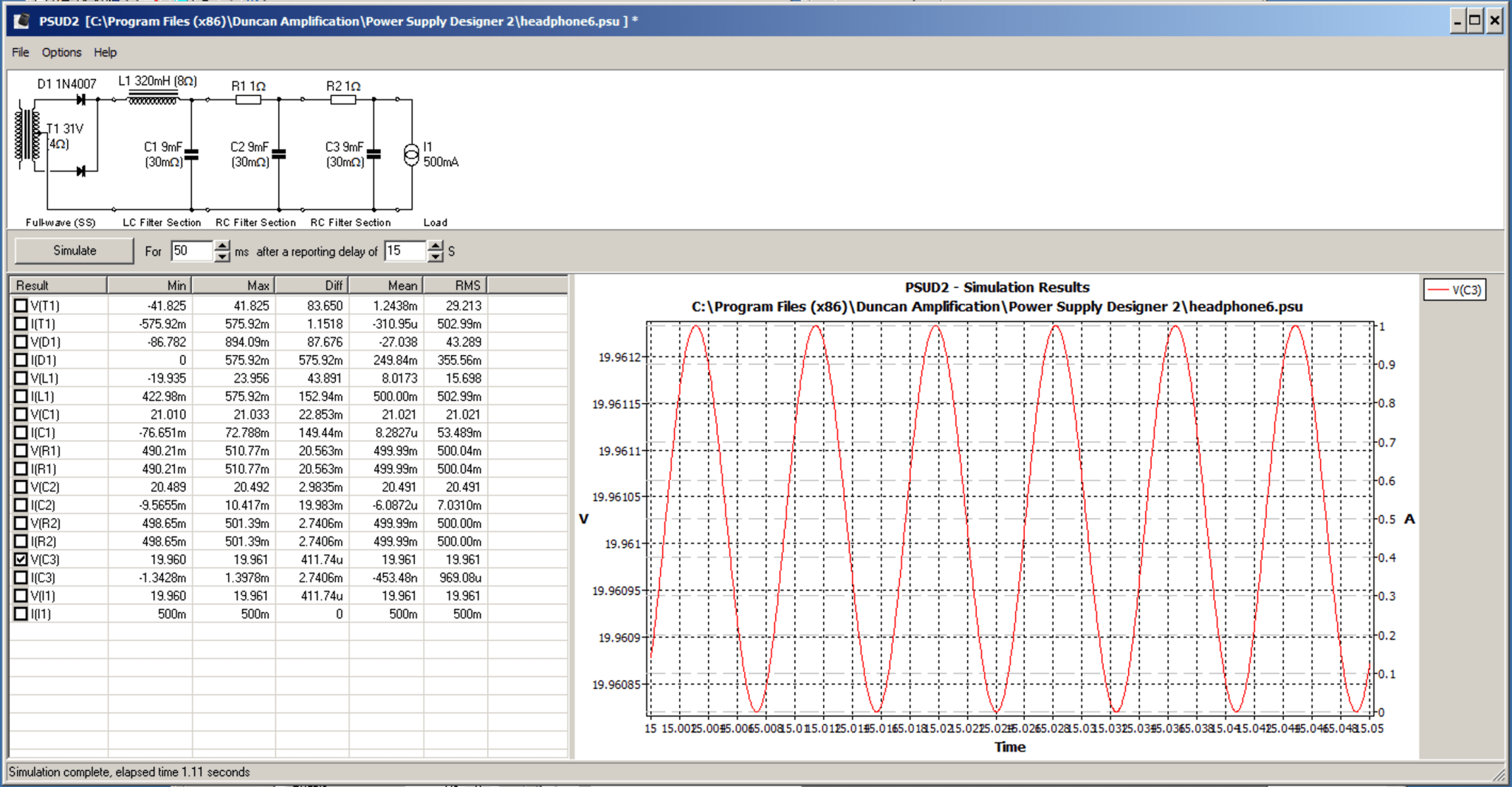

I know, I must try PSUd software to see the inpact of these design choices.

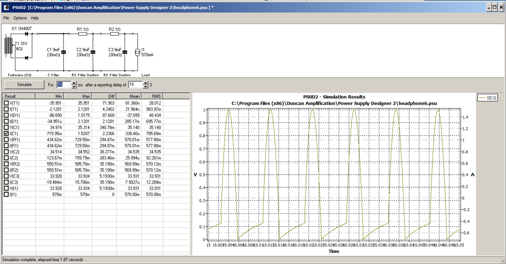

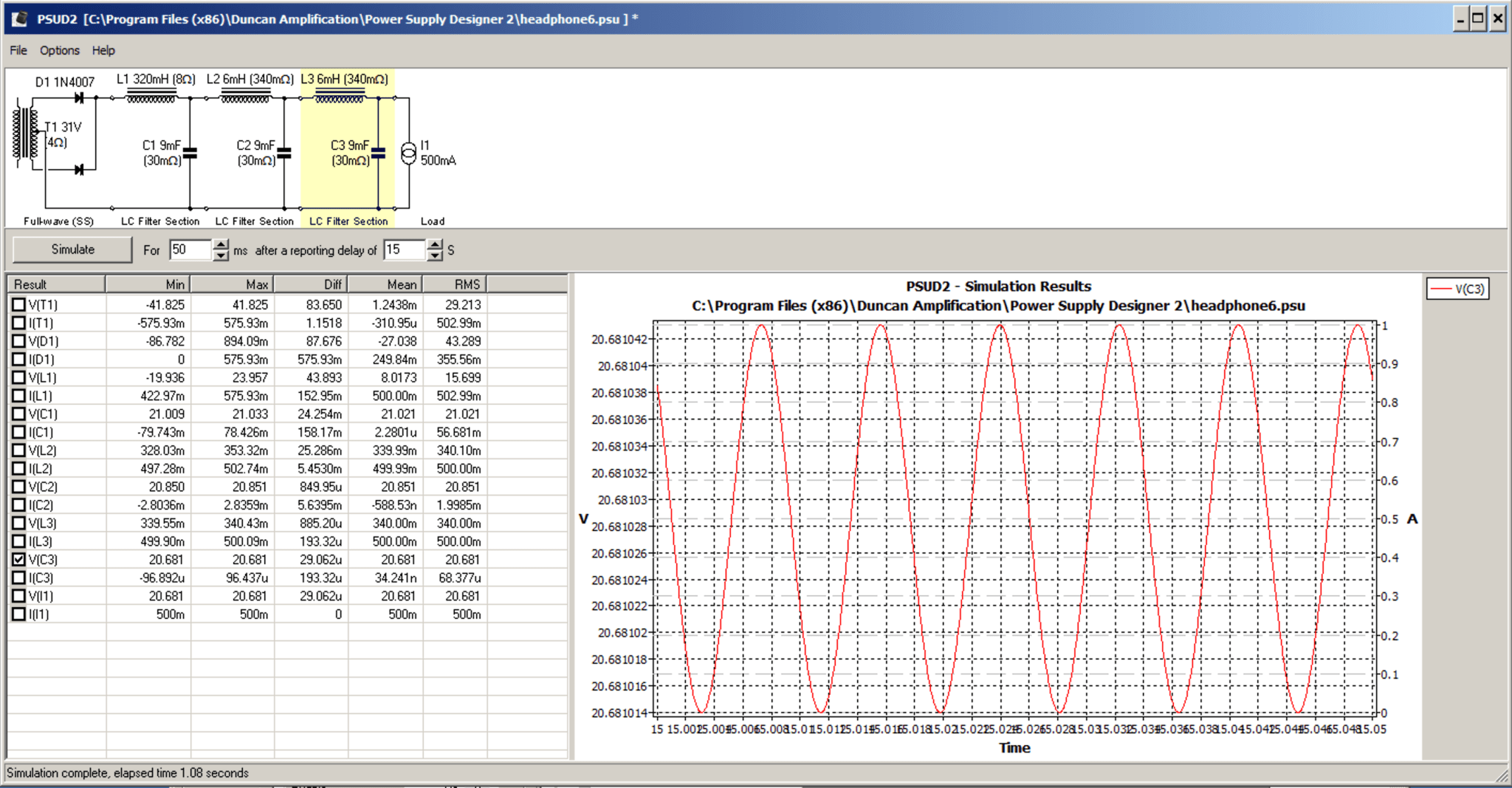

Now compare with the RMS value of the LCRCRC filter's C1 current. I(C1) is reduced from 786 mA to 53 mA, 1/15th of the original value, or about 24 dB, with a more benign waveform and frequency spectrum. The same ground traces as above result in a ridiculously quiet system.

The current through all your parts will be at the same level. Making C1 bigger without an input choke and it will only get worse!!!

Long story short , in this application , instead of inductors , suggest looking at a 4th order LPF .
Just a 4 pole ladder filter C R C R C R C R C C .
Also , suggest simulating in the frequency domain , playing around with R values , and look at the roll off .
Also note what rebone has done by putting " The Beasts " as the last caps before the power amp .
Its ESR of those caps is in the ball park of 4 or 5 mOhms . So the current can get to the load ( speakers ).
So the last caps in the ladder filter should have a low ESR .
