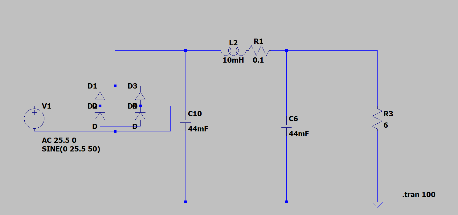

I just ran some numbers for a CLC LPF power supply filter using microcaps software .
Hopefully , this is correct . r = 0.044 and there was no dampening resistor .

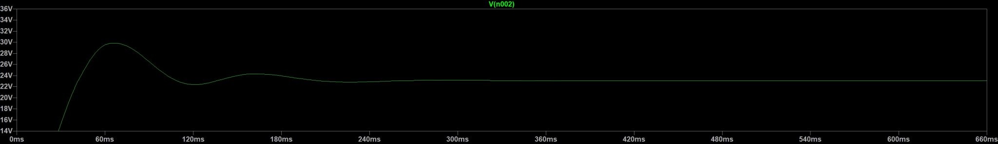

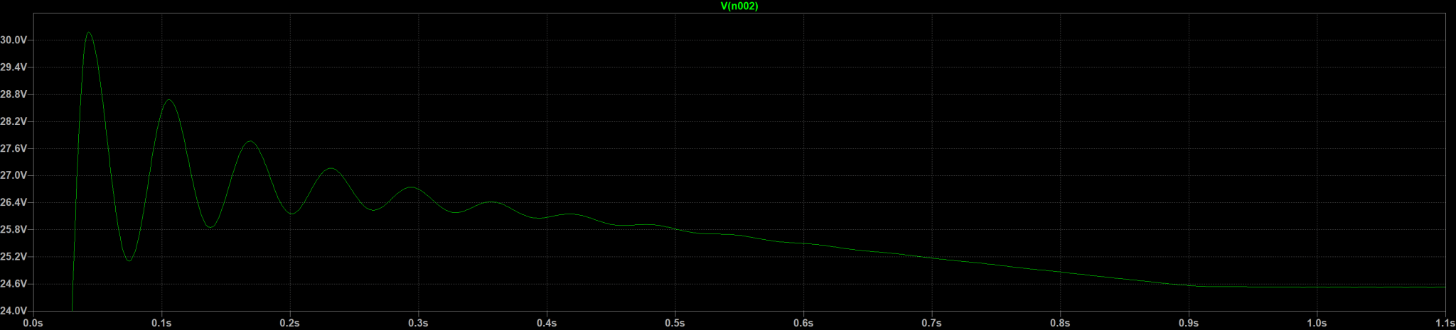

And this is what the ringing with the resonant frequency is supposed to look like according to simulation.
However with all the parasitic effects of real life parts, I have seen none of that in practice even though my Pi filter should be underdamped and therefore ringing. It could be possible that my connections between parts are that bad that they introduce enough contact resistance to dampen the ringing, but then the voltage drop should be higher.
Ozofis , Thank you for simulating this . For an underdamped system , the ringing will occur when there is a sudden demand for current .
I usually don't like analogies , but if you have ever driven a car without shock absorbers , and hit a pole hole ( step function ) ,
the car will oscillate ( ring ) and then there is a settling time - as your graph shows .
As I recall , a resistive load will help to dampen the L . So for your simulation , suggest changing the 6 ohm load to a CCS .
