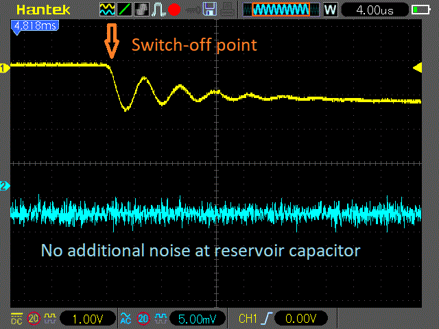

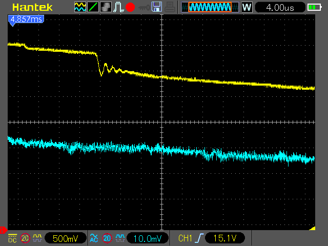

Guys, don’t worry over issues that don’t exist. LT4320 rectifiers are perfect even without any snubbers and their switching speed doesn’t produce noise. I’ve measured enough around those questions during usual audiophool dispute over power cords and their effect on power supply and sound.
Point is that active rectifiers ringing without any snubbers is orders of magnitude lower than that with diode bridges. Another important point is that nothing reaches even first reservoir capacitor. Here is attached measurement from my LT4320 board with 33.000 uF first reservoir capacitor. You can put snubbers for a peace of mind but there won’t be any difference you can hear or measure.
@ItsAllInMyHead
Notice that there is always some 2-3 mVpp residual noise which is not from rectifier switching but rather environment noise pickup by oscilloscope probes and small portion of noise from the mains. Check with oscilloscope probe where ground is clipped to probe tip. There will be similar minimum noise level.

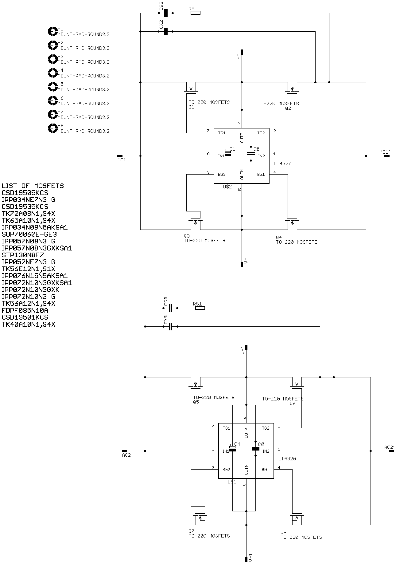

https://www.diyaudio.com/community/threads/lt4320-based-active-rectifier.336572/

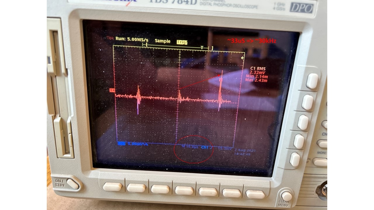

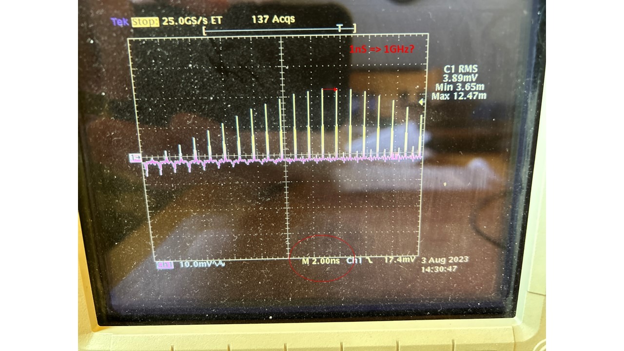

Below are a few pics after (I think) I've learned some better triggering techniques. Goes to show that giving a novice a nice tool can be a fool's errand...
Laughter and levity aside, I made an effort to understand what some of this could be other than pretty pictures on a screen, which they are (to me). I took pictures of the screen b/c saving to floppy and transferring... LOL! IF I learn how to properly use 1/1000th of the capabilities of this scope, I may treat myself to a newer model that makes capture and a few other things easier.
Again, this is the CLCRC PSU. I don't see anything in the 60Hz and other multiples of 'ripple', but because the 'noise' voltage peaks are prevalent, and my techniques are limited, I couldn't capture anything too relevant.
Starting with the lowest frequency pattern. 30kHz, I think. No idea if this is a concern or native to the circuit. I think it's either native to the circuit or EMI b/c the pattern persisted even after disconnecting from the mains / mains earth.

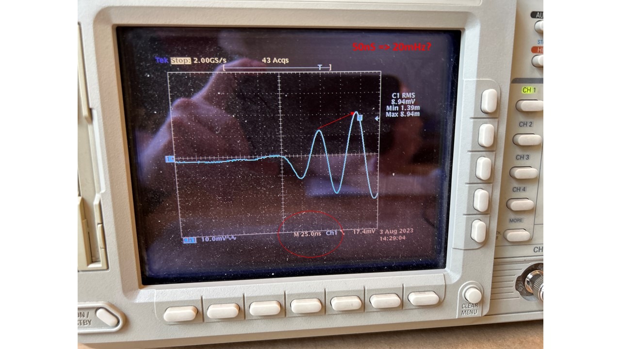

And moving slowly toward what I thought was the 'ringing'. It may very well, be, but it's at a relatively very high frequency (I think).

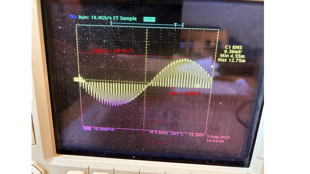

I saw a nice sine wave ... and I thought, well that must be the ripple with noise overlaid... but the sine is 20Mhz with 1 GHz intertwined w/in it... I think. I don't know diddly squat about signal theory or practice, but is this a 20Mhz carrier of a 1GHz signal? I haven't the absolute foggiest idea. My guess is pretty noise. That's all I've got.
A bit tighter zoom of same...
And finally what I thought was the ringing I saw earlier... and it may be some sort of ringing, but it's at an awfully high (I think) frequency to what a rectifier would produce.
While you all have a chuckle to yourselves... If you're willing to share any plausible explanations for what I'm seeing (or not seeing) ... I'd again be grateful.

^ Thank you! It could be so many things...
This is truly fascinating for a newcomer. I spent 30 mins using search engines to try and see what things were roughly in that 1 GHz / 20 MHz range. The 30kHz has me more interested, but it's still not totally relevant. At one point, I thought the higher frequency stuff might be my WiFi, or my microwave ... or ... or ... or... It's fun to chase that rabbit down the hole, but I want music. 🙂
Either way, what I'll likely do is see if I can limit the bandwidth further on the scope below 20MHz. 100kHz seems reasonable, I think. I'm also trying to see how I can have the bandwidth limiting 'hold' during a measurement session. It seems to pop on / off when I change other settings. That way, I won't get distracted by high-frequency noise that I'm not really looking for. It's fascinating, sure... but it's a distraction from what I'm really trying to measure. SillyScope for DoDos 101... at least I haven't blown anything up.
