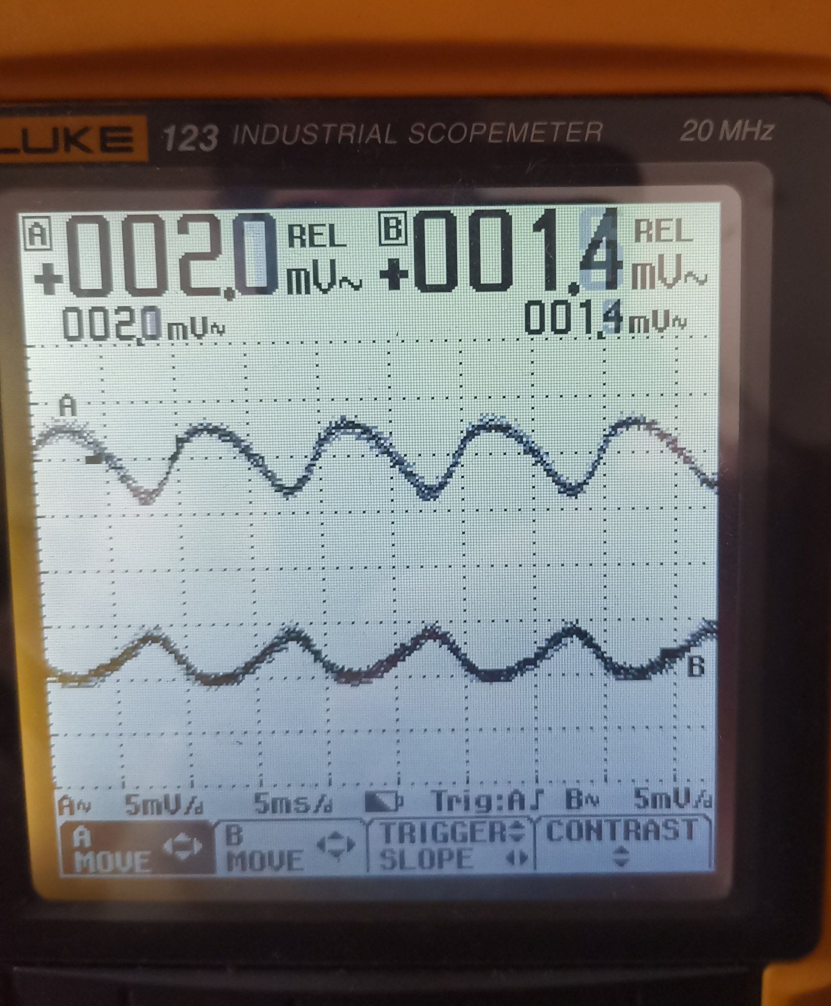

I've just measured my PSU +ve/ - ve rail ripple voltage, whist the amp was playing
Approx 2mV!
Not bad at all, it varies from as low as 1.4mV up to 2.6mV, but that could well be due in part to my melted scope probes.. Not the best that I've ever achieved, but certainly very decent

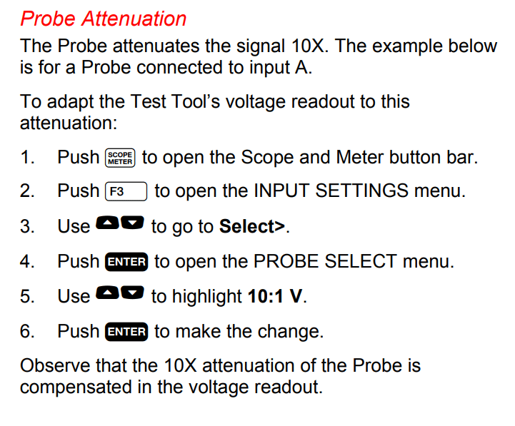

Are you sure your probes are not set at 10:1 ratio while scopemeter is set at 1:1?
2.6 mV pp ripple is not possible with 22 mF capacitors and 3 A load. Calculations predict minimum of 30 - 50 mV rms ripple at the second capacitor. Practice confirms that too.
Reactions: andynor and Dan K
The Pana caps are doubled up, as per the std. PSU layout.
I'll check the scope settings tonight. At the probe end they are set to 1x. Will need to check the scope end and compensation. Very likely that Tombo is correct

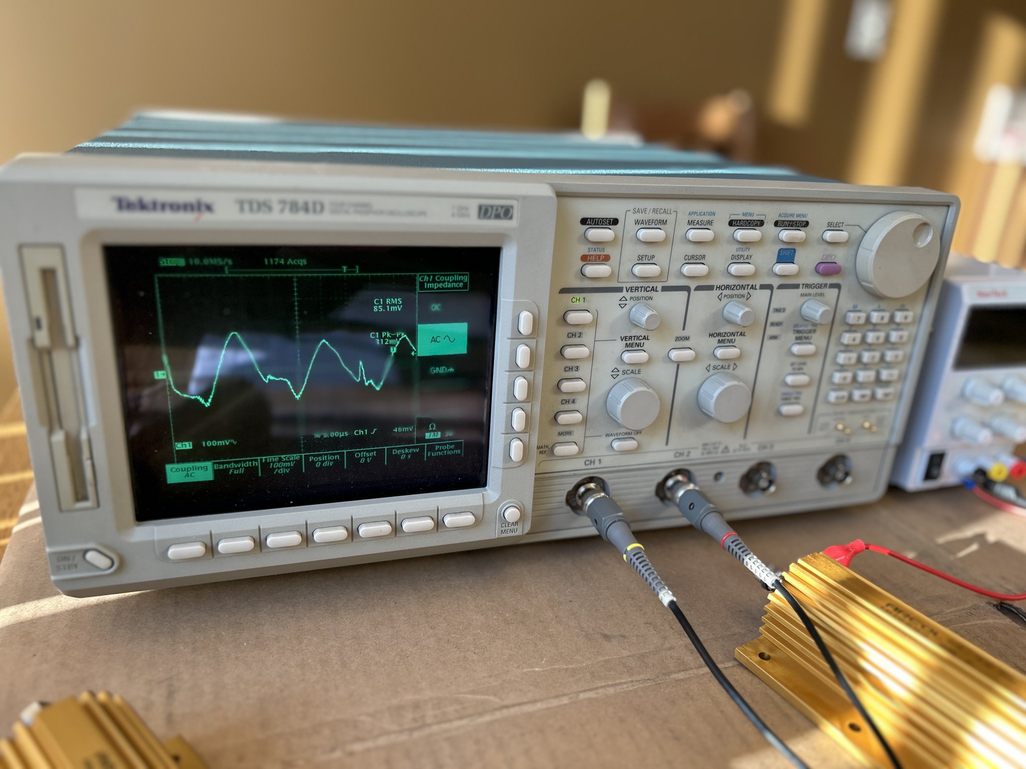

As an example - I tossed together a VERY quick and dirty comparison for a little cheap and cheerful benchtop switching PSU measured under identical conditions, but differing scope settings.
I used the dirty SE single probe method.
5V output with an 8ohm resistive load

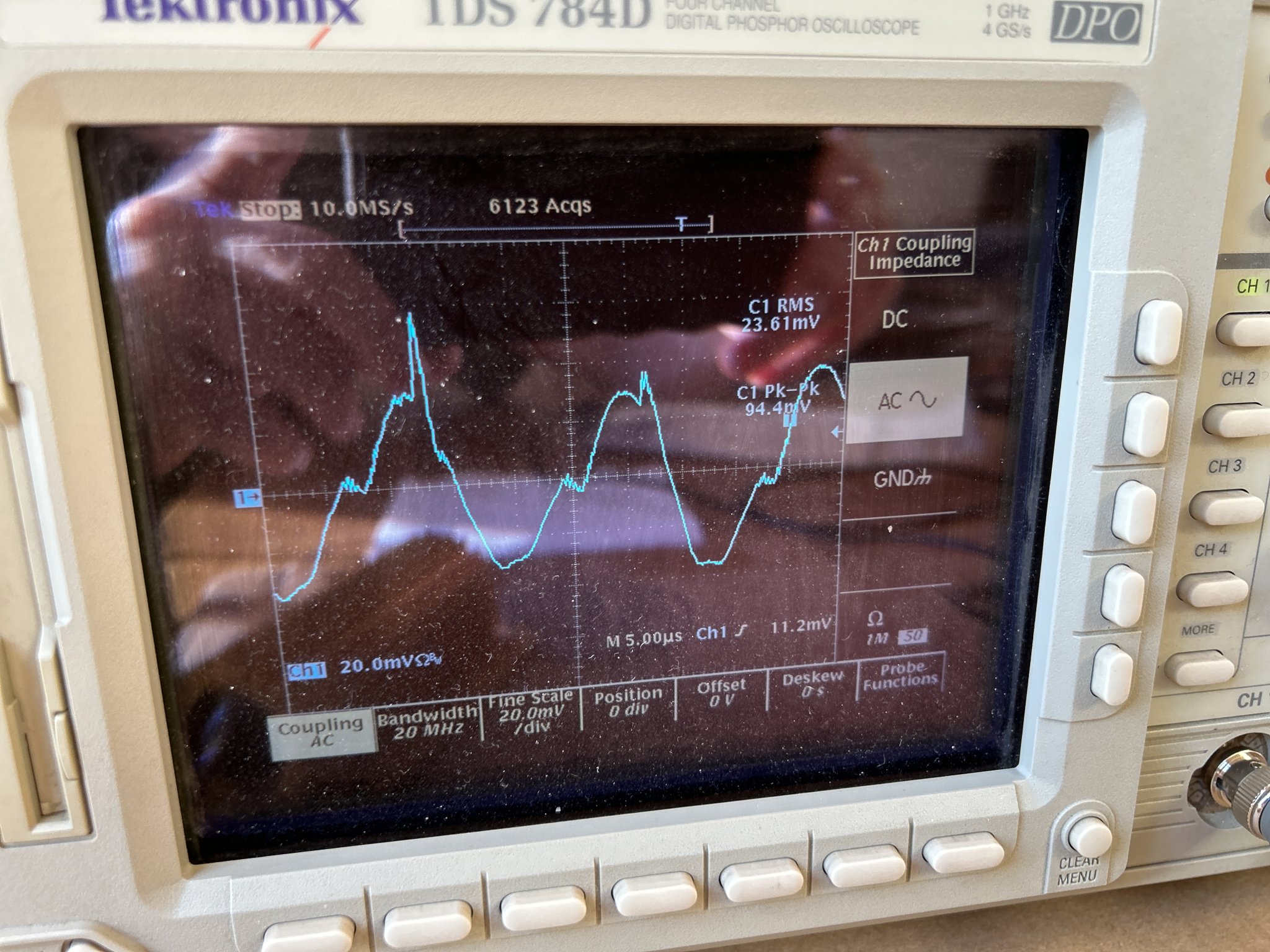

With probe settings mis-identified as 1x vs 10x, the scope simply provided the 10x differential in the measurement.
With the coupling impedance of the scope set to 50ohms instead of 1Mohms, the difference was also markedly different (pics below) - 50ohm was ~24mVrms of ripple and 94Vpp. 1M was ~85mVrms and 312mVpp
Bandwidth limiting to 20Mhz had a nominal effect on results, but made it easier to trigger etc.
Again... I am a complete and total novice... and I likely made several errors in my techniques.
The overall message, I suppose, is that I never look at the absolute value of the measurements. I simply check the relative measurements across my supplies using the same technique saved to (yes that's a floppy disk) the scope and pulled up each time.
Any input is always welcome as I learn and refine how I do this.

EEVblog tutorials are terrific and very recommended. 👍
Ripple measurement is simple. Always use AC probe coupling with 1 MΩ input impedance. Connect probe ground to the PS ground and probe tip to measurement point (PS rail output). Take care not to accidentally connect probe ground to the rail, as that would blow fuses (inside oscilloscope or amplifier).
Oscilloscope will show rails AC waveform or ripple + noise. With strong noise coming from the switching PS, limiting oscilloscope bandwidth is helpful for getting stable waveform. Trigger settings also have options for noise rejection. You can try and play with those.
Oscilloscope will display on the screen measured peak to peak and RMS ripple values. RMS and PP values are directly related by simple math operation. Both values are good as absolute ones for comparison.
