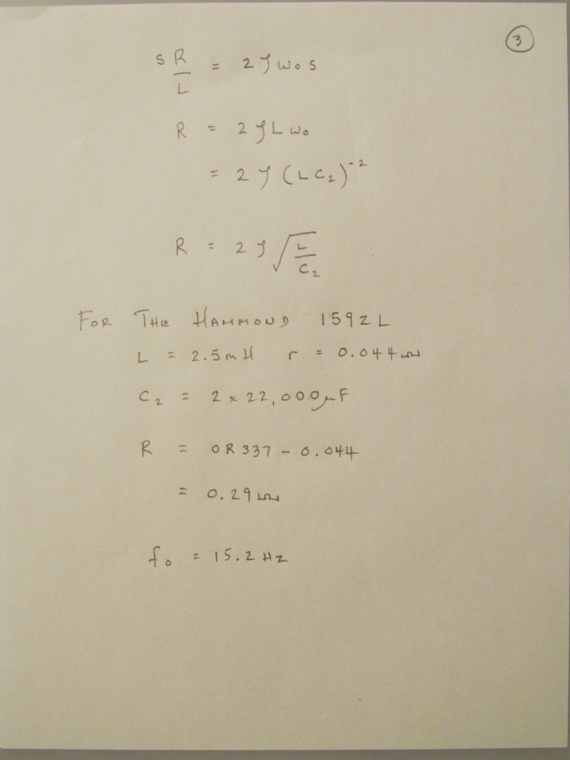

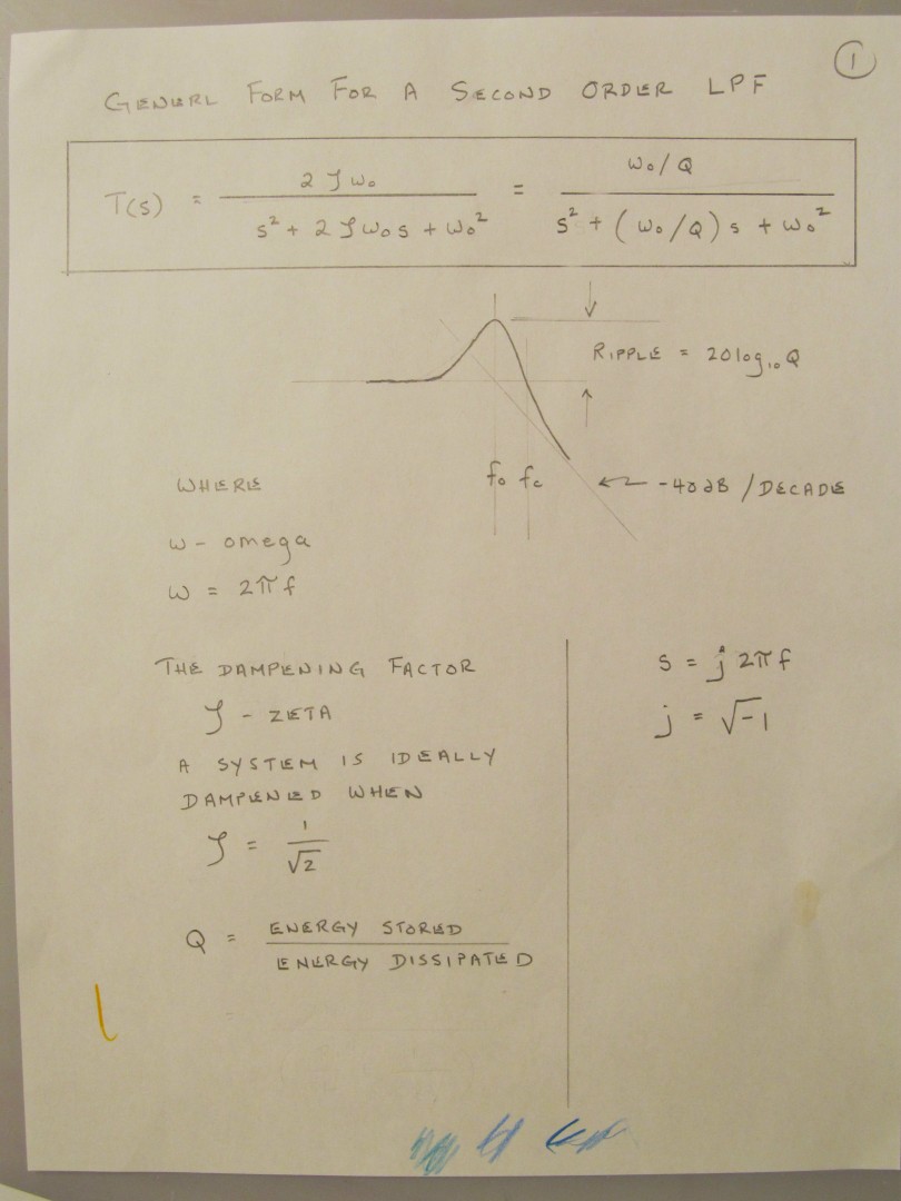

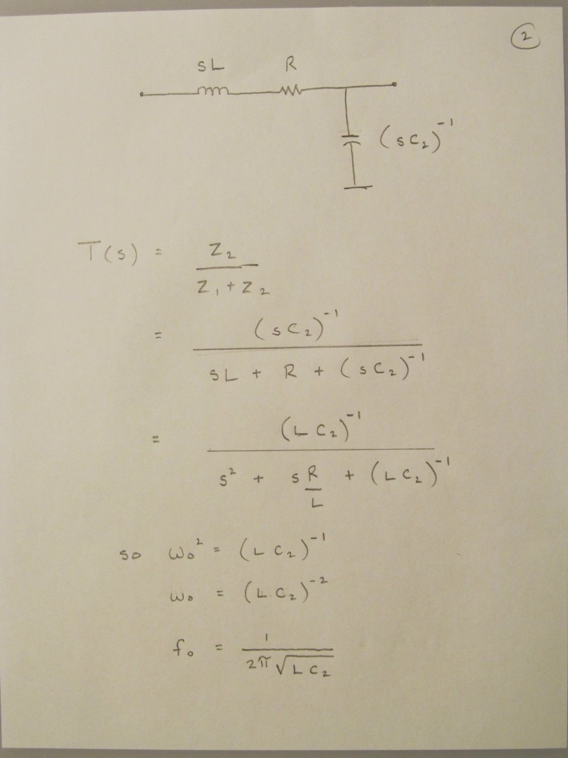

This needs checking over , but here goes
I originally thought a CLC filter was a 3rd order filter . Trying to figure out a 3rd order transfer function , in order to calculate the value of R ,
to correctly dampen the Hammond 159ZL gets a bit tricky .
However, simulating the CLC with microcaps software , fo = ( 2 * Pi * sqrt ( L * C2 )) ^ -1 and the roll off is - 40 dB per decade
so that says its a 2nd order filter .
Recall , theoretically looking into a CCS , the impedance is infinite or big .
From the power supply's point of view , looking from the supply rails into the amp , many amps are effectively a CCS .
So if the power amp is effectively a CCS , looking from the power supply rails into the amp ,
the infinite impedance will have no effect on dampening the L .
The general form of a 2nd order transfer function is here .
The transfer function of the CLC filter can be figured out because sL R and (sC)^-1 form a voltage divider .
Note how C2 - the second bank of caps - affects both fo and the dampening of L .

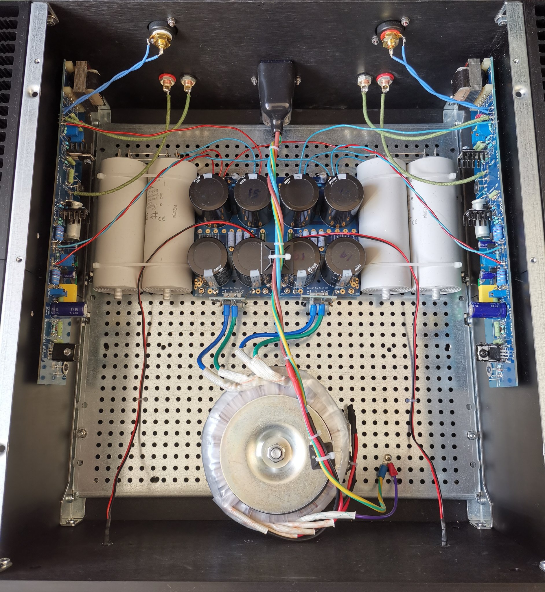

I'm wondering about going CLC on my recently built LuDEF...
At the moment I have a single DIY audio psu with the std Antek Transformer, LT4320 active rectifiers, 3-off 0R47 Panasonic resistors per rail and motor run caps. Amp is built into a 4Ux400 case so I have space next to and just in front of the transformer to fit pair of chokes.
Im looking for advice on either of the Hammond items that are 6mH/ 0R133/ 4A (157E), or 10mH/ 0R16/ 5A. The 10mH (159ZJ) item is substantially larger and heavier, will it pick up a lot more noise than the smaller one? What's the best physical orientation with regard to the traffo?
I have 0R16 in my CRC at the moment, so am I right in thinking that the 10mH choke won't do anything to reduce the impedance?

If I remember correctly, I use the Hammond 159 @ 10mH and 5 amps rating. I use two per channel (dual mono) on my Aleph J Zen. You should be safe with a pair in your LuDEF. Just ensure a bit of C after them. I am not sure about the LuDEF and CCS, but without a CCS you should ensure some good current reserves in the cap bank after the L (though of course reserves are always good!) I used overkill, 590kuF in total after the chokes. Not saying it is an example to followThe larger (10mH) choke is 0R16, smaller (6mH) one is 0R133. Would a 4A rated choke be OK on the LuDEF at 3A?
Neither is a cheap option at £75 or so
Though important not to exceed the current rating, it is also important to push enough current through chokes. Datasheets should explain min current too.
