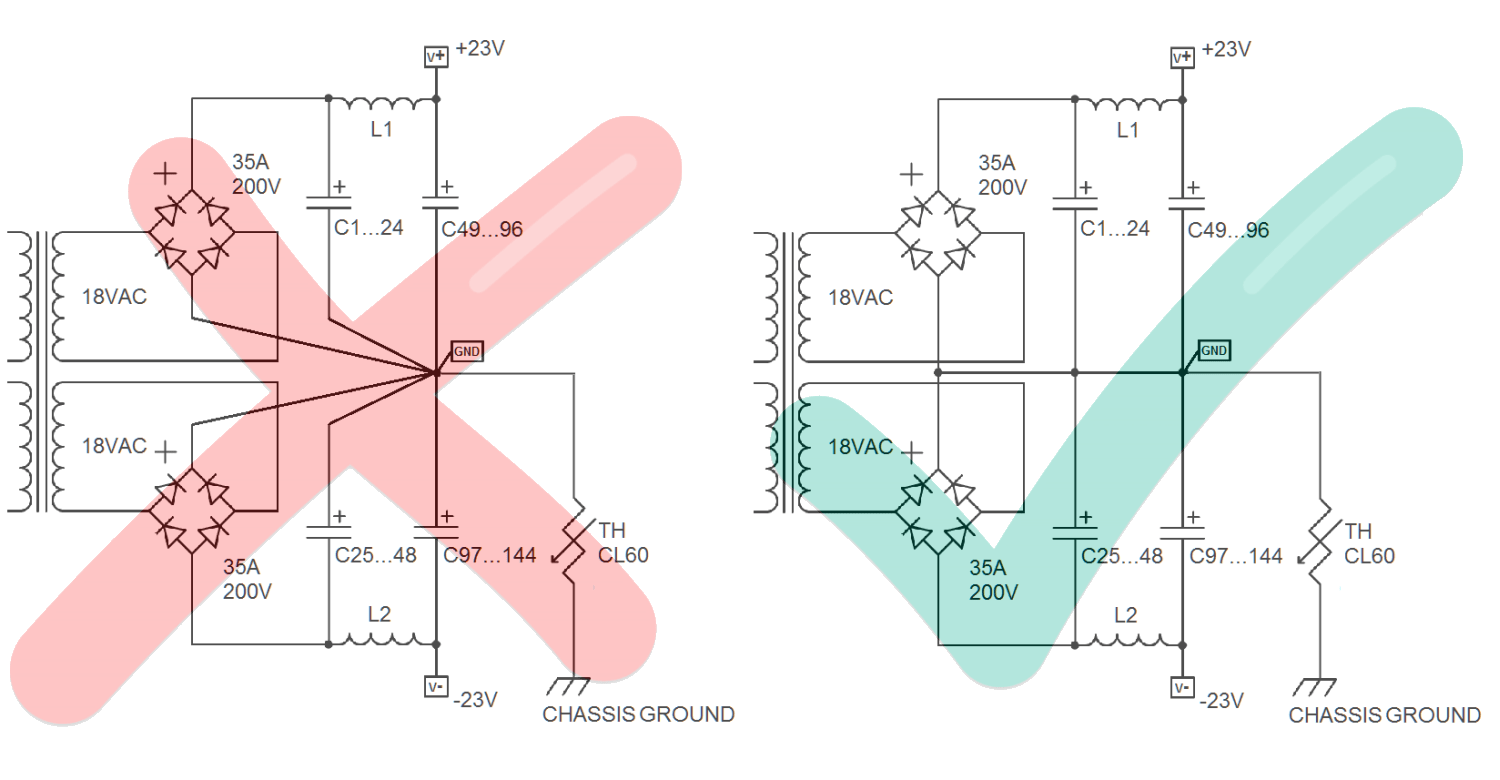

But this time, I will use a discrete power supply (no PCBs)
I will be using a hardwired PSU as well, mainly because I will be using screw terminals.
Also, I think it is easier to direct where the currents go with hardwiring.
This seems to be a good approach for the wiring.
After the rework of wiring it is the quitest (concerning hum) amplifier I have built yet.
But isn't the ripple higher than before?
It should be, but I measured around 3mV (this is all frequencies RMS) as before with a load of 4.8 A . Noise from one channel was around my measurement threshold of 0.08mV. Balanced noise was around 0.13 mV same as before. The only noticable difference I measured was 0.4 V more Voltage.

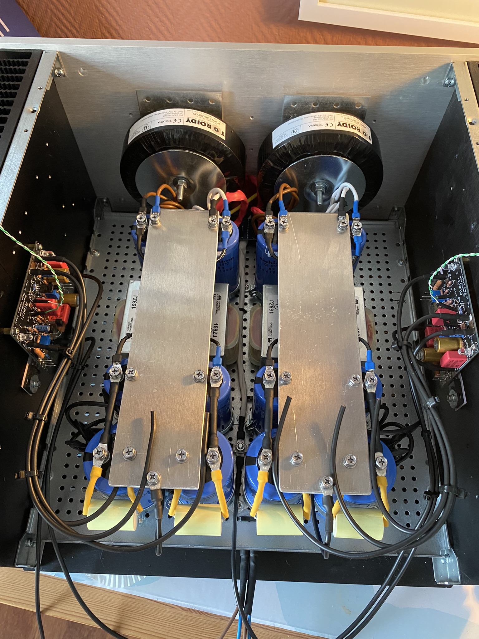

I use those Hammonds. I am very happy.
Approx 300.000uF after the chokes per chan.
