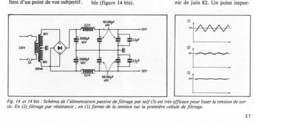

Hello,
This is the CLC supply used by the French in the eighties for a 50 watt Kaneda class A amp. I used the same choke in my 30 watt Hiraga and my friend used it in his 20 watt Hiraga. It is 200 mH 0,7 ohm dcr. My friend recently changed it into a Lundahl LL2771 but if you are afraid of to much DCR you can also go for the LL2733
The Lundahl is way better than the choke the French used which is maybe just a little bit better than the Hammond ones.
Like i said before you can ask Lundahl to change the airgap ( at no extra cost) so the current rating will be something like 20 % above the actual current so you will have the maximum number of mH. The LL2733 is 100mH at 3,4 A so if you ask them for a 2A model you will get something like a 170 mH which is way better than a 10 mH.
Because the current is not fluctuating in class A i dont expect any ringing. I mean no ringing that will give you a bad sound.
Greetings, eduard

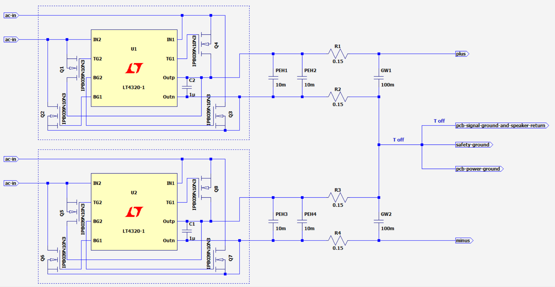

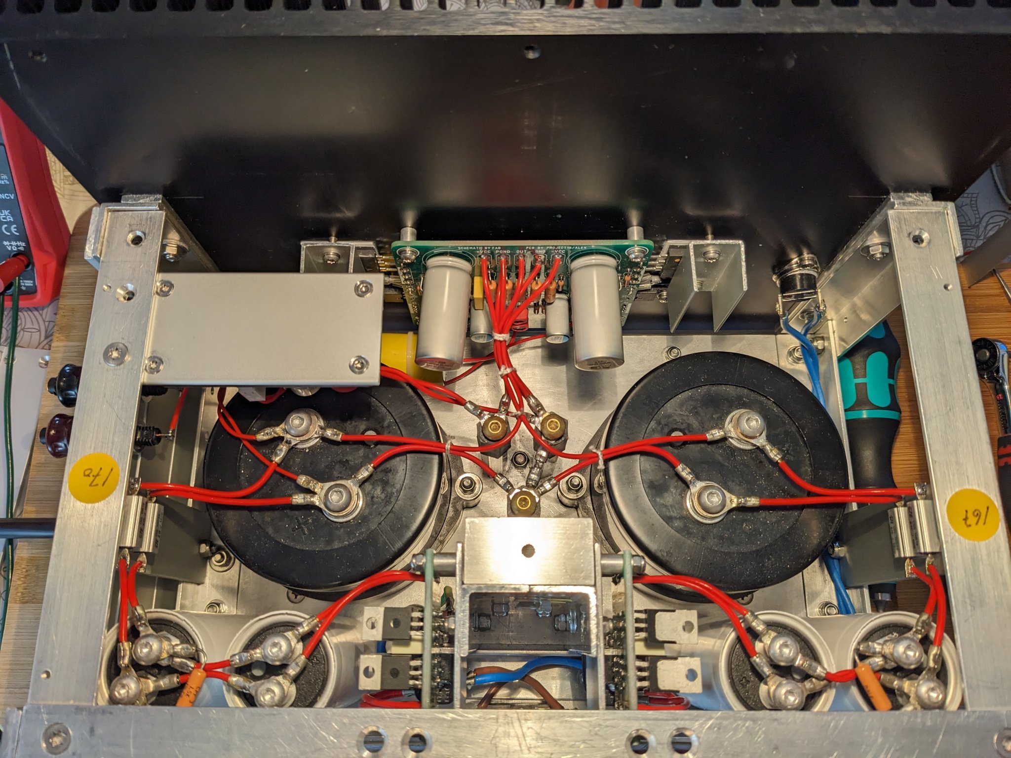

Anyway, I ended up building a CRC supply with some subtle differences.
Started with LT4320 rectifier ( a must in my opinion )
Then 2 x 10000µF capacitors ( PEH169 ) with high max ripple current.
I believe that 2 (or 3) 10000µF caps here are better than one 20000µF (or one 30000µF).
This way the high ripple current can be divided by 2 (or 3) capacitors.
I believe that the higher value capacitor you have after the rectifier the more spray of mains harmonics will be poured into the amp.
Then I wanted to try an idea that has been reoccurring in my mind, first time I saw was here I find I get cleaner ground that way ; to split the R in two and have one R on + and one R on ground. The same for minus.
So I put one 0.15Ω on +V and one 0.15Ω on ground line. The same for minus.
After this I put one 100mF with low ESR ( FTcap GW ).
In this position I believe it is better to have one big cap rather than several small ones.
The pcb traces or wiring can make a mess of the current flow to amp and speakers.
Here is a drawing of the supply, the wiring is the same as the drawing.

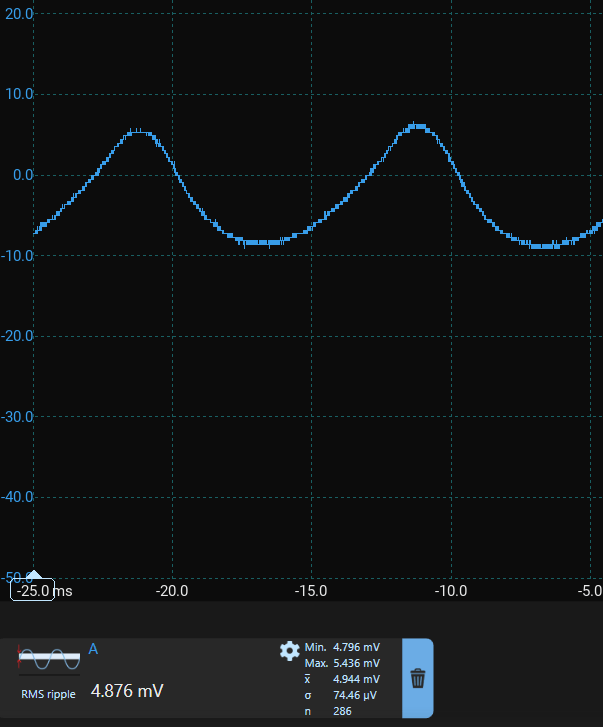

Here is ripple ( measured ) over PEH2 capacitor

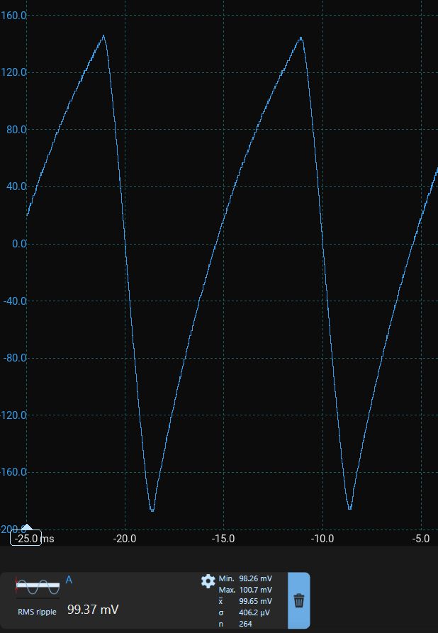

And here is ripple ( measured ) over GW1
As you can see we get the desired sinus wave like ripple as we get with the CLC.
By the way, the ripple looks the same with 0.3Ω only on the plus line.
I have just finished an amplifier with this power supply and with 92dB speaker ( Alpair 12p ) there is no sound from the speaker what so ever when amp is idle. I cannot tell if the amplifier is on or off.
Anyway, this is just a CRC power supply my way and it could be an easy test to split the R in two and put half on the ground line.
Here is a photo of the power supply.

Underhill, Thanks for your reply.
I am no expert either, but I did quite a few simulations and studies on CLC earlier in this thread, so I do agree on the ringing and dampening.
Some of the amplifiers on this forum run class A at say 1 Ampere and then deliver say 5 Ampere in class AB at lower loads, say 4Ω.
I think that one of the main benefits of CLC is the sinus wave like ripple that it delivers.
This way we can have the same sinus wave like ripple using CRC.
The steep rise of a saw tooth ripple contains a lot of high frequency noise that is good to try and stop before it enters the amplifier.
Anyway, just my thoughts and it seems to work very well.
rebone

Redbone , Your measurements show the ripple is 330mVpp across the first bank of caps .
Yet on the output cap , ripple is down to 13mVpp .
So this really demonstrates how the first bank of caps takes the brunt of the ripple
and they should be selected to handle this .
Supply filters that lead with a choke, such as LCC or LCRC are sometimes referred to as "swinging choke" filters. Their main characteristic is the final voltage is 0.9 * secondary AC, instead of 1.4 (nominal, but realistic 1.3) * secondary AC. However the final voltage only settles to 0.9 after the amp is fully warm and drawing its final bias current. Prior to that, it is possible for components of the filter and amplifier to see the full 1.4 factor, and those components should be rated for the higher voltage.
I don't recall what the stated advantage of a swinging choke filter is supposed to be. Perhaps a final lower voltage might be advantageous in some circumstances, maybe for a high voltage vacuum tube amp. For the lower voltage Class A amps that we typically discuss here, I cannot think of an advantage.
Have you guys considered LCC, or LCRC instead of capacitor input choke supply, for class A power amp?
Any pro and cons?
Here is good article concerning a LC power supply filter . Note the equation for Vdc .
I've never built one , so I can't say anymore than this .
https://electronicscoach.com/choke-filter.html
