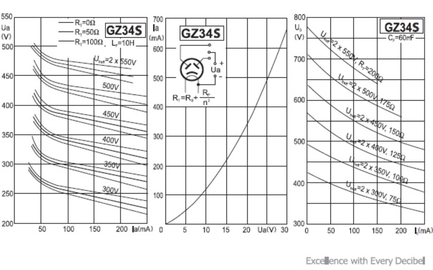

Hello,
This is from a rectifier tube datasheet but it shows some crucial info.
On the left side you see the graphics when using a ten Henry choke ( of course this with tube circuits)
At the start of the line you see what is happening when there is no resistor taking care of a minimum current flow. With more than 10 H the rise of the voltage on the first cap wont go up that high.
Of course you need your circuit to work in the " area " where the line is kind of flat.
TAKE A LOOK AT THE RIGHT GRAPHIC WHICH IS WITH CAPACITOR INPUT.
The dcr of the choke with a circuit that takes serious current is important. But it is not that important if the current is kind of steady.
The French made a preamp with a two bobbin choke with one bobbin in the plus and the other in the negative side. I have written about it elsewhere.
You could do the same with the Lundahl chokes because they have two 100% identical coils. I never tried but if i remember correctly Lundahl told me back then the current should be identical in order to make it work.
95 % of my chokes are used in single rail supplies and people who use them in " double rail supplies" all use two separate chokes. Like the ll2771 in a Hiraga 20 watt poweramp clc with a 2,5 or 2,75A current rating.
Of course with single rail you can use the choke also in a different connection, look at the lundahl datasheets.
Greetings,Eduard

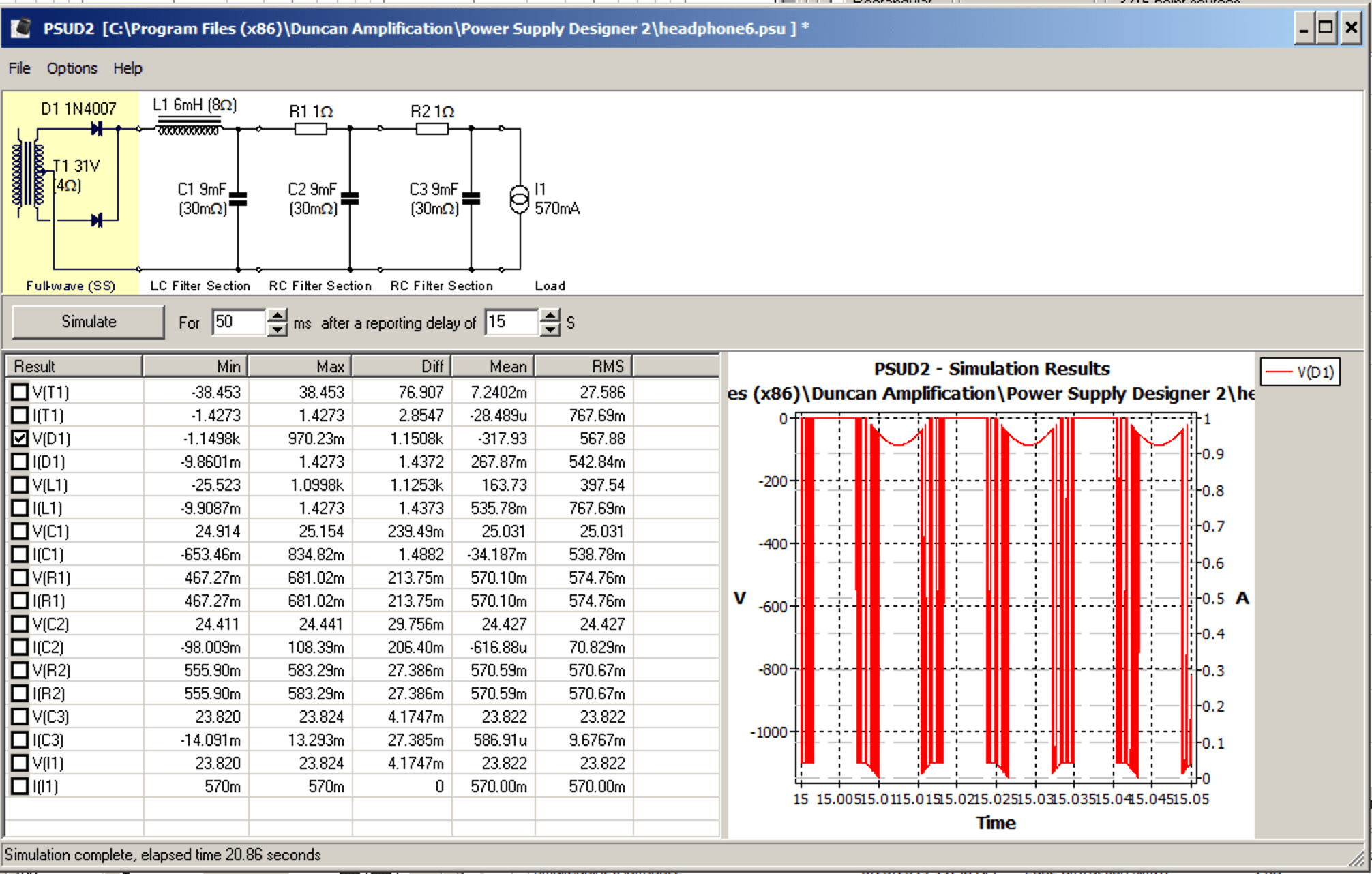

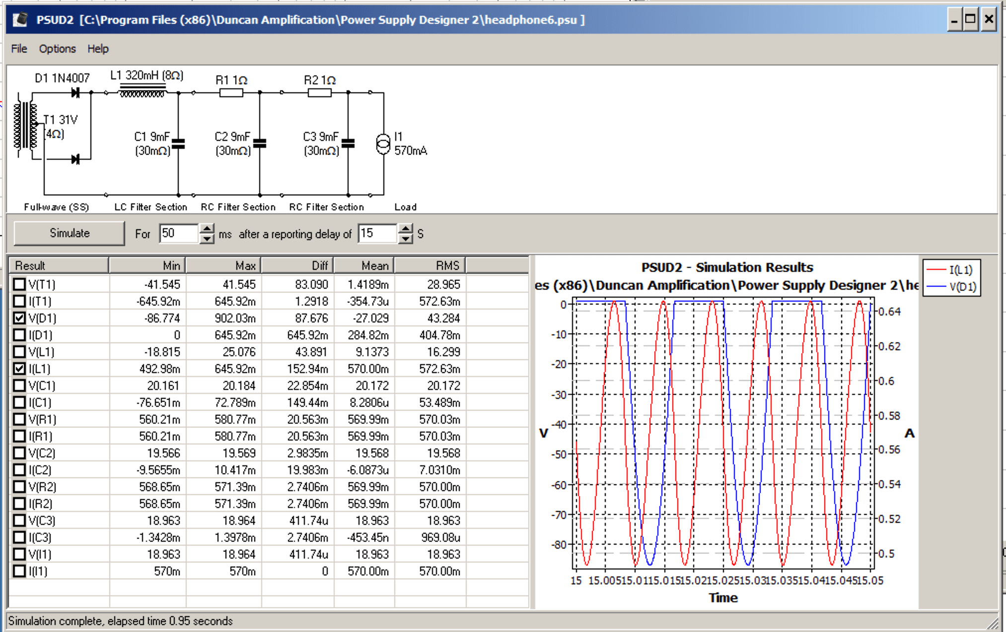

I cannot emphasize this strongly enough: PSUD is your friend. It does only one thing, but it does that one thing extraordinarily well.
Choke input filters are IMO wonderful for class A amplifiers and other places with essentially steady current draw such as preamplifiers. They are not, repeat not, recommended for class AB amplifiers since you'd need an unwieldy set of inductors to keep the output voltage steady and also to keep from smoking the rectifiers because of flyback voltage when the current collapses to zero in the chokes.
Here is the rectifier voltage with a choke properly specified for the current draw, followed by the rectifier voltage with a choke too small for the job.

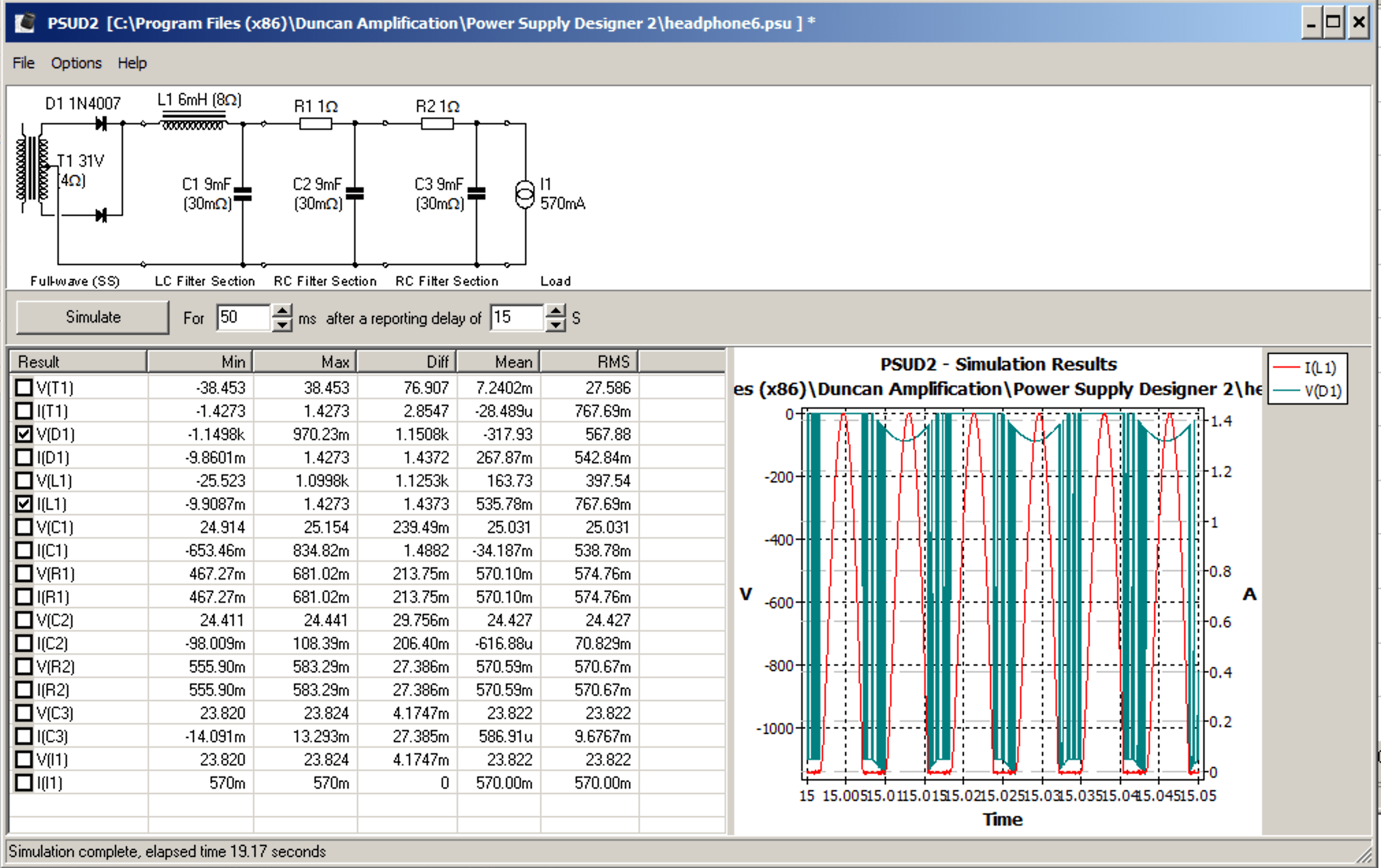

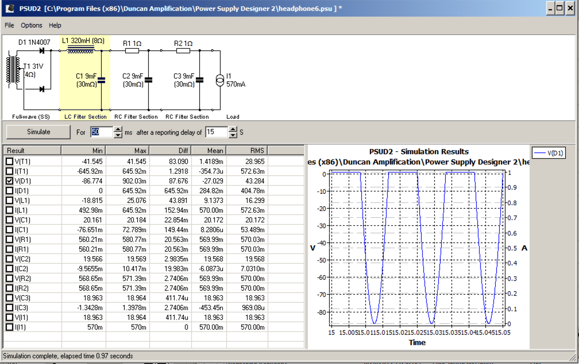

Or you could bring up a PSUD simulation and make sure the choke current stays above zero at the minimum load. The first example uses a choke properly sized for the current draw while the second is too small, with the red trace in both examples being choke current and the other trace diode voltage. Note how the diode gets zapped when the choke current drops to zero.
