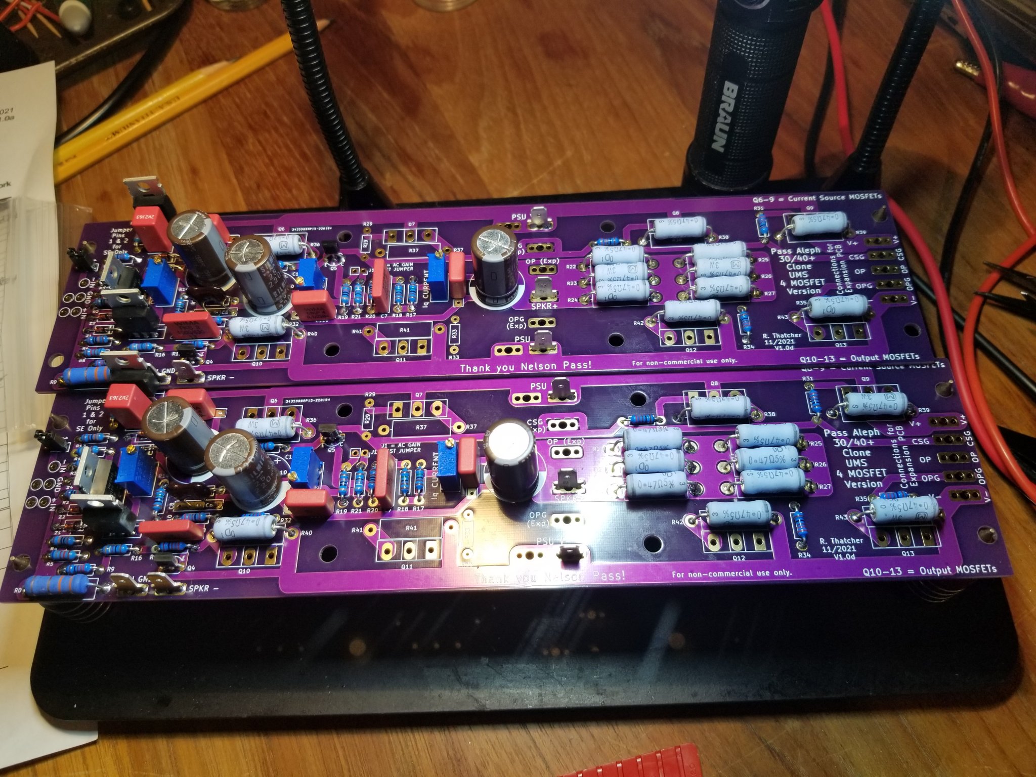

Just finished the circuit boards -- a good day's work. See the attached. Looked up, and right there was the FedEx delivery man with the chassis from HiFi2000. Always works this way, right? (LOL). How do they know I've just finished?

The Digi parts arrived today and got all laid out for the Aleph J 30 build. The Mono PSU PCBs went together in a wink -- here's what they look like (see attached).
Mr. Thatcher seems to have a gift for designing good looking PCBs. A certain symmetry and round versus rectangle theme that works on the visual level. Let's hope that they sound just as good and that I can figure out what the Transformer Center Tap connects to...

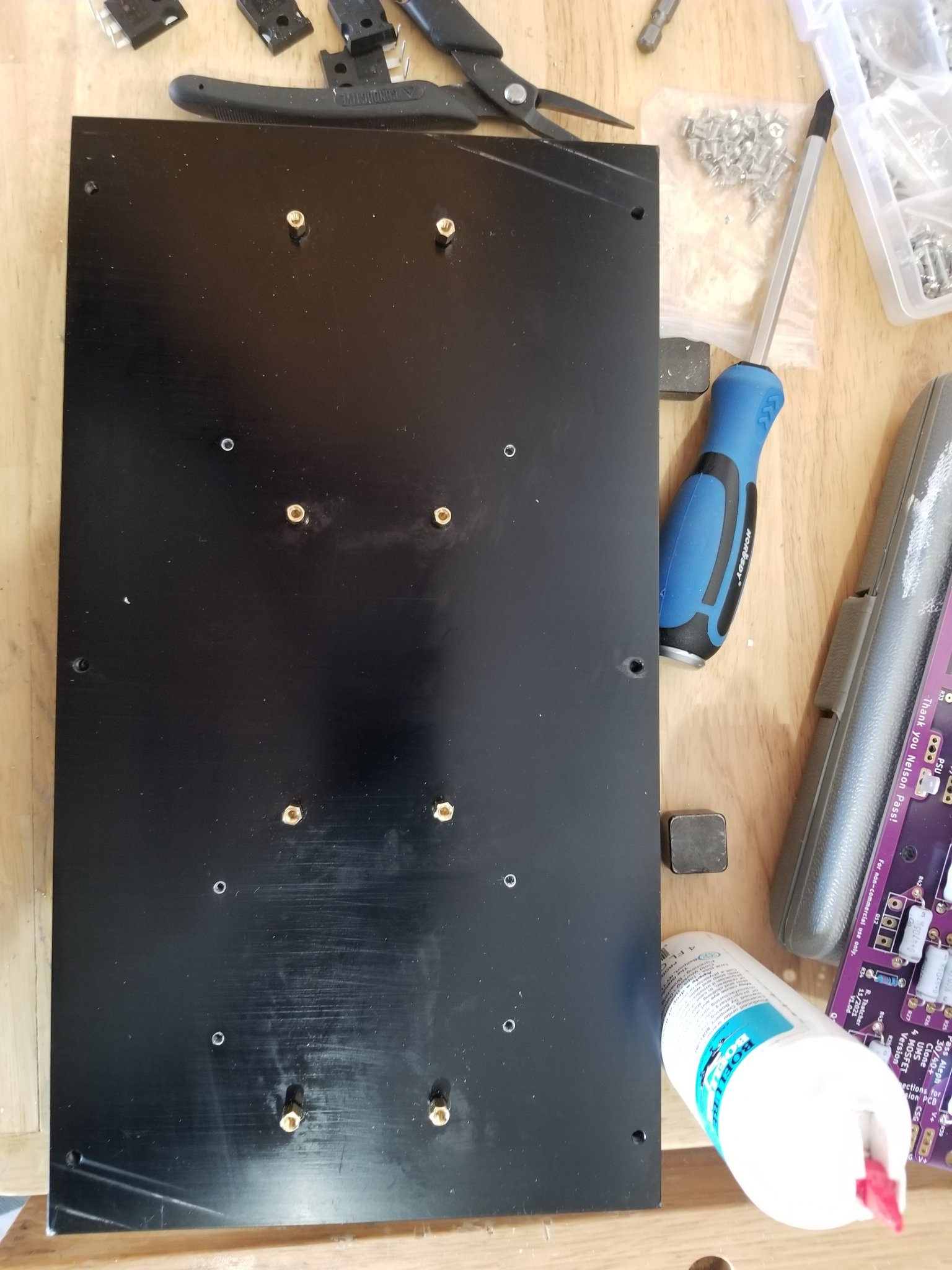

Progress Report.
Got the Heatsinks drilled and tapped today and was reminded that it is certainly easier to purchase the Deluxe version of the 4U chassis. Still, am making a number of custom changes to the front and back panels and never mind a morning spent with the drill press.

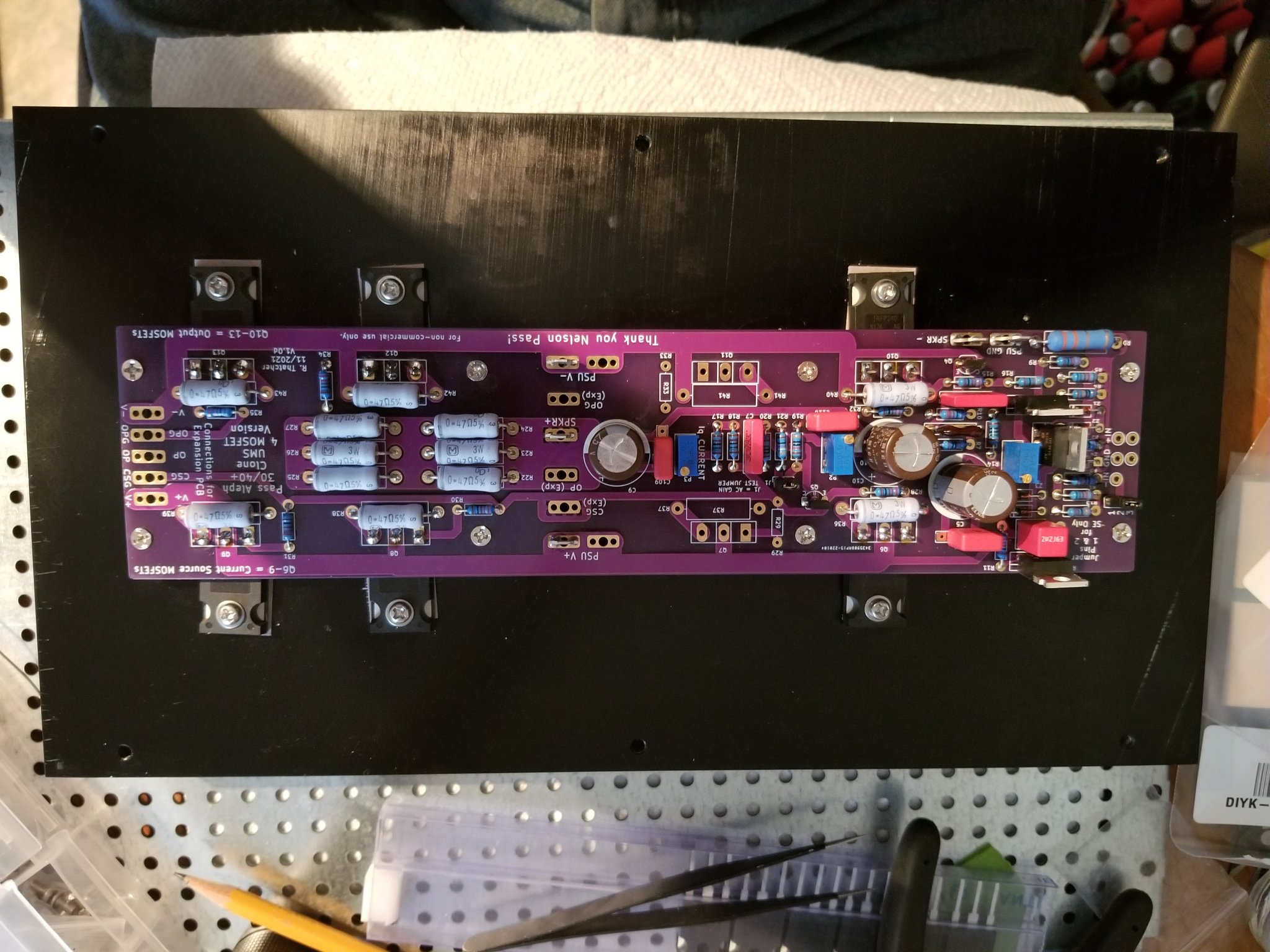

The first attachment shows the 4U heatsinks after the standoffs have been drilled, tapped and inserted. Then the board is lightly screwed in place (2 screws are fine) so the mosfets can be marked, then drilled and tapped.
You use 2.5mm bits and 3mm taps for these "standard" standoffs and attachment screws. No particular problems here as long as you have some background in drilling through metal and operating a simple tap wrench. The most important item in this first pic is the bottle of BeoLube -- Monsanto's best contribution to the audio world. Makes cutting threads and drilling tough metals a breeze. Important to know that if poured onto a surface it will mask any pencil marks used for location -- so just tap the marked surfaces first with the drill bit to make a small lasting indentation. If you are new to the metal working process, get a drill press first, then assemble cobalt drills. Step-up drill bits are also very handy -- especially if you want to enlarge a power switch hole to 7/8".
The second photo shows the board completed and combined with the 6 mosfets. These take a bit of care to get the leads inserted in the board so they can be soldered. Am using DIY Keratherm and one of these (expensive) pieces will serve for two mosfets if you bend them exactly in half and slice them apart. BTW, you need a 1/8" hole cutter for these to make the screw positioning work and a leather punch is a good choice.
Tomorrow, am going to finish the drilling work with the front and back panel designs. Then it will be relatively easy to finish the assembly and hook all together. The HiFi2000 chassis was ordered with the baseplates and they connect to the heatsink support rails in a straightforward fashion -- but it would have been nice were they able to raise in height as desired for custom wiring and transformer screw space -- you can do this with the baseplates sold for the Galaxy chassis as they affix to the side piece rail slots.
