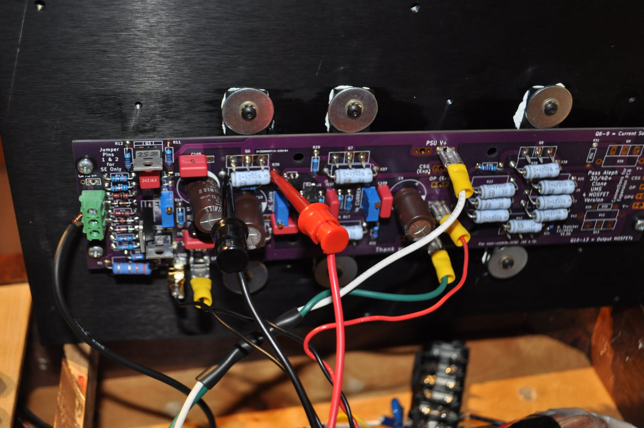

Twisting the AC gain trimpot P2 with leads hooked to an output resistor, R40 doesn't do much. Should AC gain be measured somewhere else? I re-adjuster current to 340mV, down from 425mV.
I'd recommend a hard stop.
I waited a bit to see if someone else would help you... b/c I know I have a different approach than some.
Describe the exact process you're using. Show pics of your signal generator, connections, load resistor being used and the DMMs along with their lead placements.
mV is not a unit for current. 😀 "R40 doesn't do much"? It's a resistor, what do you want it to do? 😀 Again, just playful joking. No ill will.
You're not measuring the AC current gain directly. You need to follow the procedure that Randy so carefully outlined for you in the BUILD DOCS.
Show me (us) the pictures from above along with a picture showing that you've filled out each and every one of the blanks properly in the form he created... then I'll help more. If you don't have a printer, recreate it on a piece of paper.

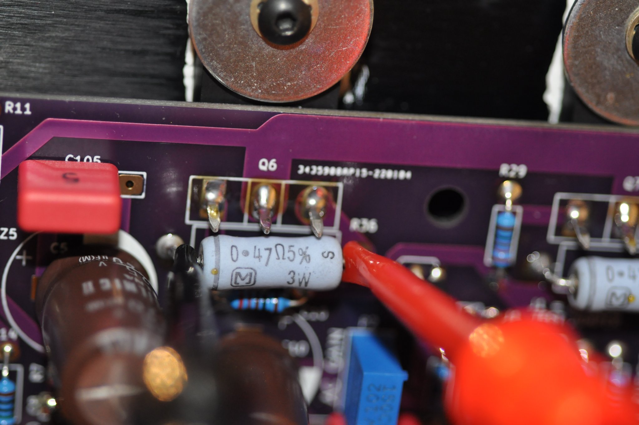

AC gain / trimpot P2 is the one I'm twisting, one side only. I'm measuring mV @ R30. I'm may just take it apart and set it to it initial value if I can't find a way to measure it.See the Build Doc. What you're looking for is in the Trimpots & Adjustments section and the comments column in the BOM.
For Aleph 30

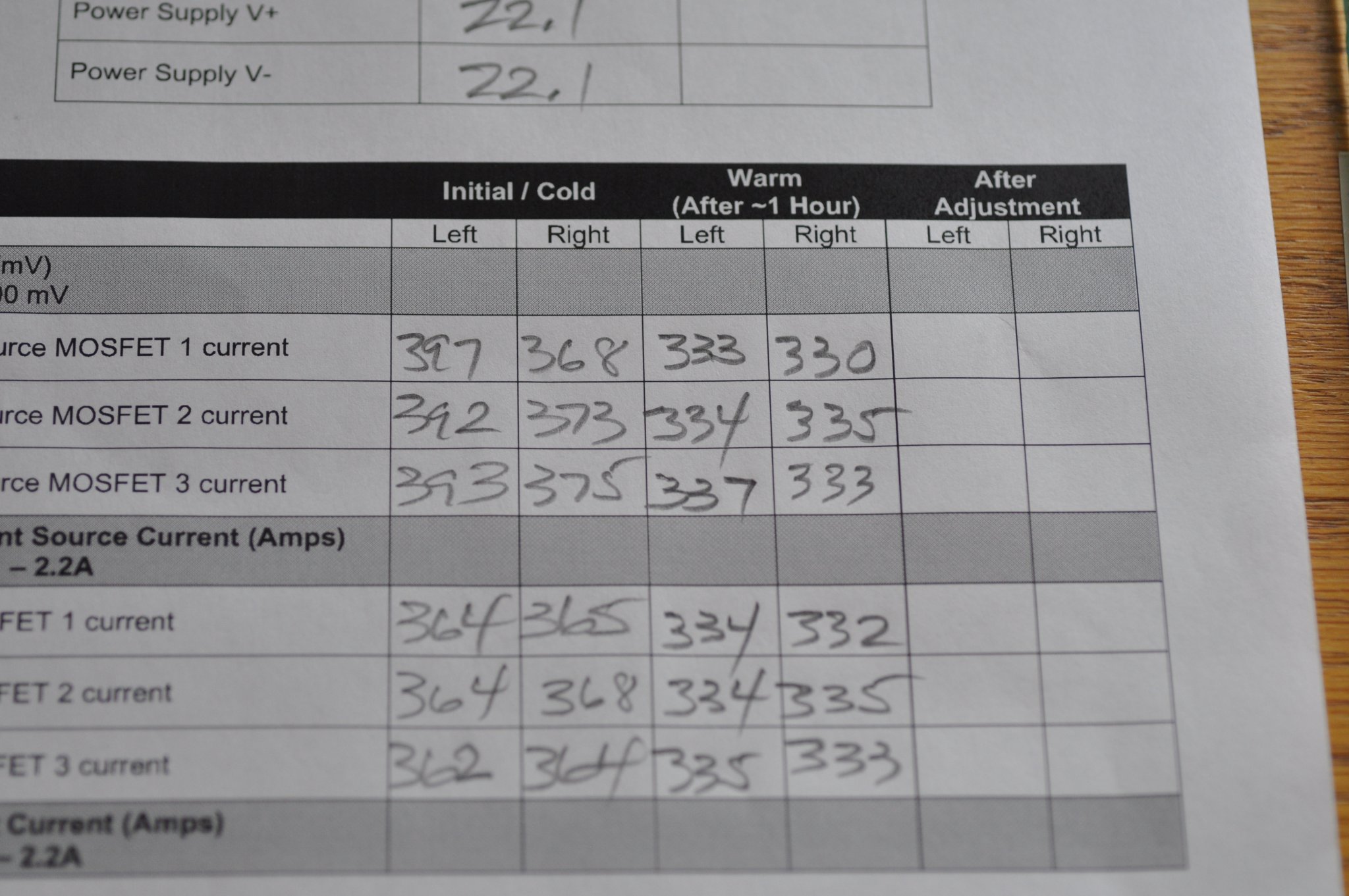

I reduced current using trimpot P3, measuring the 3w resistors on the current side. All as close to 340mV as possible.
No pictures tonight. It will have to be Wednesday. Nowhere in the build doc does it say where to measure AC gain that I can see. Obvious to some I'll bet.
Amps been on since 6am
No worries, but I have a strong suspicion that you are not measuring it correctly. You might be, but with some communication gaps, we'd best be sure with pictures. Take your time. Have fun. No rush.

Once again, as I've said - you are NOT measuring the AC current gain directly. It takes a few measurements and a calculation. You are choosing a value that you'd like, then setting it. There is a strong suggestion for what gain to start with in the documents. It's even included in the calculation table Randy created.

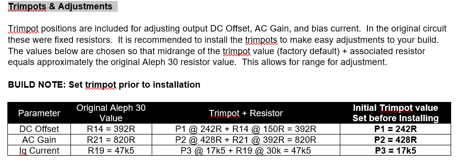

AC Gain Setting Procedure

Looking at page 4. The pcb has an AC gain setting jumper that allows for pulling R21 out of circuit temporarily by removing the jumper.
That jumper has not been installed. I have not figured out how to drive a sine wave into a load, unless it means just gook up a speaker.
I initially had trimpot set to the suggested calc., 428R and this got messed up when I intended to adjust DC offset. I twisted trimpot P2 instead of P1. I need to somehow return it back to its suggested.
value.
Back to the jumper. Doc reads like it should be in place and it is not.

Pulling the jumper is the same as pulling the resistor. I figured this out when I had my prototype boards and wanted to twist that pot. Oops. I had a broken de-soldering iron and already installed the resistor. That was why I put the header/jumper in the GB boards. This was inspired by mighty ZM SissySIT where setup includes leaving a jumper out, making a setting, then installing the jumper. Similar idea here.
- hardwire or install jumper / "set and forget"
- pull jumper and play around with settings, then re-install jumper and enjoy. This is for the experimenter.
@mkane77g -
Pulling the jumper (or not having it installed at all) is the same as taking the pot out of the circuit. The fixed resistor is still there. That's why you had some music.
Decide how you want to proceed. I think you have a better understanding now of what's involved if you want to play with this setting. If you're willing to learn... it won't be too terribly difficult. However, if fundamentally you don't know how to put a signal through a load (I had hinted twice that you'd need LOAD resistors and how you might use your signal generator)....

All dreams can't come true. I removed the board and re-set the trimpot to 428. Measuring V now. Interesting the decline of the value as things stabilize.I had an epiphany last night while sleeping. 'Instead of removing the board from the heatsink to re-set the P2 pot to 428 wouldn't a measurement at R21 that shows 820 tell me it set. 428+392=820. Or, what about measurement at the jumper position? Trying to be quiet while my wife sleeps. It will be a while.
Thanks to all the help I added a star under my username.
That works out ~2.1A per rail - right on the money. And really nicely spread across the MOSFETs - the matching worked!Volts measured.
