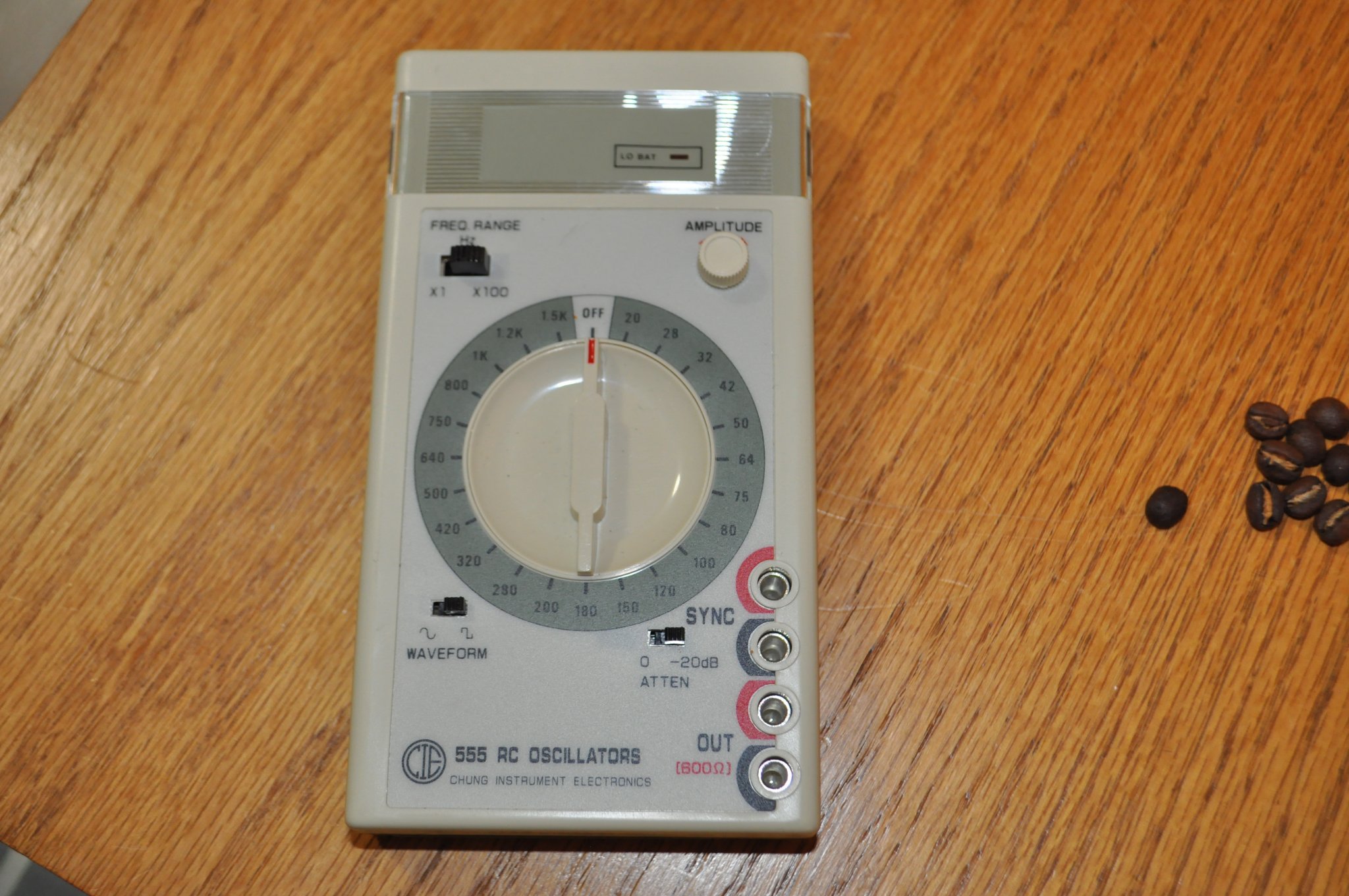

toadroller - YouTube vids can be fine for a signal, but what's providing the voltage output? 😀 My computer won't put out enough voltage to drive an Aleph 30 to 16Vrms (as an example). You may also want to note the frequency... 1000Hz is about 10x above what's mentioned. Some AC VM may not latch to 1kHz. If you're using a scope vs. a "cheap AC Voltmeter" as mentioned, then roll on Toad. 😀

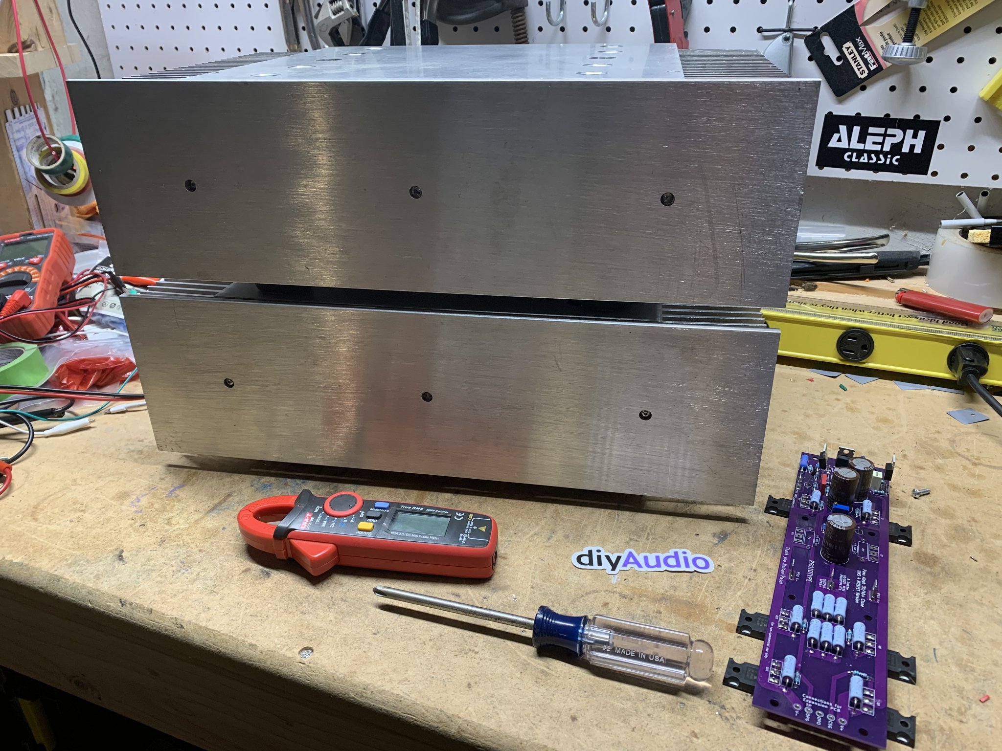

This is our Aleph J. I'll pull these heatsinks and install new ones with the 30s. It runs 50-55° C weather-dependent.
I should probably just set it and forget it, but I like the challenge. Always learning @ 69.

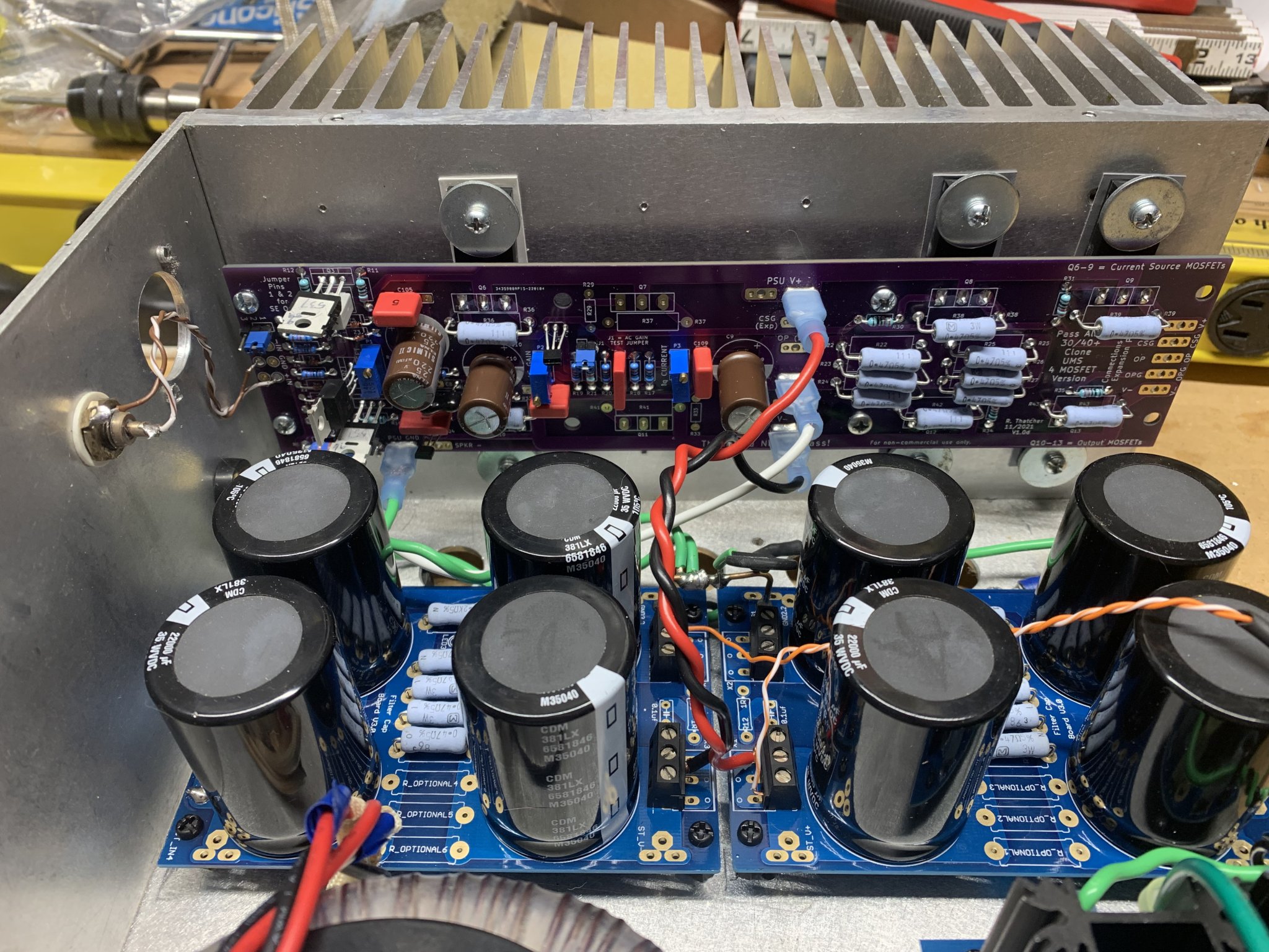

My prototype boards have been swapped for GB boards in Aleph 30 mono block configuration. They sounded great on the bench. Now it’s time to put them on JBL 4410 monitors.
Nice! Is there a reason you skipped Q7 specifically?
Not really. I need 3 of the 4 per side of the board populated. On my prototypes I tried Q7 on one board, and skipped it on the other. Makes no difference.

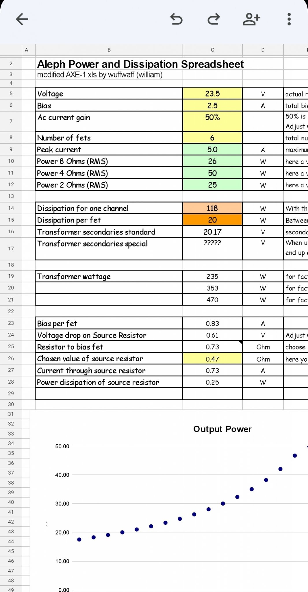

Can I use the "Aleph Power calculation" spreadsheet created by @wuffwaff for this project to do thermal calculations for certain bias points?
