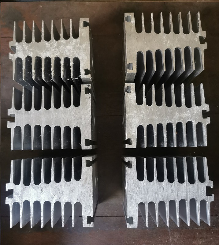

With a 200VA Antek, Randy's PSU PCBs, and the rectifier and parts, think this will get the Aleph going. Have two M2xs with outboard PSUs (thanks, Paul in WA) and they sound dead quiet and super dynamic with 500VA Anteks (only ones available) and industrial-sized rectifiers. Like the mono or outboard approach.
Laughed at myself before I saw that you had linked to a selection with 2x chassis. I thought chassis prices had gone through the roof. 😀
The mini's are fantastic. However... for this build, you're likely only going to use one heatsink per chassis, correct? You did the outboard PSUs for the M2x. You could... if you wanted... use the same PSUs for your M2x and your new Alephs to swap back and forth. You could also (perhaps with a bit of a wait) get the new monoblock chassis from Modushop. I don't know your other considerations, like if you need both amps running at the same time, or in different rooms. Just tossing out a thought. No matter what you choose, it'll be a great build.

"The mini's are fantastic. However... for this build, you're likely only going to use one heatsink per chassis, correct? You did the outboard PSUs for the M2x. You could... if you wanted... use the same PSUs for your M2x and your new Alephs to swap back and forth. You could also (perhaps with a bit of a wait) get the new monoblock chassis from Modushop. I don't know your other considerations, like if you need both amps running at the same time, or in different rooms. Just tossing out a thought. No matter what you choose, it'll be a great build."

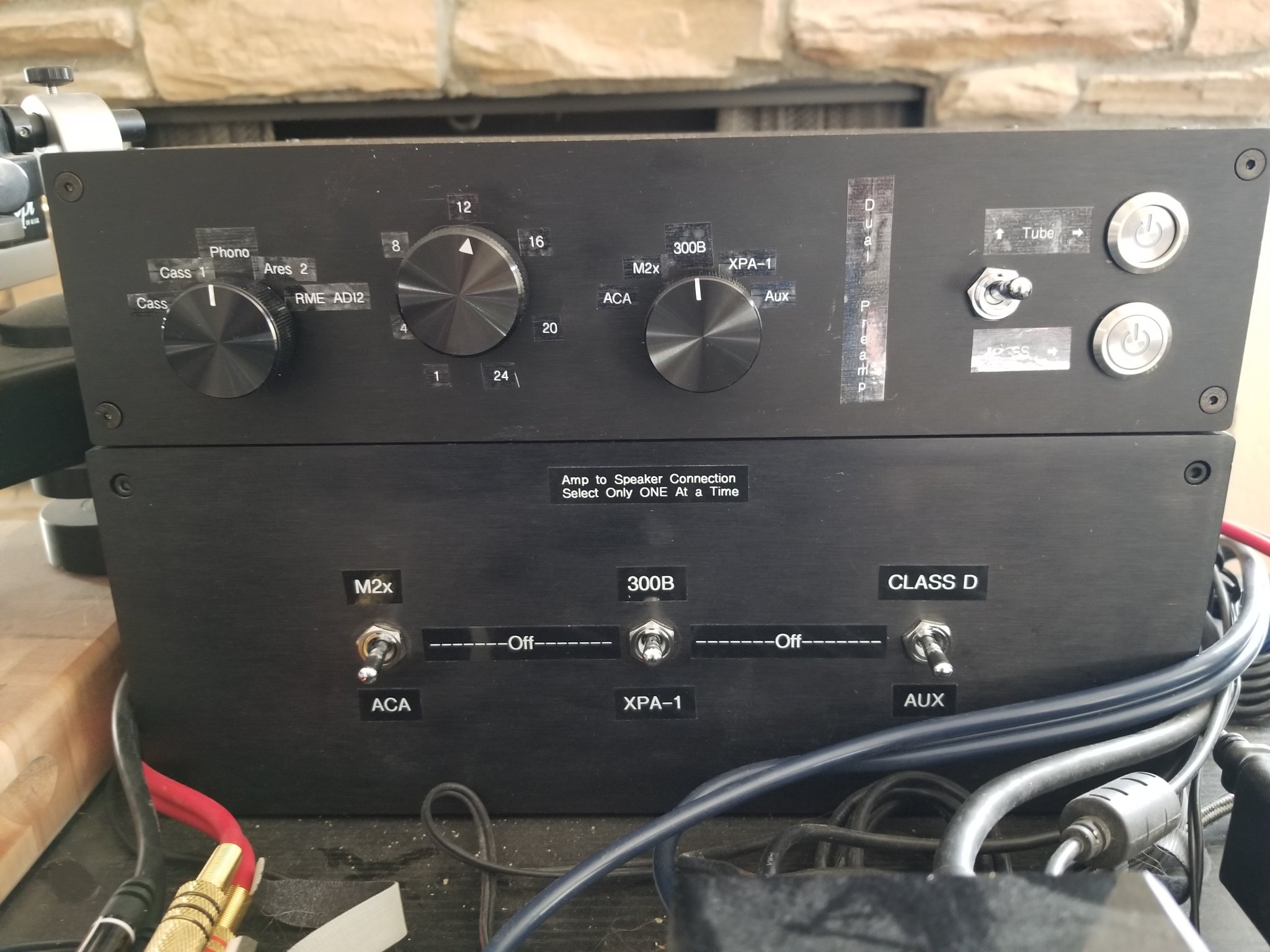

My pursuit is to make a variety of amps available along with multiple pres and media sources in order to select each for the best audio effect. As such, have built two Pass amps, two Pass/Wayne preamps, and designed and built multiple switching boxes to make this a realistic process. Here is one state of this madness:
Using these two boxes you can get a wide variety of audio combinations dialed in.
Want to hear what a vinyl source sounds like with a tube pre and 300B amp? Make the selections, turn on the amp, and away you go. Five seconds or so. BTW this is one incredible sound.
But let's say you want to massage the new Denafrips Ares 2 DAC with the Wayne WB2018 pre and try for some digital perfection through a pure Class A amp (the ACA). Takes 5 seconds. A cleaner sound is hard to imagine. This combination is my favorite morning sound to get you thinking straight.
My overall goal is to establish a lexicon of ideal audio combinations in the Medium/Preamp/Amp/Speaker chain. Then, I use the phrase "Active Amp Selection" to describe making these decisions in real time in order to improve your listening experience.
Yeah...it does work, can tell you.
Started one thread about the Dual Preamp and it was a colossal dud. Won't even try with the Active Amp Selection concept. Will have to wait for the second coming, I suppose.
Now in conversations with the DIY deity 6L6, discussed the pure class A option and he suggested the Aleph J as one of the best choices.
SO...HERE I AM. Ready to build another amp! And buy lots of new stuff! Oh how I hate buying lots of new things (LOL). Have to console myself with the realization that this is one of the ways to stay young.
Yeah...buying lots of stuff and staying young. For some of us, that's the way we are throwing away our retirement...

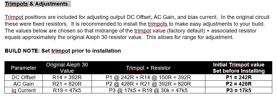

I've seen it somewhere on this forum, but my search isn't getting me anywhere. I'm trying to figure out how to center the trim pots before installation.
See the Build Doc. What you're looking for is in the Trimpots & Adjustments section and the comments column in the BOM.I've seen it somewhere on this forum, but my search isn't getting me anywhere. I'm trying to figure out how to center the trim pots before installation.
For Aleph 30
