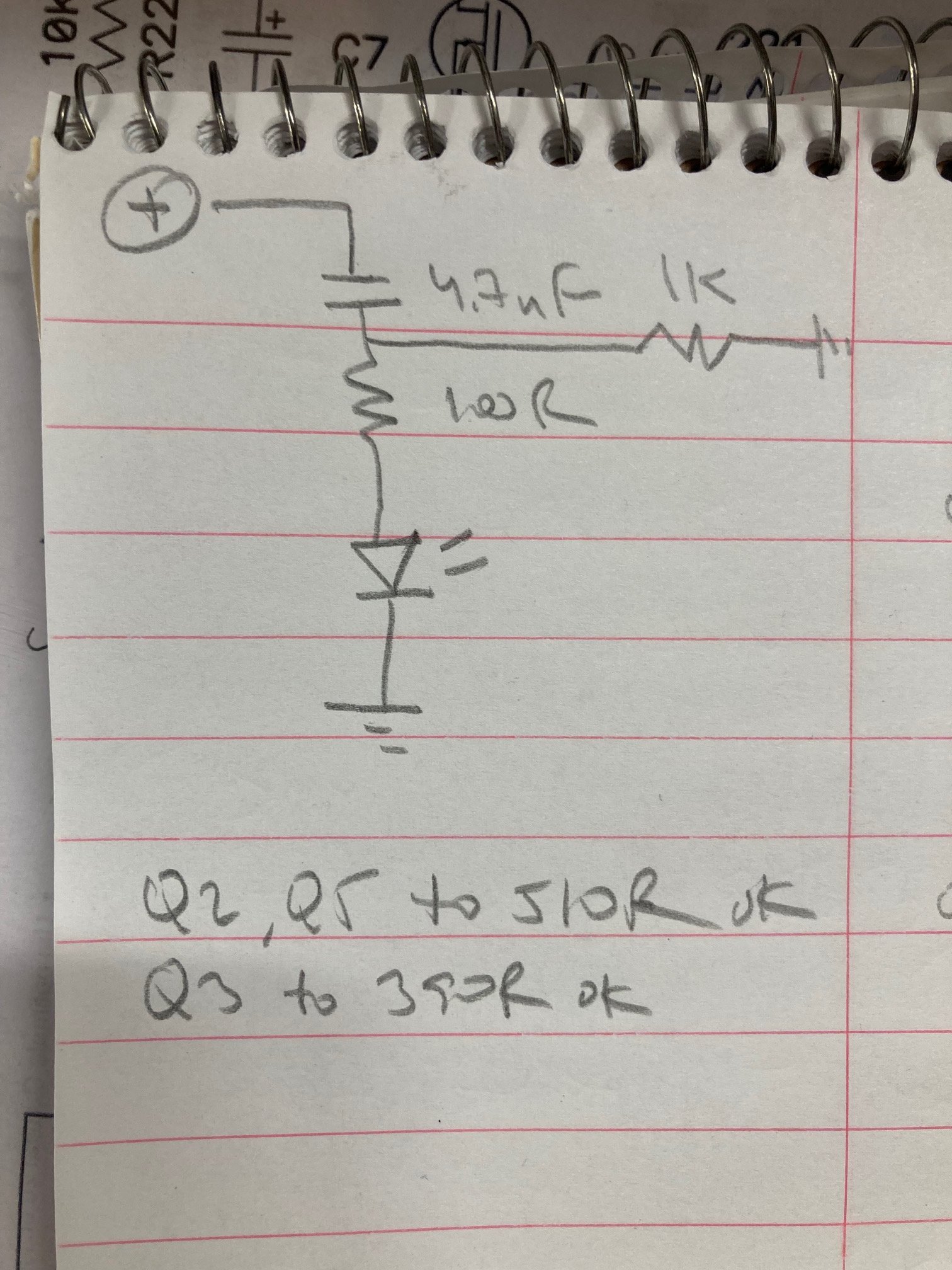

@ranshdow Have had no prior experience here and will have to do some investigating on oscillation testers. Always take the approach of turning a weakness into a strength and if the project lets you buy new equipment, then it's a good one...

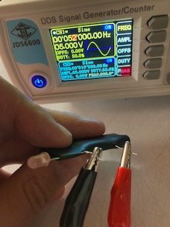

It's something you can build cheap and easy. Someone somewhere on this forum once described a test circuit in words. Here's a working schematic & the device in action (the LED lights up when AC above 50kHz at greater than 5V p-p is present, but this probably depends on the on-voltage of the LED you use). Ignore the text referring to transistors, it's from a troubleshooting effort.

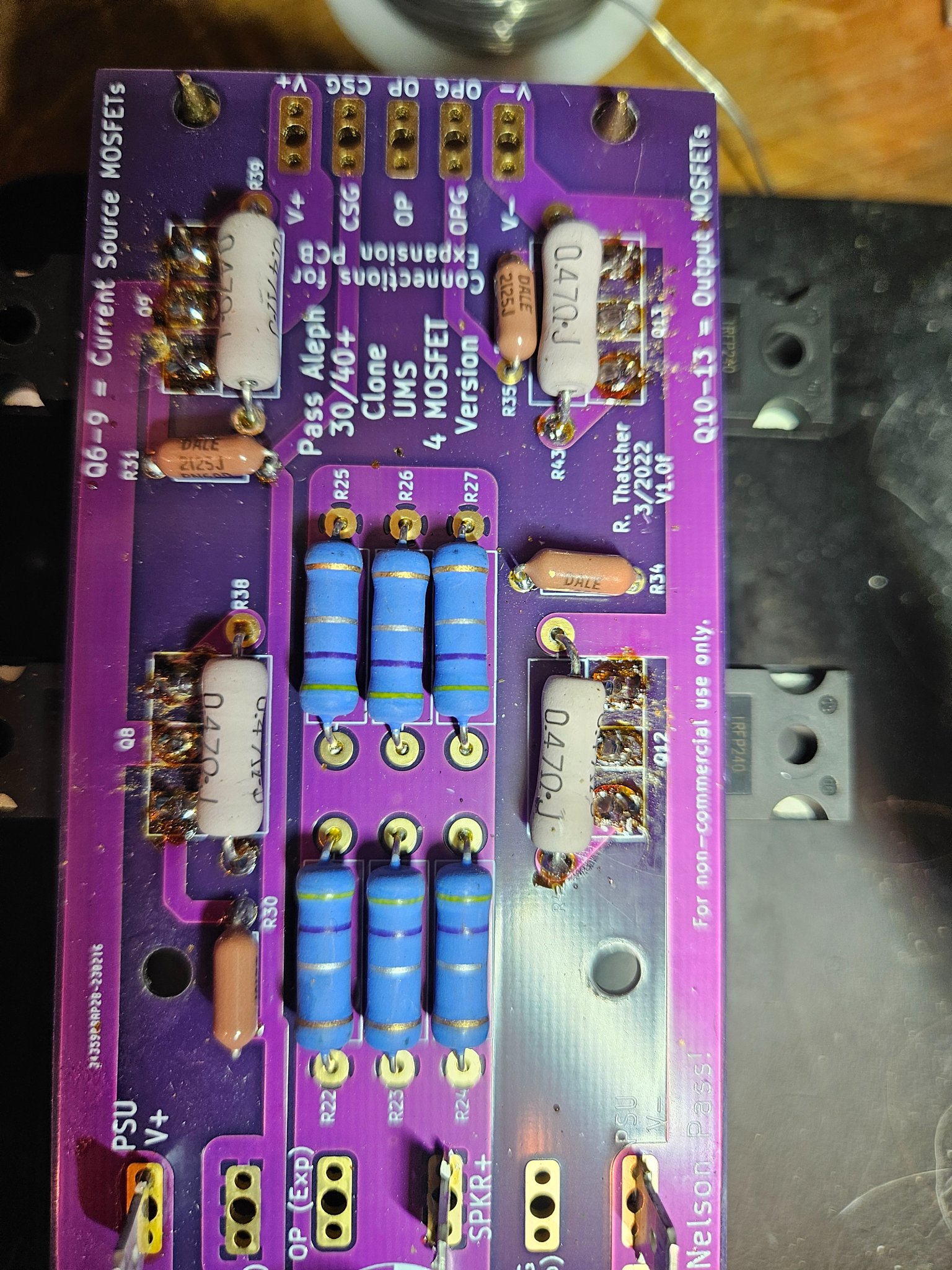

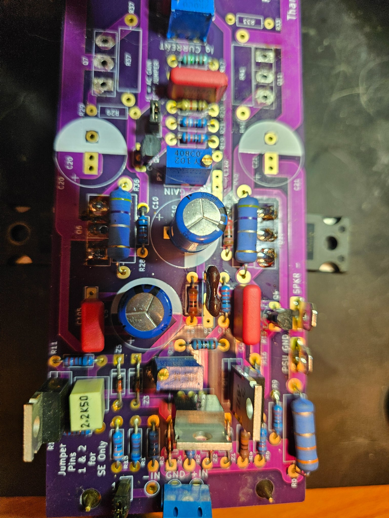

Bad News.
Took the PCB out and reflowed all of the Mosfet and Resistor joints. This board had a problem originally because the 112 Mosfets/resistors were incorrectly placed in the 111 slot. They were relocated and all of the resistors and mosfets replaced. After this, the PCB worked fine but with the POP noise.
After reflowing, turned the unit on with the MM set to measure the DC Offset. It turned on and showed a typical value of -0.004 vdc or so.
THEN after a minute or two, the offset jumped up to 18-19 VDC and could not be adjusted by the trimpot.
Woe is me! It was working with the pop for some time. But after the reflow, it is not operative.

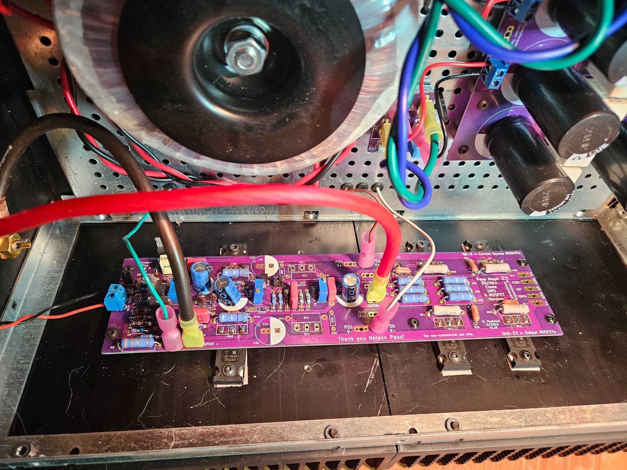

Any ideas? Otherwise will have to build another board and my parts and equipment are in the mountain home.
Jpegs added.

Think not ZM. Used those connectors for some time and the tightness is always modest. My guess would be that some active board item was distressed when the Mosfets were in the wrong locations and that has became worse causing the failures.
But its irrelevant. Am replacing everything next May.
Until then, can use the 300B and A/B amps here in place.
Checked the Mosfets and three (!) are completely shorted out. Am giving up on this PCB entirely and replacing it with another.
In a "popish" kind of way it sounded good while it ran...
Hmmm.... I think you have other problems there as well.
Shorted MOSFETs would cause an immediate swing to V+, or V- rail measured at the speakers' positive terminal, as soon as you turn the power ON.
If the MOSFETs pair (V+ rail to V- rail) are shorted, the mains fuse should (well, one would hope so...) pop out/blow.
Eric: the solder flux is because this pcb as noted above has been reworked several times. What you see on the heatsink is actually dog hair...lots in my places. This is irrelevant because the board is being replaced entirely.
