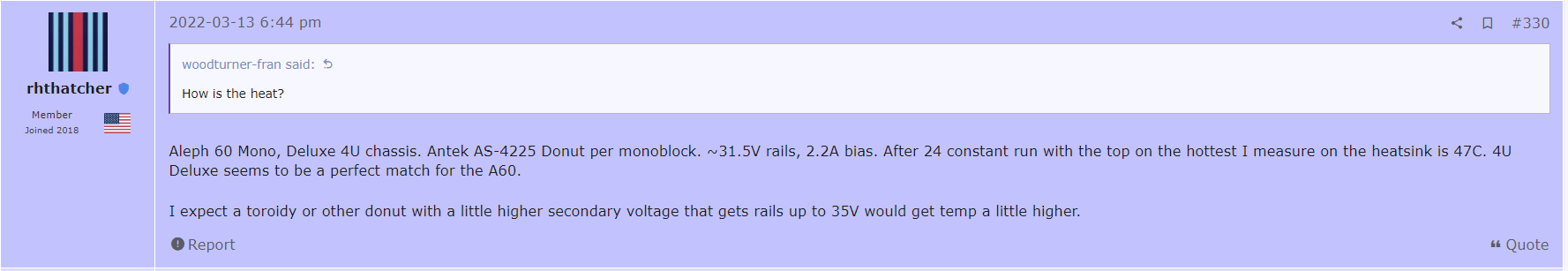

Randy, I have now found your build of the A60 in 4u300.
Do you still use the amp regularly (because it's 2.5 years old)?
How is or was the temperature behavior and long-term durability?
I have my M2x in a 4u300, but it's an other, tamer animal.
Thanks in advance.
Istvan - A60 in 4U/300 is warm and reliable. I had to hunt for my old post...

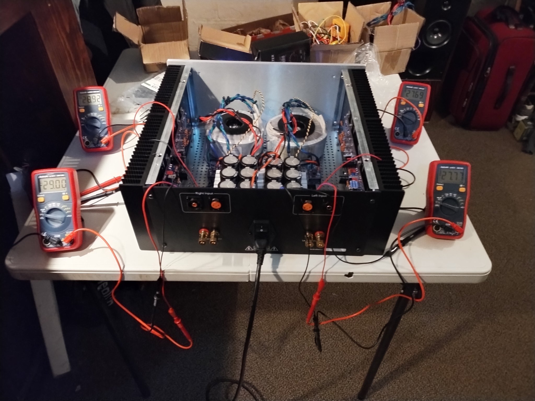

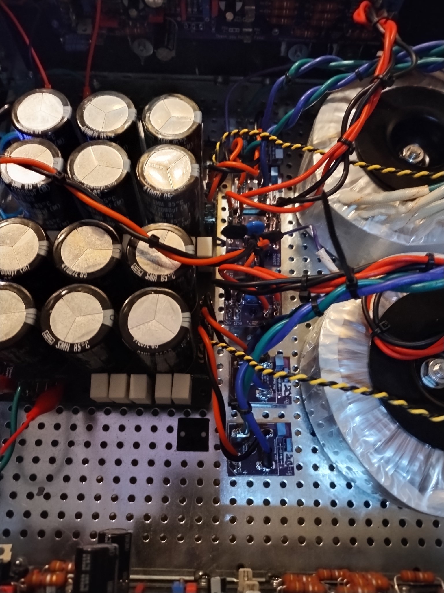

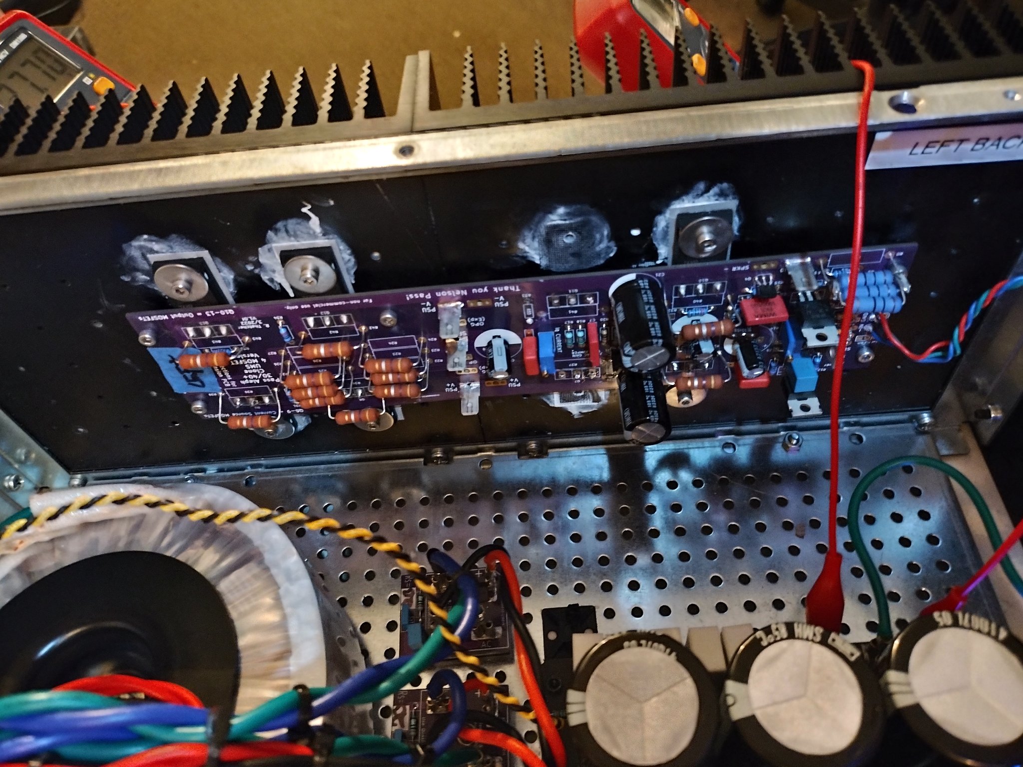

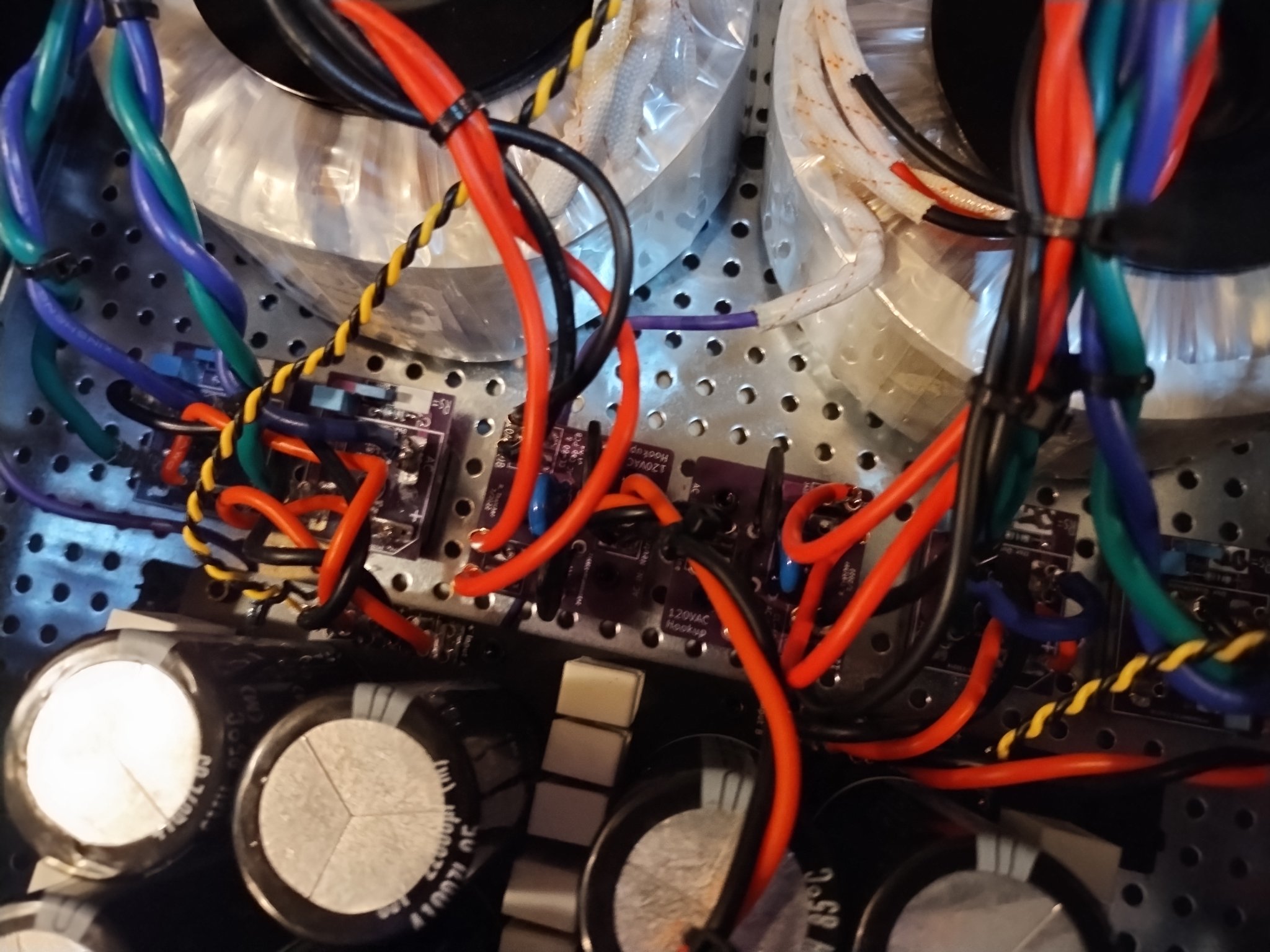

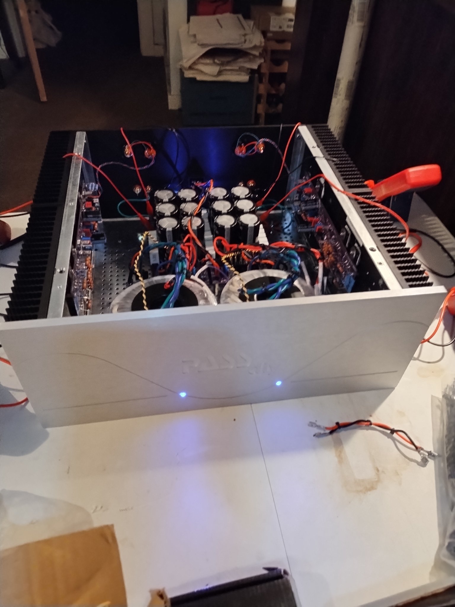

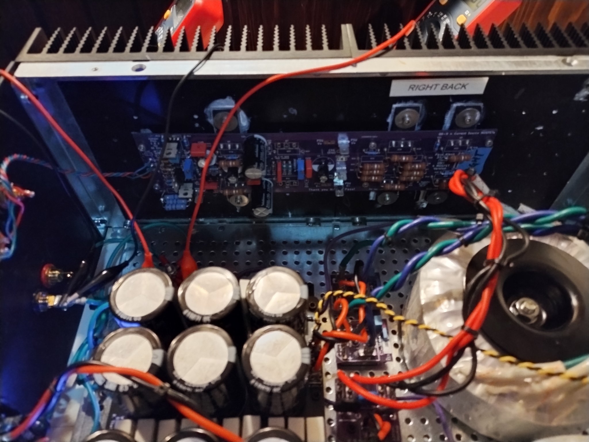

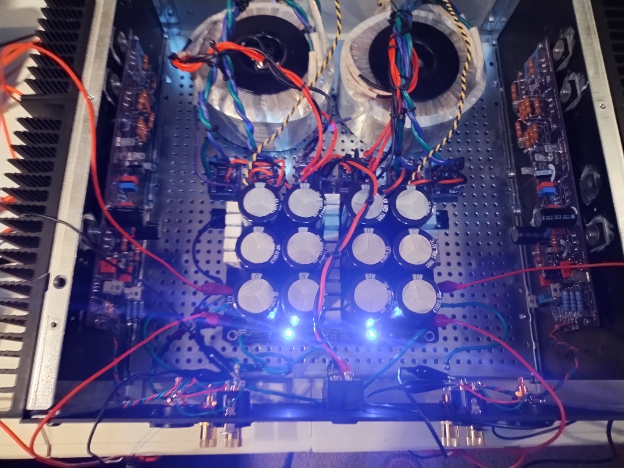

Randy Thatcher's Aleph 30 with IRFp250 mosfets in 4u chassis with W12 PSU - Dual Antek AS-4220 traffos. I also used the Soft start circuits from Randy. Just putting it on test. All power mosfets matched to within .002 vgs. All input mosfets matched equally to each other on both channels. I've seen heatsink temps between 40 - 48 degC.
330mV on each mosfet.
