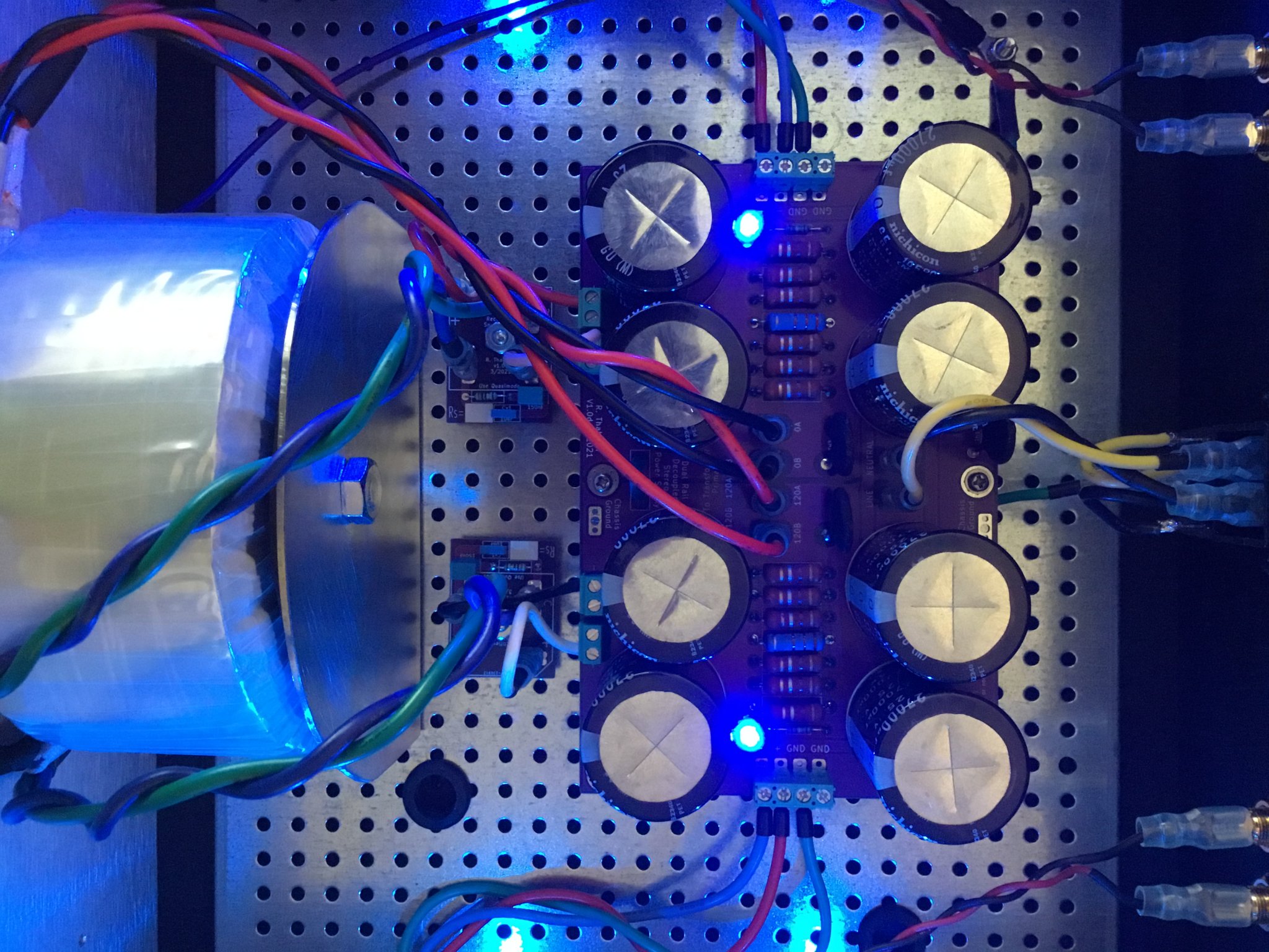

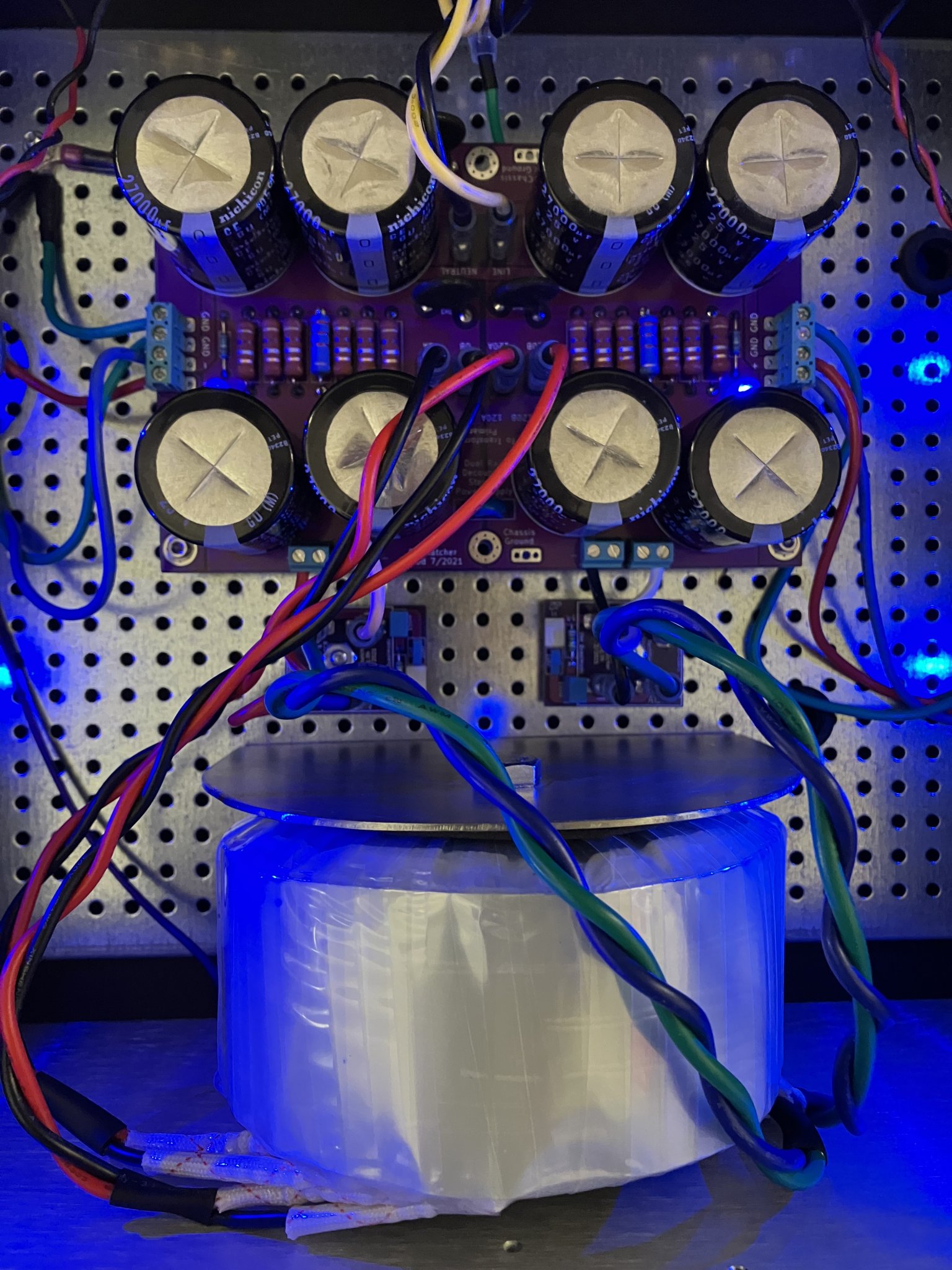

It makes zero, zilch, nada, no difference AT ALL from a functional standpoint with your wiring ... but... (there's always a but)... Black is line/hot and white is neutral per US mains wiring convention.
You also chose to use white and black (and red) with white used for - and + from different rectifiers. That would confuse me... but I'm easily confused.
Mainly wanted to say... awesome... but I am too much of a goof to have the same colors used for various things... particularly within the DC side (the two whites from the rectifiers).
Also... you've got your "audio gnd" connected to chassis gnd/mains earth (the baseplate - left side) and also the thermistor installed as the ground lift.... I'd reconsider that and/or ask someone way smarter, but I think that defeats the purpose at best and may cause issues at worst.

The wire colors are kind of the way they are. I started out with a bunch and didn’t feel like ordering another bunch. I go back to them every couple months thinking I’m going to ”fix” things but never do.
I would like hear about the ground issue you see. If you can expand on that and offer a suggestion, I would appreciate it.

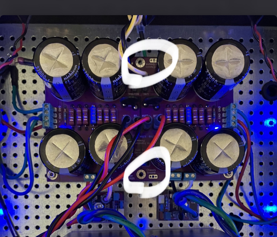

Chassis ground issue.
Solder a wire or use a screw at the circled holes to connect the PCB chassis ground connection to the bottom plate. These connect chassis ground to the Audio ground through the CL60 that is located near one set of these connectors.
