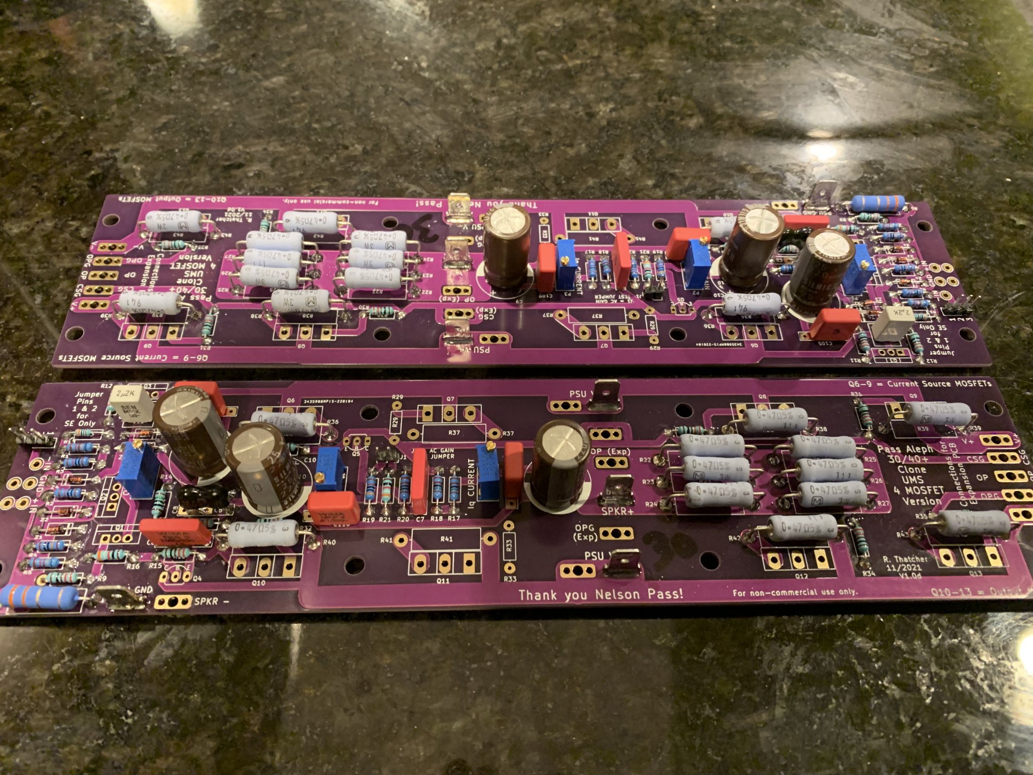

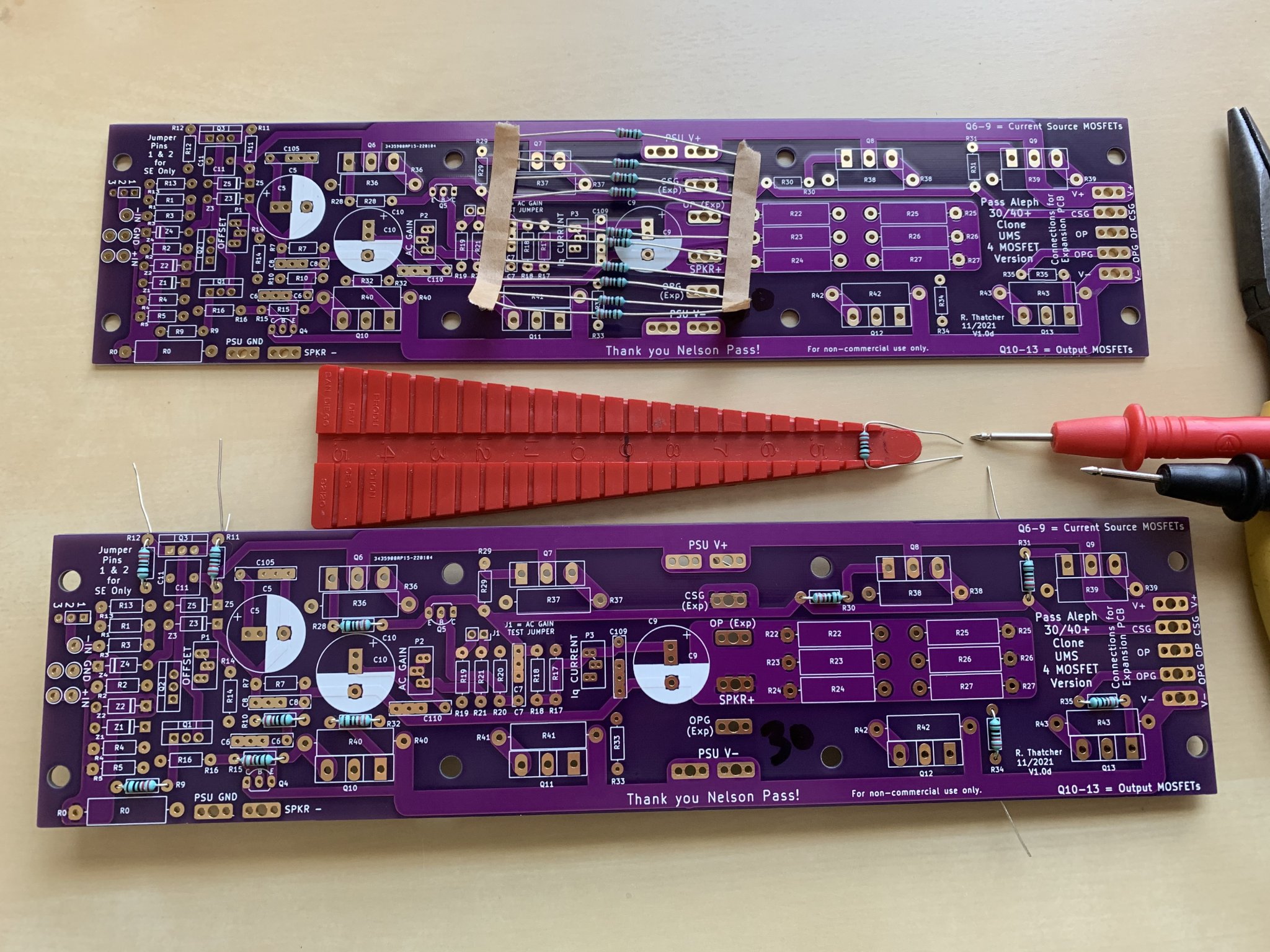

Here we go. I’m going to replace my prototype boards with new boards to play with the new features. I’m starting to stuff the new boards with 221R’s.
This will be an Aleph 30, and I’m going to stuff mosfets in Q6, 8, 9 and Q10, 12, 13. Since I’m skipping Q7 and Q11, I’m also skipping associates gate resistors (R29 / 33) and source resistors (R37/41)

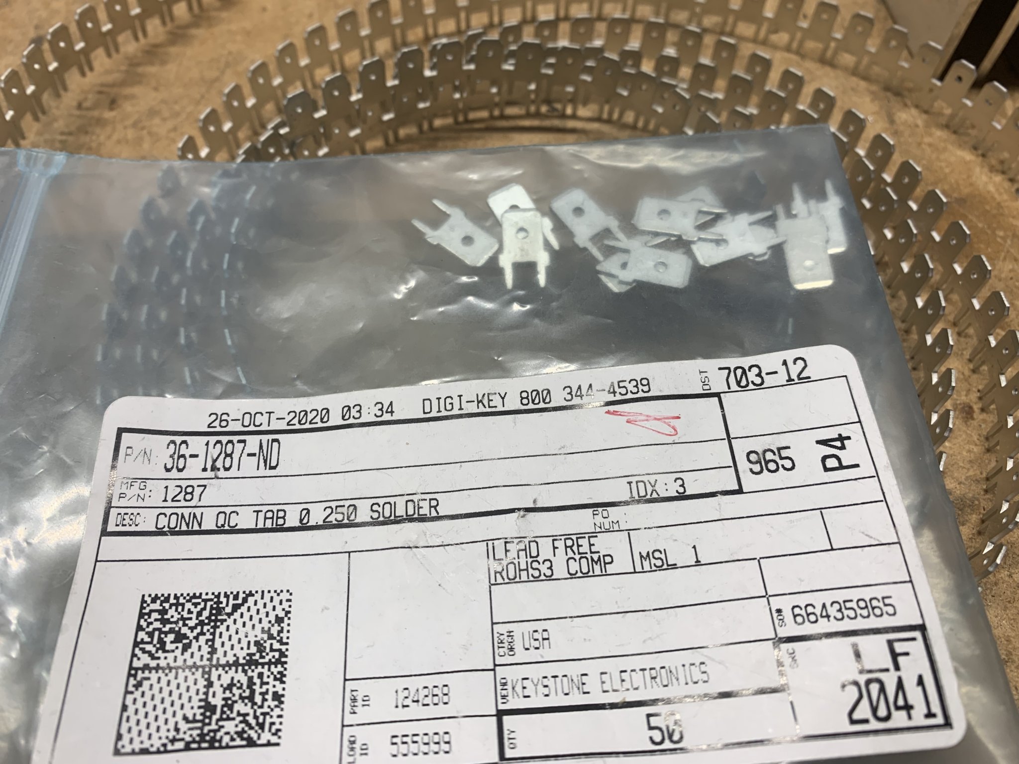

There's 5 or so possibilities for terminal blades. Is there a preference? https://www.mouser.com/c/?type=Circuit Board Blade Terminal
this is the one from the building guide BOMThere's 5 or so possibilities for terminal blades. Is there a preference? https://www.mouser.com/c/?type=Circuit Board Blade Terminal
https://www.mouser.it/ProductDetail/Keystone-Electronics/1287-ST?qs=lQmX4aIt5iBQmFQ9gmrtHw==
Thanks for that. What else am I forgetting that's not on the above BOM?
